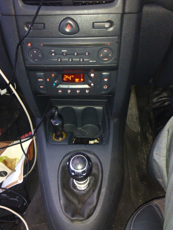

Been playing.
Not a bad fit

Every one i speak to in the trade who map these says the engine i have has stronger pins and rods, and well capable and reliable at 300hp with matching torque. if it throws a rod then, all i need is a new motor there widly available and then ill forge it :) some thing to do hey :)
Yeah shes dirty hahaha had my lunch in it and its stood for a while, full valet when shes finished :)
