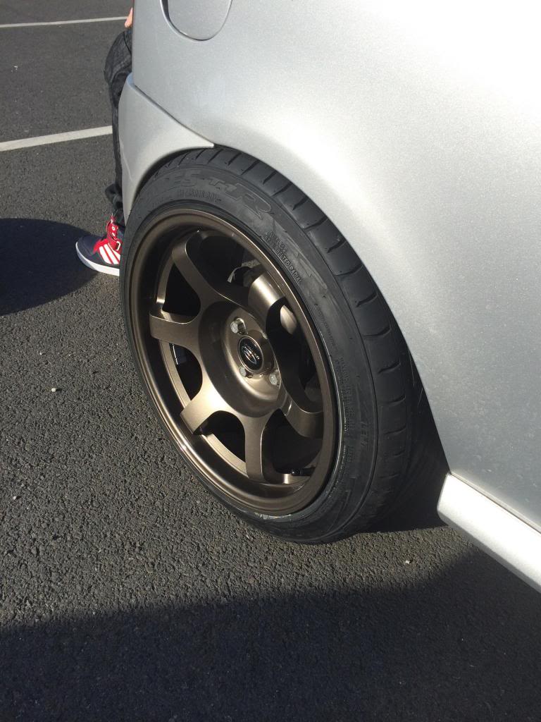

You will get pulled and possibly points for the rears being like that.

No worries matey. If you got the wheels lathed professionally then it'd be fine. It's not something I'd want to be doing myself as they've got to be perfect!
I've got to agree with Tom though, you will get in trouble if you leave them sticking out that far :/
