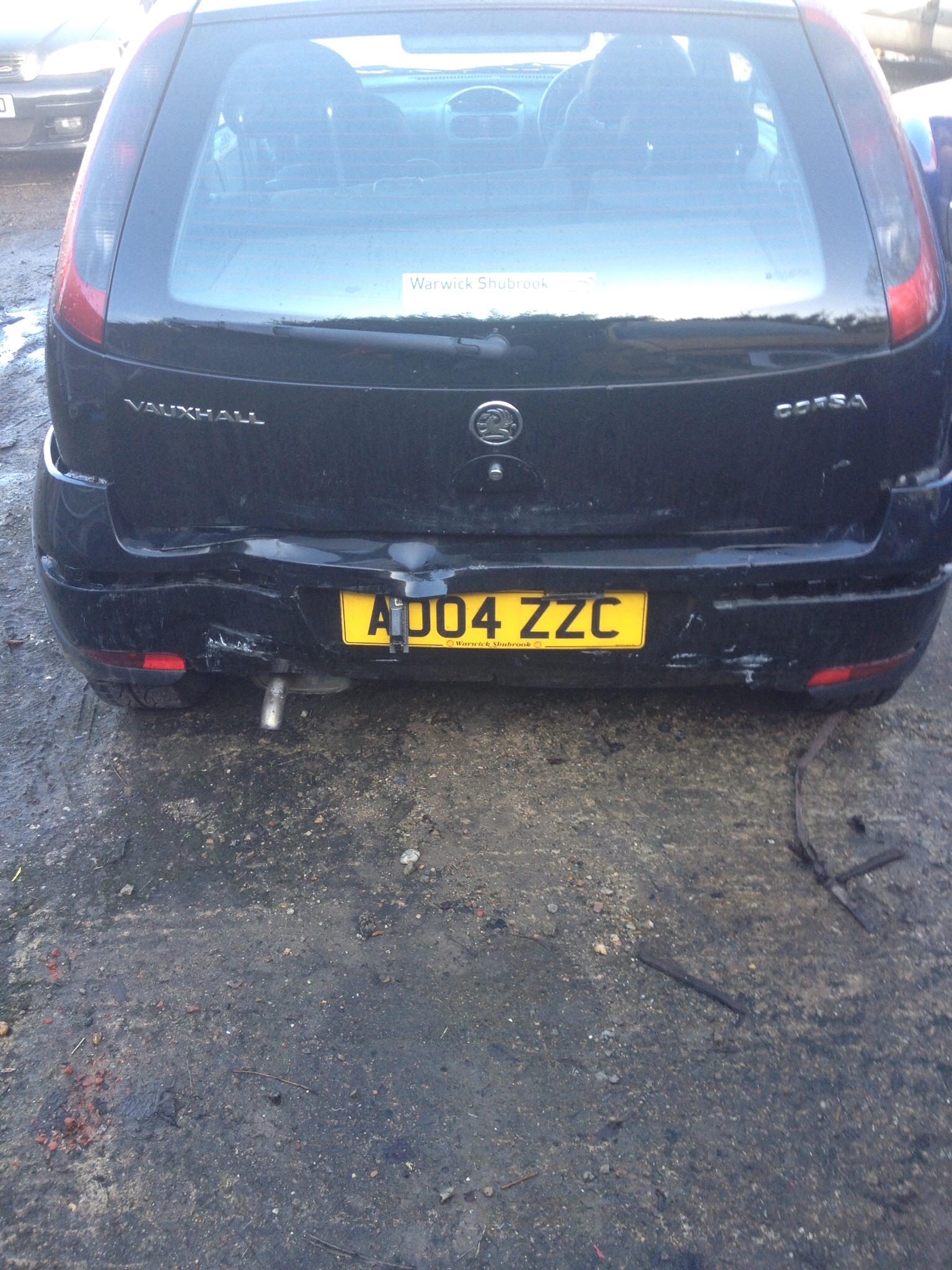

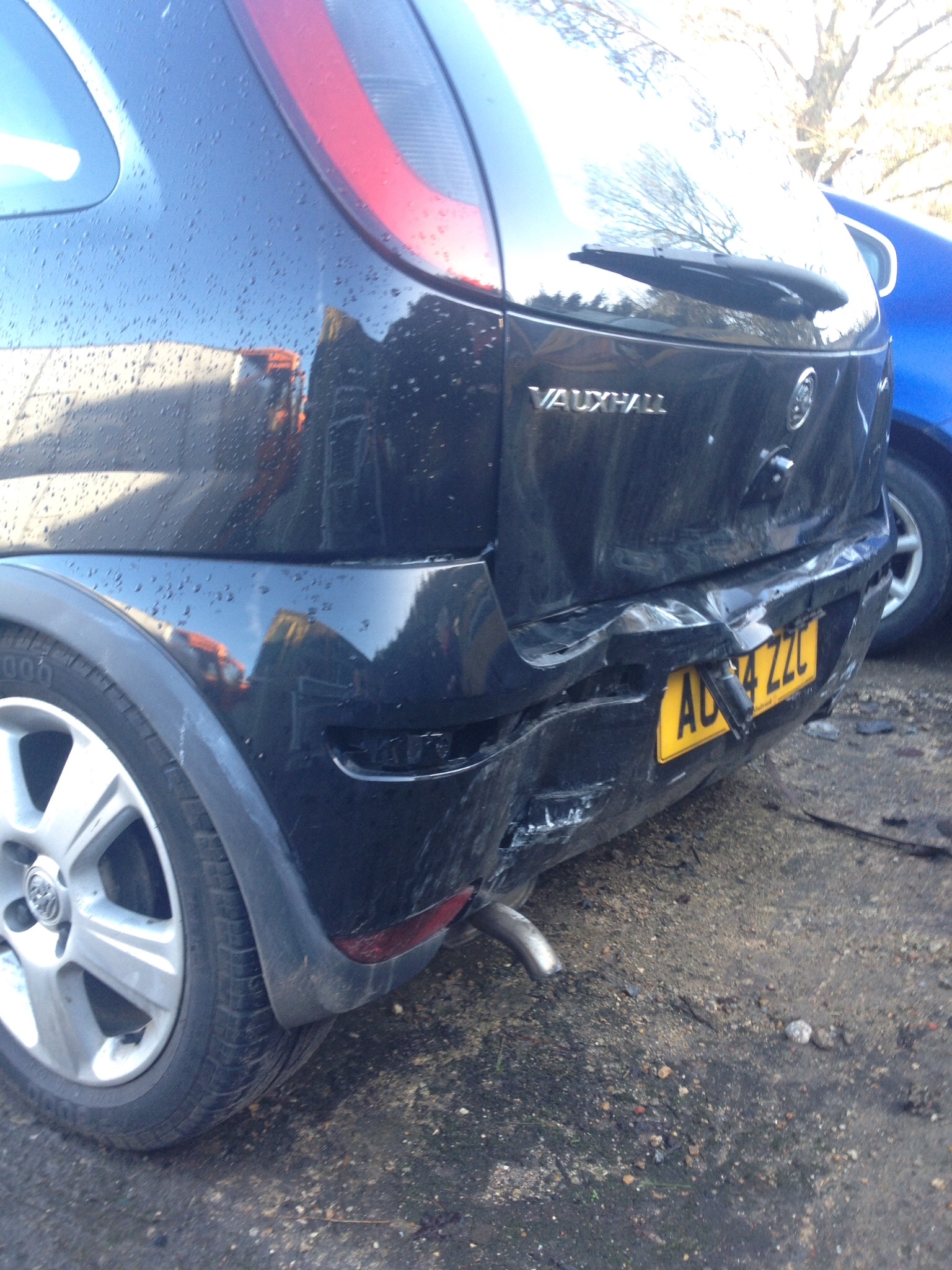

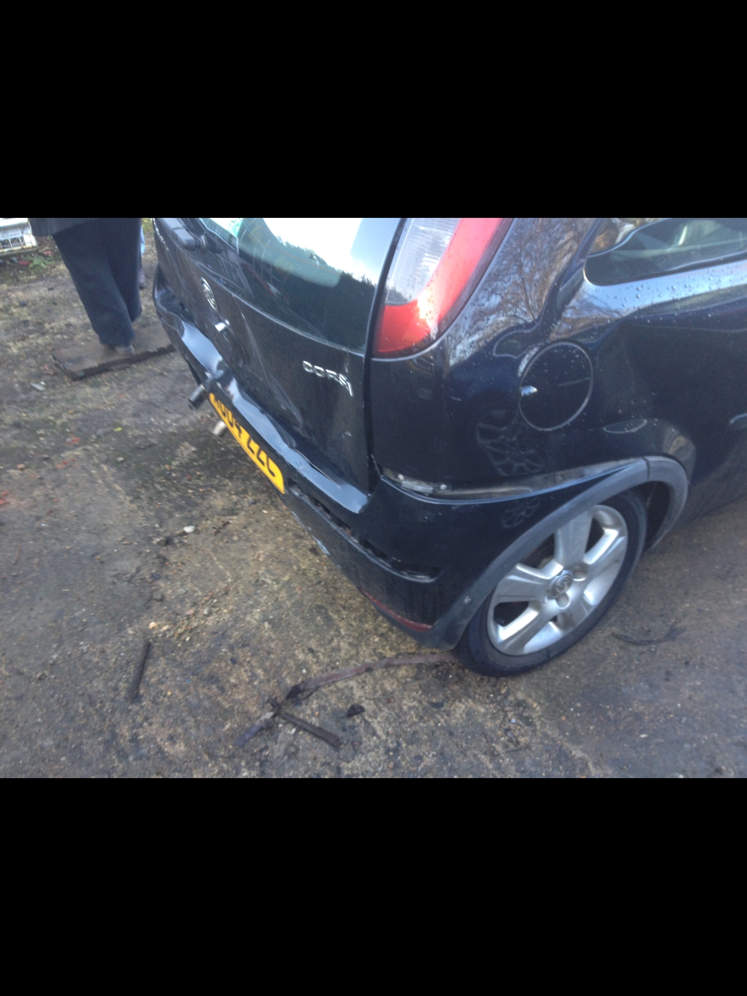

I lost my first car (Corsa) in January to a Audi A6 on a straight road it took quite a battering, that was a very experience considering I'd only been driving 2 weeks

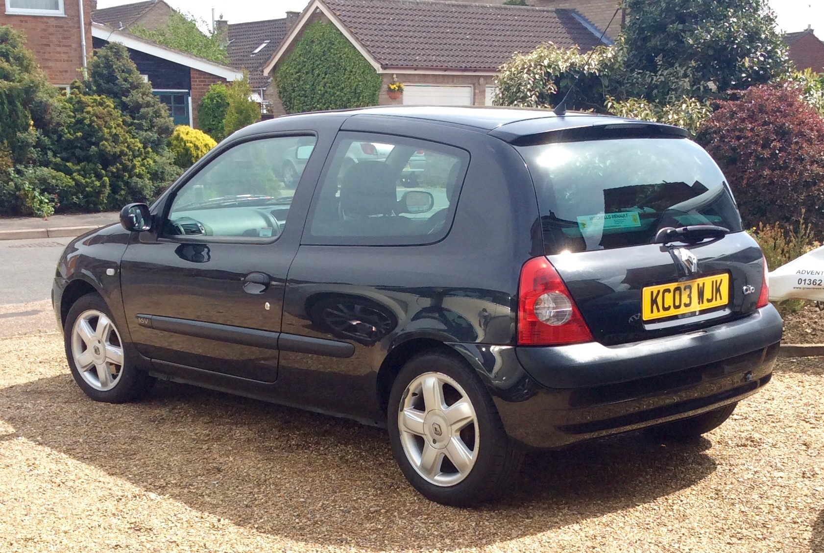

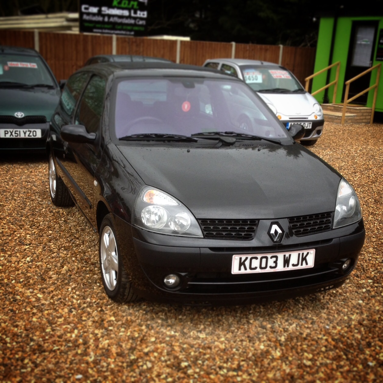

So 3 months ago I decided to get myself a Clio 2003 1.2 dynamique on 70k. It has been used by a uni student who didn't really care for it I don't think, the few marks and scratches here and there. Even a few dents. And too make it worse, swirl marks, makes me crease Possibly the type that left the sponge on the ground while hosing the car down. But it was mechanically sound, and has been so far (touch wood) Nothing major that can't be corrected though, I was happy to be on the road again after 3 months from it

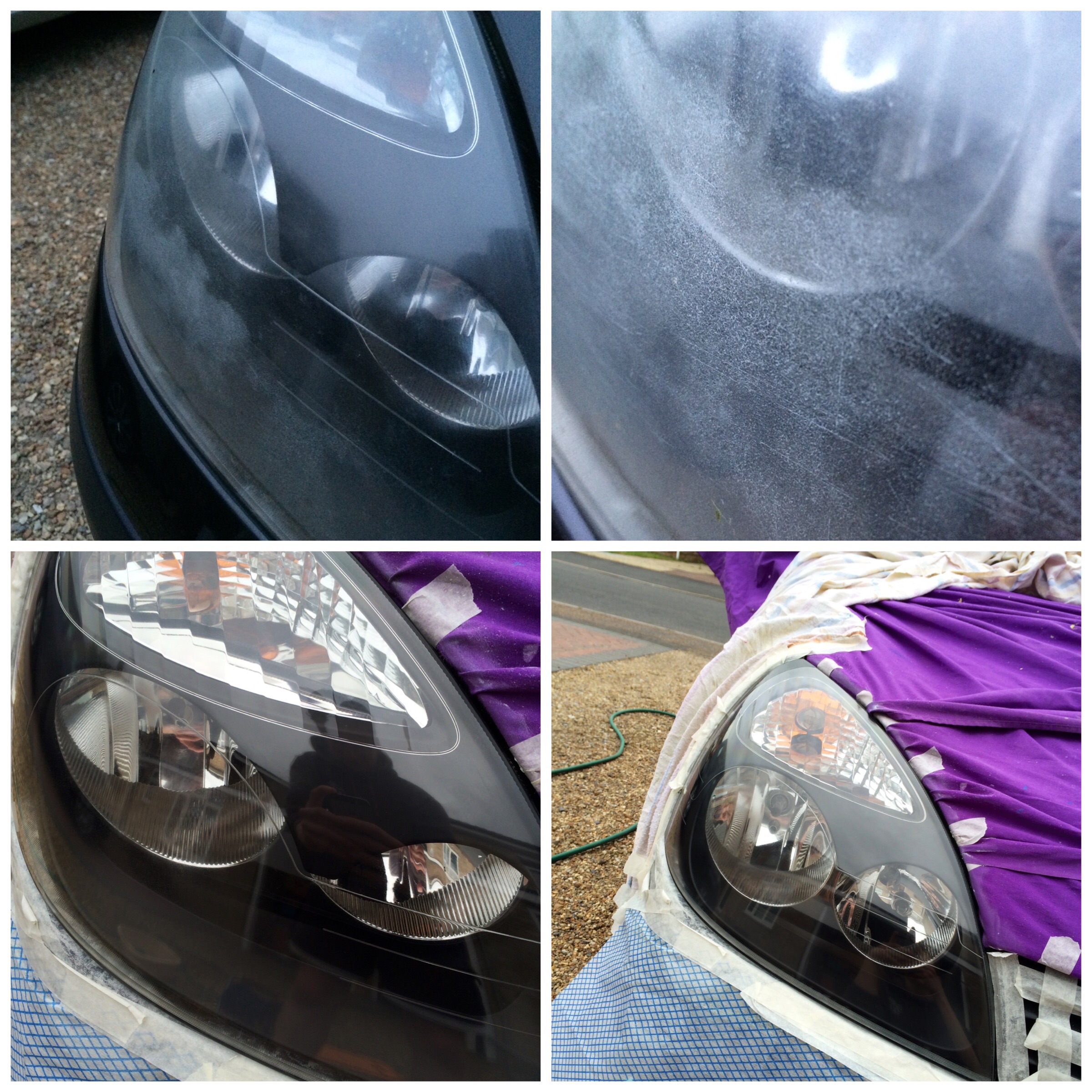

I gave it a good thorough clean once home and a good wax and polish, which revealed many scratches covered up by black shoe polish that was sneakily used to cover them. Here's how it stood after a good clean. (I didn't take many pictures because I didn't expect to be posting something like this, apologies)
Now obviously I was very happy with how it stood like that, because even at standard it looks smart, I had just planned to clean it regularly. But after hours of looking at this website my mind was changed. After seeing what the likes of @Kitson93 @Brad.shepp @Dr Jekyll had done to their black Clio's it inspired me to get mine looking as nice as they did theirs. I had a list of things I wanted to do initially, so I started off sorting out the cloudy headlights.
Just covered the area around and started sanding from 1200 grit up to 2500 grit until I was happy with the finish, then using a sponge drill attatchment, with a little of Meguirs Ultimate Compound (very good stuff) it brought them up nice and shiny like new. Both my brothers have Clio's and they're thinking about doing there's now
Both headlights finished, very pleased with the results.

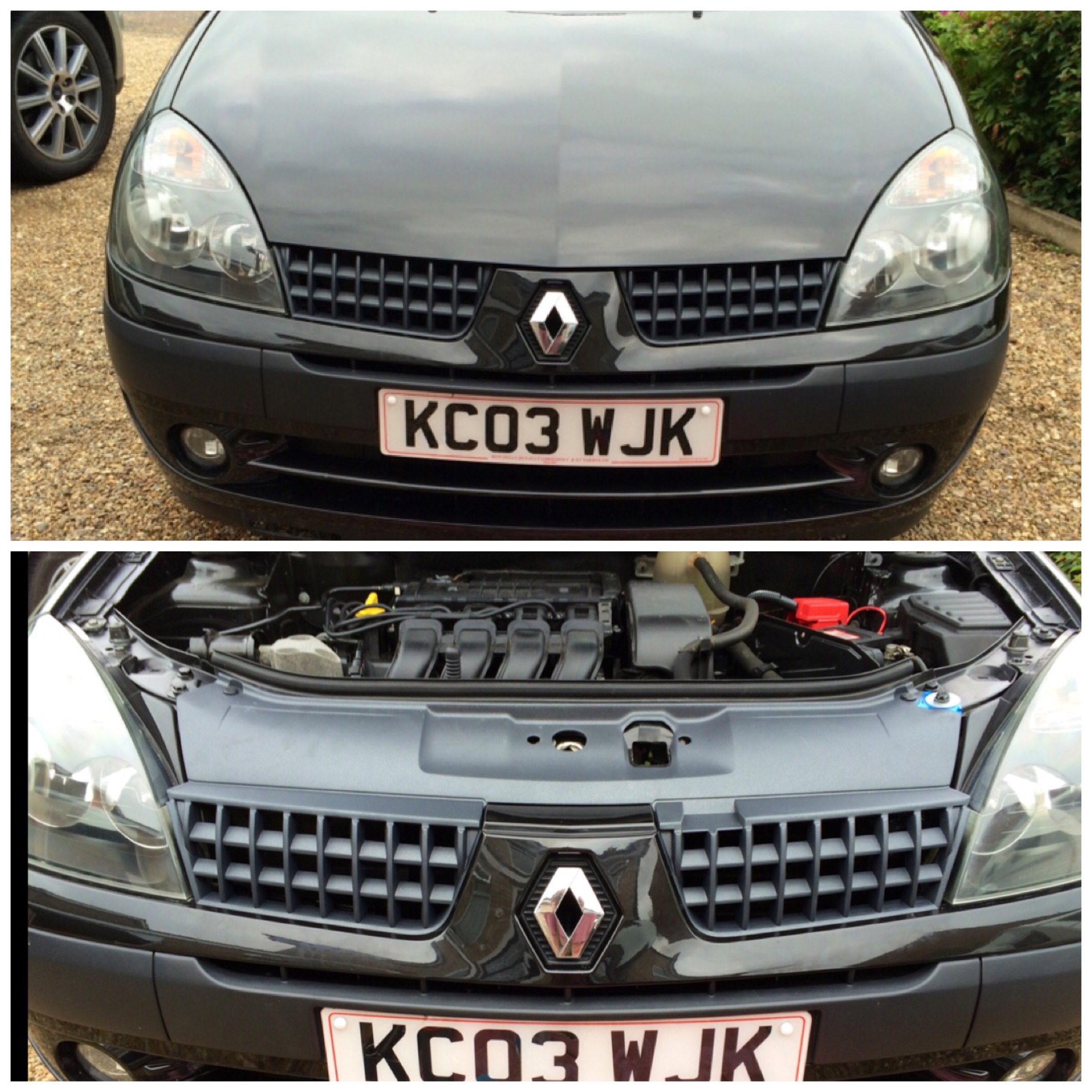

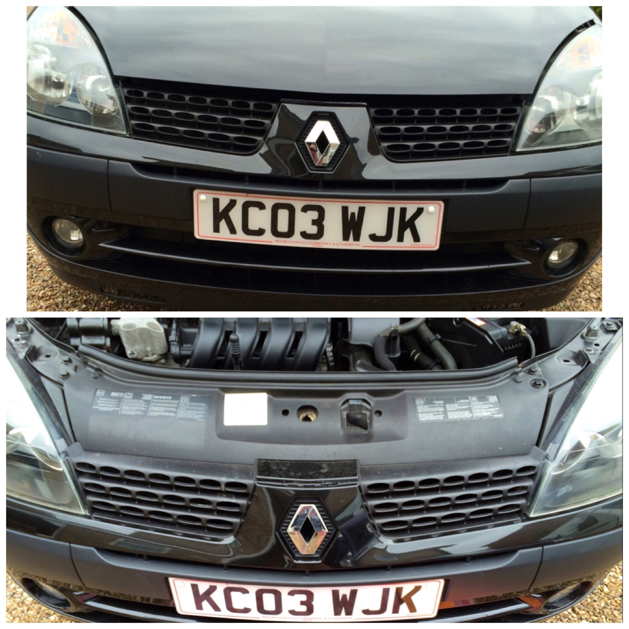

I think almost every Clio owner on here knows whats coming next, I ordered a RS Front Grill to tidy up the front, everyone does it but it's not frowned upon thing, it's more like a 'has to be done' job! It arrived within 2 days which was pleasing so I set off straight away to fit it. I also decided to give the surrounding areas in the engine bay a clean while I was there.
Old boring grill off.
Lovely sporty grill on, makes such an improvement to the overall look, if you haven't already done this to your Clio, I recommend it. I plan to spray it gloss black or satin black in the future though as I'm not 100% keen on the grey look. When I get round to doing that though is another story.

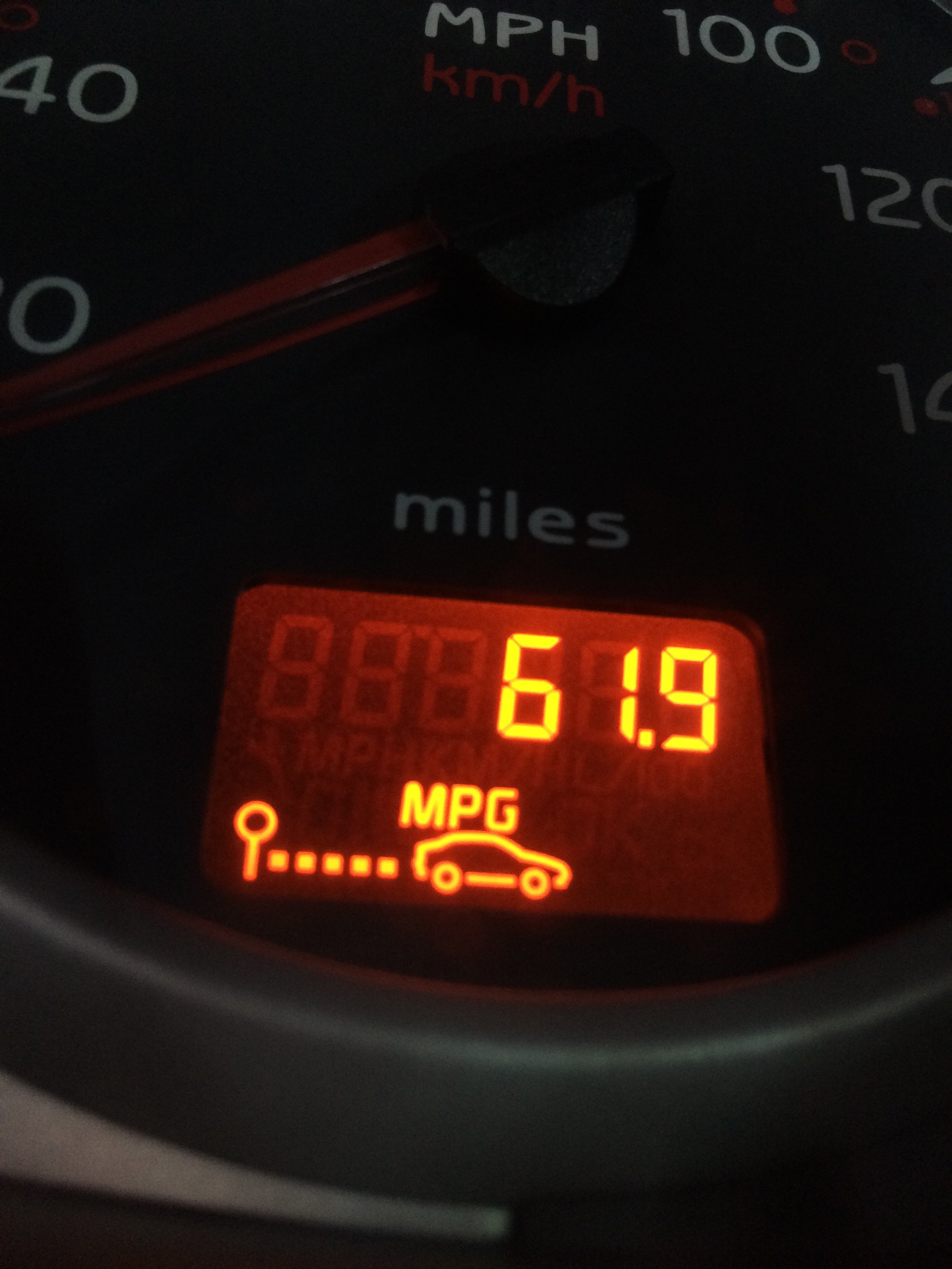

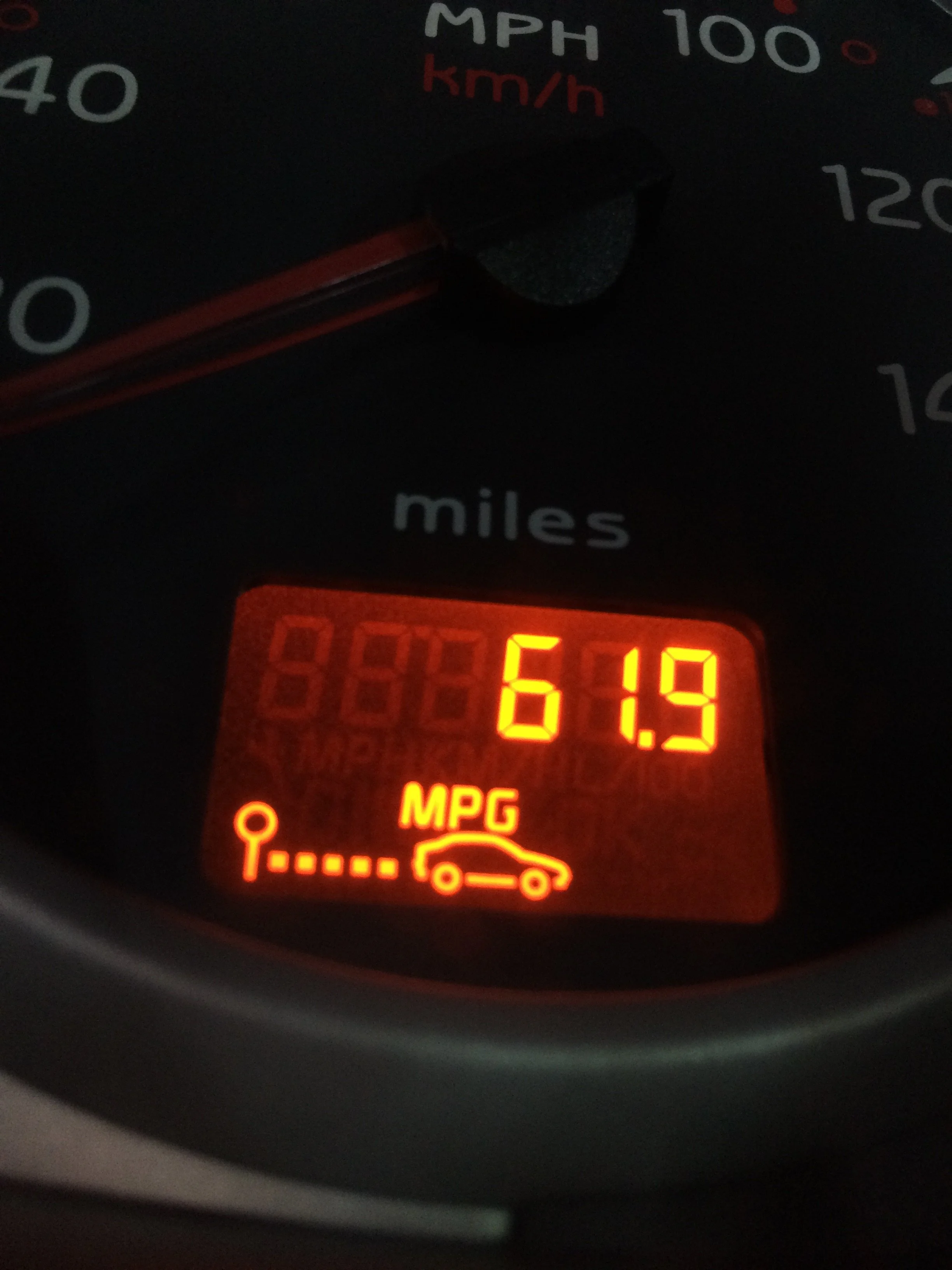

So after a few weeks with good MPG with the Clio, I found some time to do some more things to my car.
As you can imagine I was very pleased with the MPG, but after finding the gas pedal it's gone done a little, I'm currently averaging about 56MPG which is still very good.

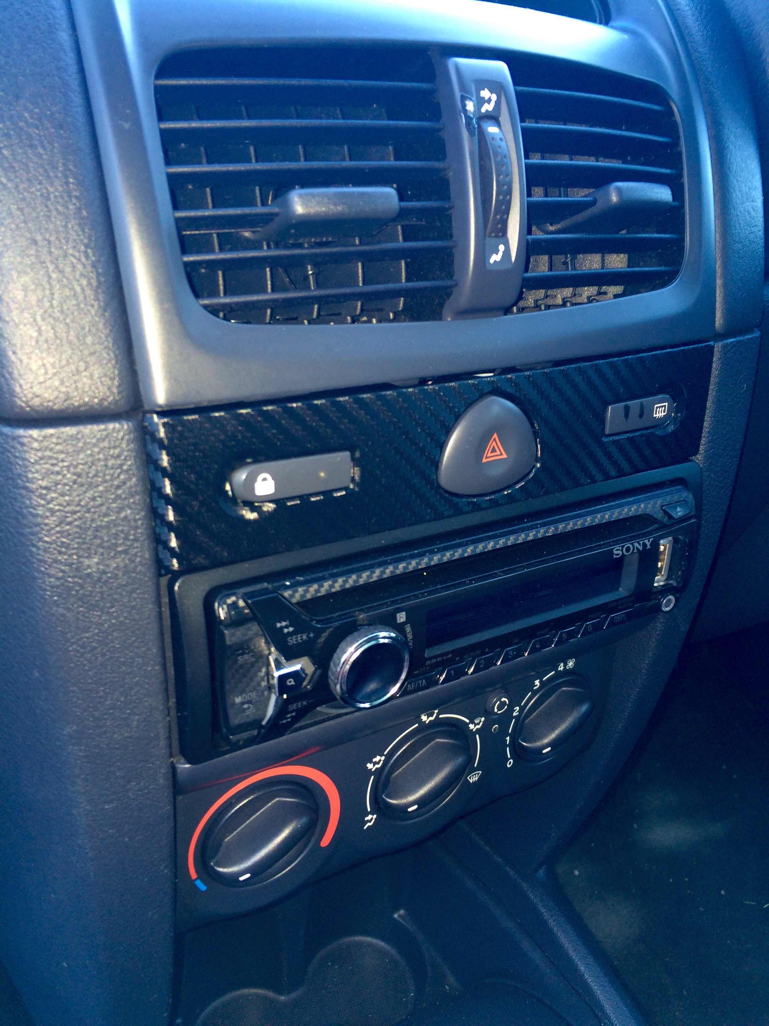

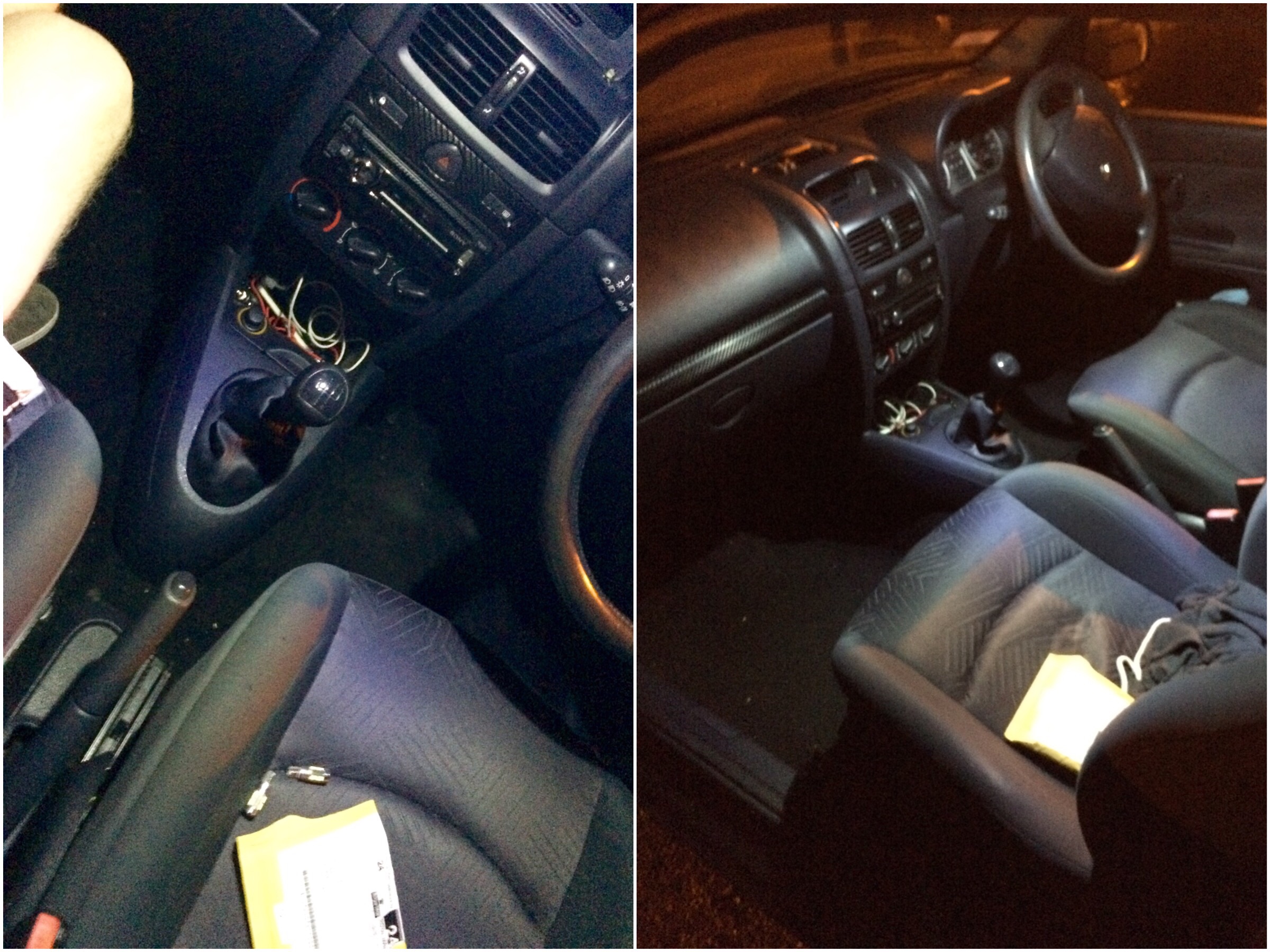

Anyway, I know it's not everyone's tastes but I had to do something about the scratched silver interior dash strips, I think you know what's coming, yes I Carbon wrapped them. Sorry I don't have any before pictures but they were badly scratched. This isn't a permanent job, I hope to eventually have a black red theme interior similar but better than @Dr Jekyll did haha
(For anyone interested what that looks like, this was his interior)

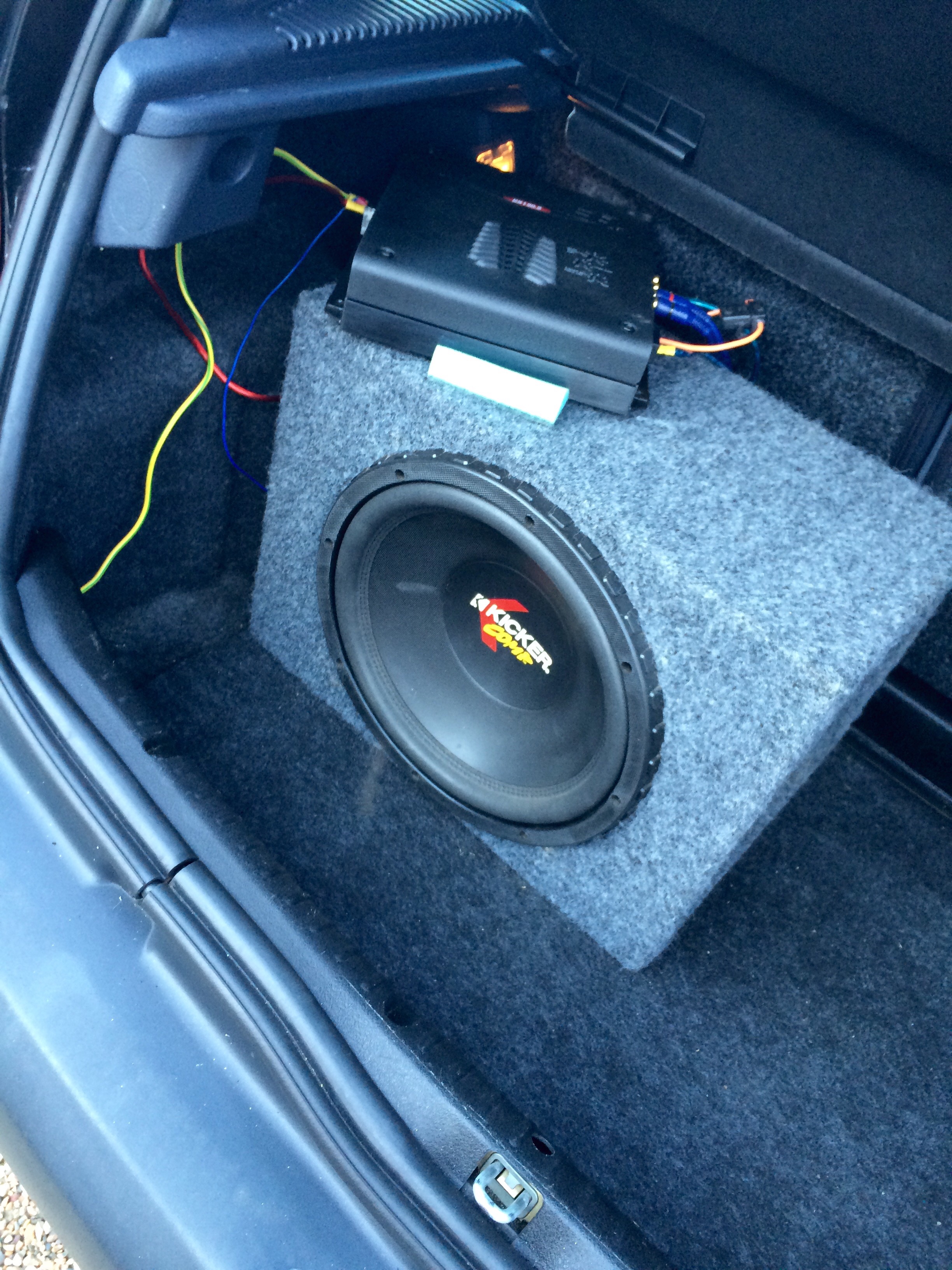

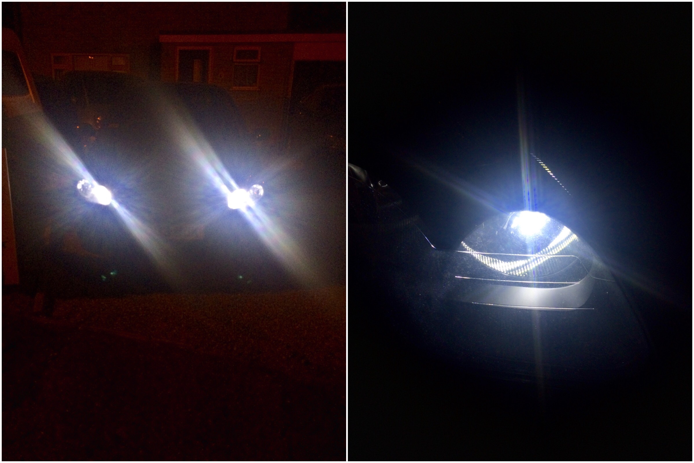

I also installed a new headunit and subwoofer while I was there, subwoofer was a fiver from my cousin, nice addition to any sound system imo.

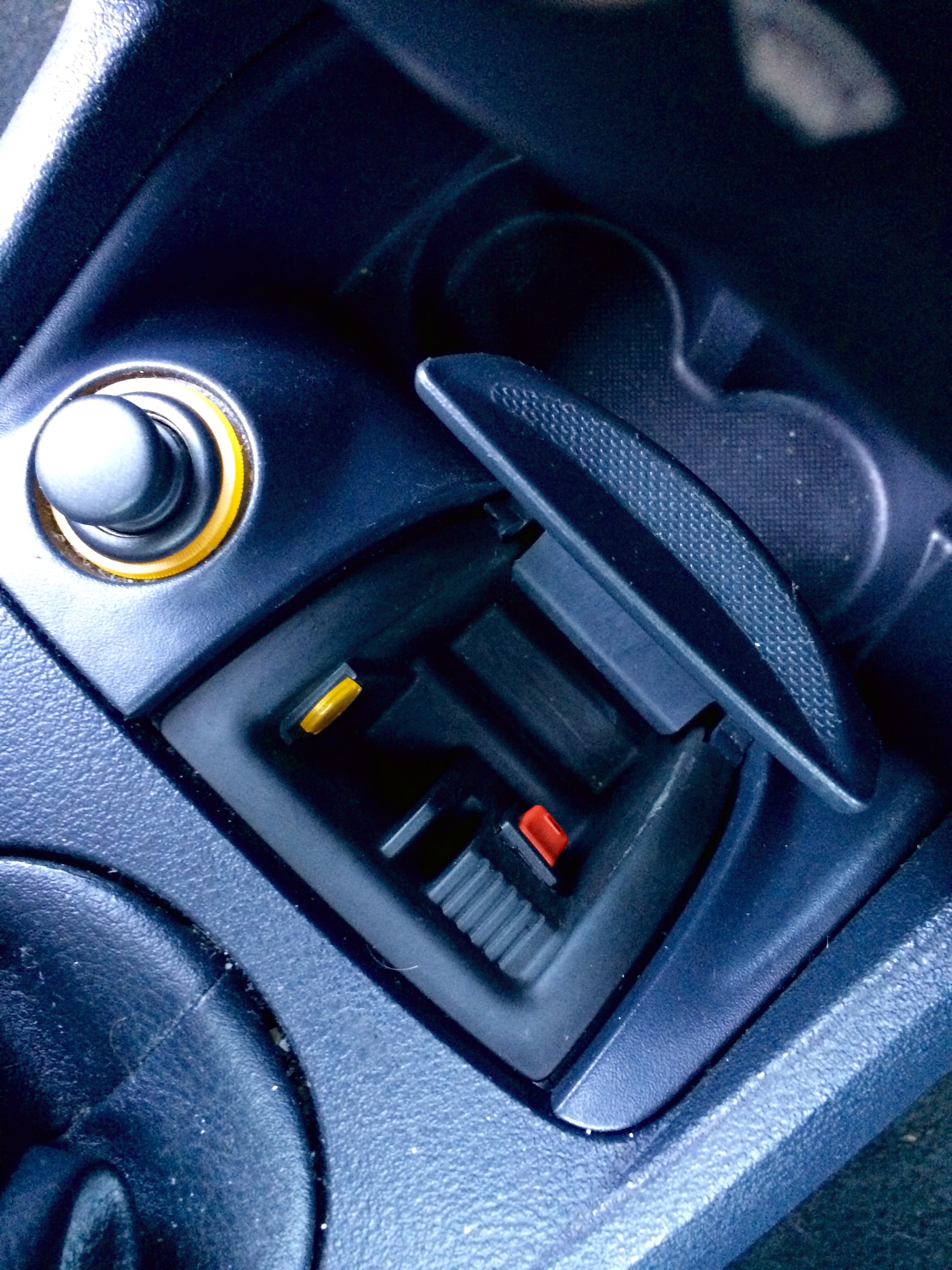

Now I know this mod is very chavy and many of you won't like it, but it was simple+free so thought why not. I installed blue led's in footwells that run of a separate tiny battery, I wired a switch next to the cigarette lighter so can be switched off or on whenever I like.
It's the best of both worlds really, it's all hidden and can't be switched on/off whenever. For when the chav you get come along that says you should get some lights for footwells I can switch them on and when they're off and the dislikes will come along and they'll say I'm glad you didn't install led's in the footwells, (because it's all hidden) so win win. I had forgotten they were there last week.

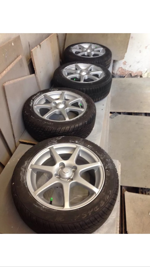

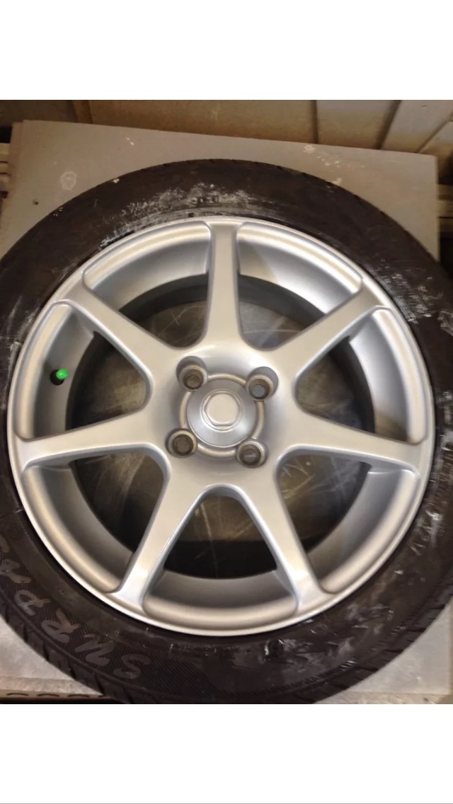

I wasn't happy with the standard alloys so I set about looking for some used ones on the cheap In a local area, that's a difficult task I know. After dwelling on these certain alloys I finally decided to go get them, a lovely little trip to Great Yarmouth here they are, (4 great tyres, 2 are new) £80 was decent I thought.
The plan was to refurb them myself, couldn't afford powder coating them, I know they aren't everyone's cup of tea, but I was happy with them.
All loaded in Clio, looking back at these pictures they actually look quite smart!

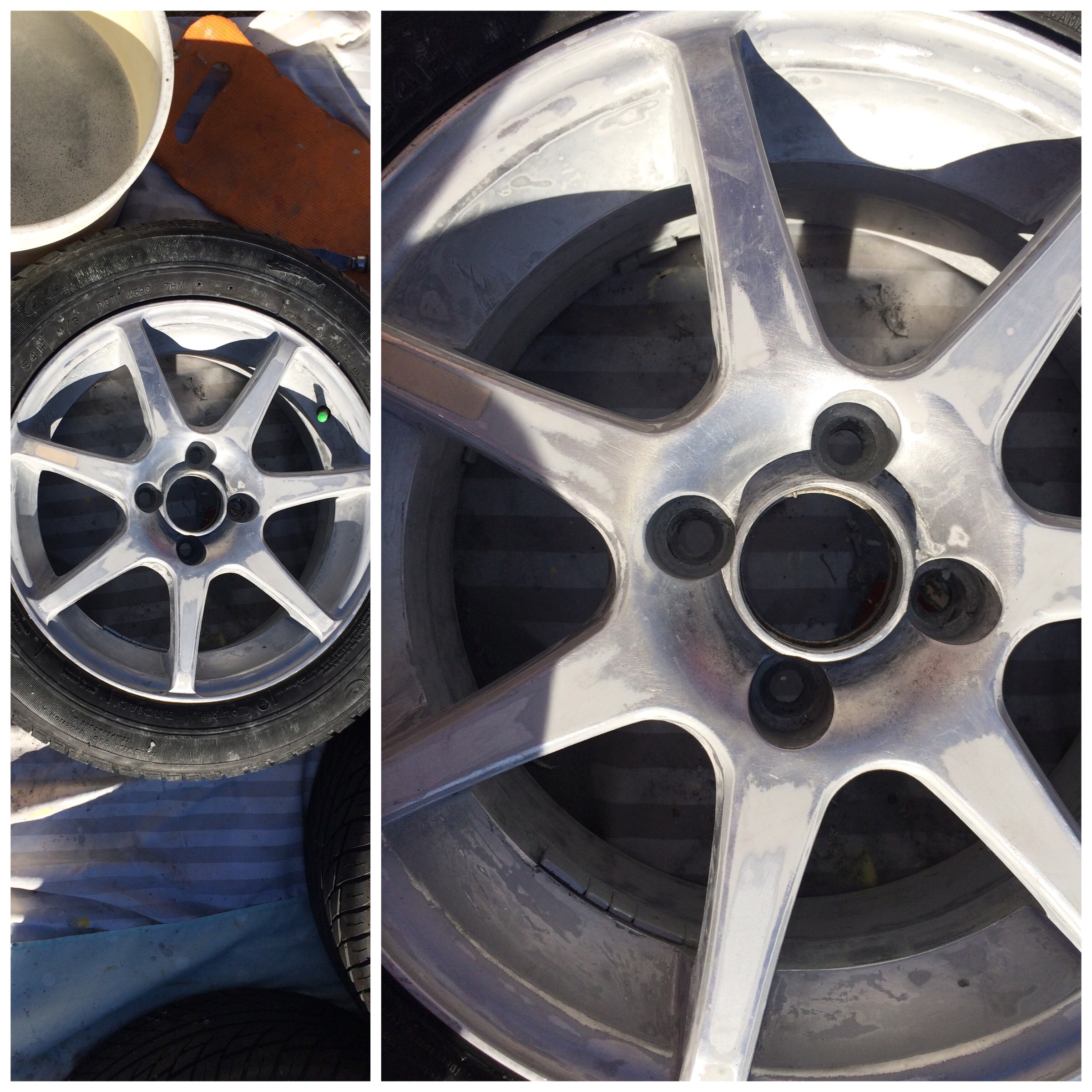

After seeing a horrible collision on the way home I then loaded them in the garage ready to start working on them the next day.

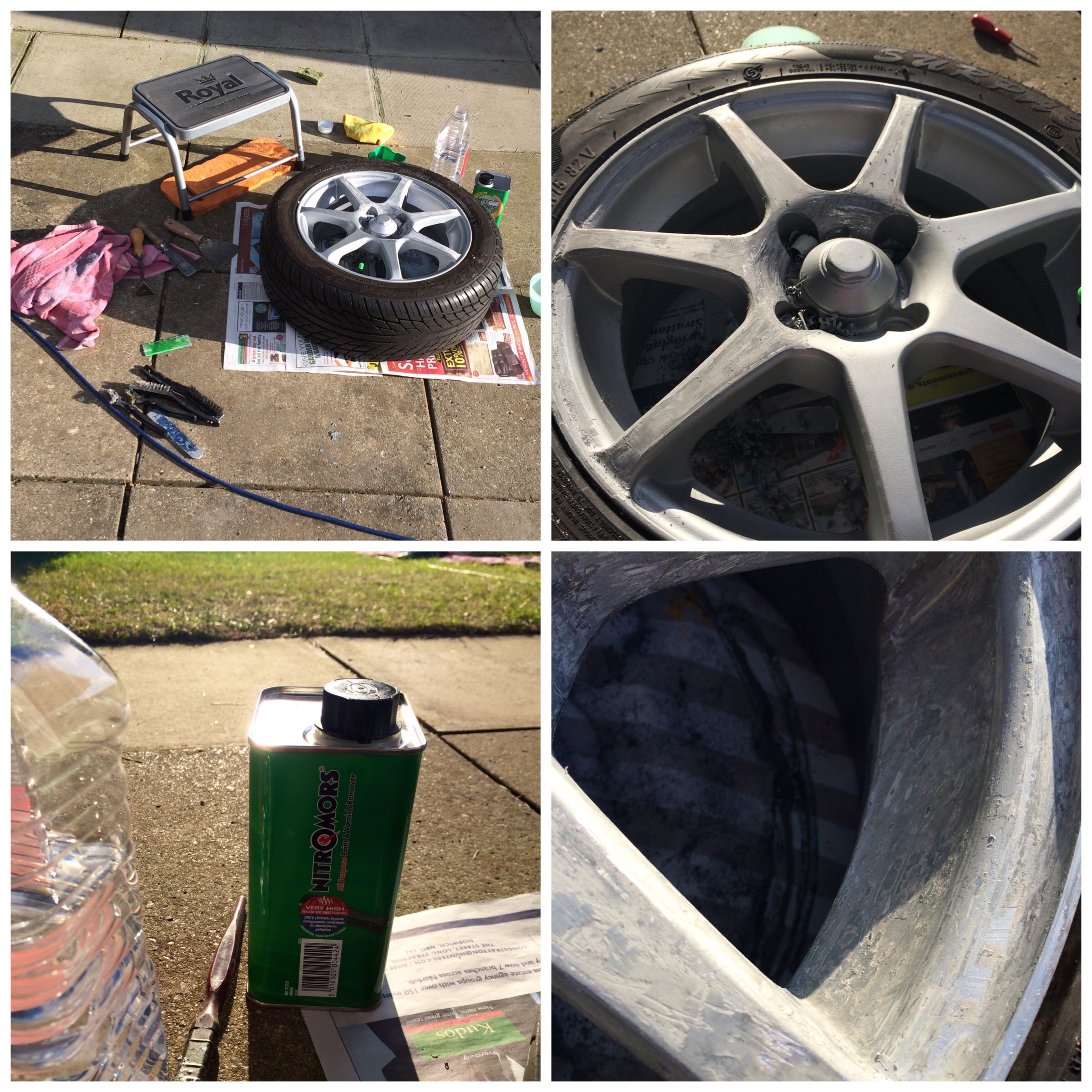

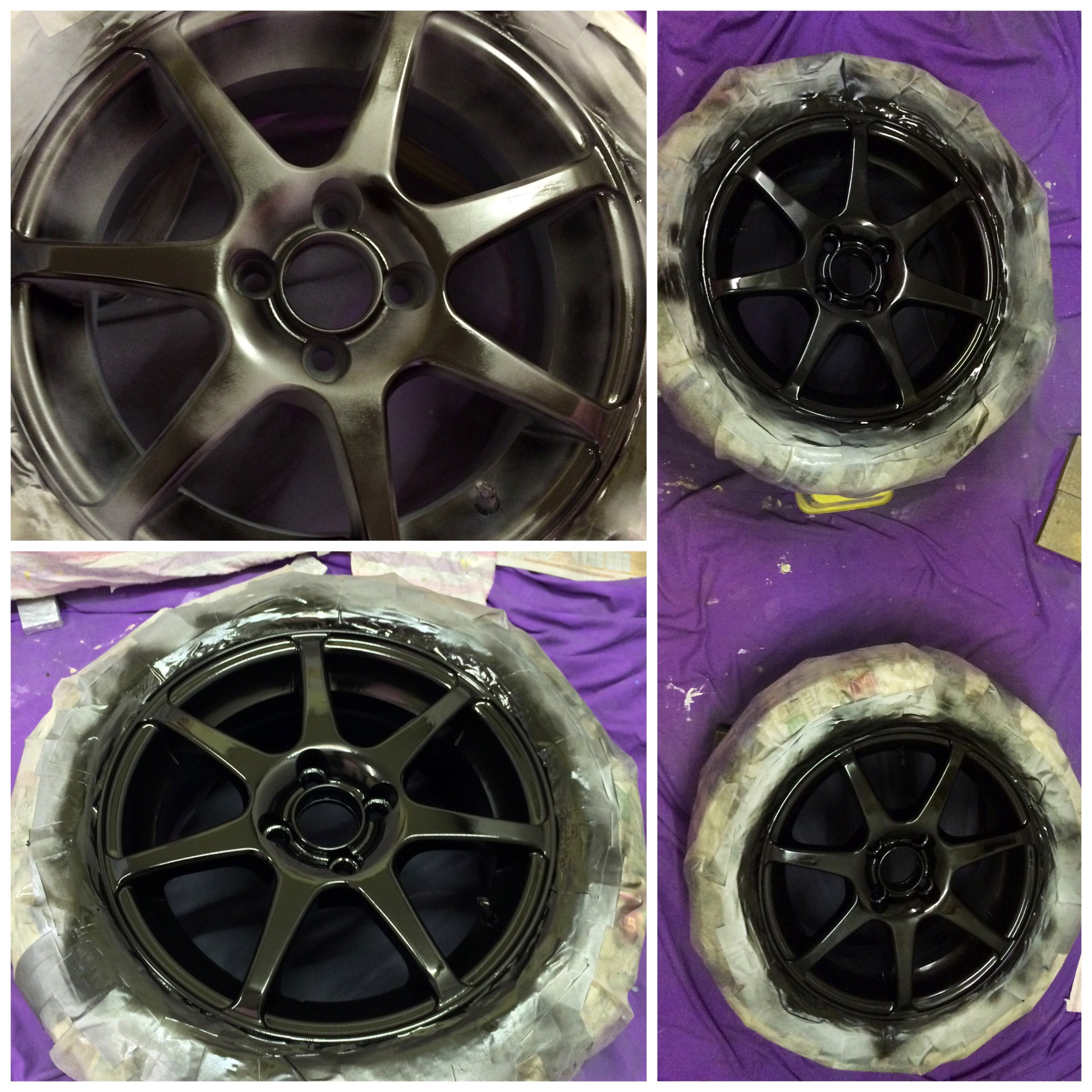

I had the paint, sand paper, paint stripping tools and a spray booth all ready. I couldn't wait to get started
The paint stripping process had started.
It would say it was roughly 30 minutes before the swearing started Getting the paint off was an absolute nightmare, even nitromors would've needed a tin a wheel. Whoever done these before done a really good job, the paint was layered heavily. This took the majority of the time I wanted to get it to a bare alloy ish for the painting.

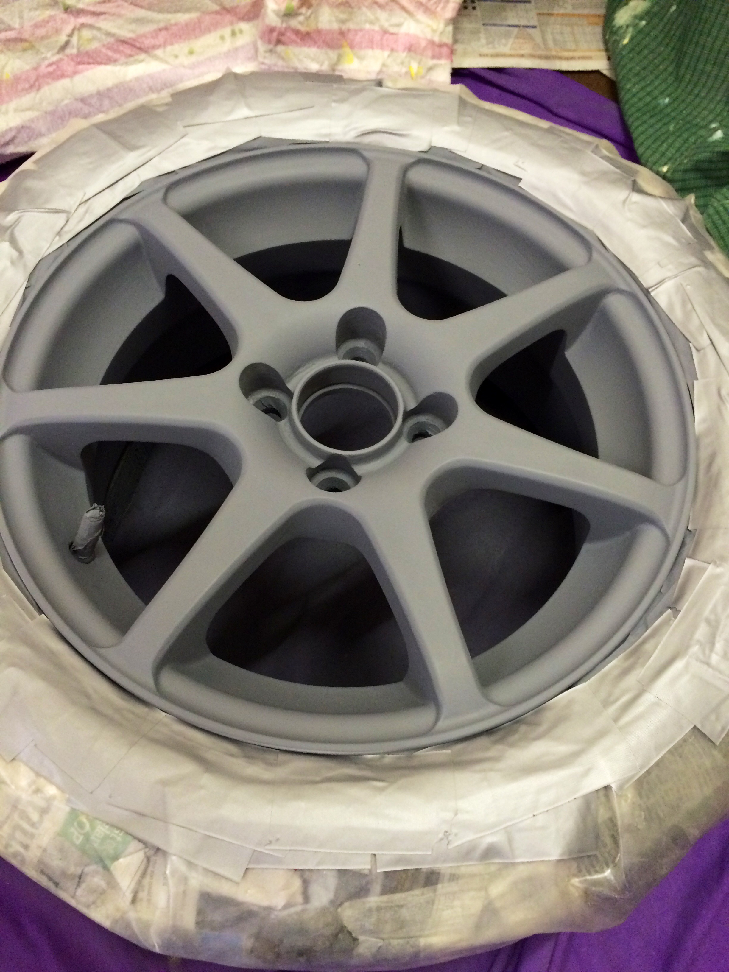

2 of the wheels were ready for painting, obviously I took the weights off, degreased the surface and and masked the tyre. I wanted to do 2 by 2 because they're wasn't enough room in my garage to do all 4 at once. Plus they could be drying while I take the paint off the old ones, erghhh makes me cringe with the thought of it these are the paints I used, good ole halfrauds, I was satisfied because of my budget.
I'm not going to go into the details as this isn't a 'how to' thread haha

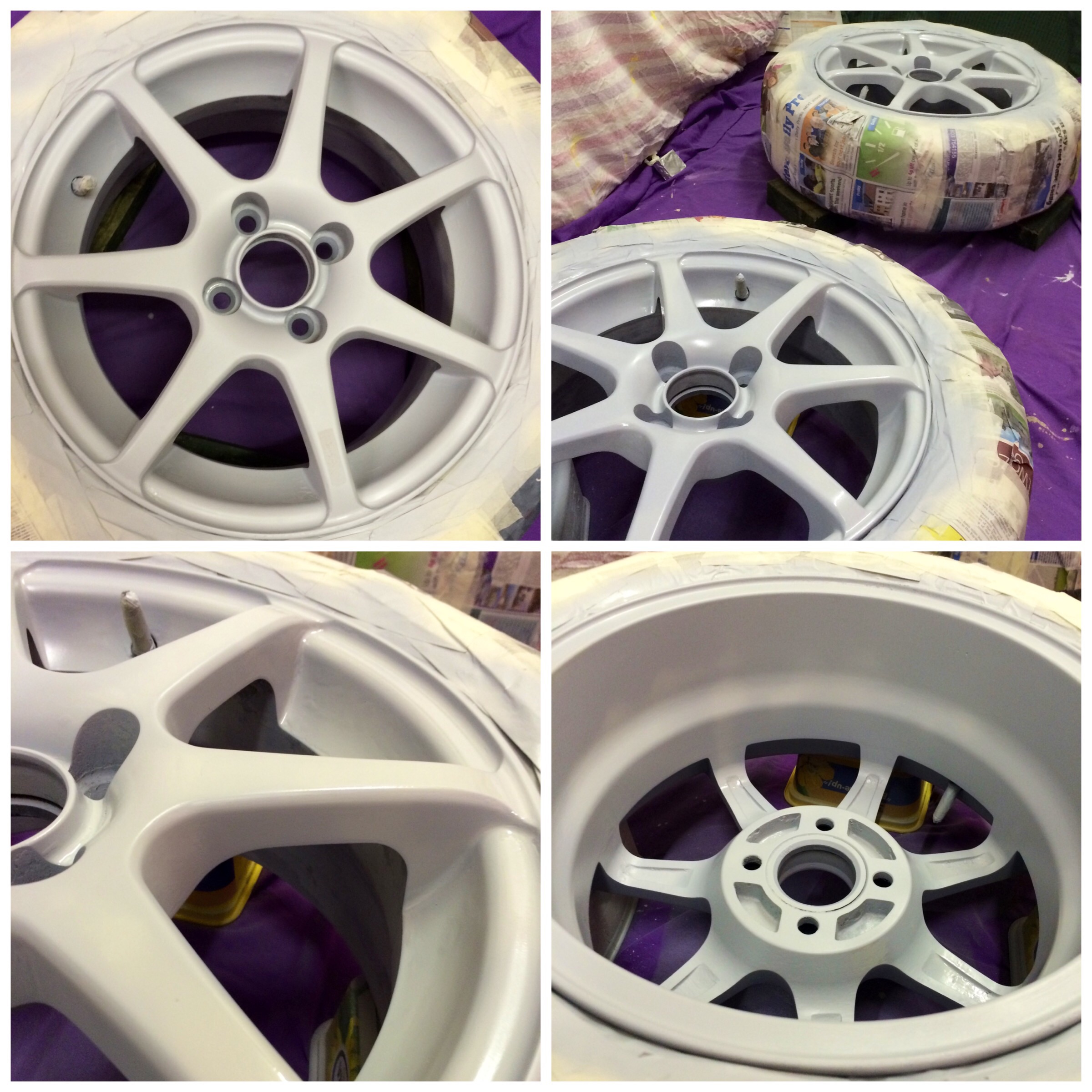

Several coats of the Etch Primer was applied
Then normal primer was applied

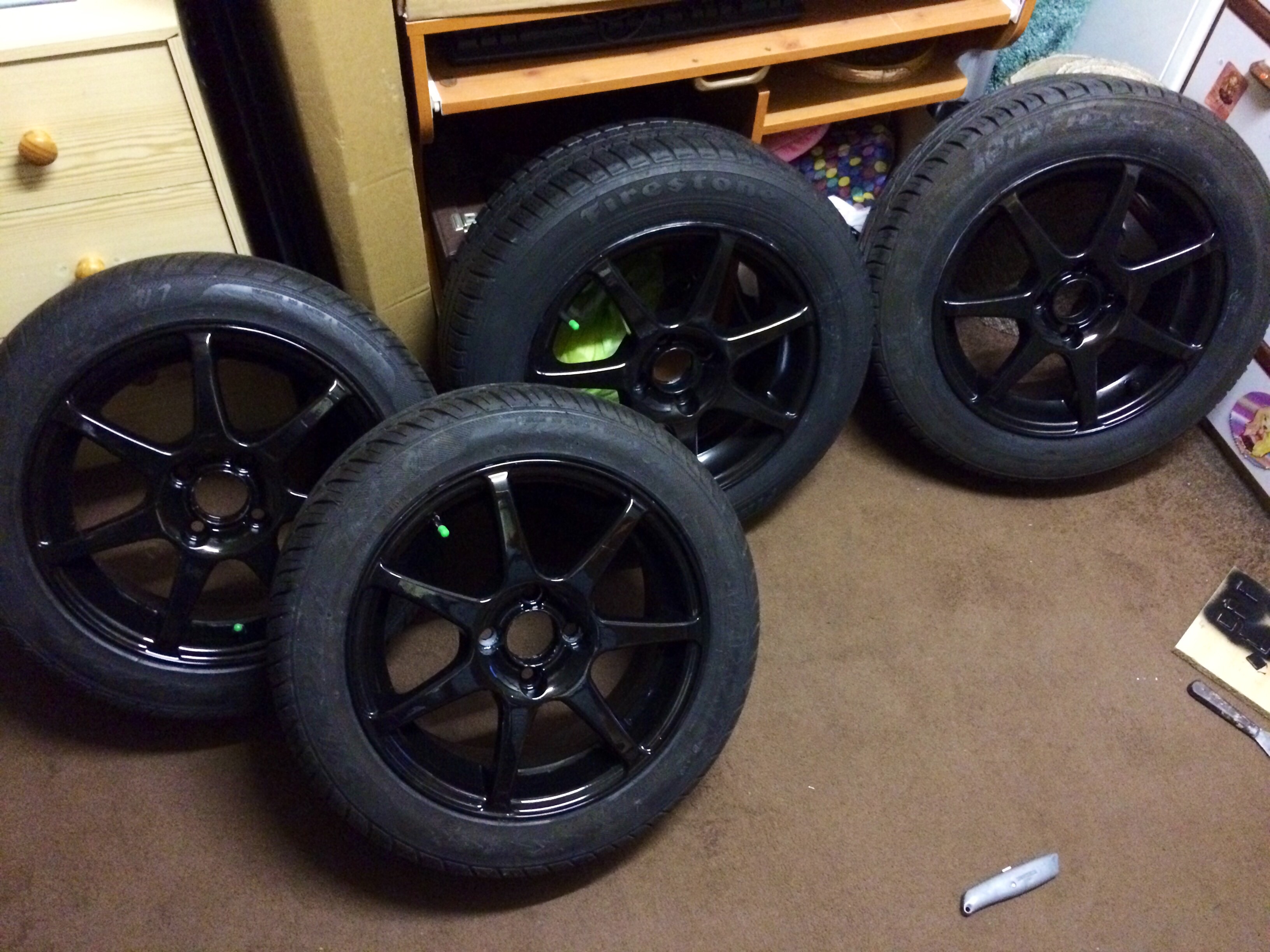

Then gloss black and lacquered. Lacquer was a right pain in the arse, had to be the right temperate to be applied.

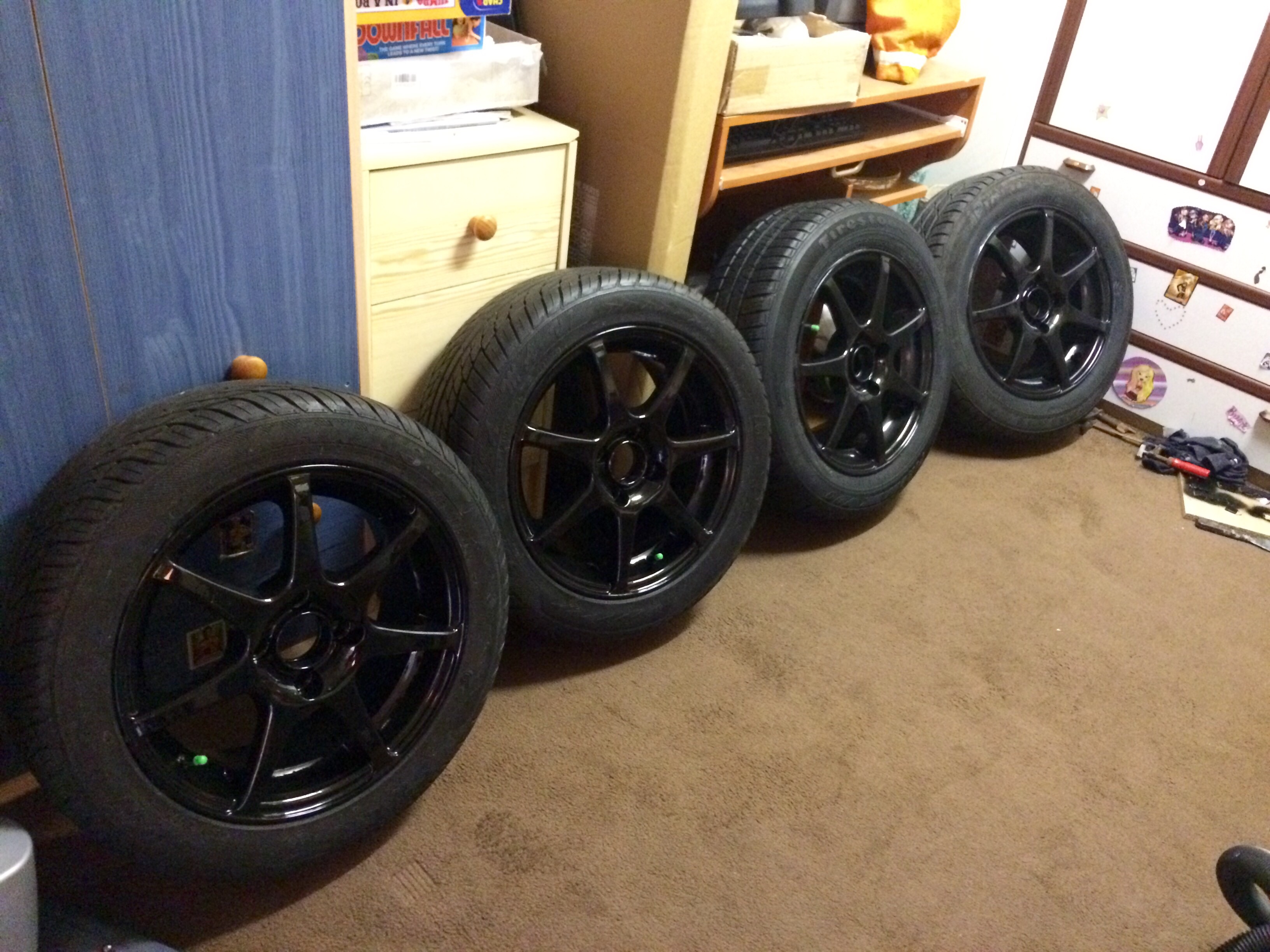

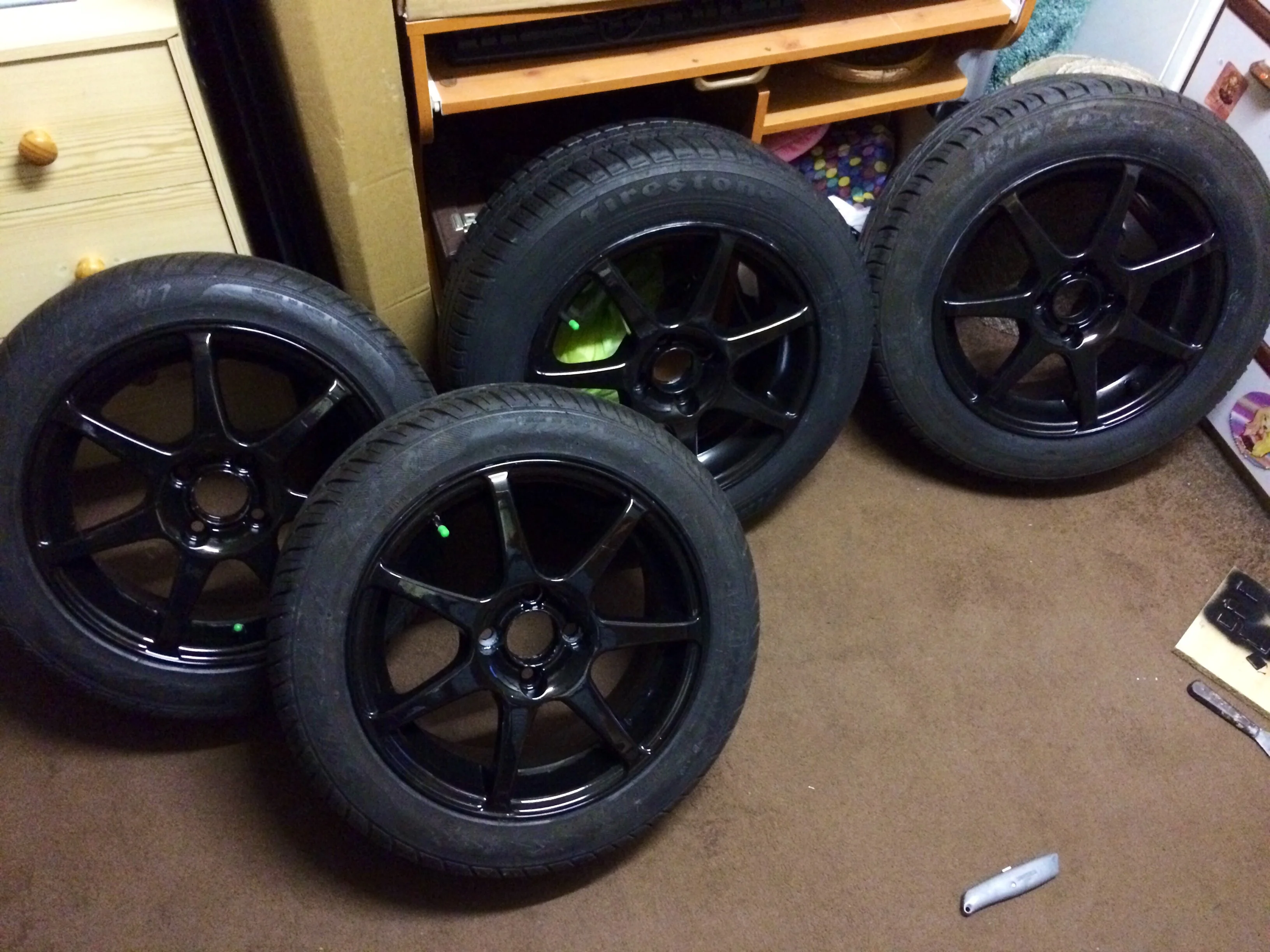

I was very pleased with how they were looking, the same process was applied to the other 2 wheels. This is how all 4 looked
It was such a big relief finishing all the wheels, no more sanding, phew I was very happy with how they looked, I'm not a fan of the sport wheels or anything just if anyone suggests them in the future. With all 4 wheels left to harden for 2 weeks before being balanced I decided to turn my attention back to the car, colour coding, drums and calipers were on the cards to be sorted.

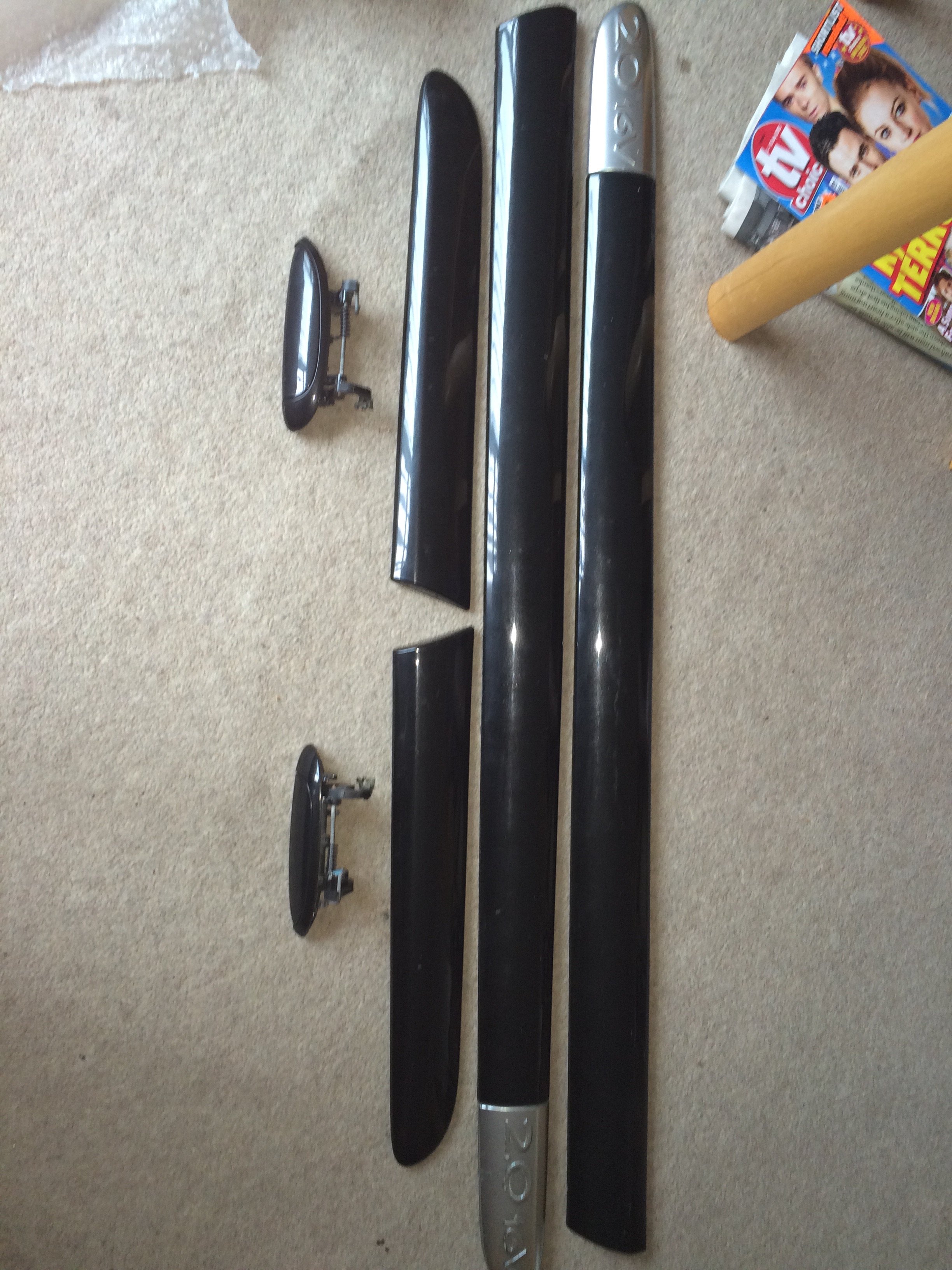

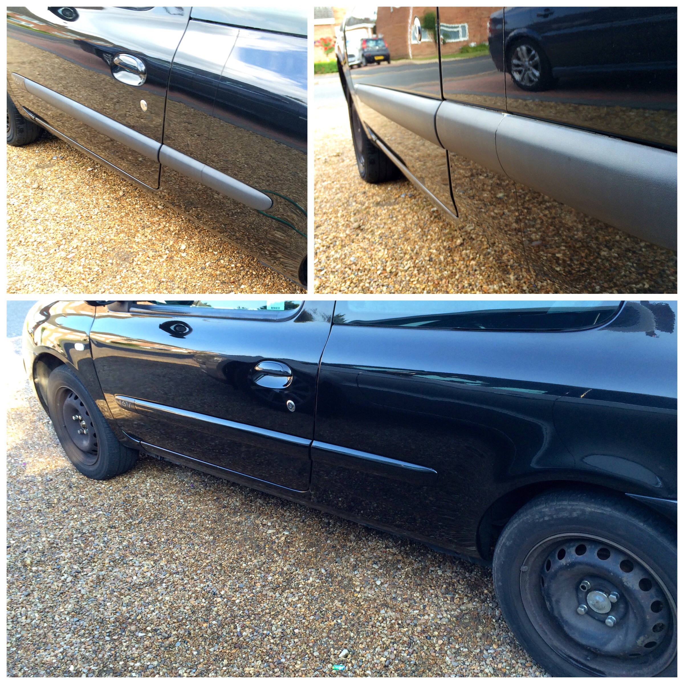

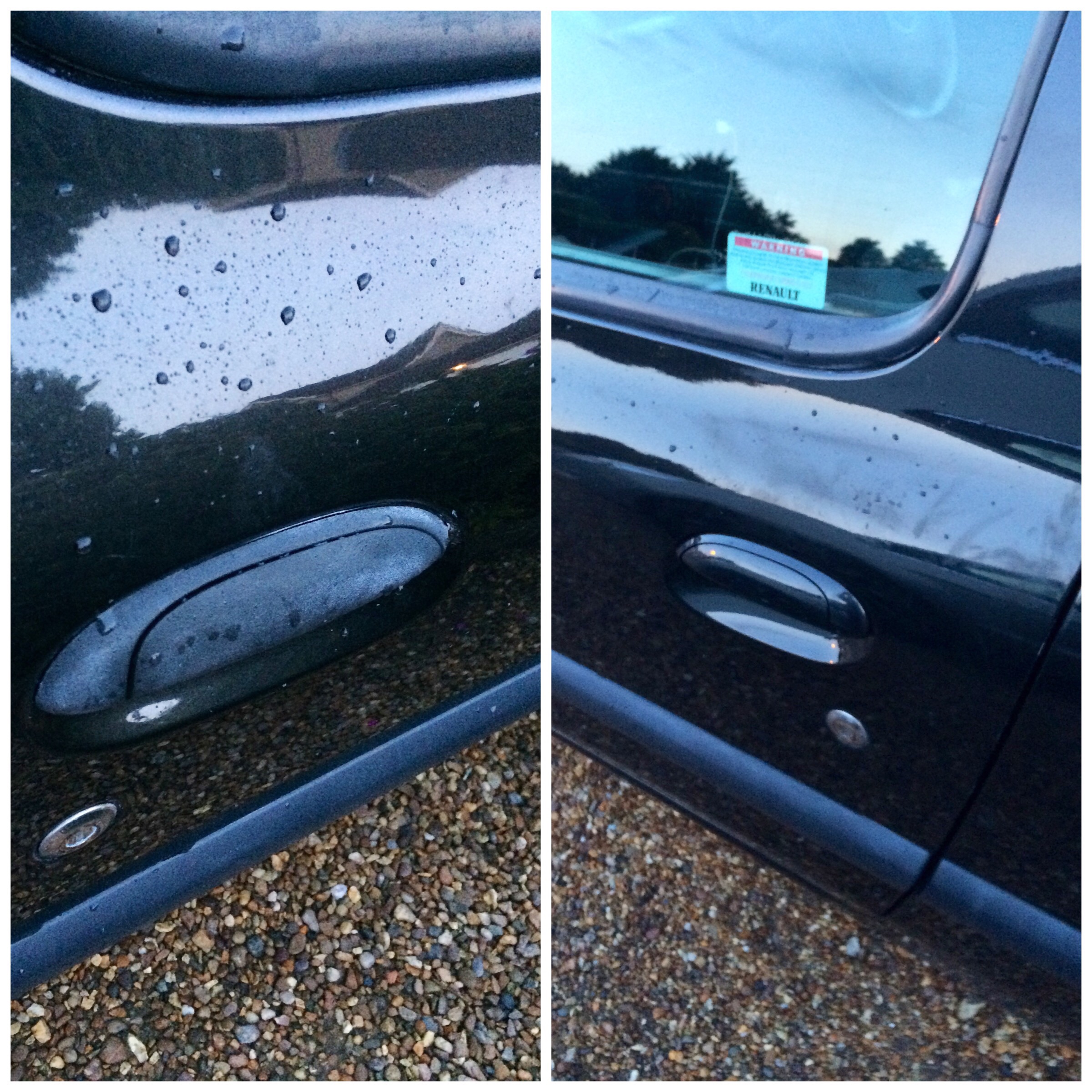

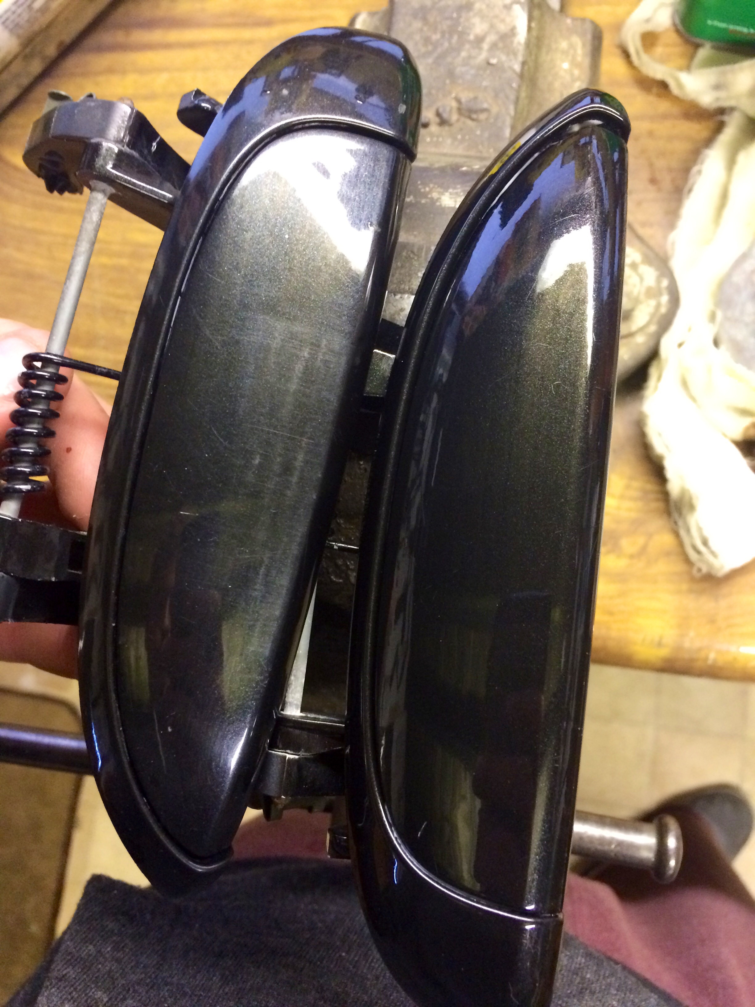

So while the wheels were hardening I decided to invest in some colour coded side strips and handles off a 172 sport instead of trying to do them myself, £25 was a fair price I thought! They arrived very quick and packaged well
The strips and handles were a little dull and the painted needed a good polish to bring the colour up, yet again I used the Ultimate Compound which brought them up nicely
That picture doesn't really do it justice but it's a massive improvement. Old ones off, new ones on
I thought the handles were going to be difficult to change but was actually very easy, anyone that Is planning on doing this and need advice on doing it just drop me a pm, I'll be happy to help
As you can see I changed the bullets, having 2.0 bullets on a 1.2 didn't seem right
Massive improvement, a very simple but effective mod! Makes a massive difference on a black Clio!

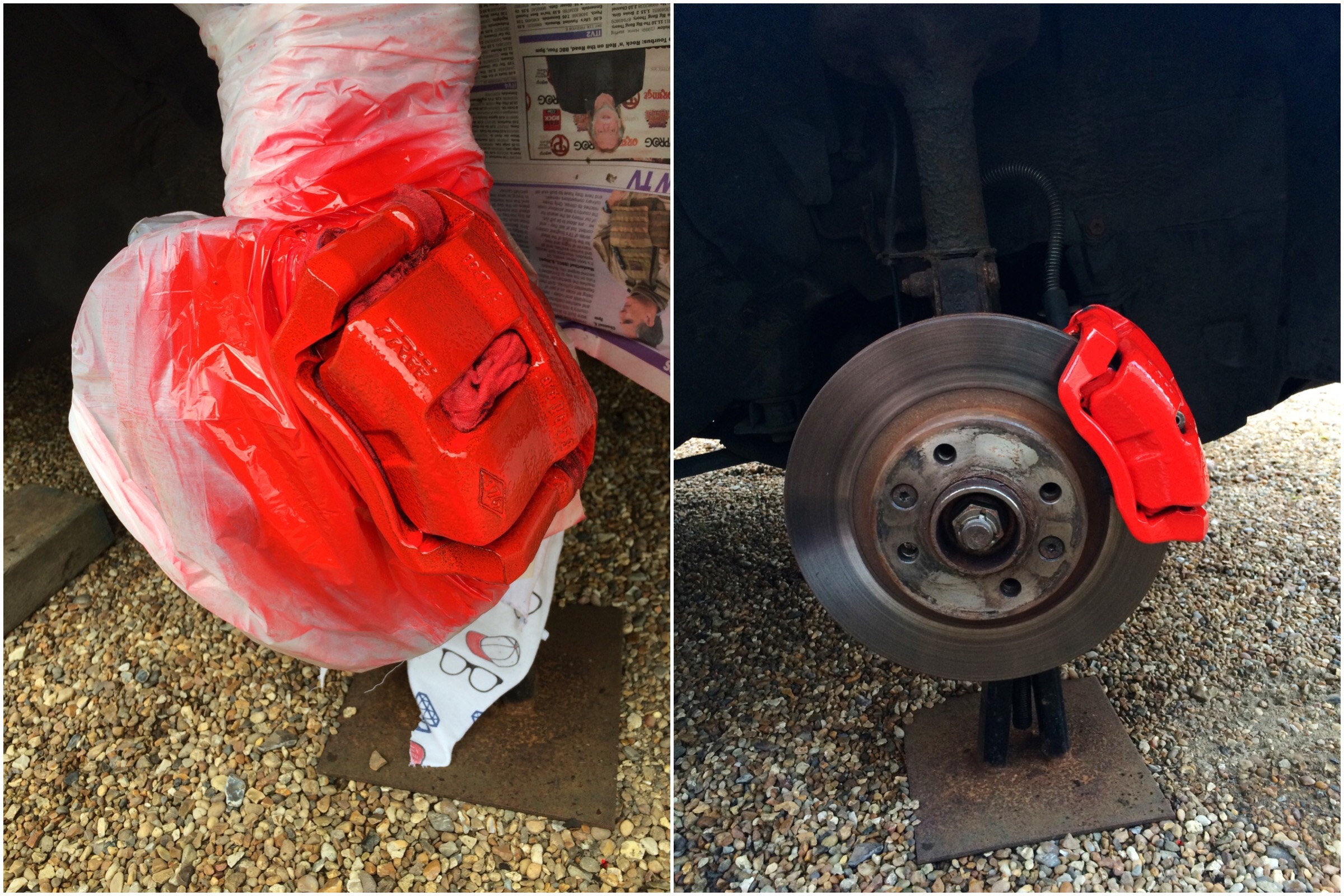

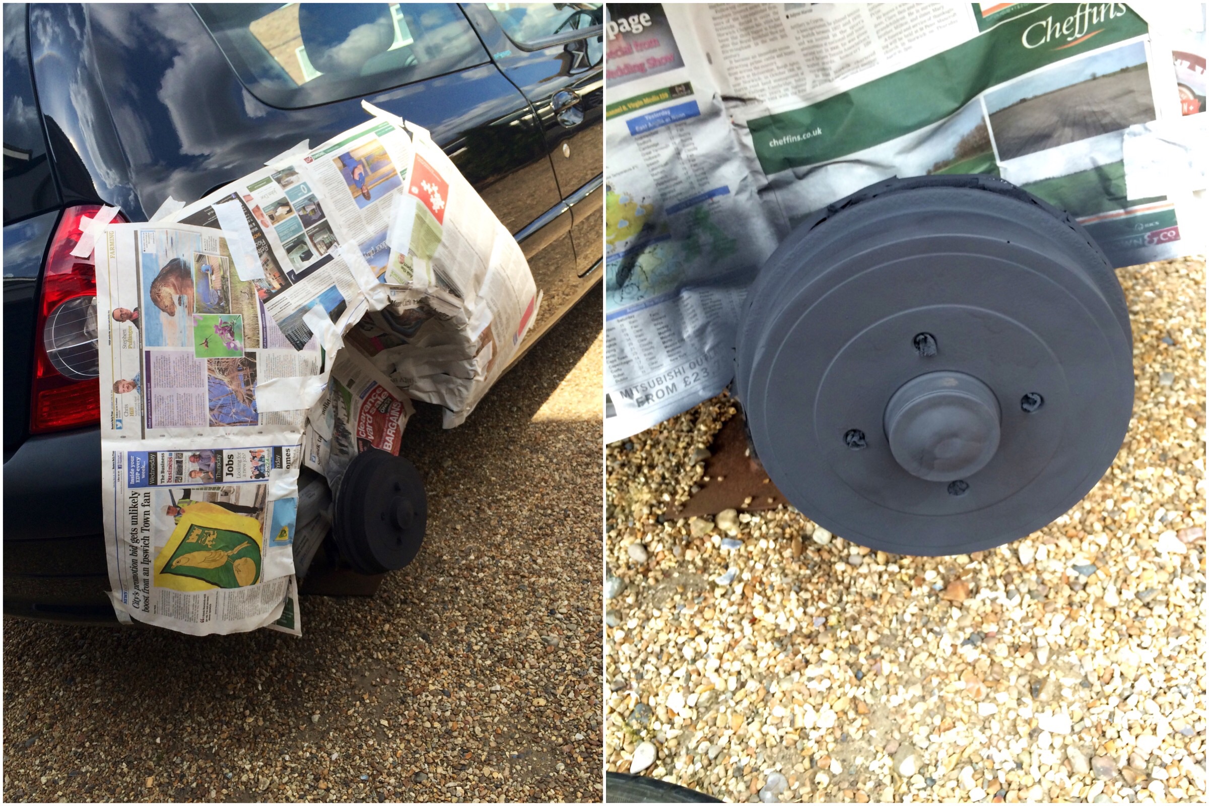

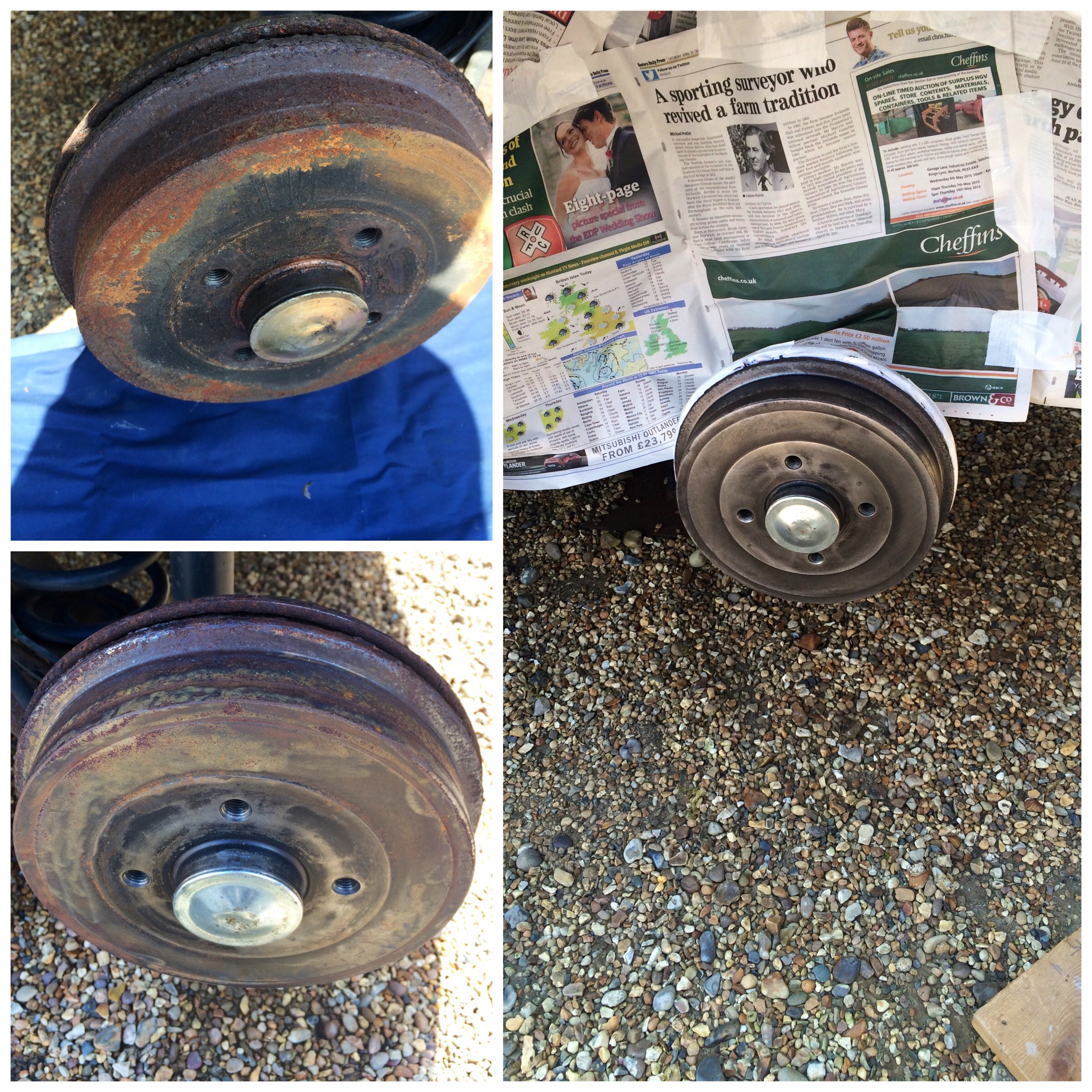

My drums and calipers were in desperate need of attention! I haven't got a before picture of the calipers I forgot, I'm terribly sorry chaps but trust me they were bad
All sanded and ready for the paint
The 'High Temperature Paint' appeared very black when applied but it dried up a dark grey, I wasn't too fussed just needed to tidy them up, but I actually really like the colour! Must better than the rust! Now for the calipers
I am very impressed with this paint too, especially as it's spray can! The red really is as bright as it looks on the picture if you haven't already guessed I like the combination of black&red, whether you like a colour scheme or not I like it they were all finished and all I had to do now was be patient with the alloys

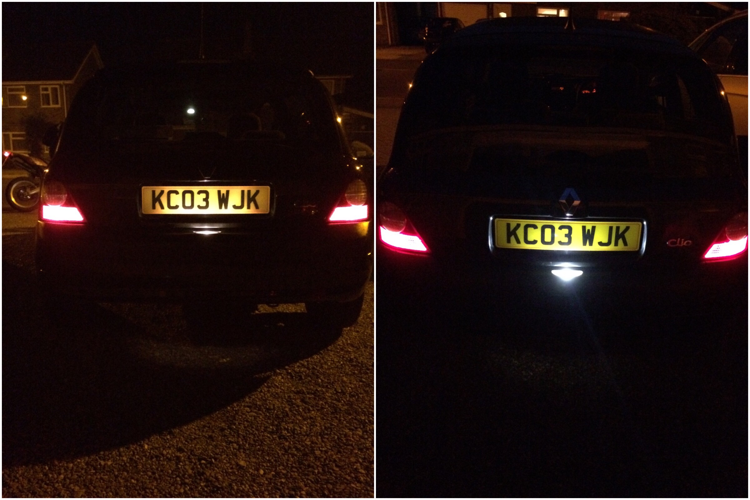

I ordered a new number plate led bulb, this is such a good mod to any car, makes such an improvement. Cheap as chips too!
Strange looking things!
Pictures don't do it justice but it's such a difference.

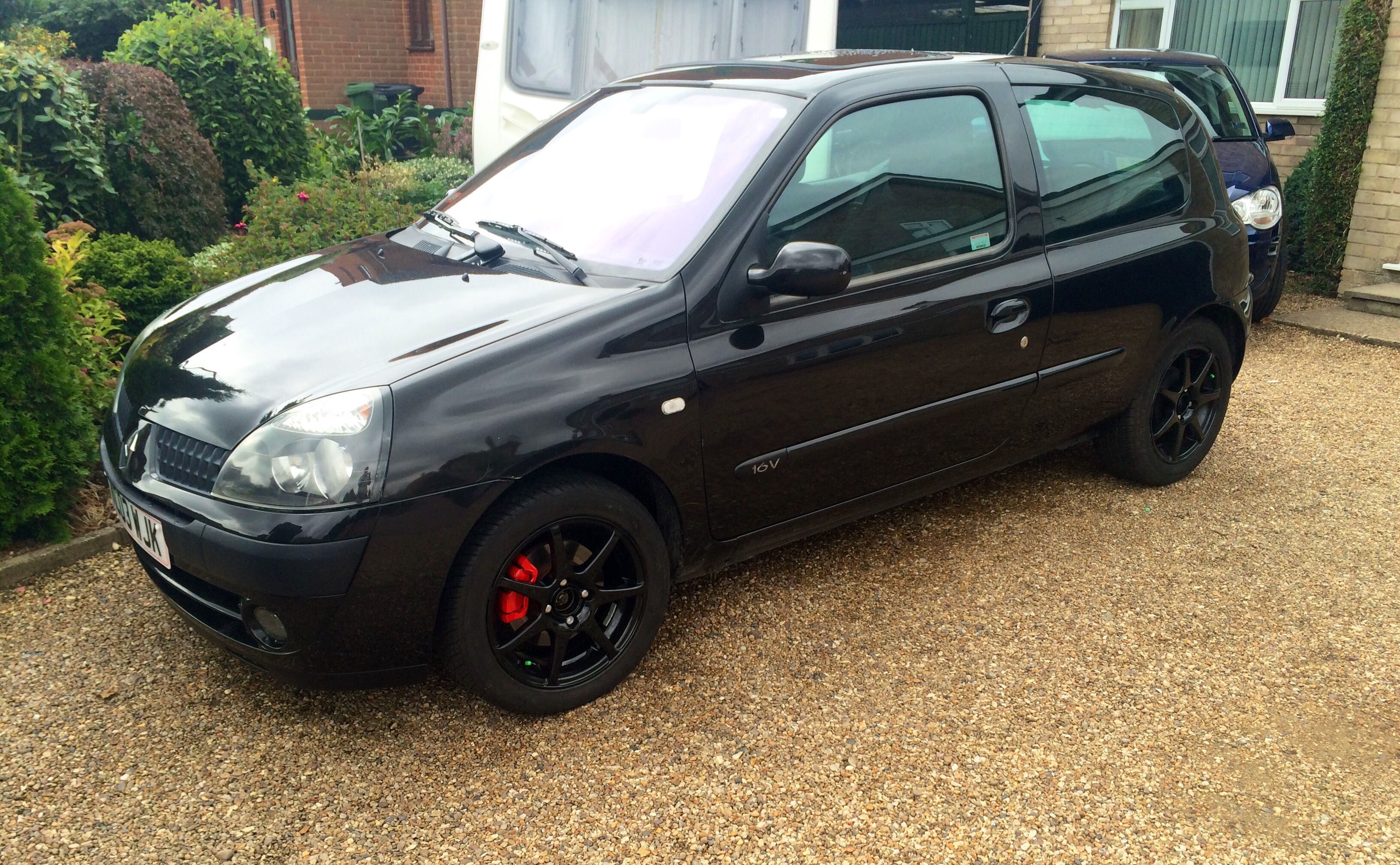

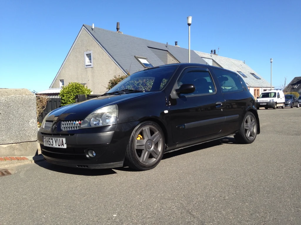

UPDATE:
This has been put back quite a bit as had a few problems and been really really busy. But here is the update. Enjoy

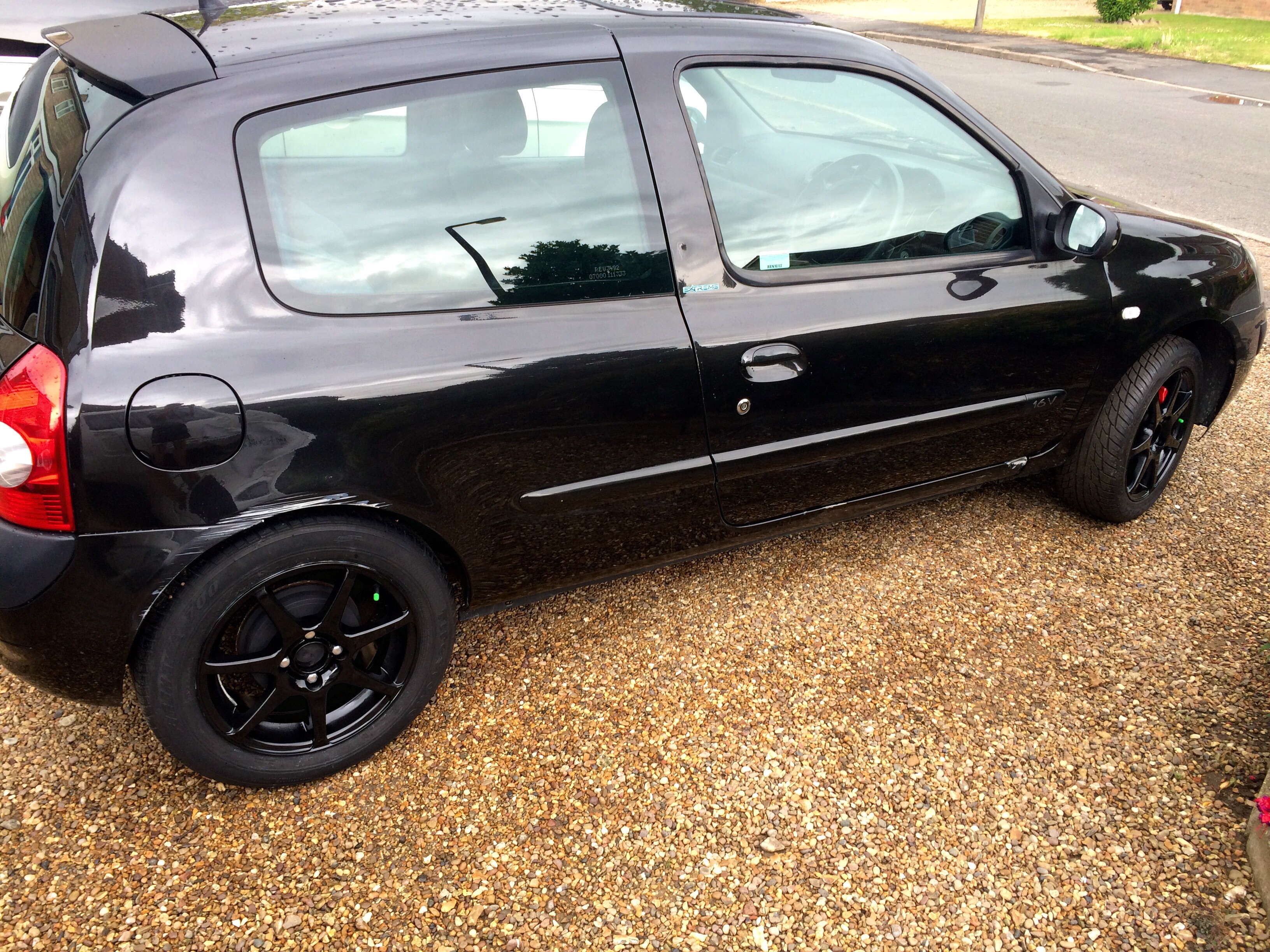

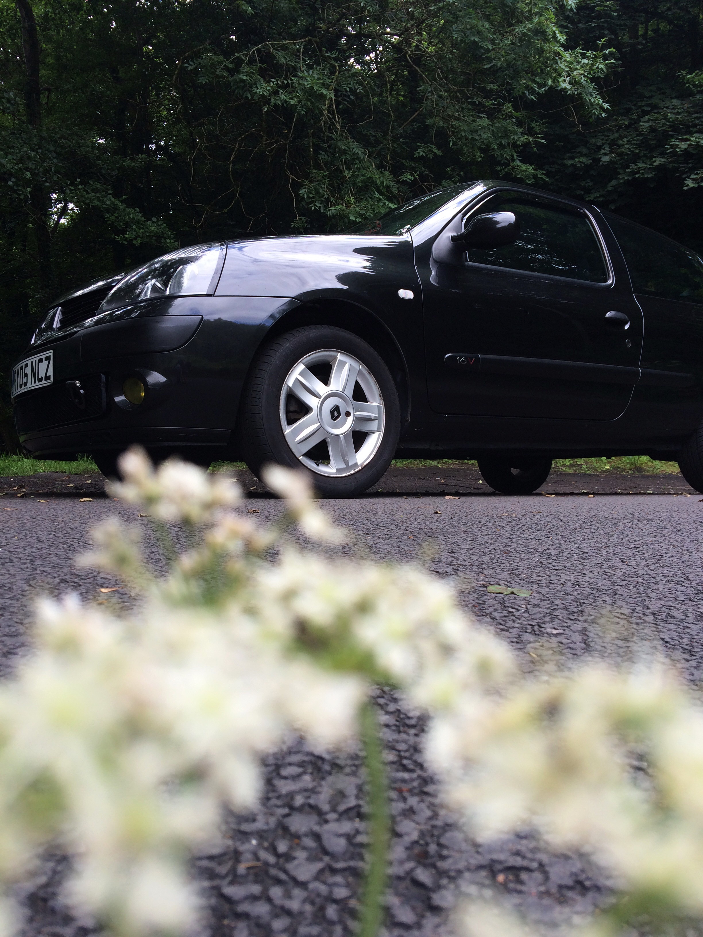

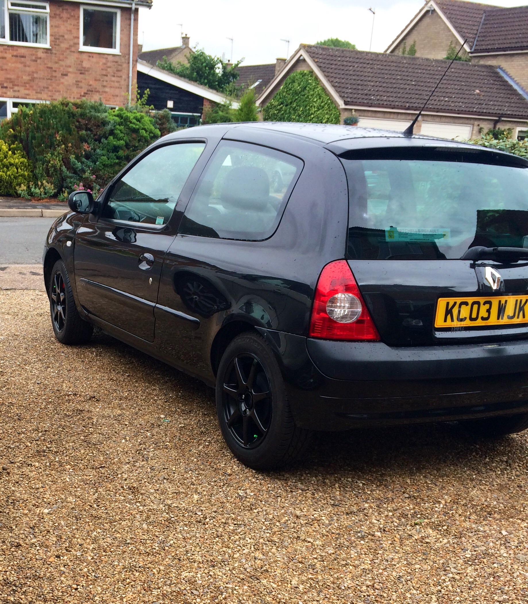

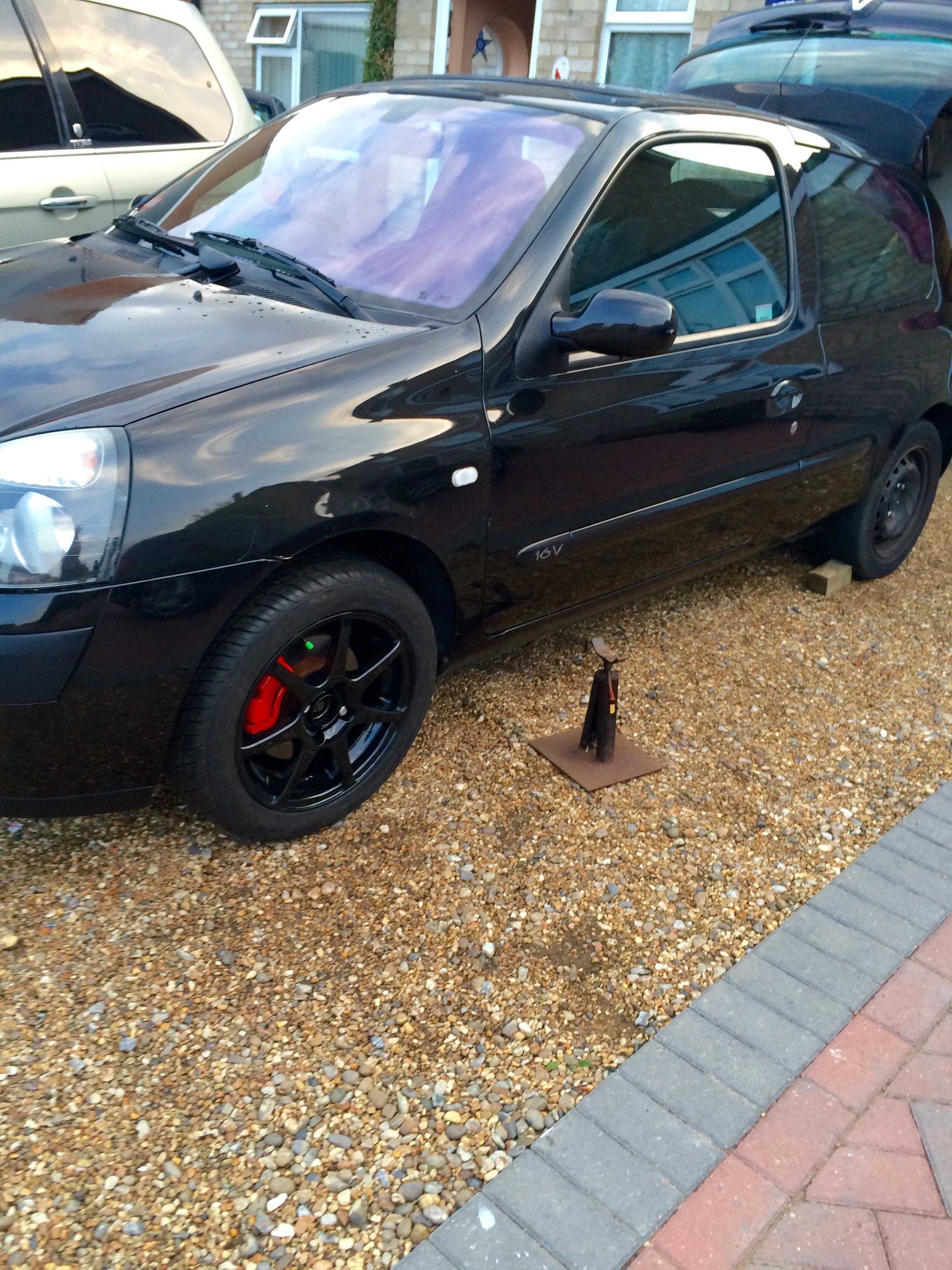

The alloys were finished, balanced and ready to put on the car. Pictures aren't the best but I have taken some nice ones to upload soon
Really pleased with how they've come out, totally different from the grey before, was always sceptical about how they were going to look black but I'm really pleased with them hope you all like them too now to put them on the car!
Really pleased with how she's looking! Hope you like what I've done so far! There's plenty more to come! Thanks for looking. I'll try get some more updates in this week, last week was a bit hectic! Any tips or anything all welcome!

Nice mate. Look at the old wheels I had on mine, I found there was too much wheel arch showing. It also showed off the pu$$y ass brakes on the front, so the 182 wheels came out :smile:
To be honest, I'd liked your old wheels, if you'd of got them refurbished in black they would've looked great imo, just not a fan of the 182 wheels, which is a shame probably because they seem popular haha. just going to lower it a tad and get spacers I think, have you lowered yours?
They were too big mate, 17"s. Why lower a car then raise it back up lol. Don't do a mod because its popular, do it because you want to :smile:
Mine is lowered, on Eibach Sportlines 40/30

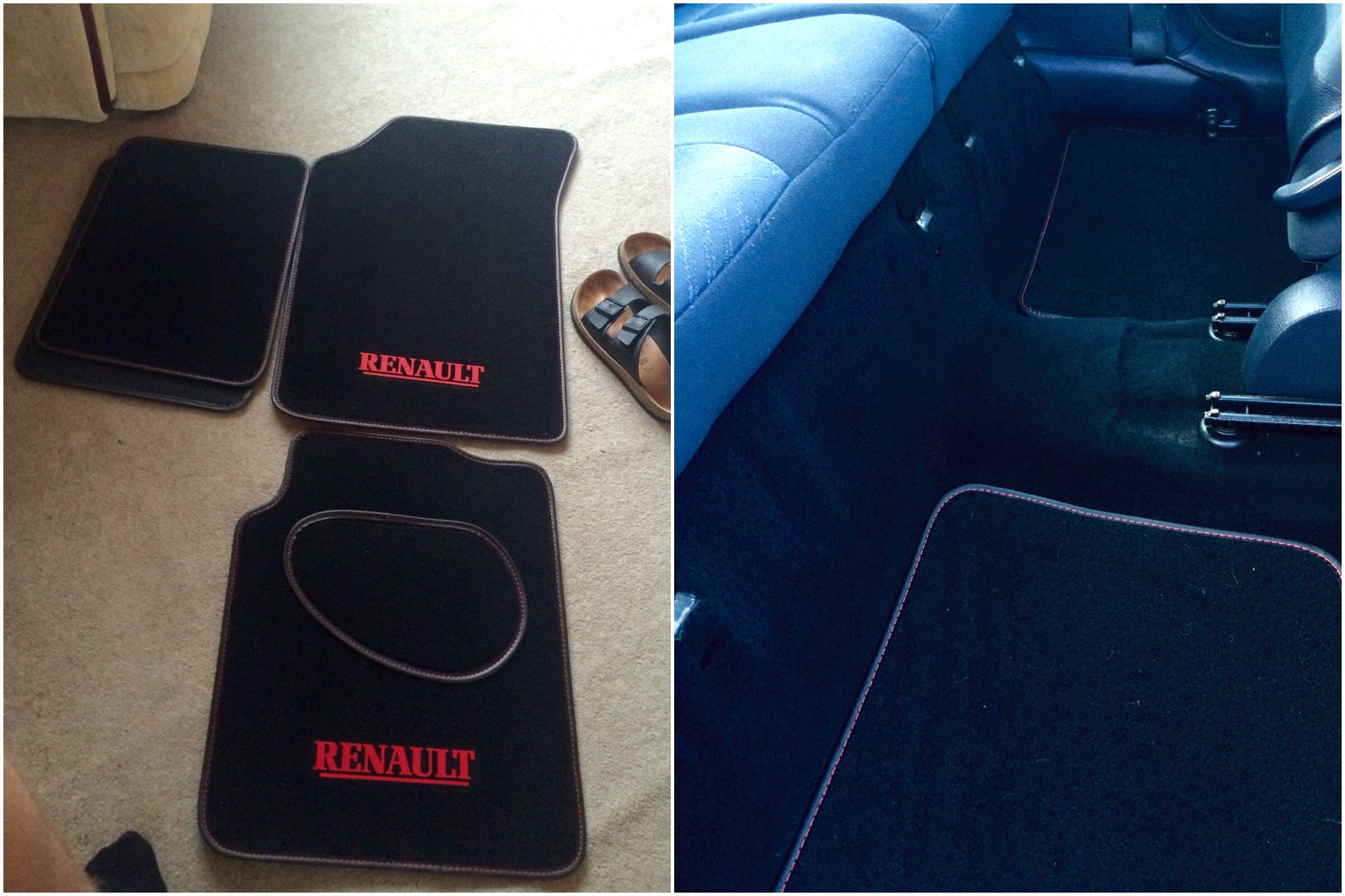

My interior was crying out for some nice mats, so I ordered some off eBay. I though they were going to be cheap and nasty because you never know with eBay but they are brilliant and a good strong material! Here they are
The red black interior scheme was alive! I'm currently on the hunt for some xenons on the cheap, condition doesn't bother me as I'm happy with doing a refurb of them! But in the mean time I fitted some led side lights along with a very bright interior led
Only picture I have of old interior light, but to be honest everyone knows how crappy they are!
