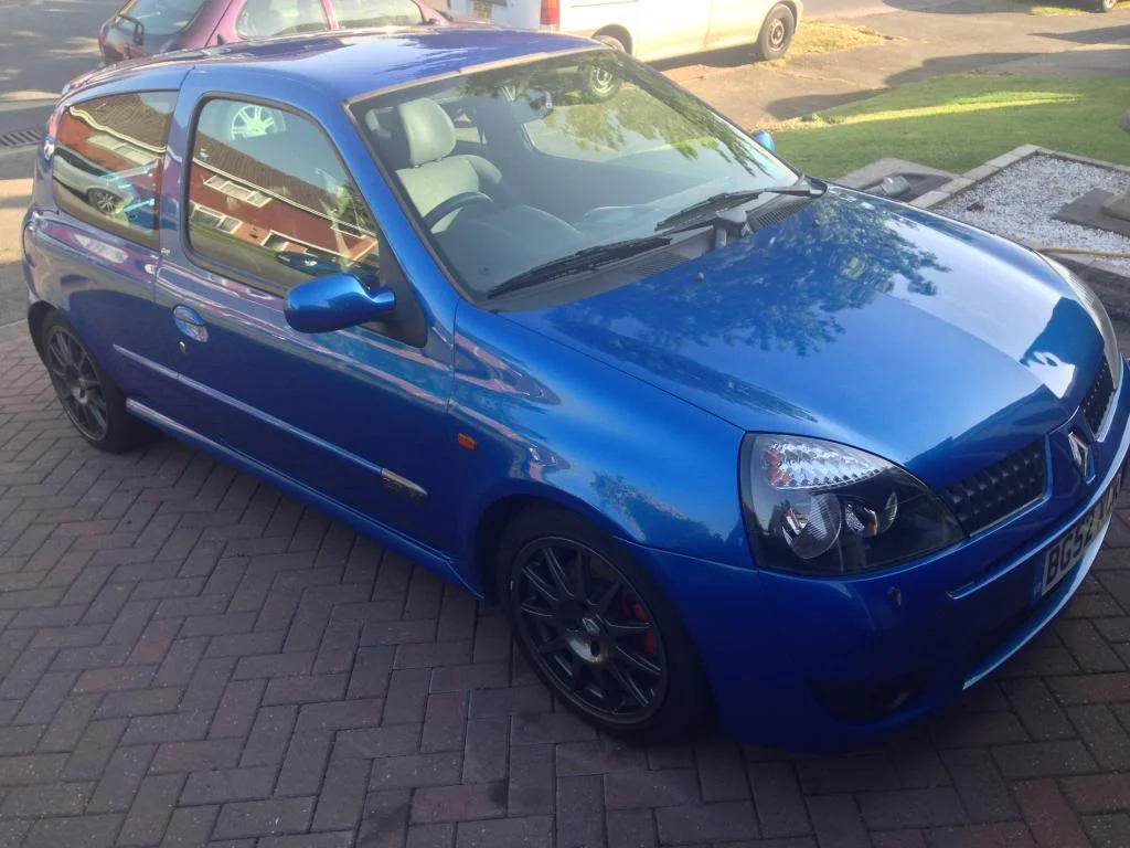

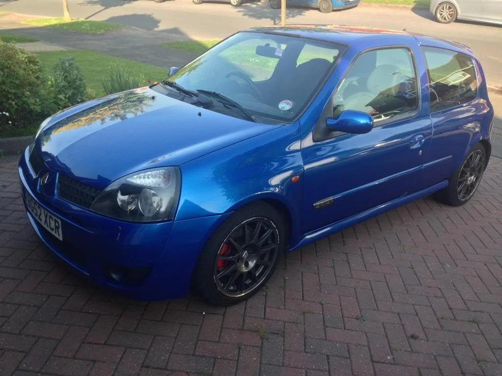

Hi all. I'm new to the French car scene. I stumbled a cross this 172 cup as my previous track car was set on fire on my drive :(
Here it is
So plan is to build it for track/weekend blast and a trip or 2 to the NurburgRing.

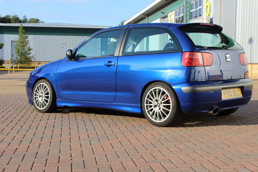

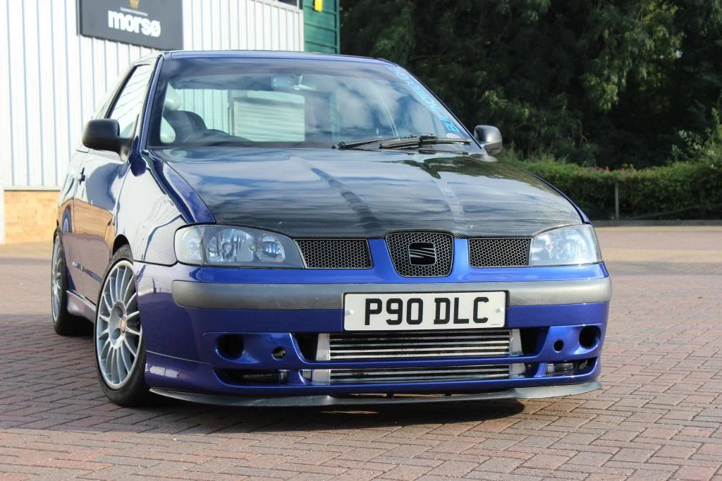

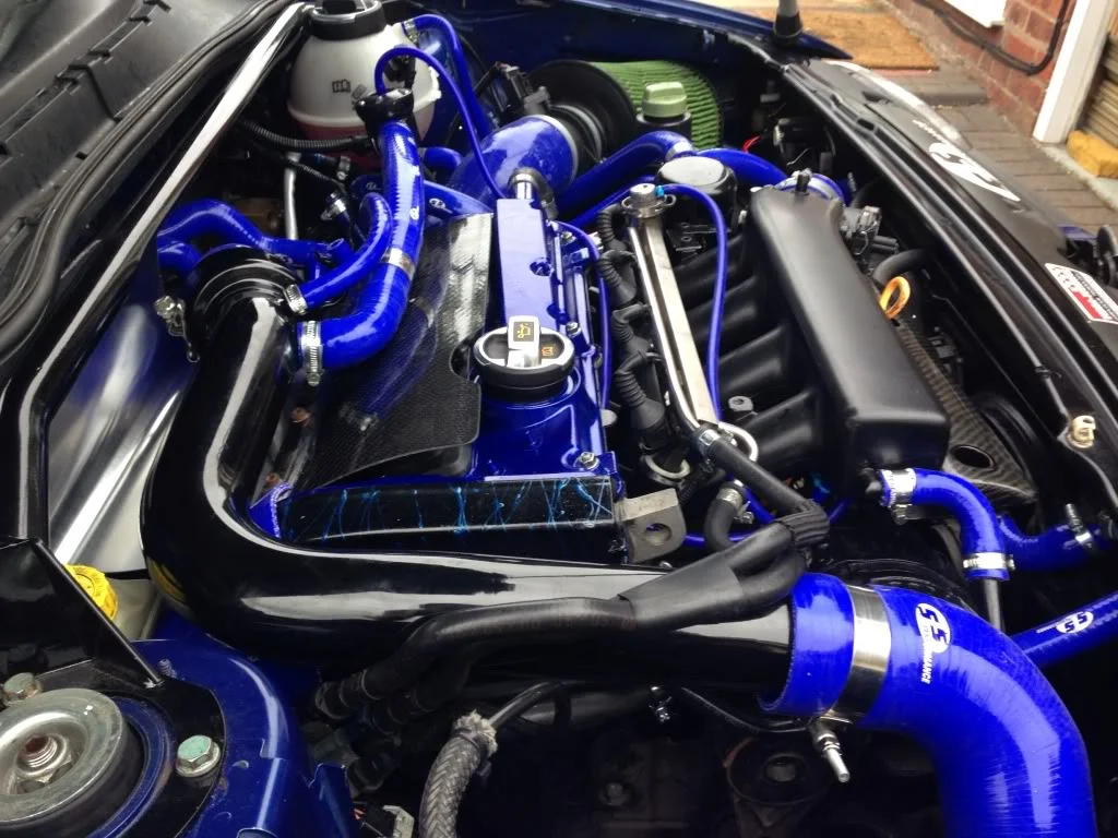

Few pics of my old track toy
quick spec - forged engine 300bhp 310ft, AP racing brakes, B16s, custom wide track, custom manual steering conversion, carbon bonnet, LSD fully stripped.
Plan is to build the clio to better spec, not to worried about the power difference as I love how the clios engine goes. I don't miss the turbo feeling driving the clio as I have this for a daily :)
seat leon cupra K1 2.0l turbo :)

Cool love the Ibiza that was my second Ibiza running K04 :)

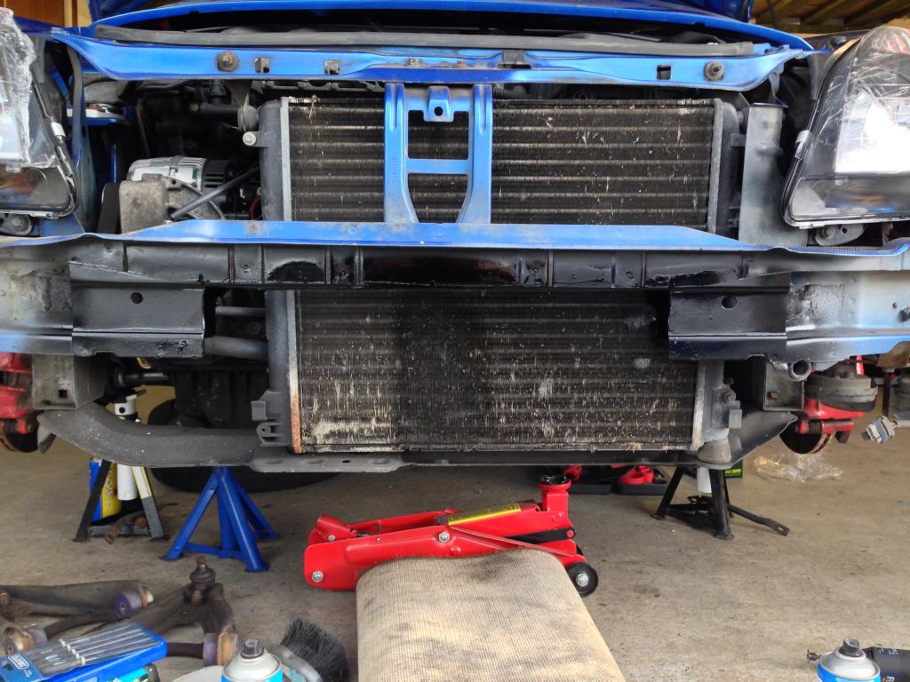

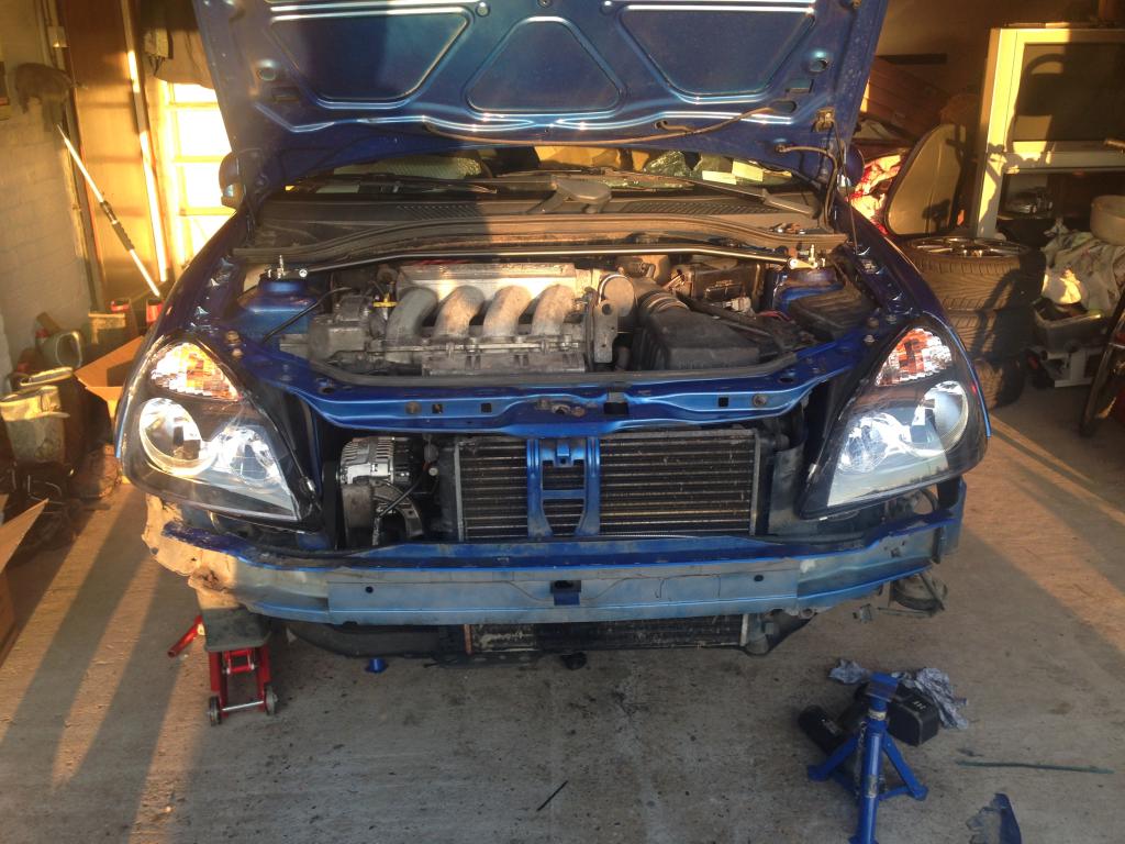

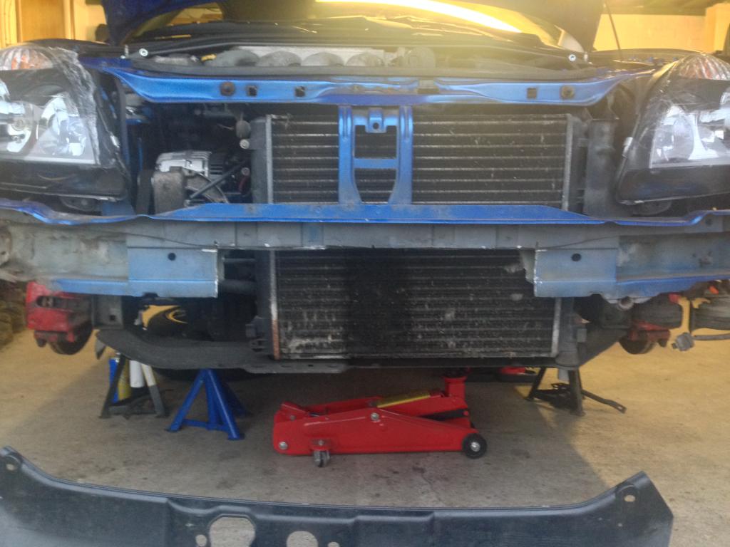

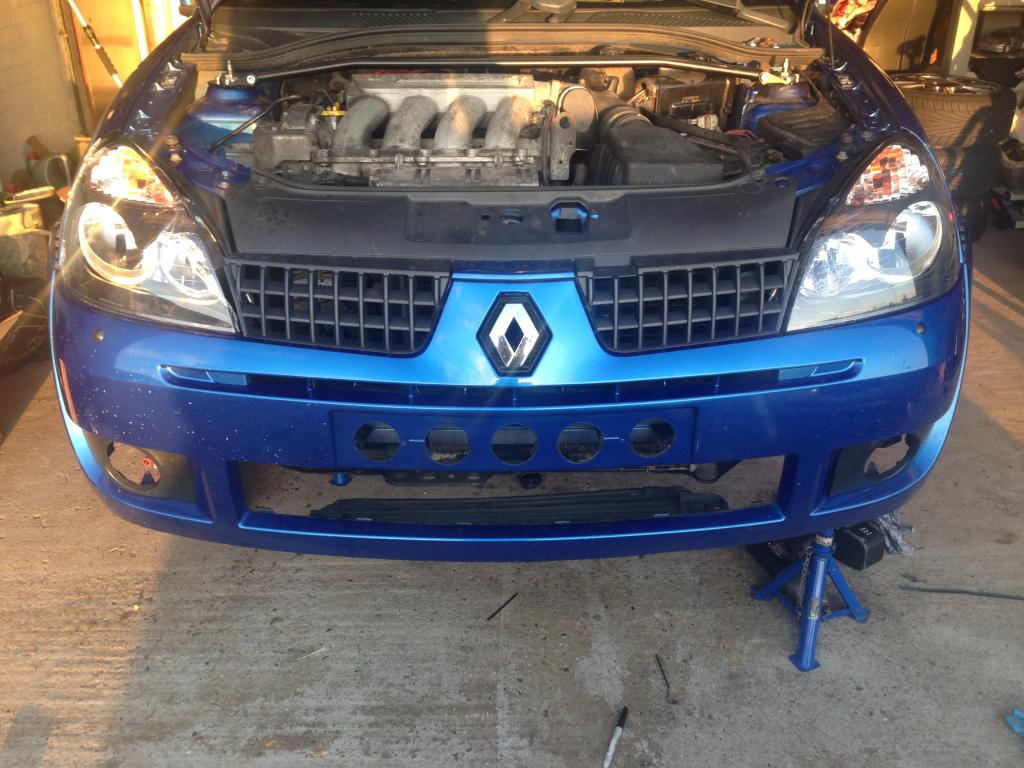

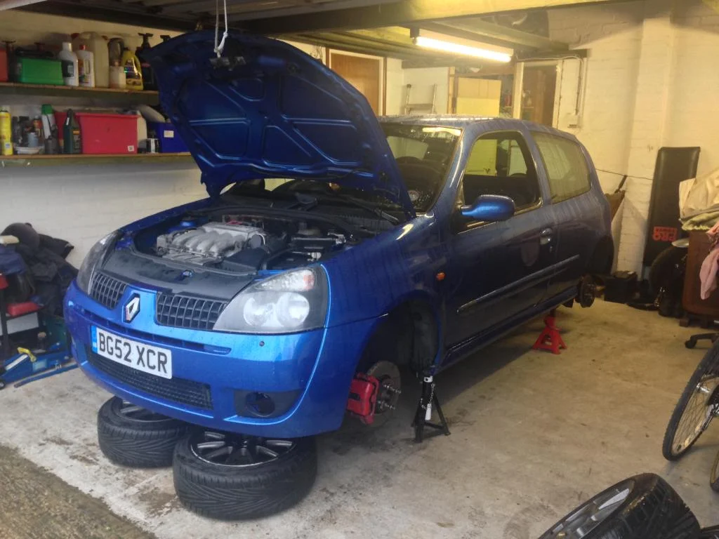

I whipped the front end off this morning before work.

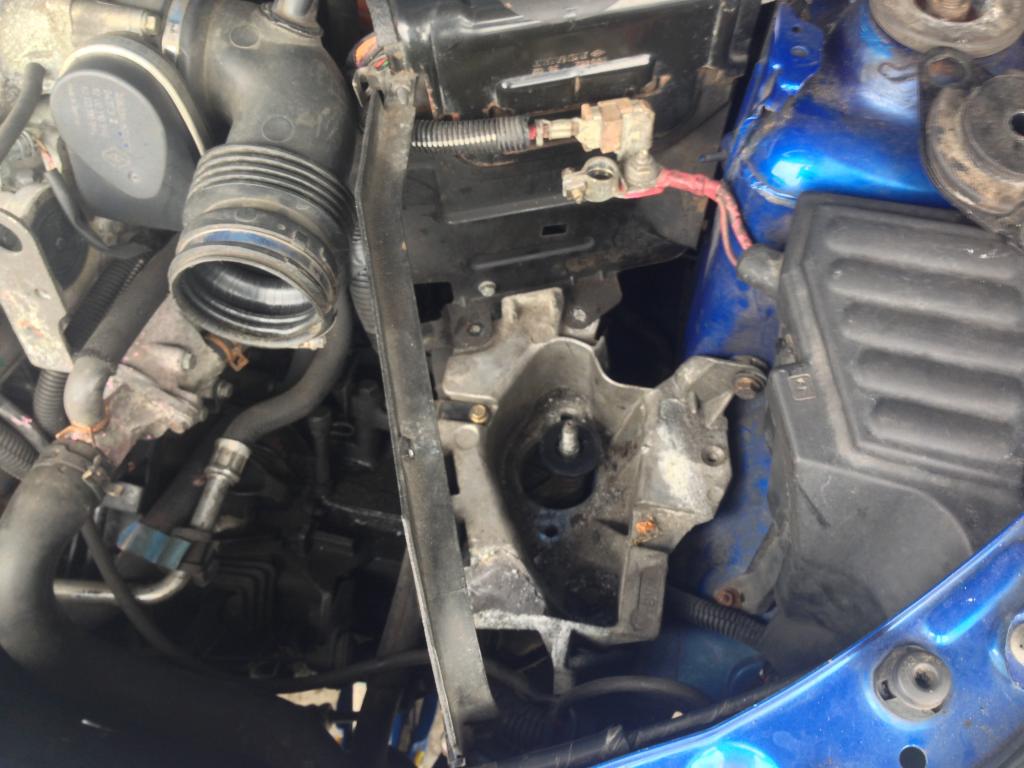

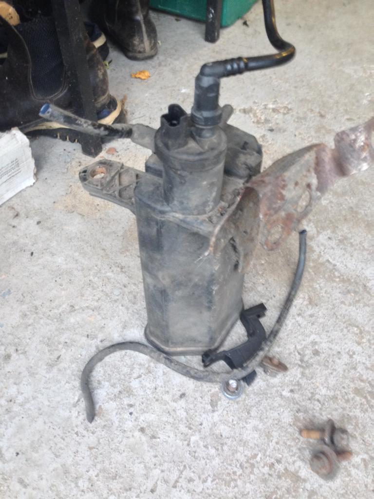

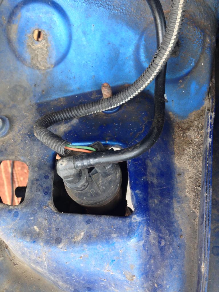

Anyone got a guide for deleting the carbon canister

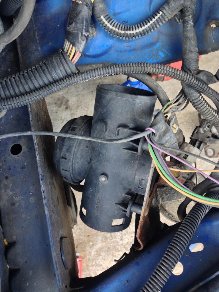

and anyone know what this is?
Chi
  Z4, VW172, R26
There's workshop guides kicking about if you have a search.. PM me your email and ill see if I can find mine.
  2x S1000RR
that thing is the acoustic valve, its attached too the end of one of the standard airbox feeds, and for the carbon canister I just took it off and secured wires and hose away.
  PH1 172
Yeah just whip the carbon canister off! I just pulled mine off and cut the wires out and blanked off the hose.
Sweet will crack on with that then.

Yeah I must admit my mates had the legs in terms of speed/acceleration as the Ibiza 1.8t is a lot more tuneable as we all know but on the twisties they'd all happily admit my 172 at the time won hands down.
A mate of mine still has one the same colour as your old one, Dave Martin from Birmingham don't know if you know him?
What setup were you running on the Ibiza exactly?
Name rings a bell can't place it tho.
Too much to list lol
rough spec
Rebuilt Forged conrod engine, BAM k04 turbo, 5 bar fuel pump, 4 bar injectors and FPR, 3inch turbo intake, 63mm intercooler piping, massive intercooler, mocal oil cooler, 3inch decat exhaust. Stealth racing track based map
suspension wise, mk3 golf wide track front end, mix of Vibra technic and solid bushes and mountings, Neuspeed arbs front and back, Bilstein B16 coilies, mk2 golf non pas rack, corrado G60 AP racing 4 pots bells and rotors kit.

So cracked on tonight after work. Got plenty done

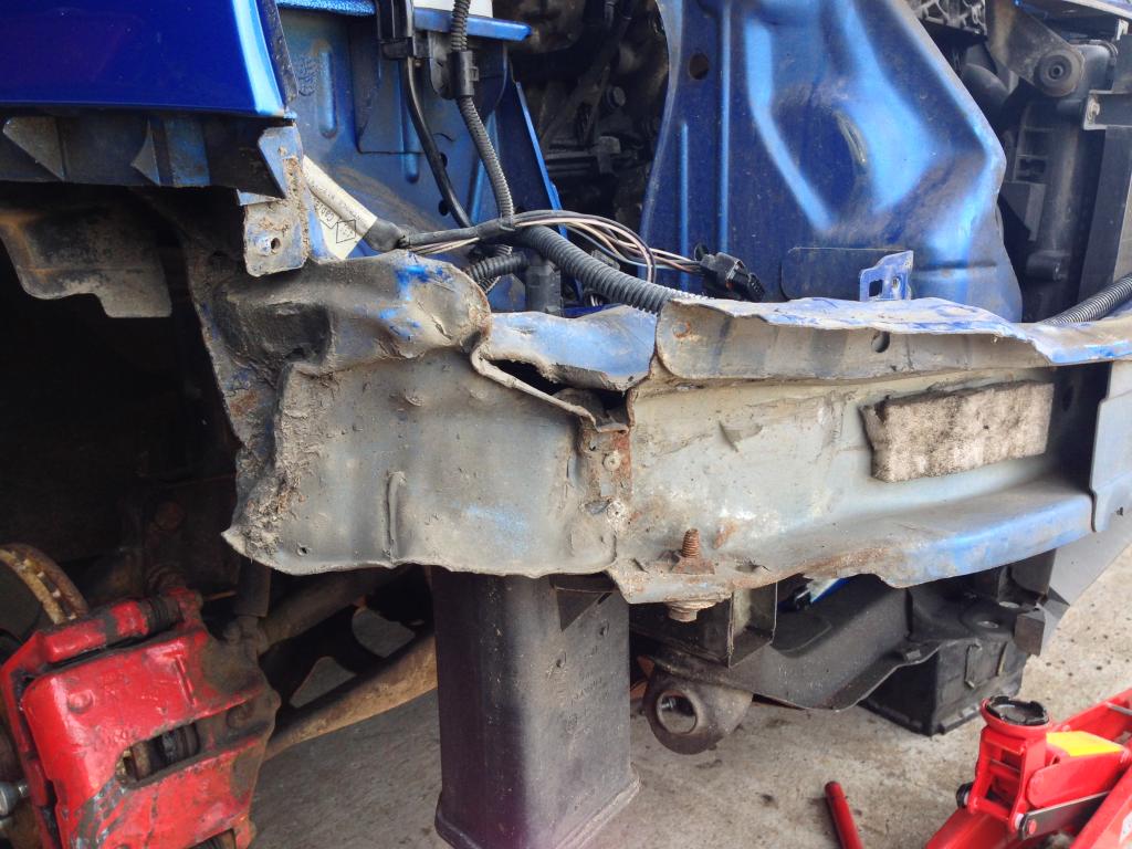

Found it's had a bump once in its life, nothing to bad just bend the corner of the crash bar. But it's making it hard work to remove the carbon can as all the nuts/bolts are just spinning lol
Removed some stuff

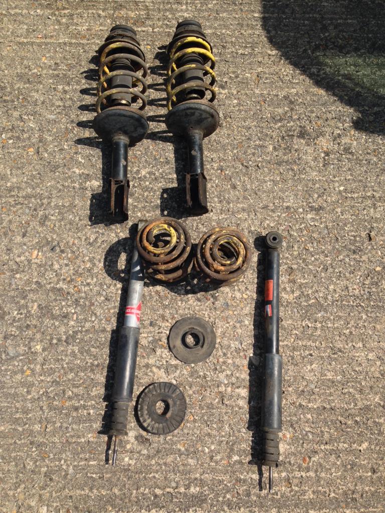

Wanna sell the shocks/springs and dogbone can I post in the forsale section yet?

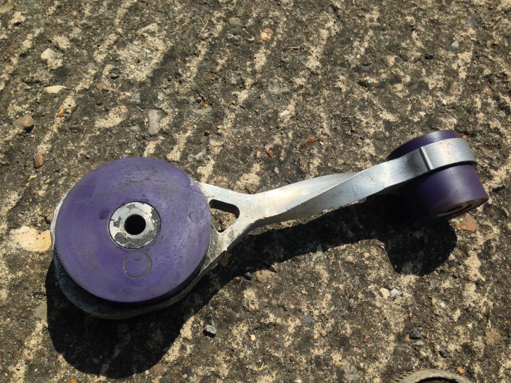

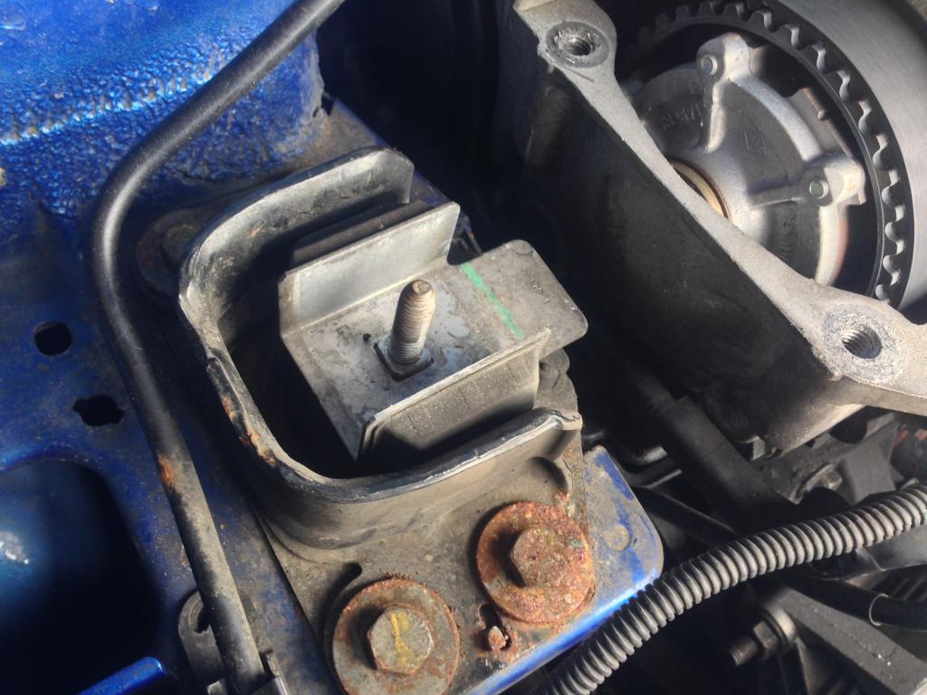

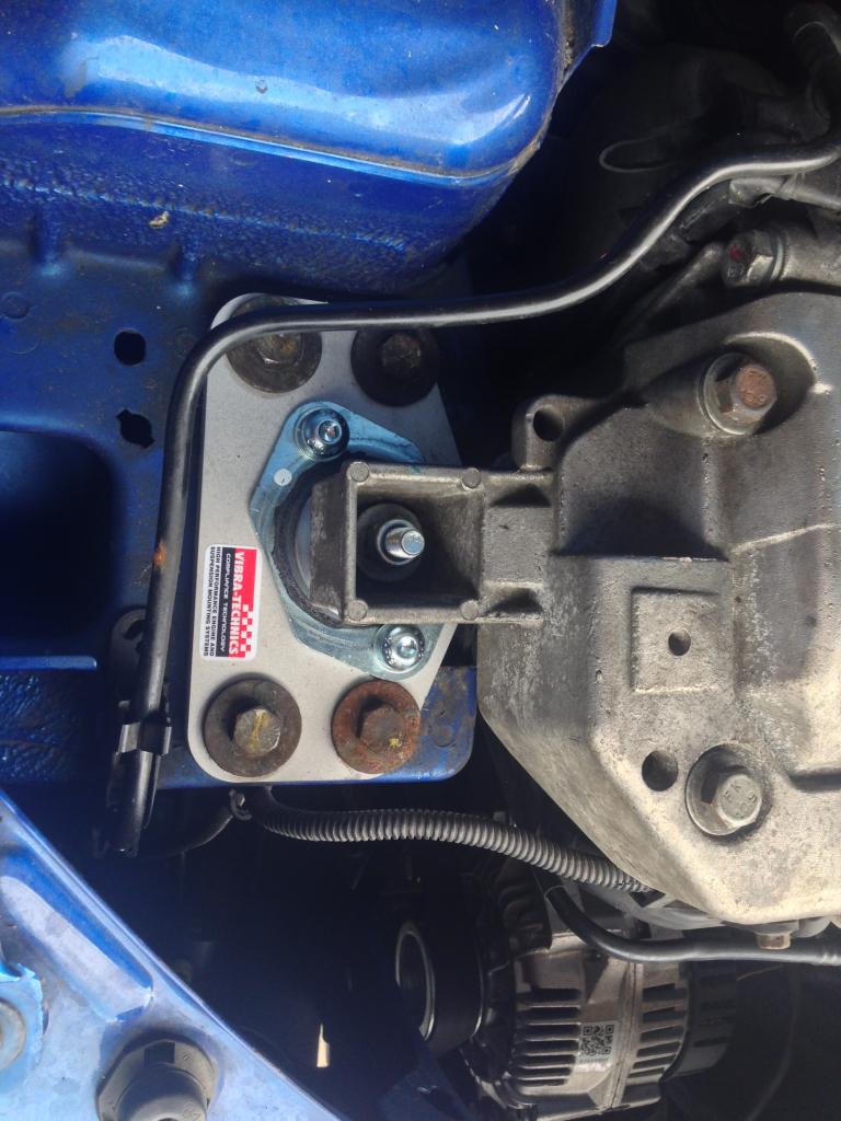

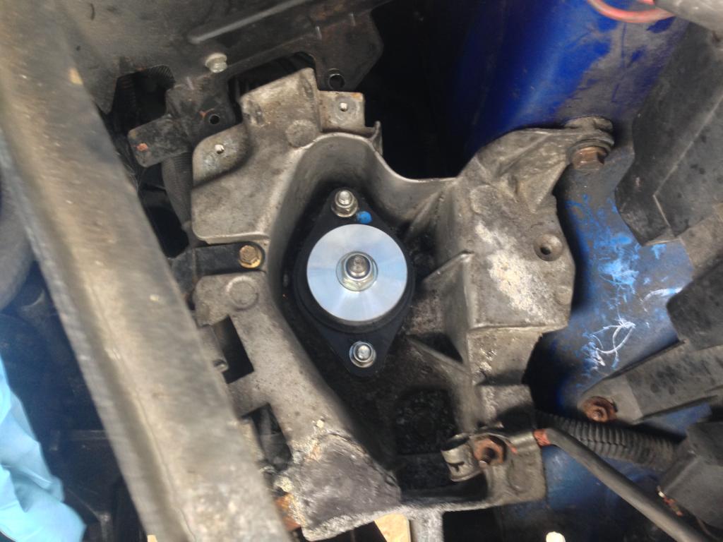

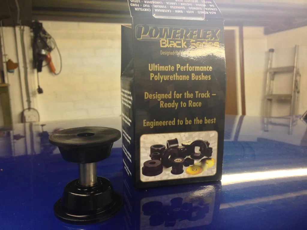

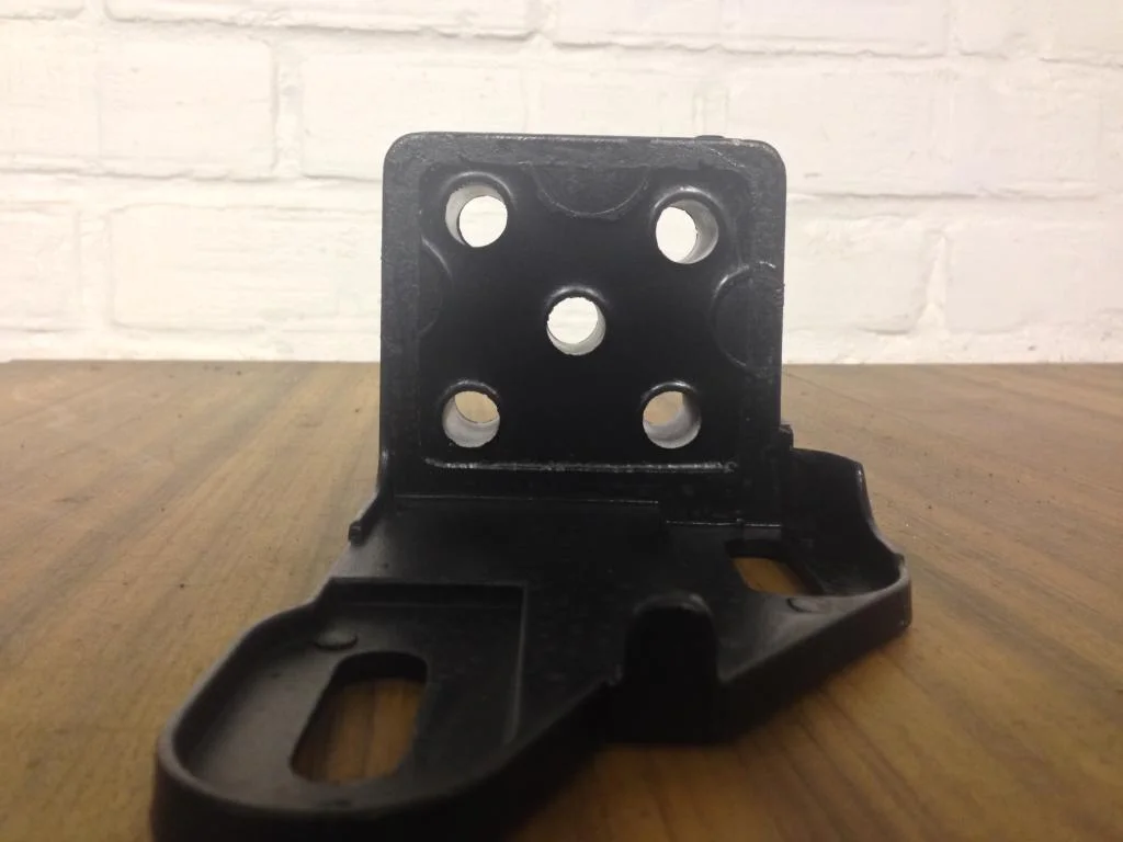

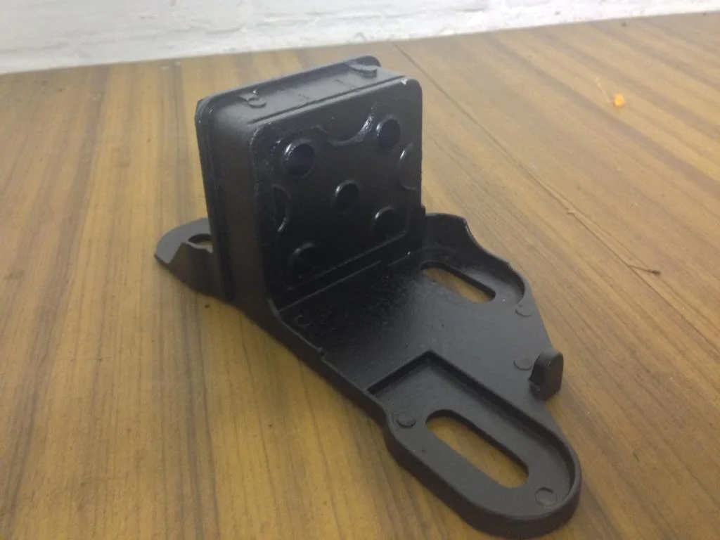

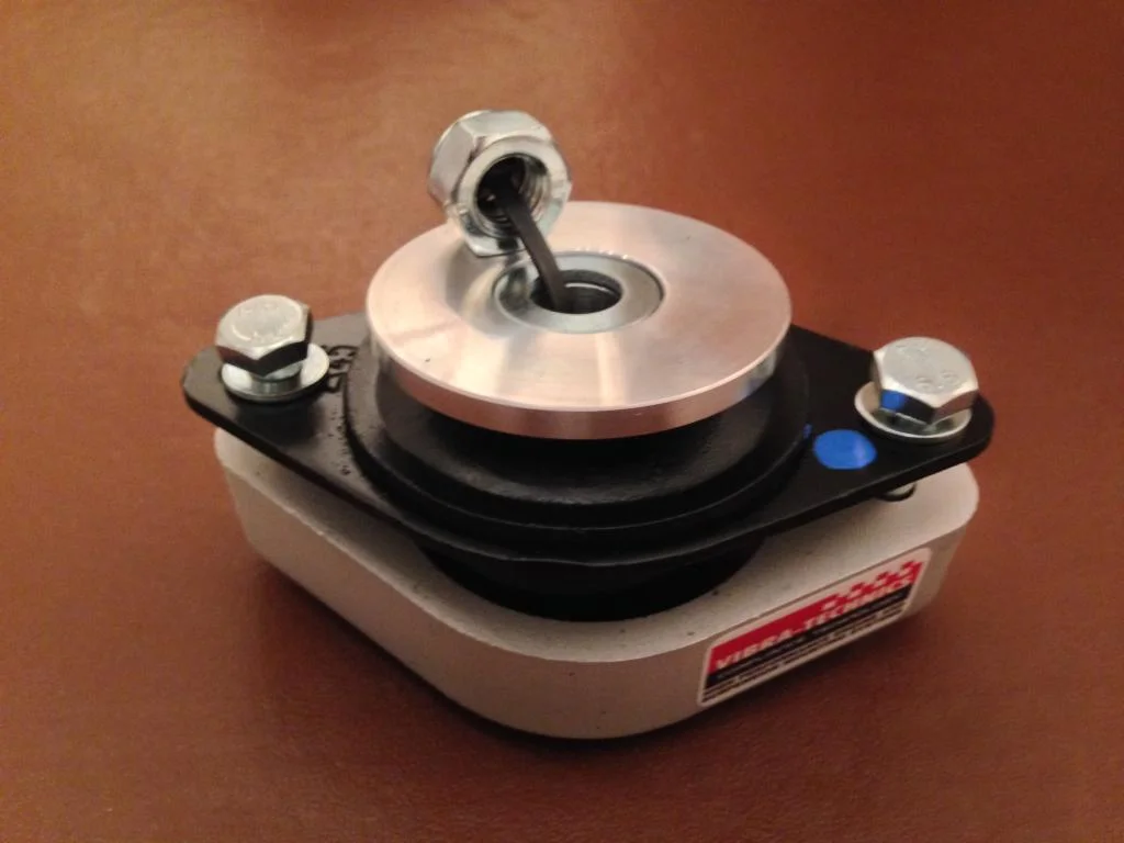

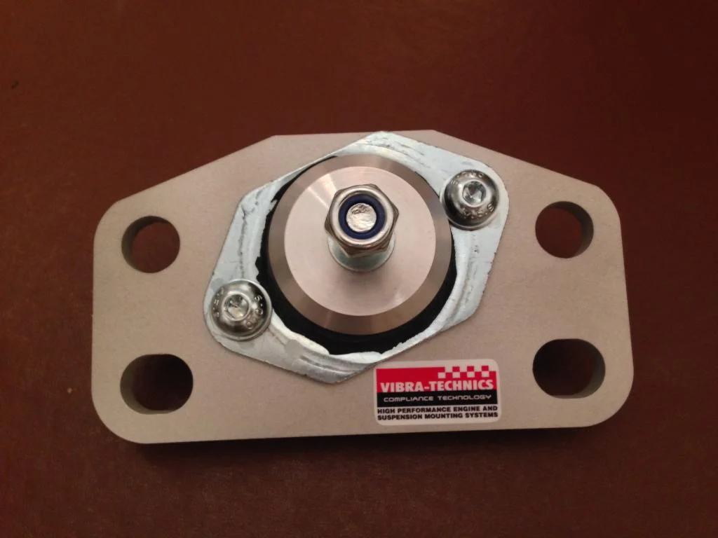

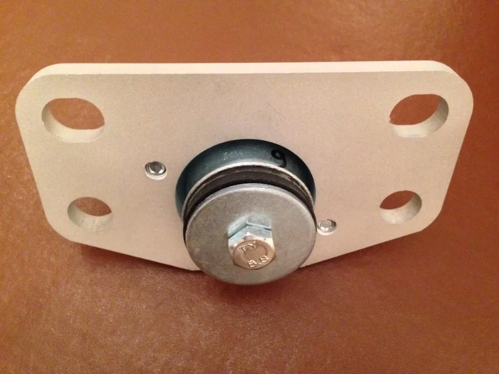

Then started to fit my new engine mounts
Old ones off

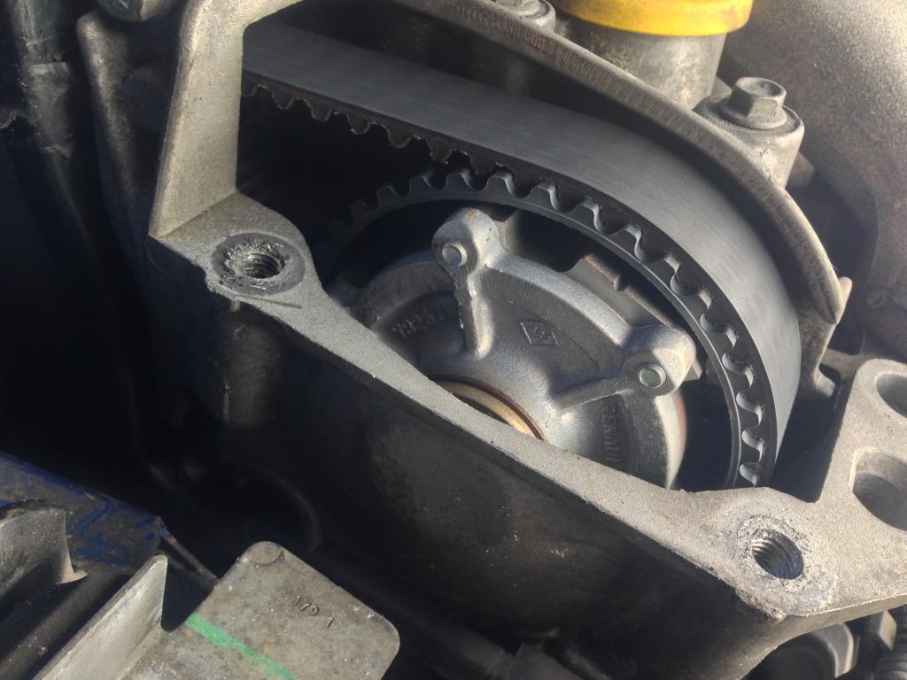

Quick pic of the new dephaser and timing belt
New gearbox mount
New engine mount
New gearbox dogbone

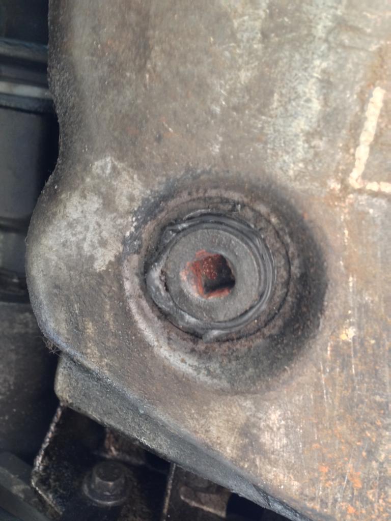

Also noticed this while under it
Sump plug!! [:mad:]

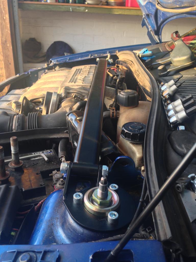

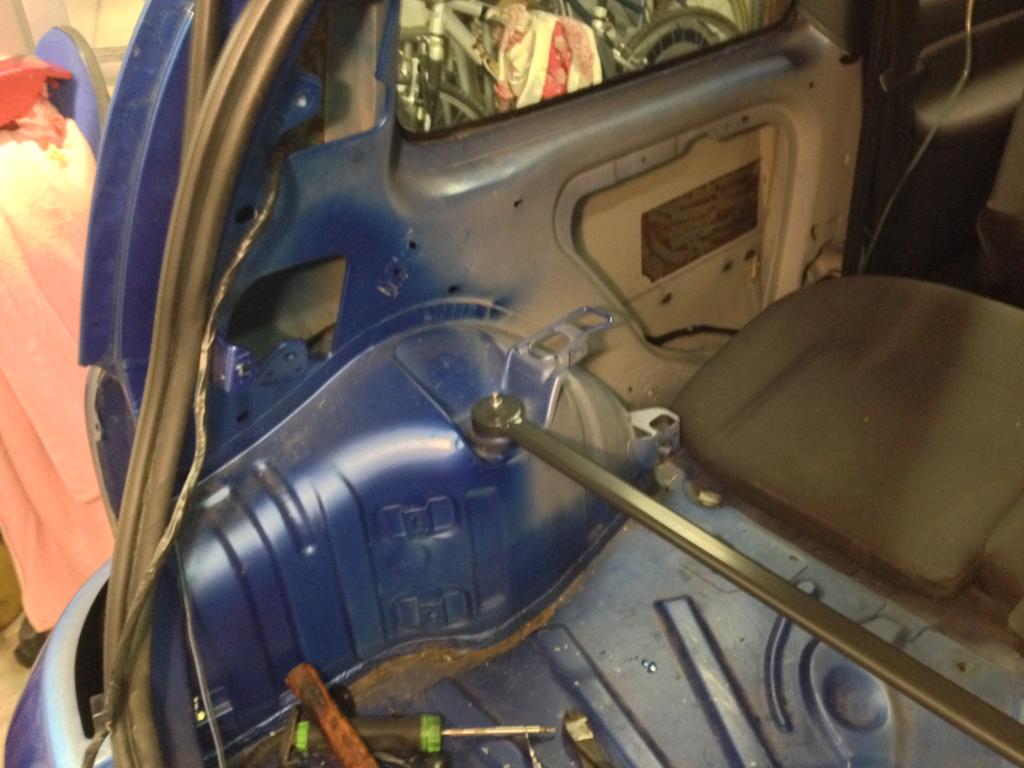

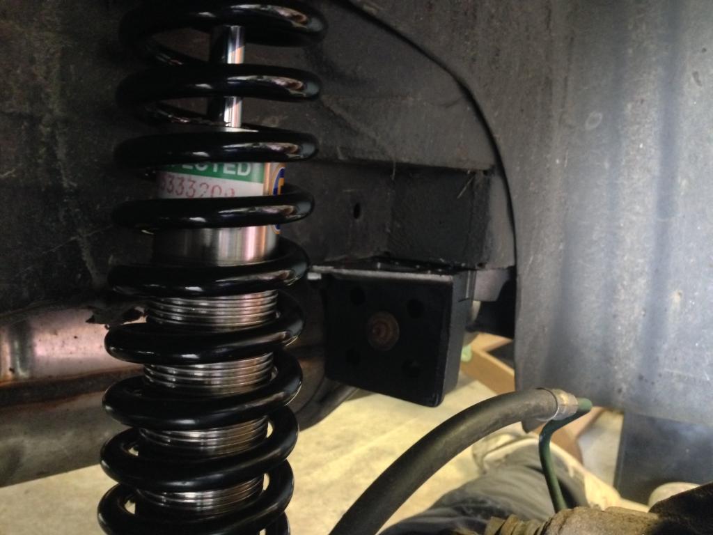

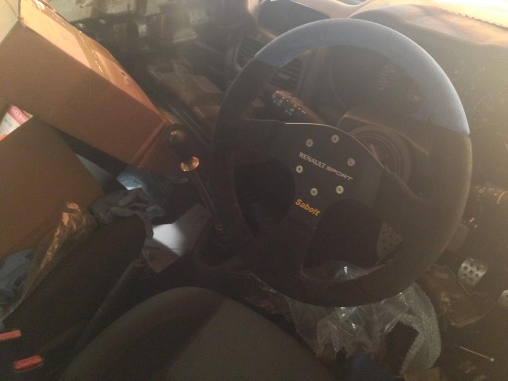

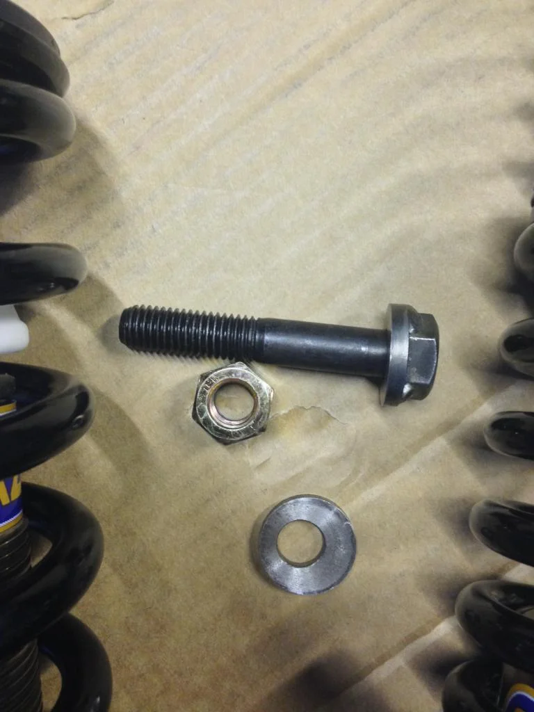

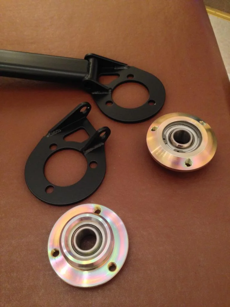

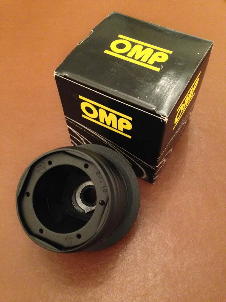

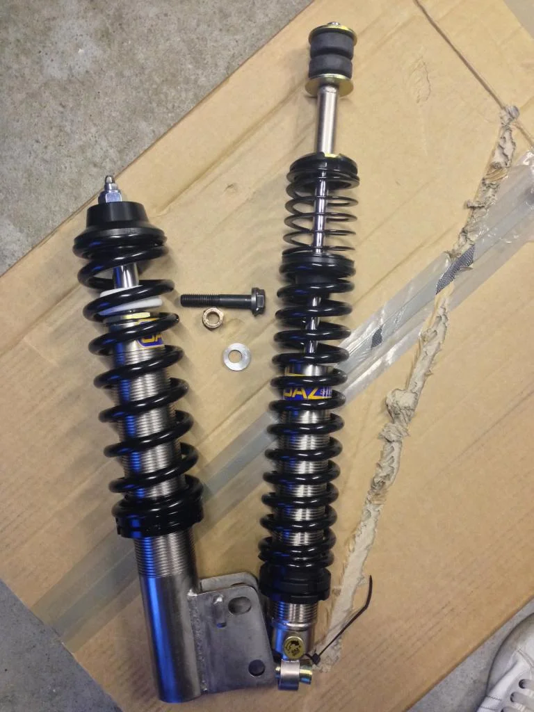

Started fitting my Pure Motorsport topmounts and strut brace
Started removing the exhaust and heat shield to drop the gear shift tower out.
Proper bodged exhaust hanger
I then forgot to take pics as I went and took a bulk few in progress
Coilovers, top mounts, strut brace, rear arb, snap off boss, steering wheel, rear strut brace and gear shift kit all fitted just need to adjust the gear shift kit.
Also drilled the rear bumper haha
Treated to New headlights
Bumper drilled, just need to drill the crash bar.
Hopefully get get some more done tomoz, needs the inner tie rods changing and possibly read discs and pads :(

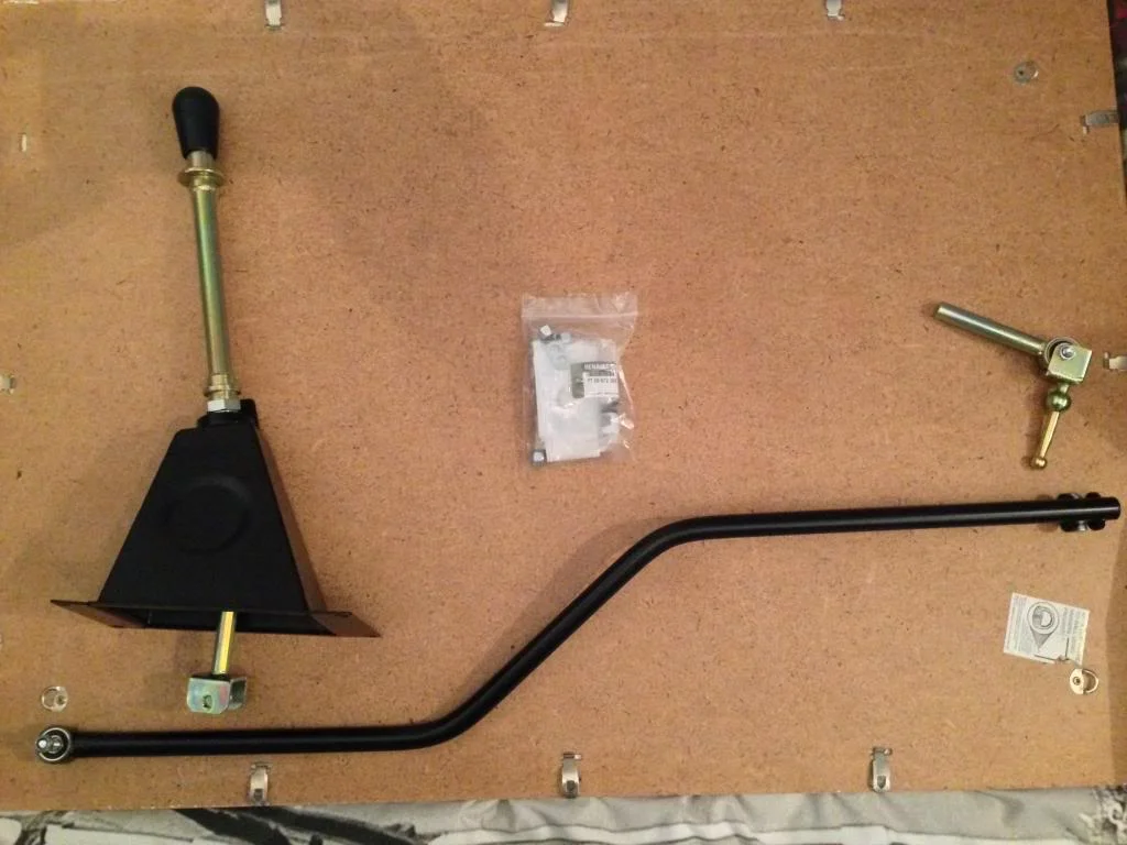

Oh anyone got any hints and tips on setting the PMS linkage up??
I've put the linkage together (gearbox end) with out doing up the little 10mm nut and 5mm Allen key bolt (clamps the black link bar to the gold pivot joint) I can select all gears R & 1-5 fine, as soon as I tighten the last bolt I can't get reverse or if I tight the bolt whilst it's in reverse I can only get reverse and 1St :( any quick tips? I had to stop for me tea before I could finish it lol

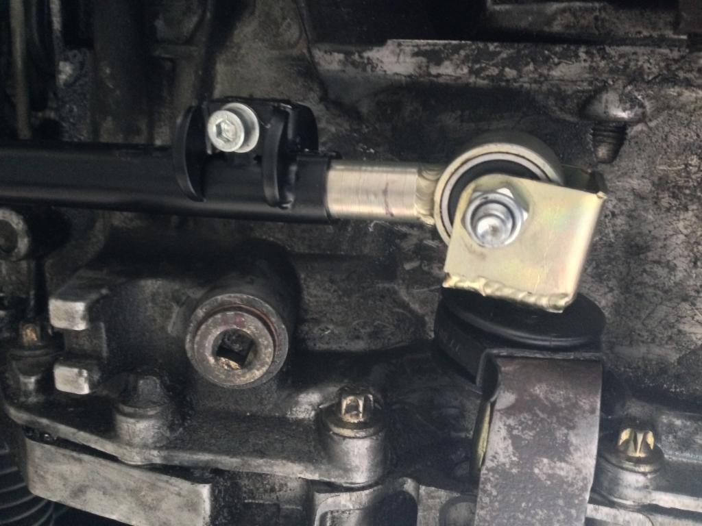

Did more on the car tonight

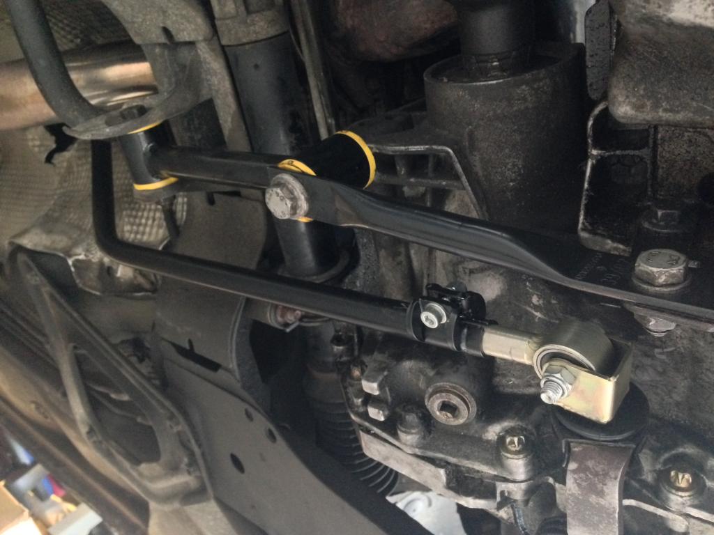

got the PMS linkage all set up :) mine was hitting the lambda sensor in 4th and 5th, hitting the tunnel in 5th, 1st and reverse. All sorted now tho which is good. Seat position with the steering wheel closer and the gear stick closer really makes a difference :)
anyway few pics of the linkage

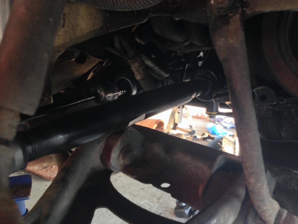

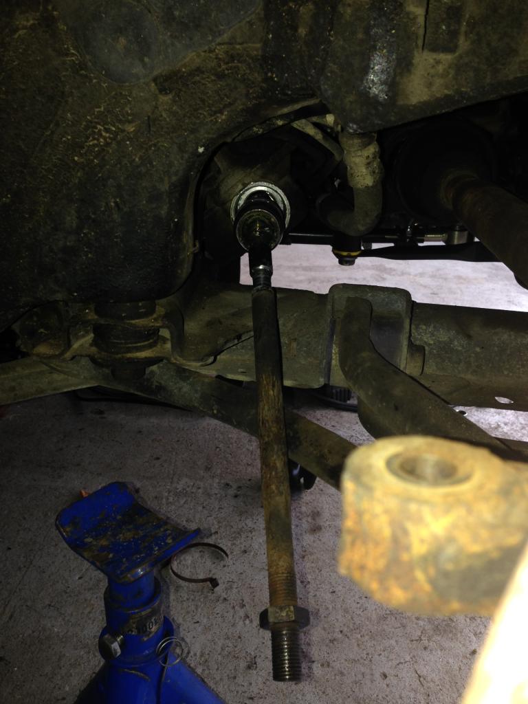

with that done I whipped the track rod ends off and steering boots off to find the inner tie arms completely knackered. Just gotta get me tool to undo them.
also ripped out the carbon can

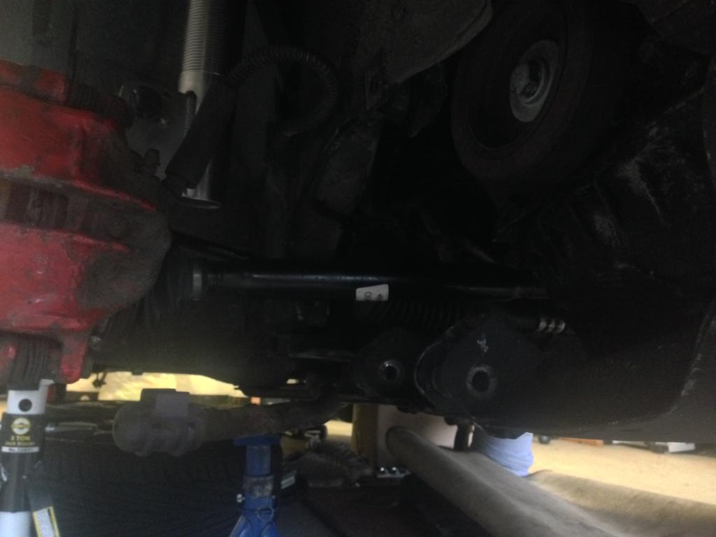

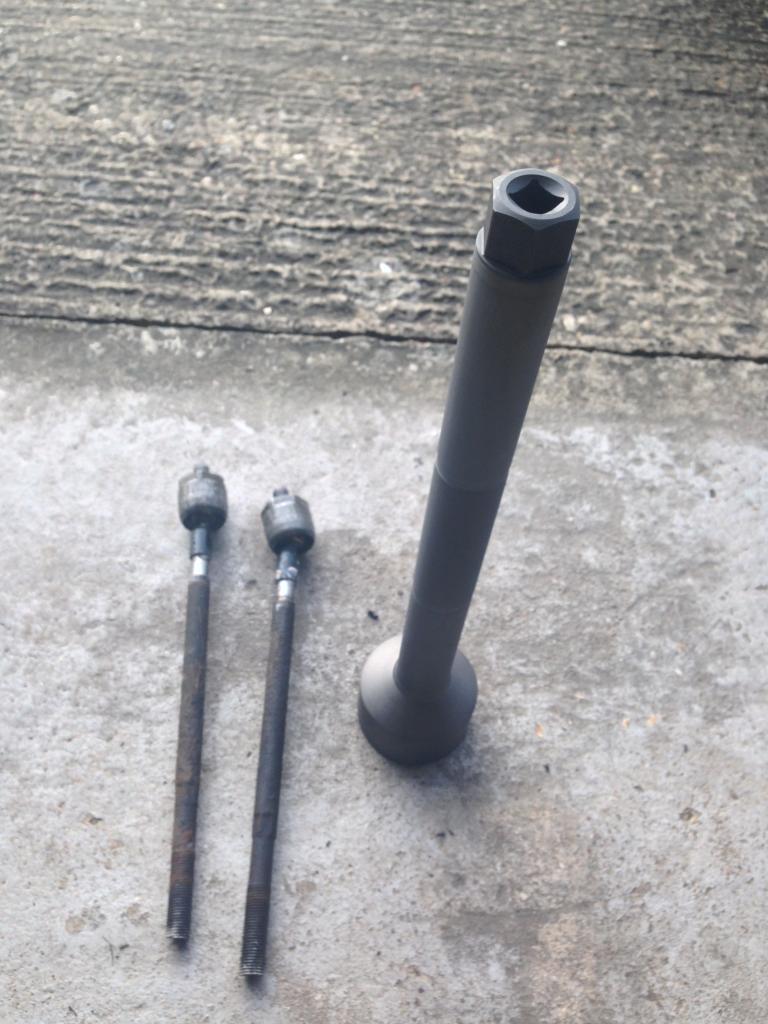

Whip inner track ends out last night. So easy when you've got the tight tools for the job.
There proper knacker. Got some new ones from work so will whip them on soon along with a new drive shaft as the inner joint in the drivers side is knackered.

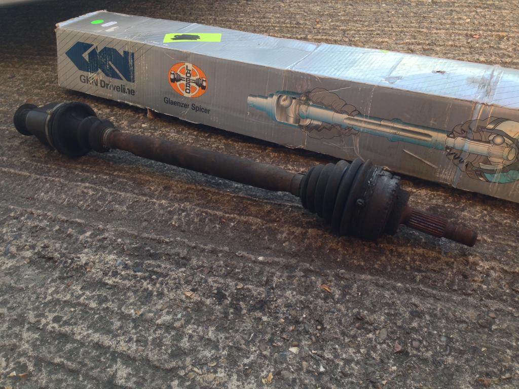

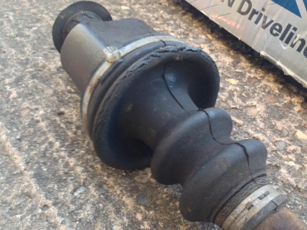

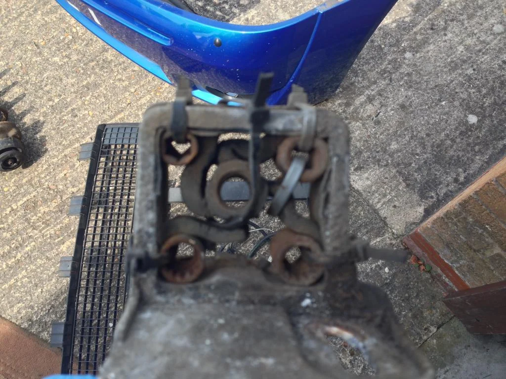

Changed the drive shaft and inner joints tonight.
Drive shaft boots were falling apart and had been bodge (like most things on this little clio) with cable ties which had let all the grease out lol.
Knackered boot and famous cable ties
Old one
New one in with the inner tie rods aswell.

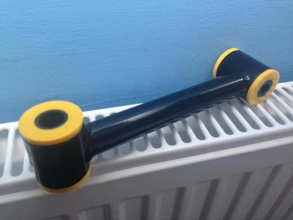

ill be be taking the wishbones off tomoz as I've ordered some uprated ones :)

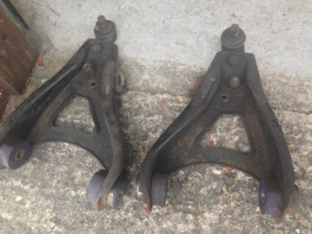

Did abit tonight

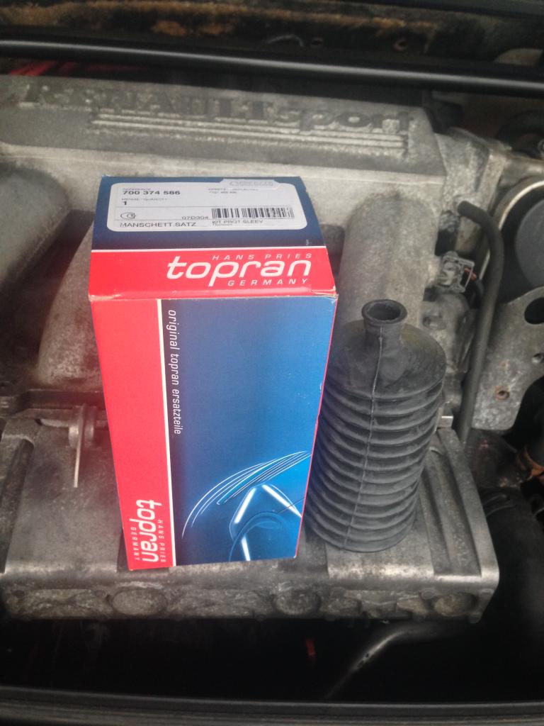

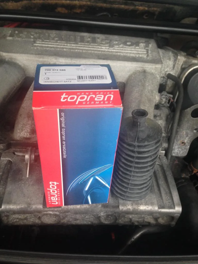

Fitted new steering boots
And removed the wishbones ready for the new ones :D
Powerflex bushes only been fit since April ;)

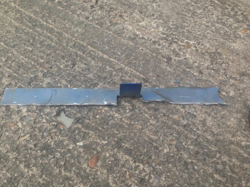

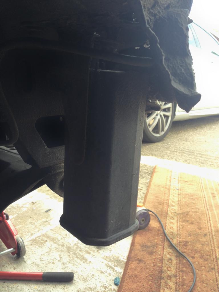

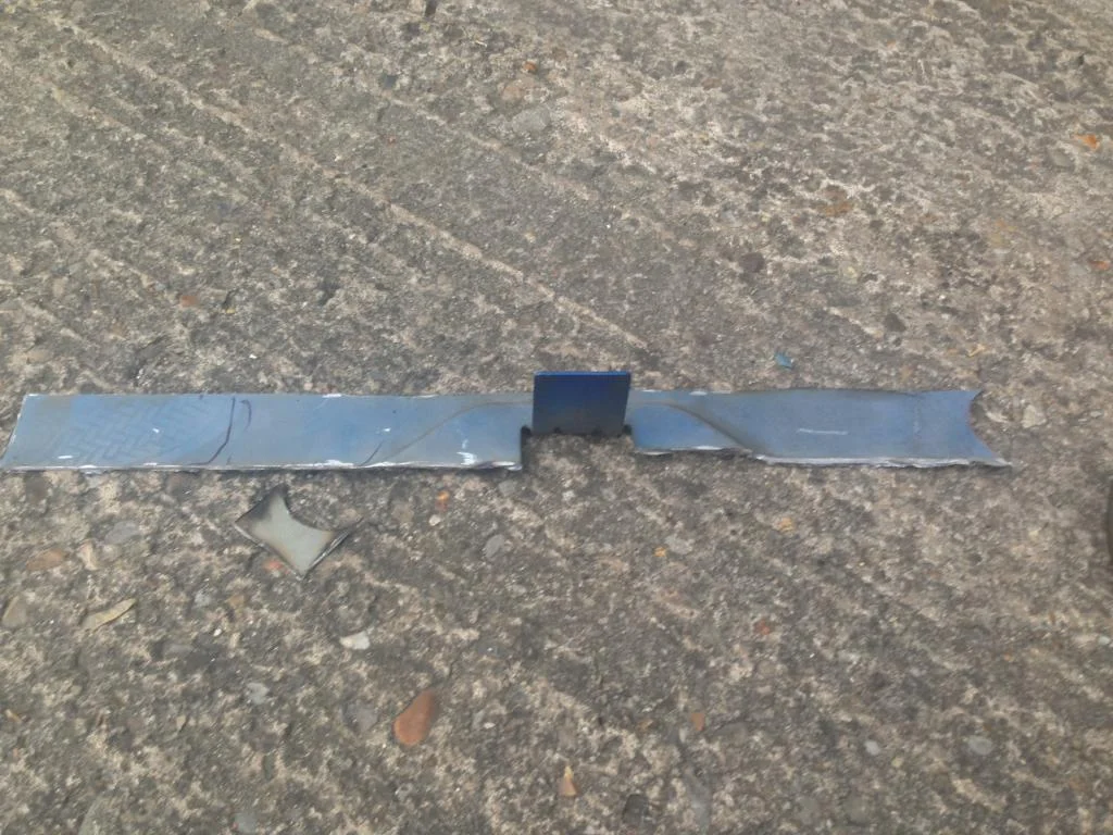

Also went abit mad with an angel grinder and chopped abit of the crash bar out, need to tidy the bar up now lol

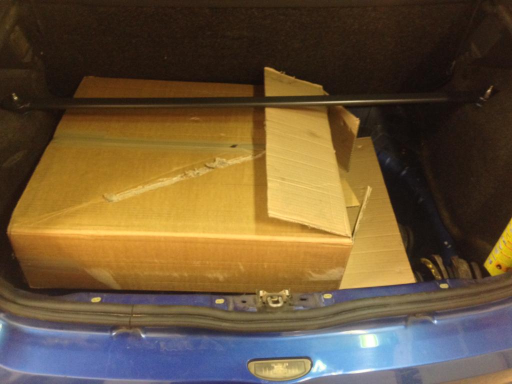

Fitted some new wipers as mine where totally gone.
as I didn't get in the garage till half nine I decided not to turn the angel grinder on and cut the crash bar out slightly, instead I pulled the interior out :) well most of it.
bloody filthy lol. Will need some tlc to get how I want it.
All of the interior when in the boot of my K1 :) helped tidy things nicely

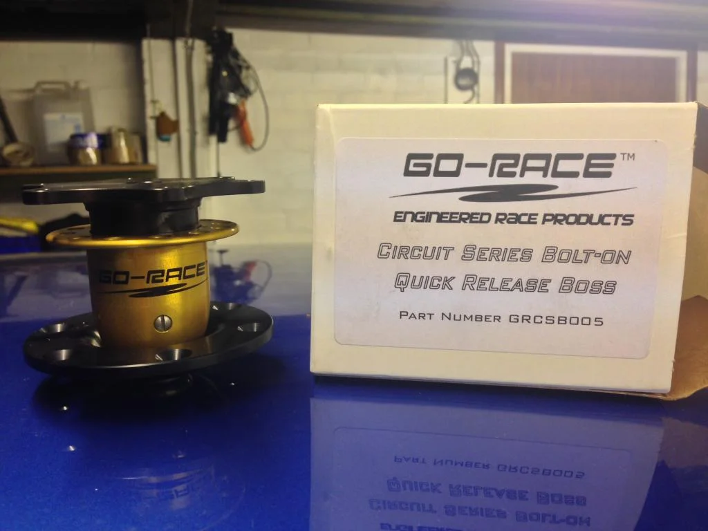

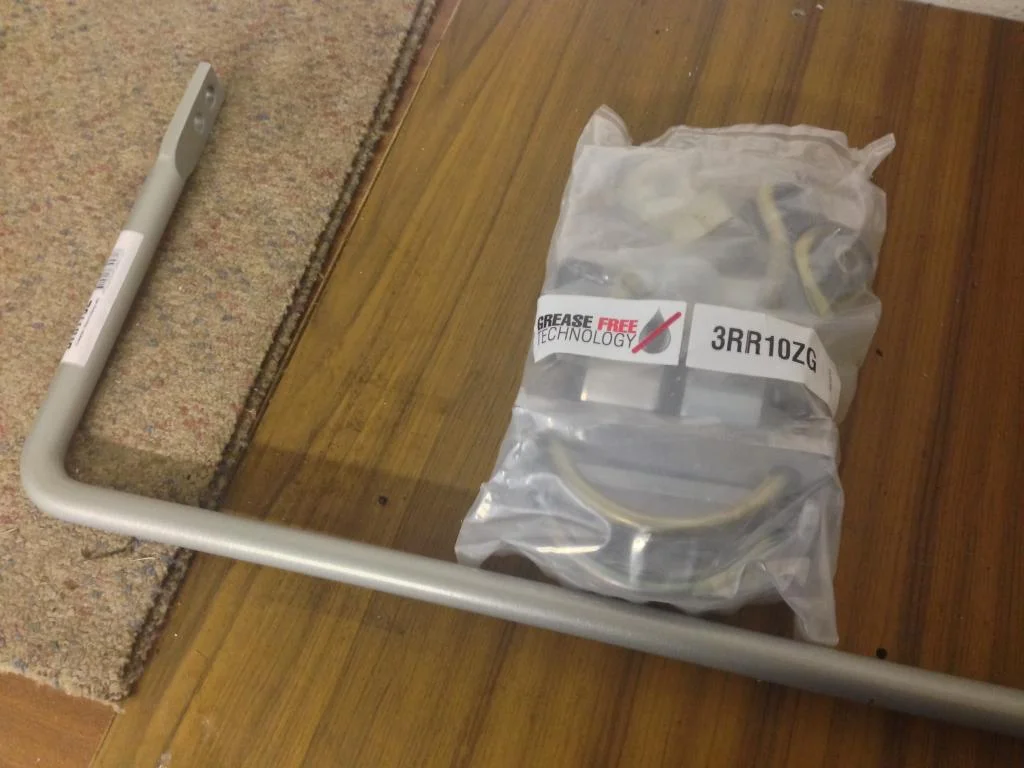

Brought one of these to help set the camber up :)

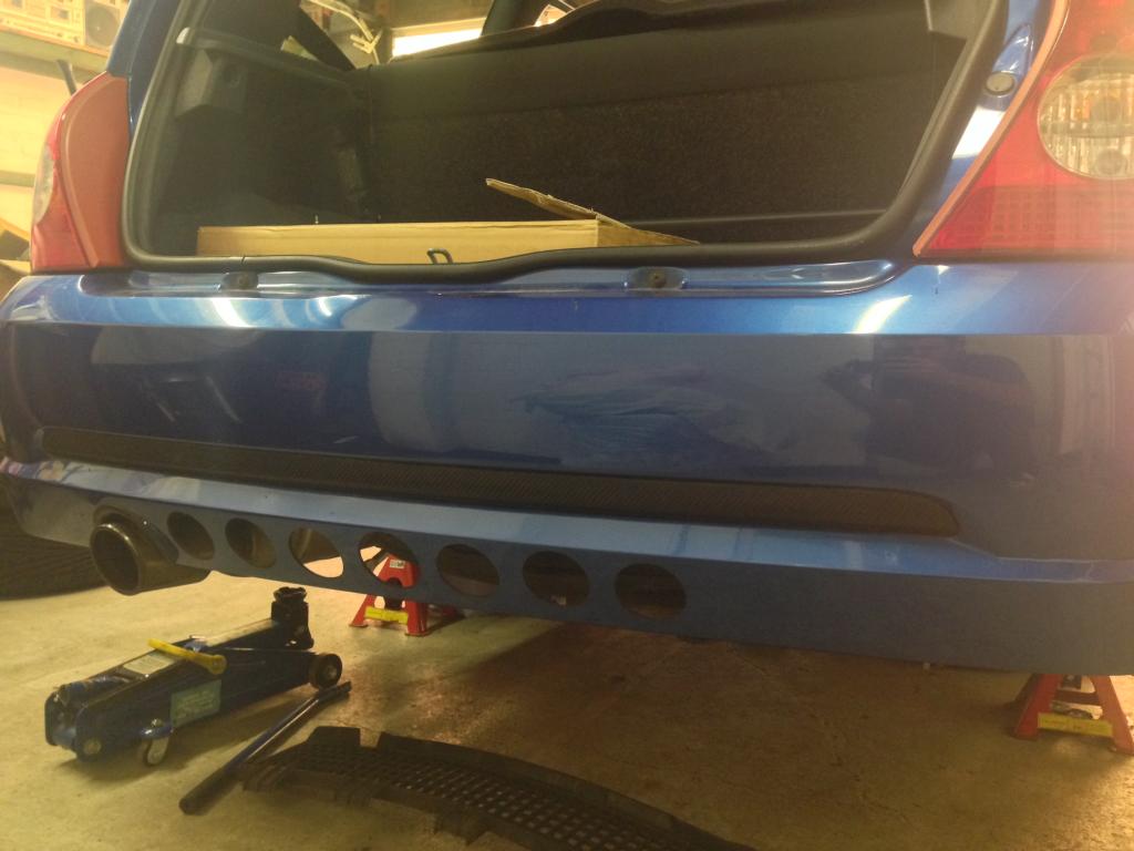

Cut the crash bar out for the air flow
Same with the bumper
Have it a lick of paint to stop rusting

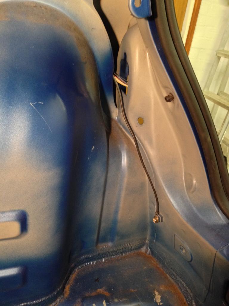

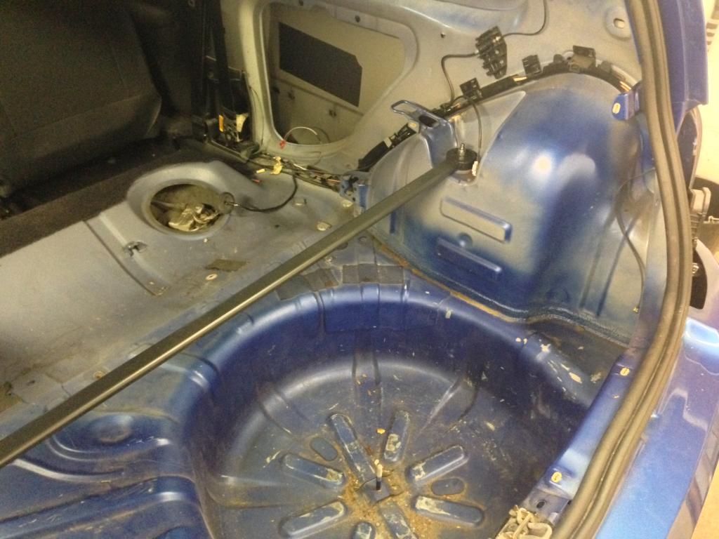

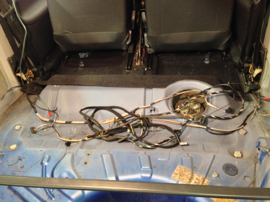

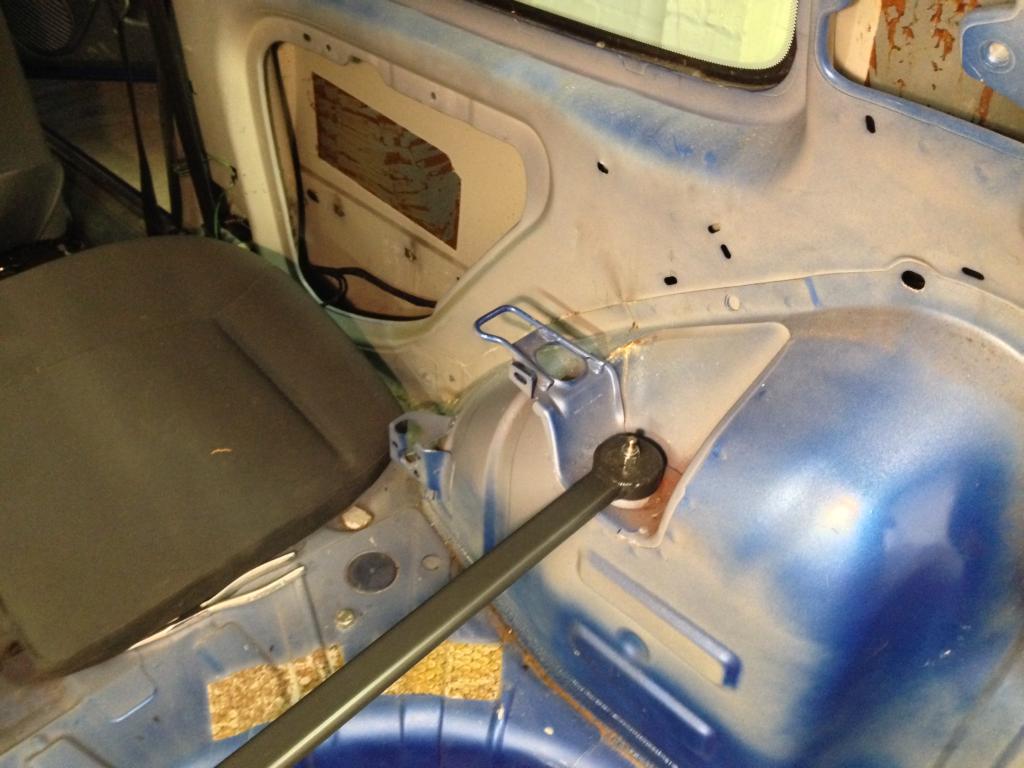

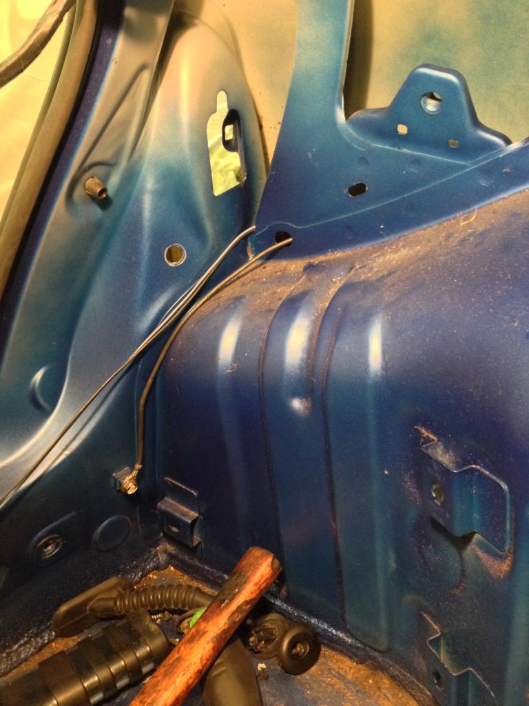

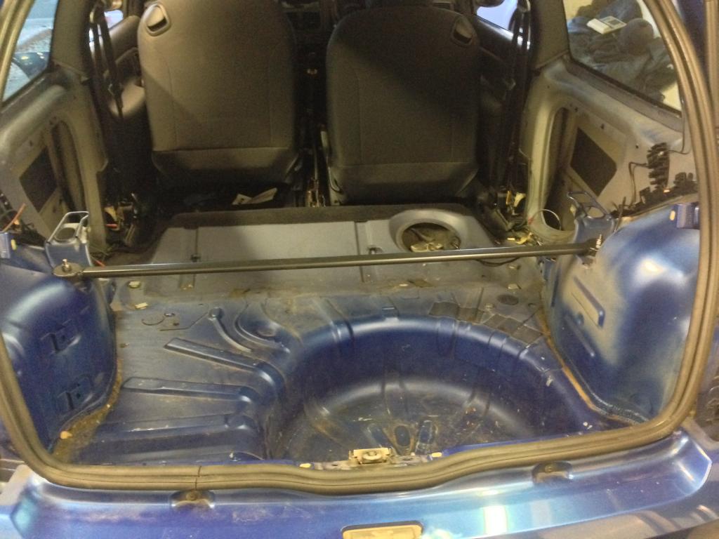

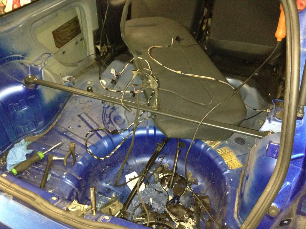

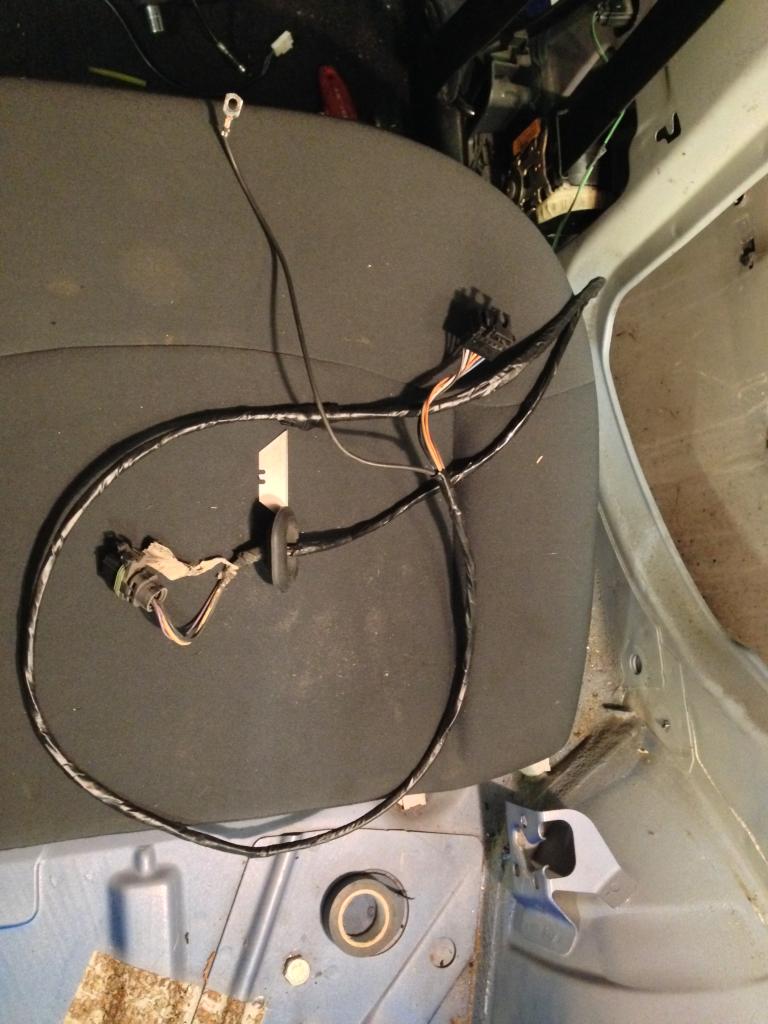

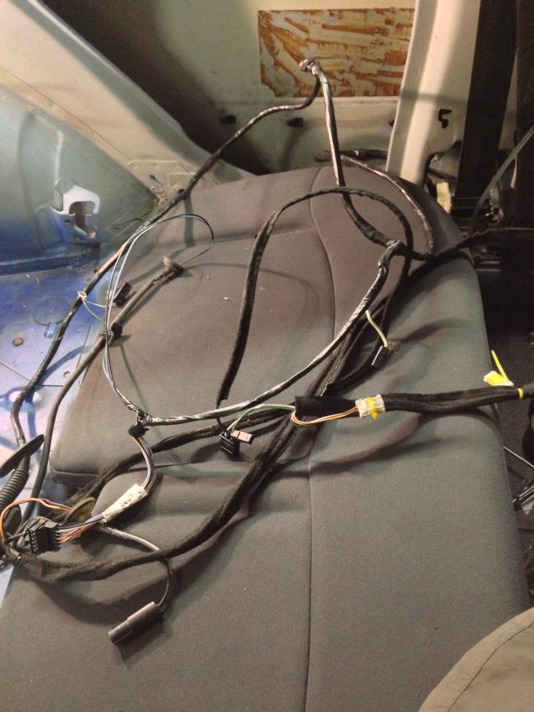

Then moved onto the wiring in the back, so striped the spoiler off and headlining
and pull the wires through the boot and stripped all the wiring off the wheel arches
Stripped and tidied.

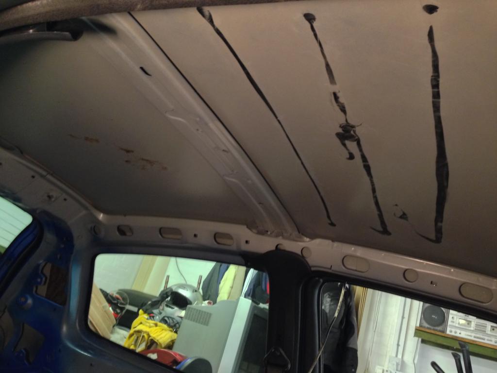

all the sound Deading is striped out even the roof lining silicone which was a right pain
Offside wiring all tidied
and near side all tidied along with the boot wiring
Wires all ran in the new places
Offside
nearside
just gotta run the wires back through the boot, which will be fun I guess.
Carrier bag full of sound Deading and rubbish
Picture of the business seat
Looking great, good work with the sound deadening removal.
I would not have done that to the front crash bar though, drilling circular holes like you have done to the bumper would have been sufficient
