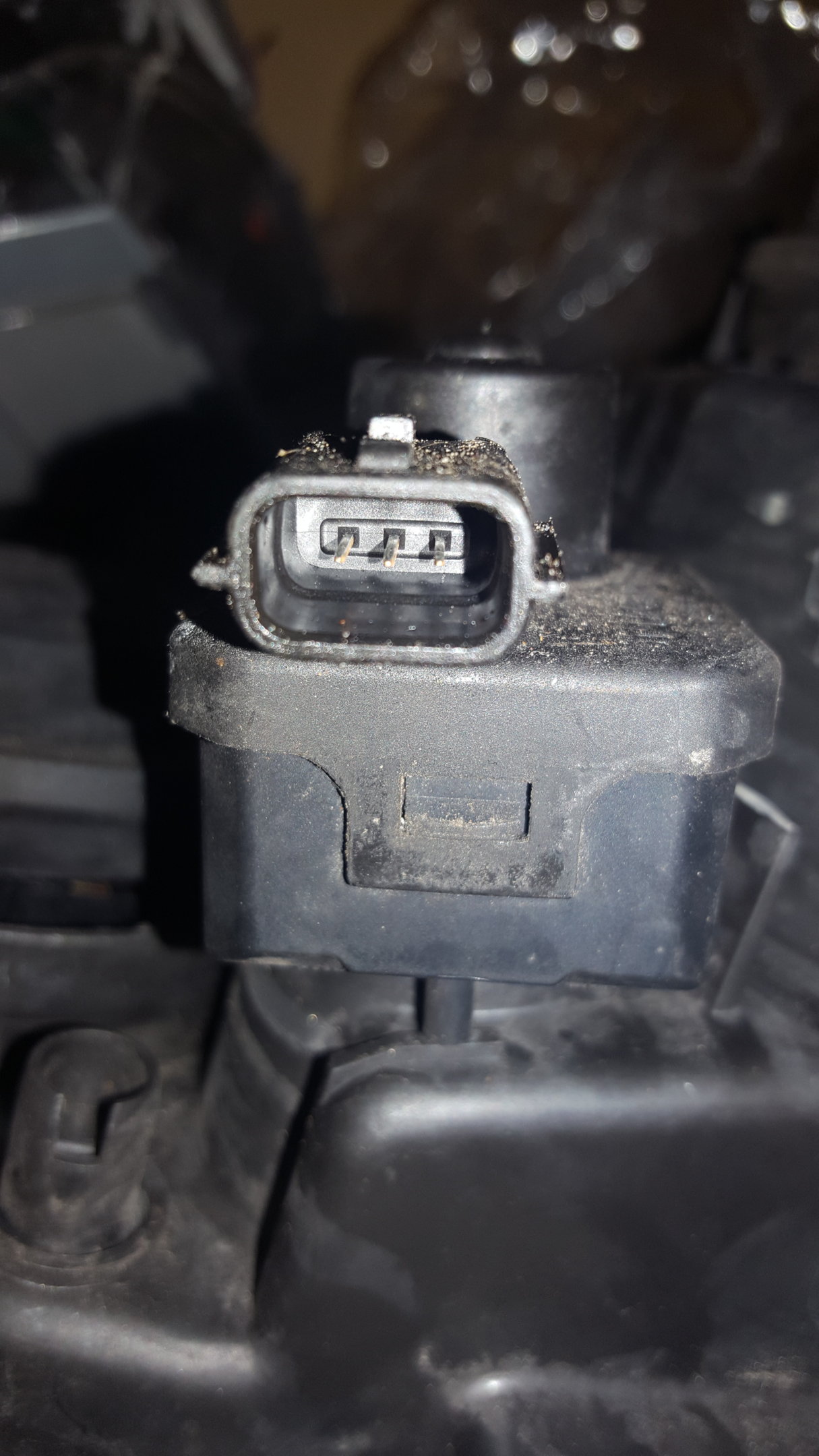

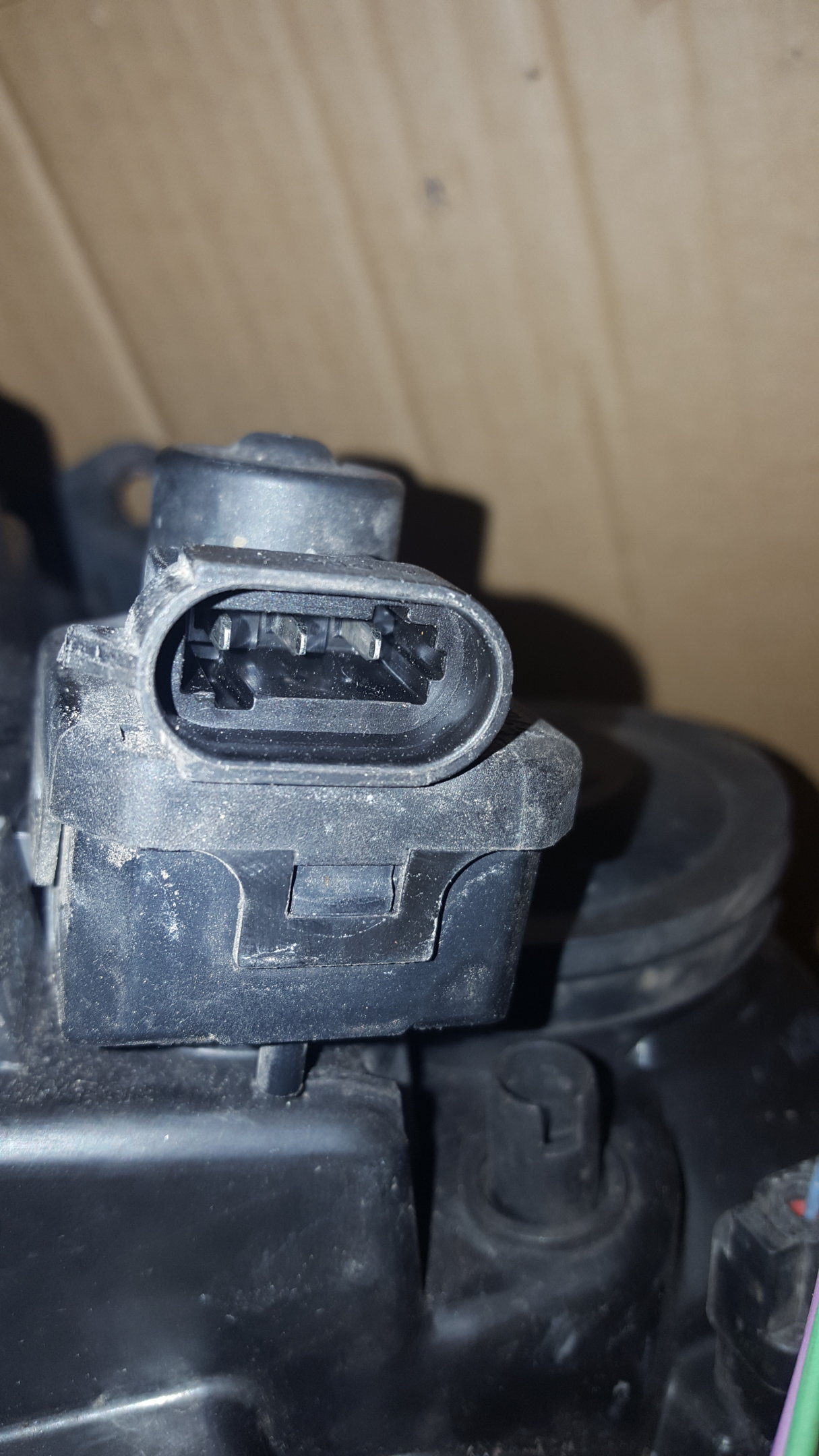

As promised....
pappasmurf
  Arctic Blue 182
I'm not sure if those highlight it well enough but one is clearly a rectangle the other is oval. Plus one is quite a lot larger. I'll attempt to swap them over and see what happens.
mossyv6
  Trophy,V6,5GT,AG200
As above turn the whole plug, you will hear a click and it pulls out. Put new plug in and make sure it locates into the ball socket and turn/click into place.
Its the headlight height level adjuster by the way. Had to do it on my Trophy.
