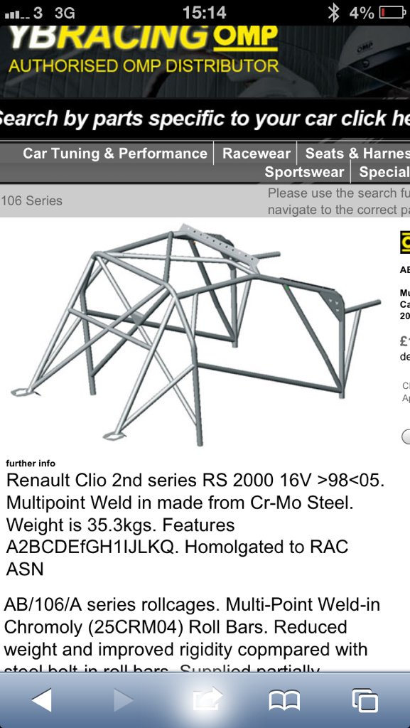

I've ordered an omp roll cage from D.T and it comes with the tubing to connect the cage to the strut tops.
I can't find any pictures or any information to see how this is done . Can any one help?
This is the cage I have order .

If that's the exact design you want, I would double check schematic as OMP are known for changing design and not letting anybody know. I would buy an extra piece of pipe as well to span between the 'A' pillars, would finish the design off well IMO.

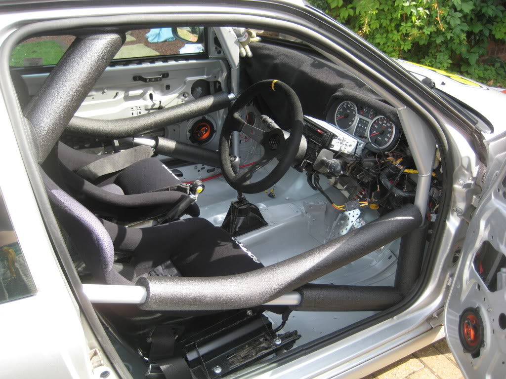

Yeah thats what i thought, its the same as my cage but i didn't put the bars through to the bulk head. I just ended up adding a bar to the side sections of the cage where your doors are and then adding harness bars.

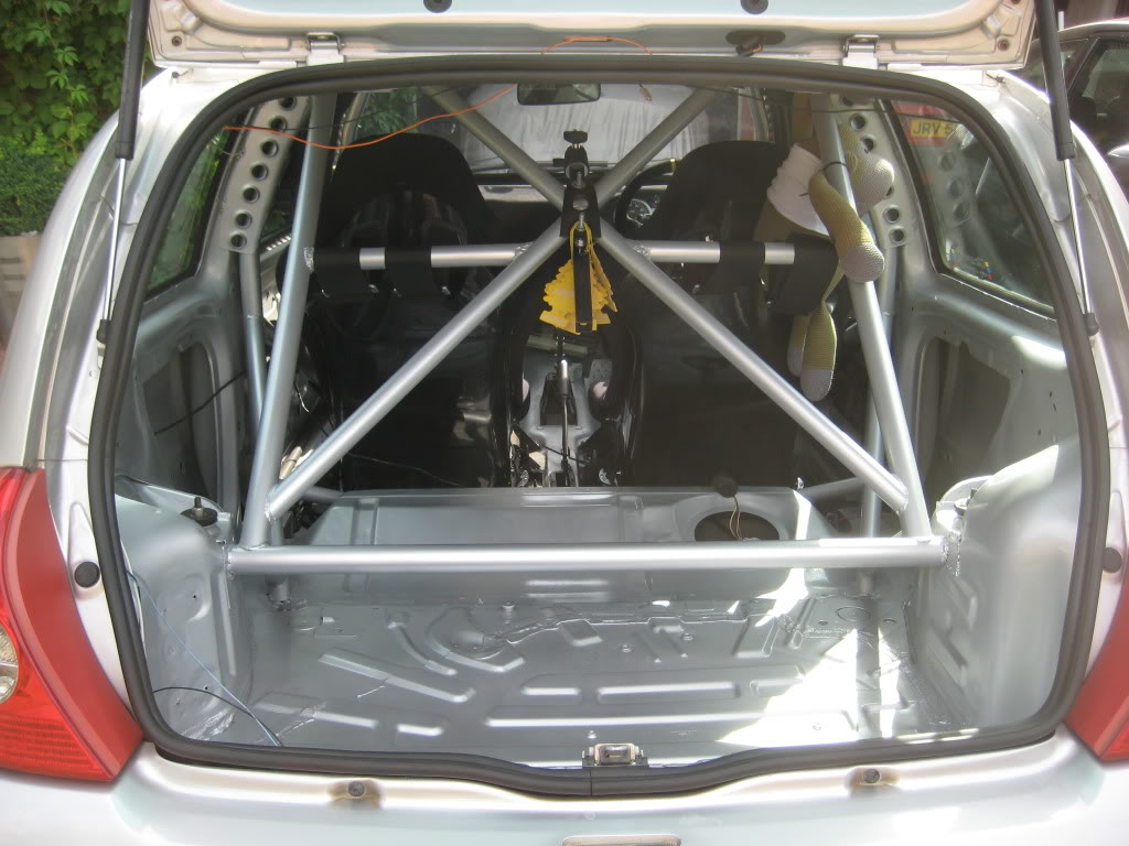

Only photo I can find to help you, thought I had more!
edit_preview.php
Here you can see the front bars are welded in, but the main front hoop has not been welded to it yet.
