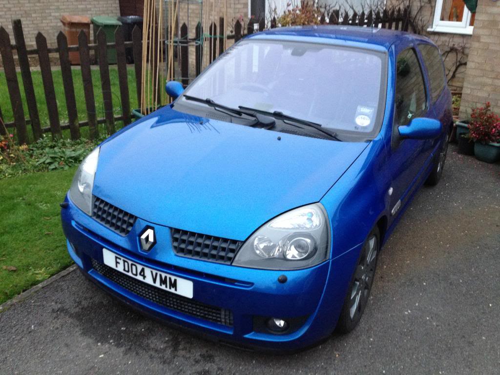

I bought the 182 a week and half ago now and I must say I absolutely love it! I came from a 1.4 Corsa C so this is a massive power upgrade for me.

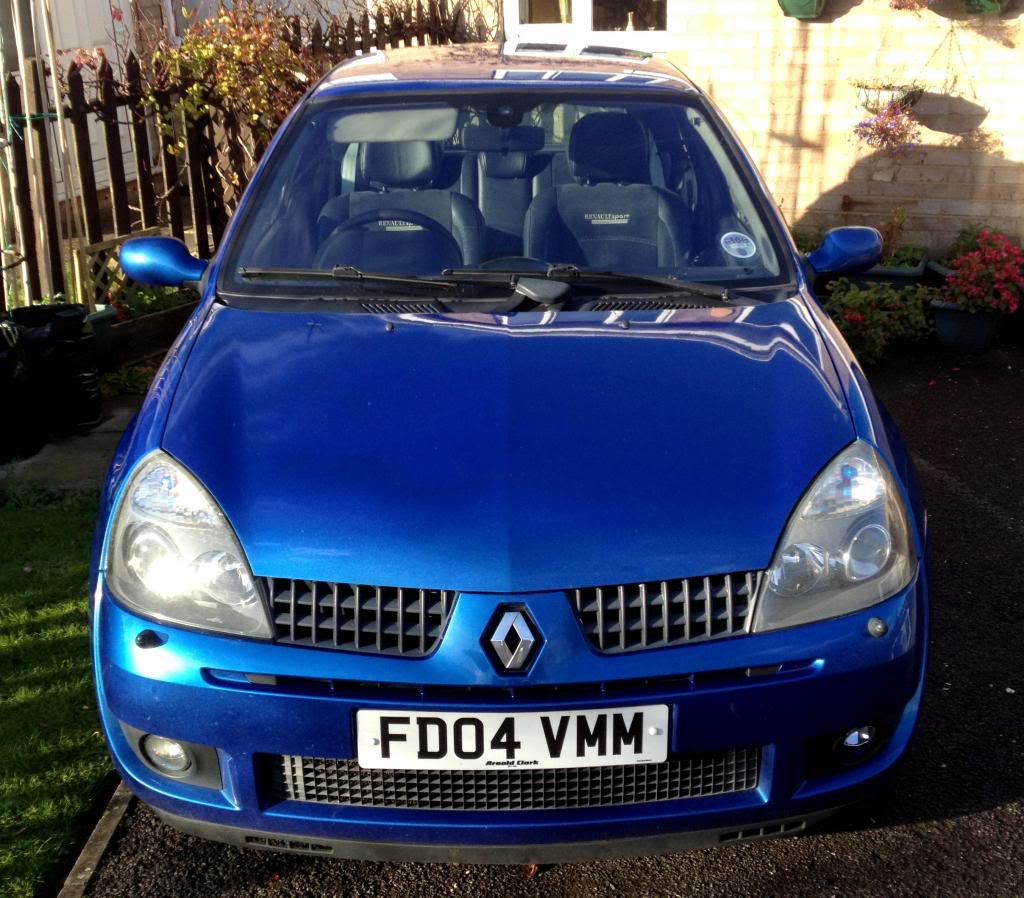

Here's how it looked on the day I brought it home:

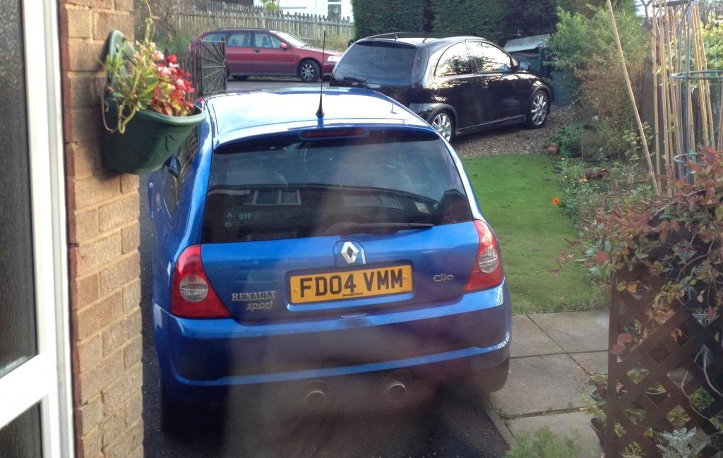

In this photo from my lounge window you can see my old Corsa in the background (now for sale):

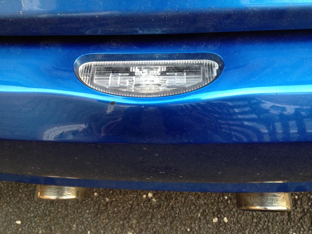

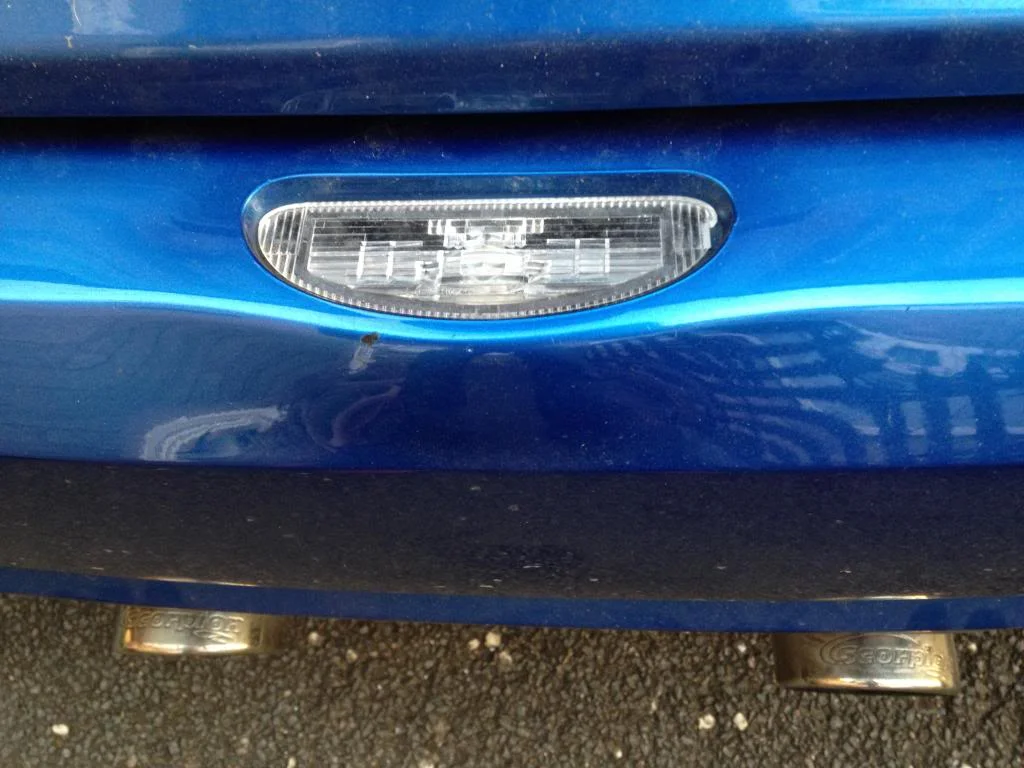

Before I had the car home I'd already been on eBay and bought a new number plate light, so that went on immediately:

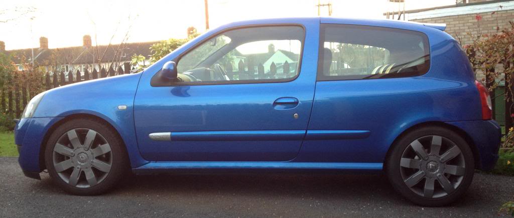

I had also already bought some Cooksport lowering springs from the group buy recently organised on this forum (that membership already paying for itself). The drivers rear shock was completely knackered and so cornering up until now had been quite interesting. Today the new springs were fitted along with new genuine Renault rear shocks, and new exhaust mounts. This is the before shot:
And after:

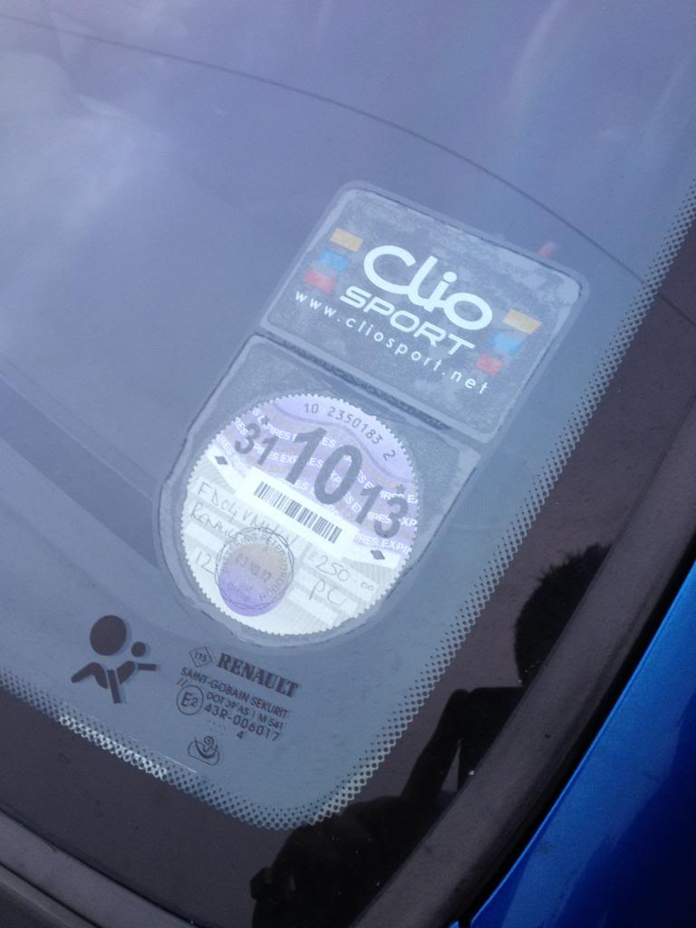

Fitted my Cliosport tax disc holder:

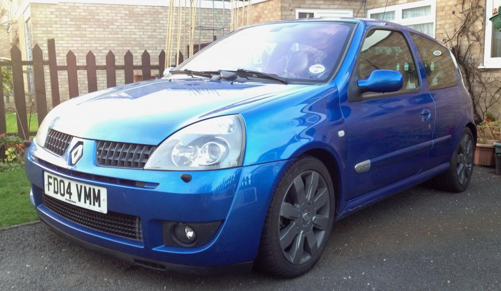

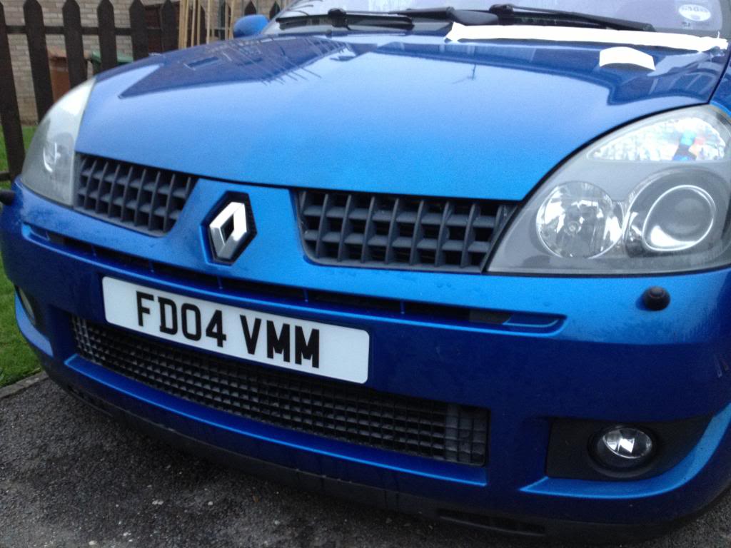

Also fitted my new plates, rear is plain normal and front is plain 3/4 sized:
I really like the way the car is looking now. After the recent work it is amazing to drive and it goes round corners on rails - I really do rate the Cooksport springs highly. Today I had a parcel from clio_stu which contained a throttle pedal with metal pedal - for some reason my current throttle pedal is rubber and the rest are metal? Anyway, metal one should be fitted shortly. I am shortly receiving a set of Renaultsport mats so they will be in the car next week!

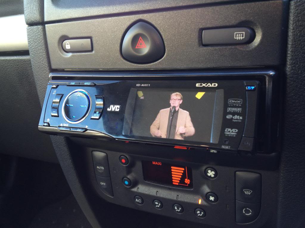

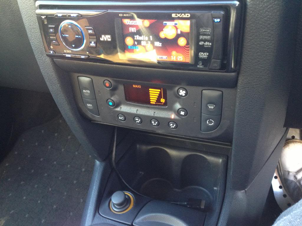

Feel like I made some good progress this weekend. First thing I decided to do on Friday after work was fit the JVC DVD headunit which I received earlier that day - fitting stuff to your car in the dark isn't advisable. Here's the start I made:
I got it in pretty quickly, here is a daytime photo of my efforts:

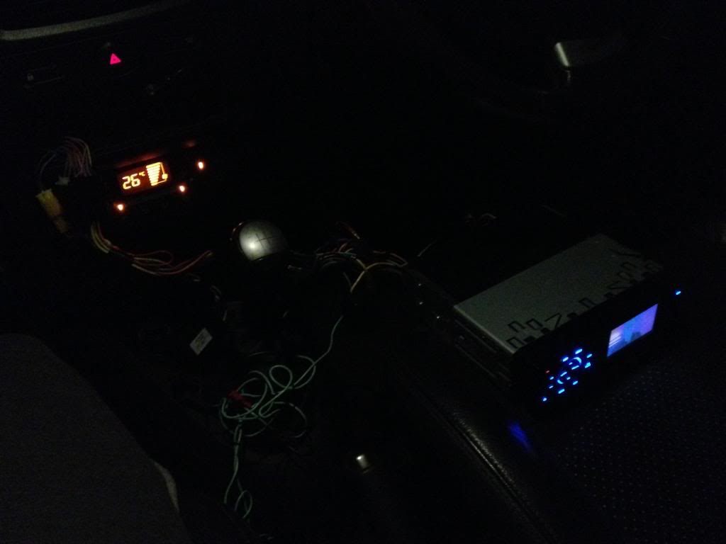

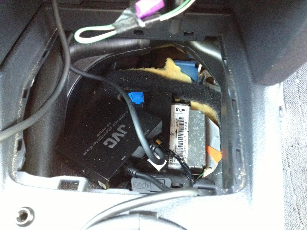

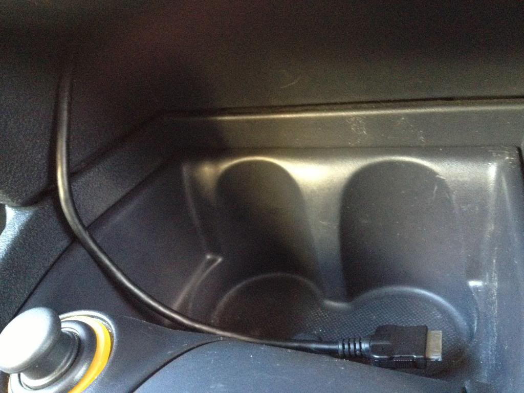

Today however, I took it all back out and fitted the iPod adapter that came with it. I did this by locating the unit under the cup holders (there was just about enough space) and threading the wire up through the dash. The iPod end I decided to stick through a gap in the panel located just under the climate control unit. I think it looks ok and it certainly works great:

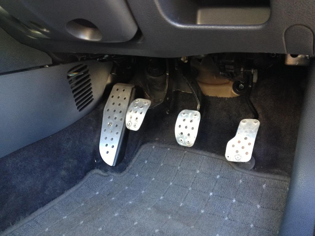

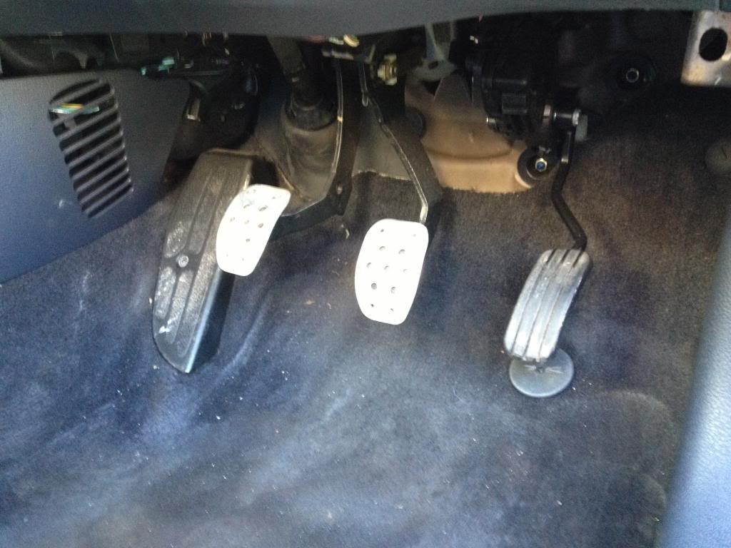

Another job I did, and my favourite in terms of the visual improvements, was the throttle pedal. As you can see in the pictures below my 182 had been fitted with a rubber pedal for some reason. I purchased a metal one off a fellow cliosport member and fitted this (with a tiny lil trouble when I didn't plug the throttle in properly), along with a metal foot rest. I think the improvement is great and it all matches at last!
Before:
After:

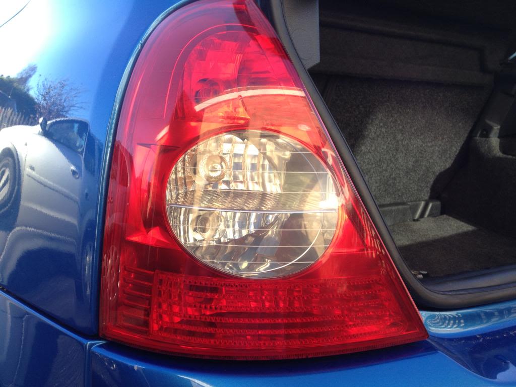

And another tiny job; Silvervisions in the rear lights! It's all about the lil details:

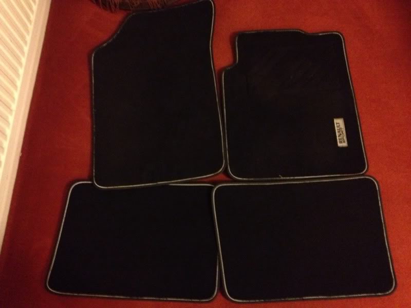

Got myself an absolute bargain today! One of my mates recently wrote off his BG 182 and so offered me his Renaultsport mats for all of £15 - they are in great condition so I snapped them up straight away.

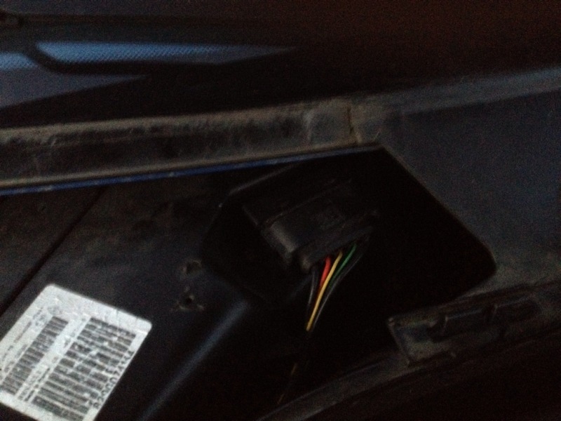

Looking good mate, heater fault will no doubt be the resistor. Have a look in the guide section theirs a thread on how to repair in an save your self a couple quid.
Throttle pedal is a dodgy one. Maybe the previous owner done it to stop his foot slipping off the pedal as the sport ones are quite slippery when wet.

Cheers Bobby. I've taken the resistor pack out this evening and am sending it off to a guy on eBay. I'm looking forward to getting it back and having heat in the car!

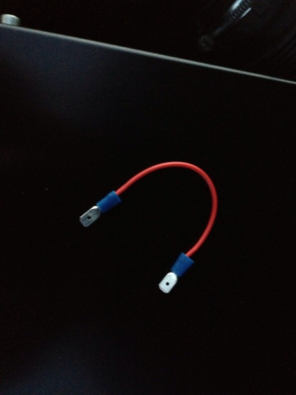

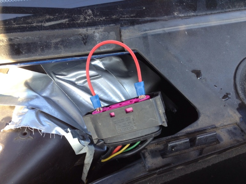

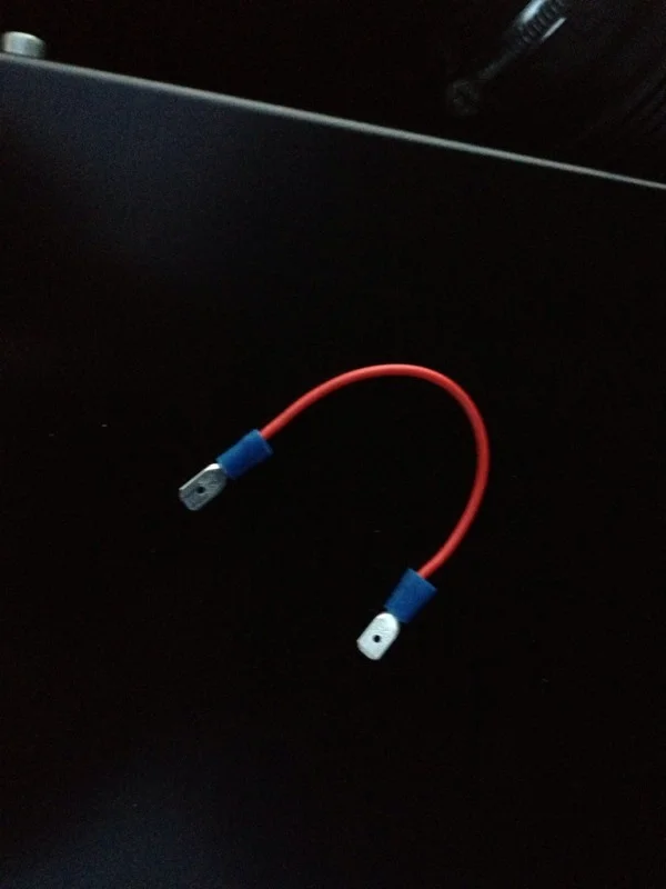

This morning I bridged the resistor pack plug to bring the fan on full time. Also bunged a couple of old sockets in the exhaust mount and cable tied them in, this is only temporary but at least the exhaust is sitting straight for the time being.

Little update again. I sent my heater resistor pack off to a guy on eBay to be fixed, in the mean time I made a little bridge for the plug and drove round with the blowers on full. I also fitted the black battery cover, as you can see below!

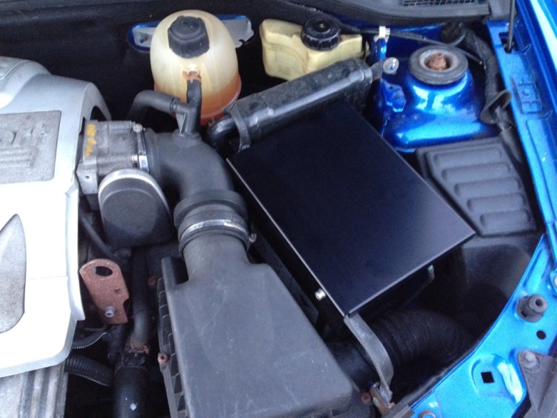

Little update today - I bought an induction setup off of Kizza9 (top member, sent it out next day for me), it came with a Samco bend, alloy pipe, and K&N cone filter. For the time being I have decided just to fit the Samco bend, although I may have a play with the rest of the setup in the future.

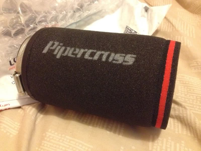

I have just ordered a nice new Pipercross filter to go behind the headlight, I already have the alloy bend that came with the Samco so this weekend I am looking forward to fitting it all and having a nice induction roar.

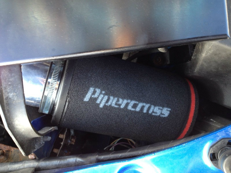

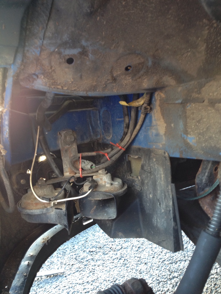

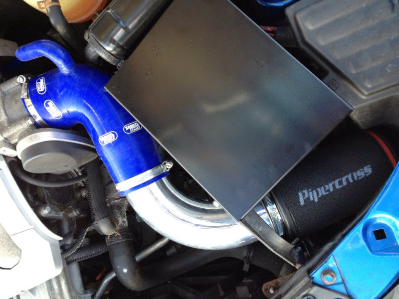

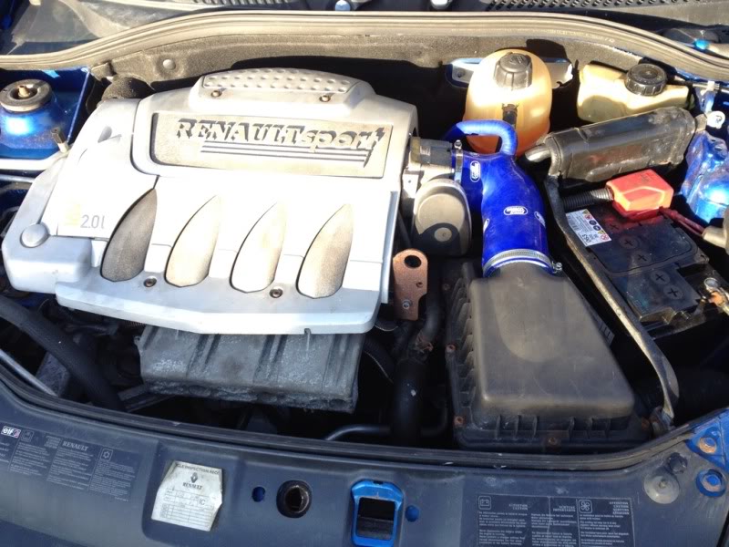

First things first, off comes the passenger side wheel along with the arch liner. The acoustic valve then came off, bolt in the end of the lil hose, and tie everything up.

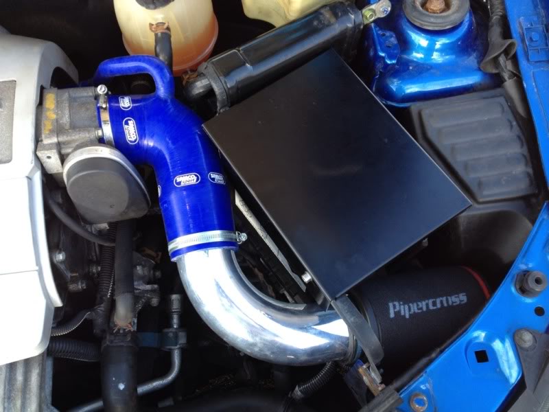

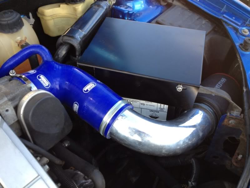

Next I went about removing the airbox and the two air feeds, replacing them with an 90 degree alloy bend and a Pipercross filter I bought from Regals Motorsport. I wasn't 100% sure whether the Pipercross would fit behind the headlight but as you can see it went in there easily with a little room to move around and position. I think the setup looks great in the bay.
I've taken it for a quick drive and the sound is amazing!! Driving sensibly up to around 3.5k you cannot hear it at all but as soon as you open the taps it roars and puts a massive smile on my face. I'm really happy with this set up (some might say similar to the k-tec item) and it has cost me about £110 all in.
I'm very interested to see what you guys think?

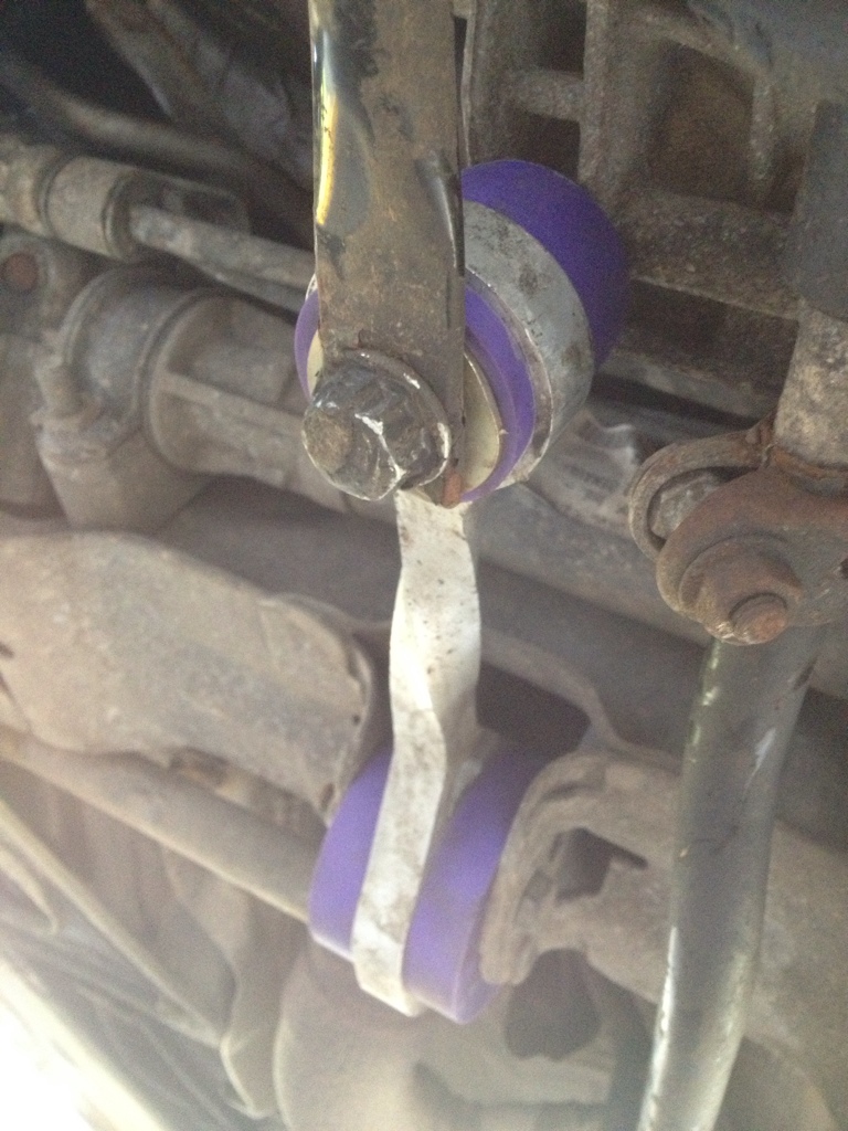

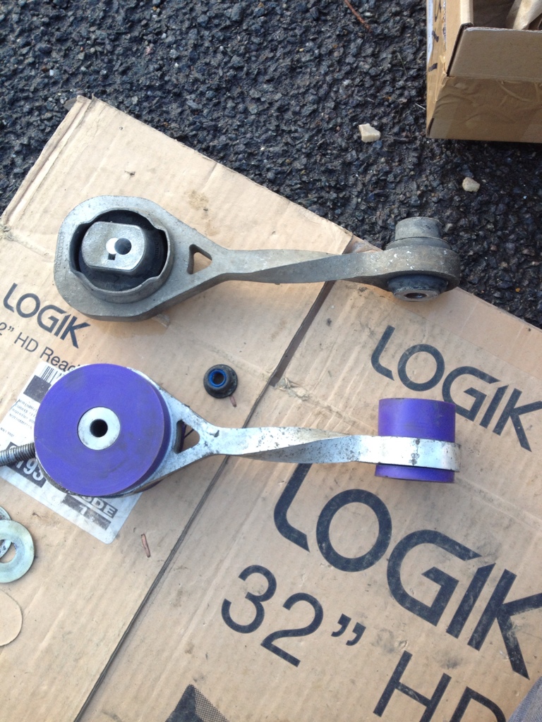

Second job was to fit the Powerflex'd dogbone mount that I also purchased from Adam. This job was actually a pretty quick one - jacked the car up, unbolted the old standard mount, bolt in the new Powerflex'd mount. I'm glad I decided to do it this way rather than pressing the bushes in myself as this way was soo much easier!
I've taken it for a test drive and can really notice the smoother gear changes and the engine doesn't seem to move so much when putting your foot down whilst going through the gears. Really impressed with this modification and for the £30 I paid I think its an absolute bargain! Highly recommended.
