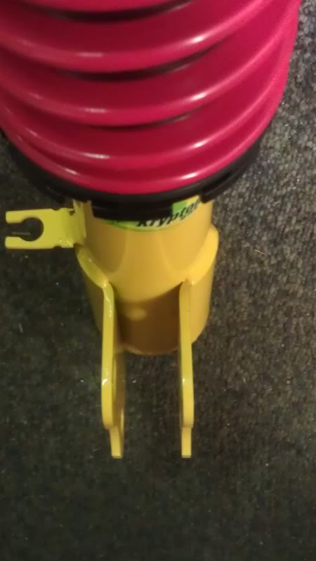

I've read about 4 people now though that have said they don't fit Cups as they're 2mm too narrow to fit the hub and have to go back to be fixed.
it's absolute nonsense. For a start cups have the same hub spacing as a normal 172
If you look at the plates, they're designed to be tight, they are attached to the strut in such a way that they act as a clamping spring (something which SPAX felt was important to do with the camber adjustment relying on clamping force) you just have to part them slightly when assembling
You can see the welds do not go all the way to the edge, deliberately to allow this flexibility
  DON'T SEND ME PM'S!!
Email reply sent to me when discussing this reported "issue"
The fact is O.E style brackets are always loose because they are designed to clamp around the shockabsorber tube as well as the hub when tightened.
The Spax brackets fit half way around the tube. The load is spread over a large contact area with the body tube. The material used for the brackets is quite flexi to allow it to flex without fatigue issues this does allow it to bend to make it fit!.
Many aftermarket dampers simply have a lazercut plate butted up to the body tube. The problem can be that the contact area with the tube is small and the brackets can tear away from the body tube around the welds. Also the highest stress levels are at the welds which have altered the structure of the metal around them.
i should mention that the cases you've mentioned were not apparent to me, maybe if they'd gone through me they'd have been given the correct information
I'll ignore that nonsense then - I did think when they said they were 1.5mm too narrow that I'm 90% sure my bilsteins flexed more than that lol

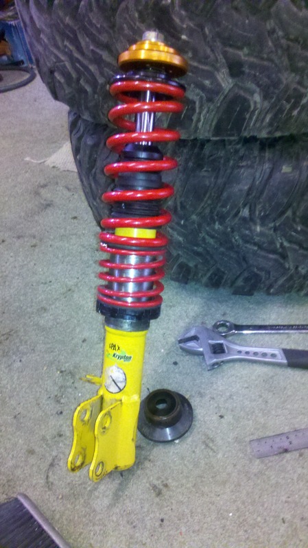

generally you can get most things unsiezed using a bit of force and soaking things for a bit. I left Emma's bilsteins soaking in a parts washer overnight, and then used a set of stilsons with a 4ft scaffold tube to undo it, It put up a bit of a fight, but was fine after a few rotations..

Oh right Lewis seemed to think the height adjustors were seized and they needed spanners to adjust?
No either i have miss worded my ad, or you've read it wrong.
I haven't tried adjusting them, i don't know if they have seized, can't see why as the threads are minty clean. I don't want to sell them and end up in Chris205/BlackGold's position, being accused of saying the wrong thing, just want to cover my a*se.
Also i'm not actually that far from you Phil, so i'd happily meet you in the middle so you can inspect them before buying :)
Didn't realise they had been re-valved and springs changed to be the same as yours Tony, bit of good news :) Does that mean they are more valuable? ;)
