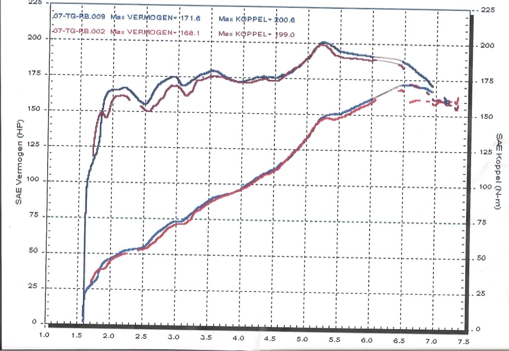

i got both.. :approve: top lines torque, bottom HP at the wheels
