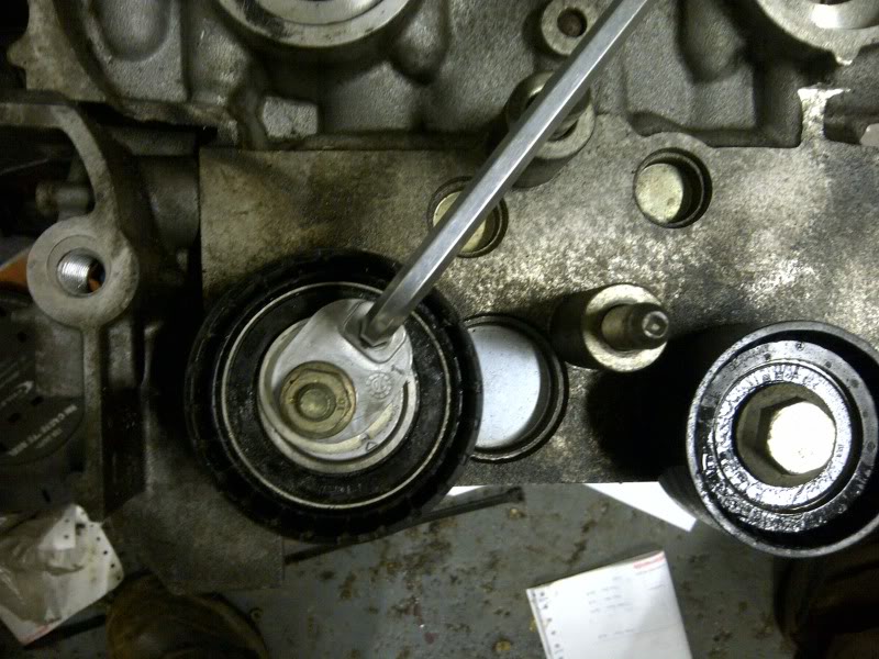

how the tensioner should look when fitted

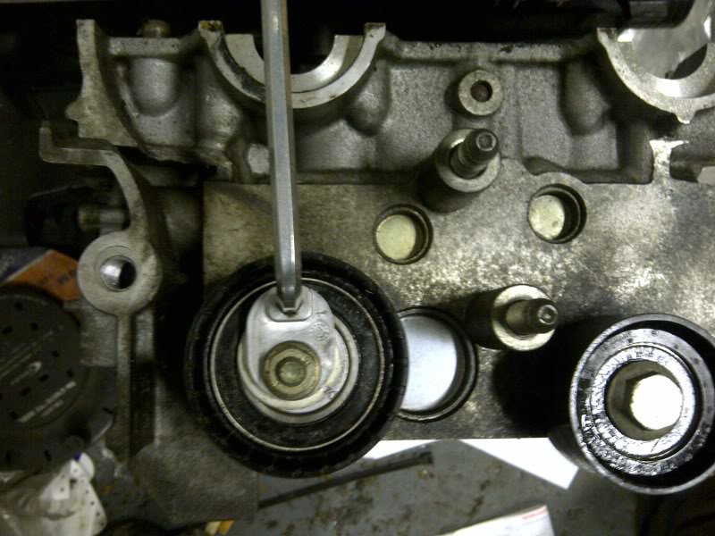

but it can be fitted thus
note the notch/arrow on the tensioner both line up in both pics, lower image is the wrong way to do it
I see, so if mine is anything like the 2nd pic its incorrectly tensioned and hitting its stop.
What is this stop? is it just making noise or is is doing any harm?

i'll take some pics on monday of the back of a tensioner so you can see what i'm banging on about, the ratio between the front side and the back is huge, if you move the tensioner 1mm on the front it equates to about 5mm on the rear hence why its so important to get the tensioner **** on
