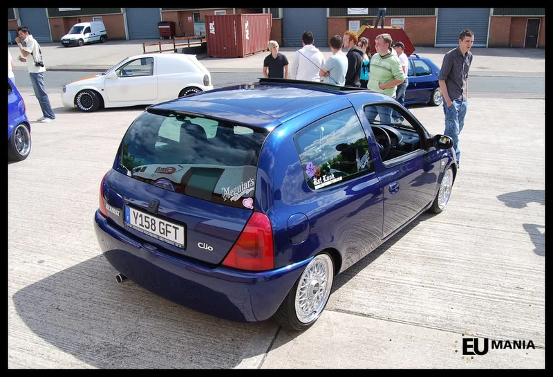

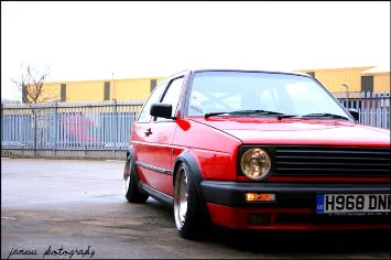

Right, well many people may know me because of the Clio & Golf ive built previously...
The Clio
The Golf

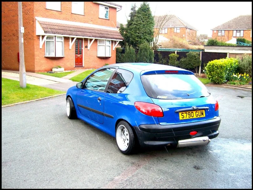

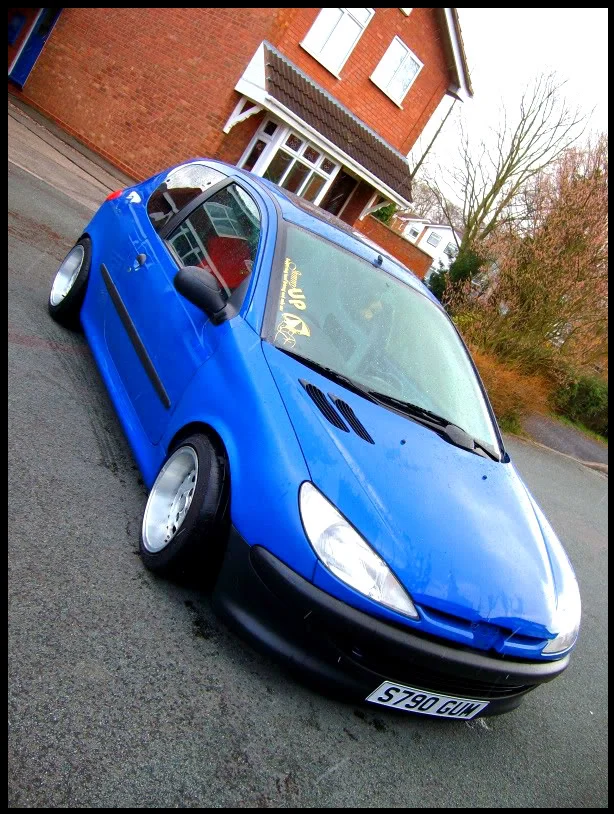

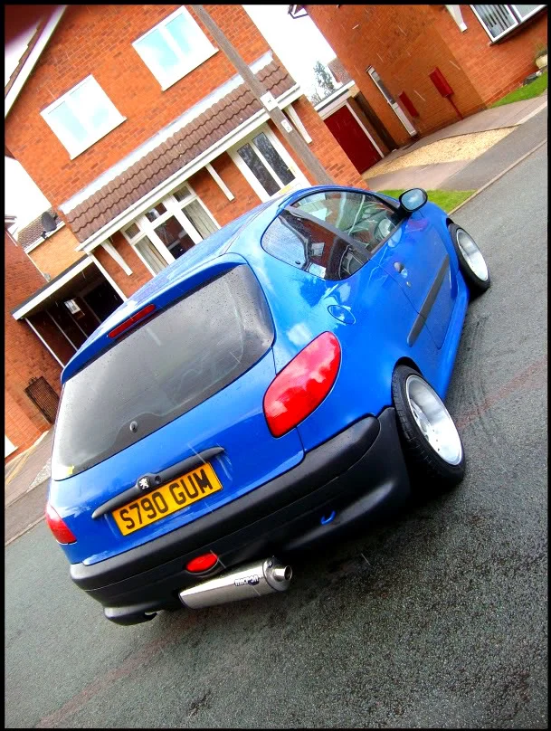

And here i am with my new build. Its a pug 206, that was bought of a forum member on here, 'Leo', of which many of you may know :). Anyway, not being one for modeling other peoples work, and building my own set out on the new project!
Its only a 1.1L, but in the current financial sitation, its helping me out loads, in terms of fuel, insurance & tax; also supporting my argument of when their finished their not able to be driven fast anyway. :)
Anyone enough of the waffle, after i sold the golf, i saw the 206 for sale in the classifieds, text leo and arranged a viewing with the intention of buying...i got there realising the car needed an awful lot of work, however, i managed to purchase the car with the price reflecting the work needed to get it up to standard.
Ok, so the first day came, and i set out work on the 206. I dropped the coilovers to the bottom of the thread; also removing the helper spring, meaning its physically impossible to drop the car any further. I also fully stripped the interior, leaving one seat and the dash; and adding a few personal touches like the 'jimmy up stickers'.

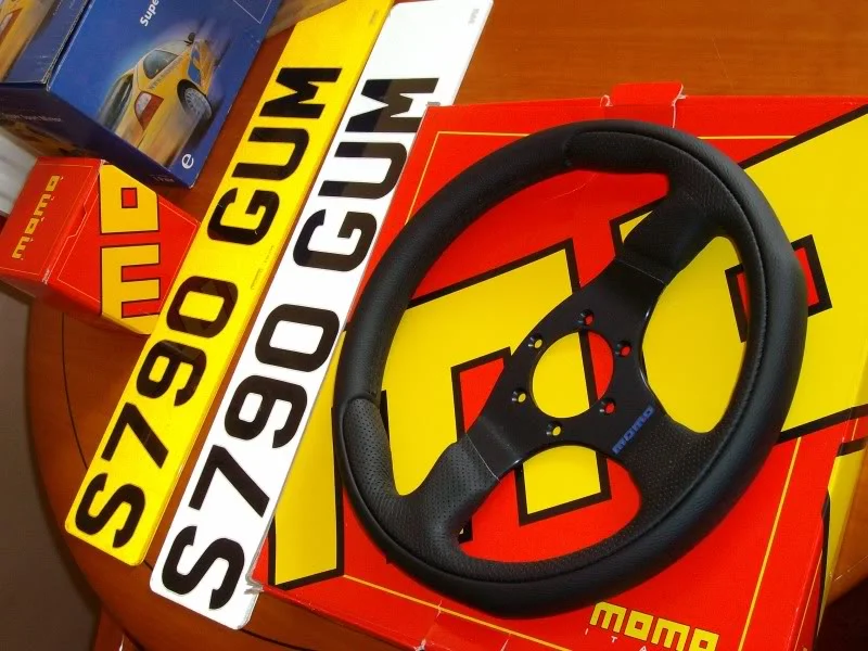

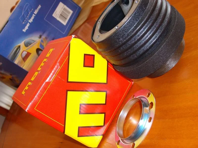

First of all i purchased a 300mm Momo Team wheel; The ultimate overdone euro wheel' however for a reason, And a matching Momo boss to compliment it.
I then made up some new number plates, with the intention of cutting them down to suit the next stage of the modding treatment the pug was about to recieve...;)

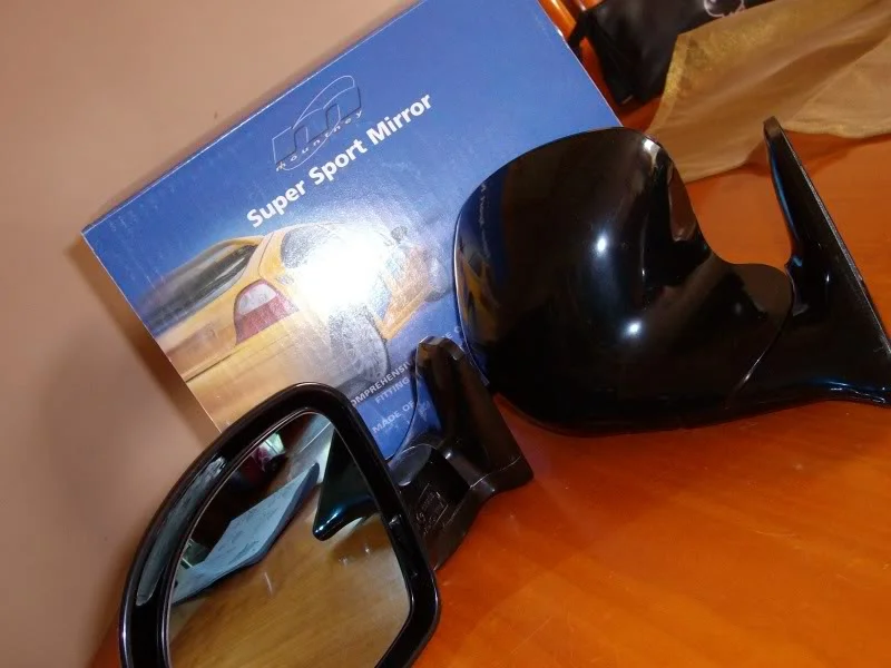

And some replica BMW M5 mirrors; however they were sure to undergo a bit of cut, shut & smooth to make a fully custom mirror set up :)

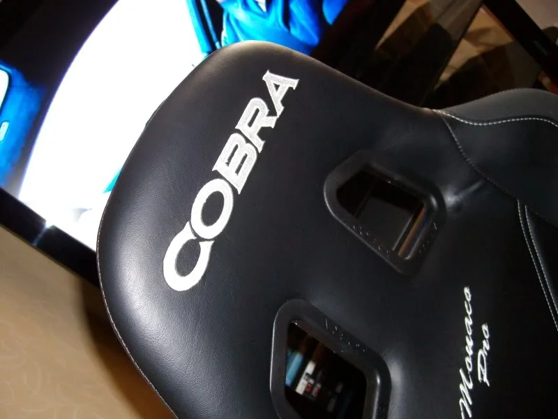

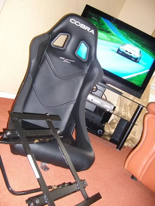

At the same time, i also purchased a leather Cobra Monaco Pro seat to compliment the interior, along with a sparco harness and tilting & sliding subframe.

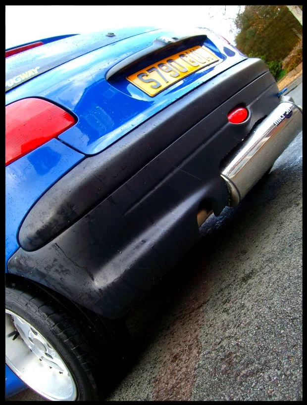

Right, after the ordering and purchasing was complete from halfords, i got on the phone to phil at powerflow in stafford to make me a full custom SS exaughst system; using a motor bike can as the backbox lying across the back bumper.
Out to be different & set the trends; not a sheep and to follow them.

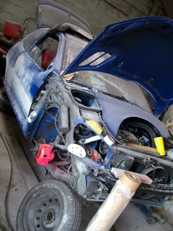

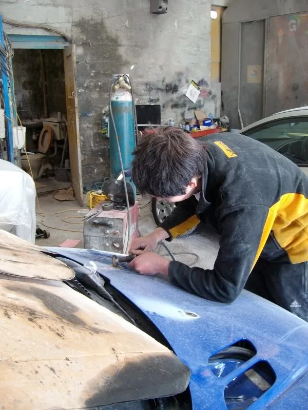

First of all, it was time to strip the pug, ready for the work to be carried out; so off came the lights, moldings, numer plates etc...

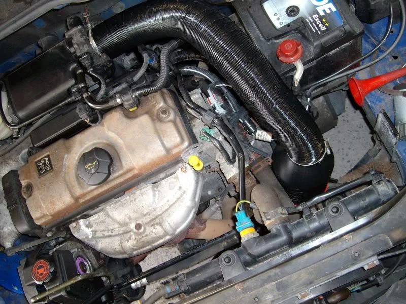

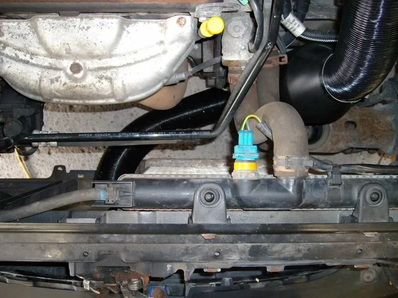

Whilst stripped,i found out that the breathing modifications were'nt up to scratch and needed addressing, so a trip back to work and they had been sorted with a BMC DIA enclosed induction it.

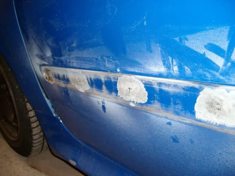

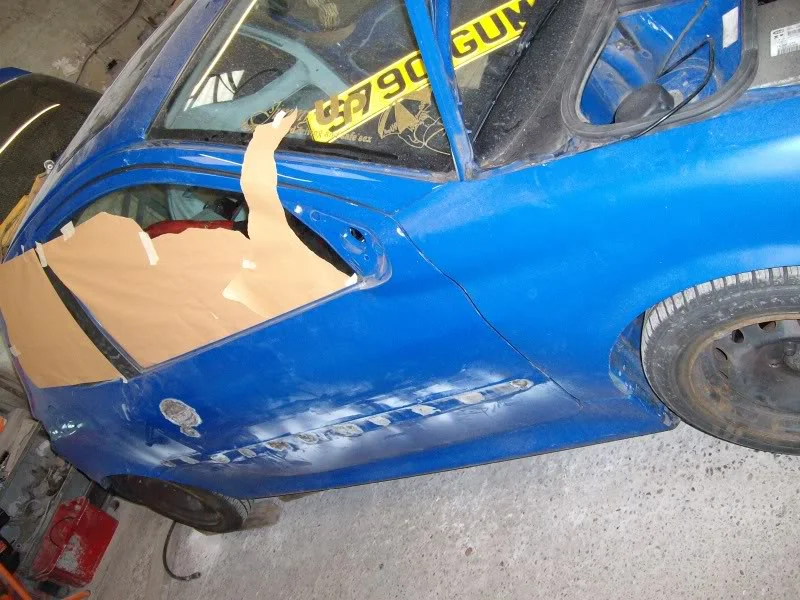

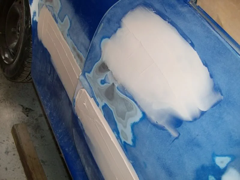

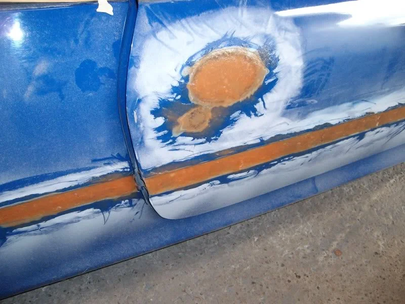

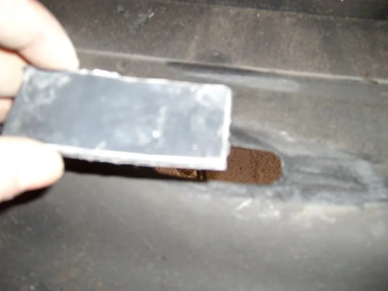

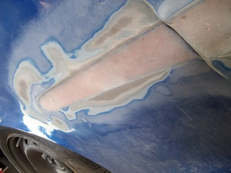

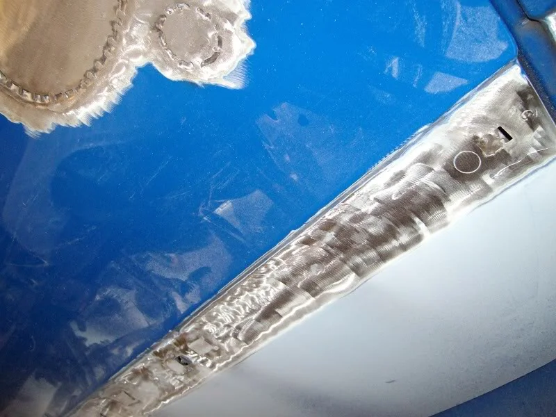

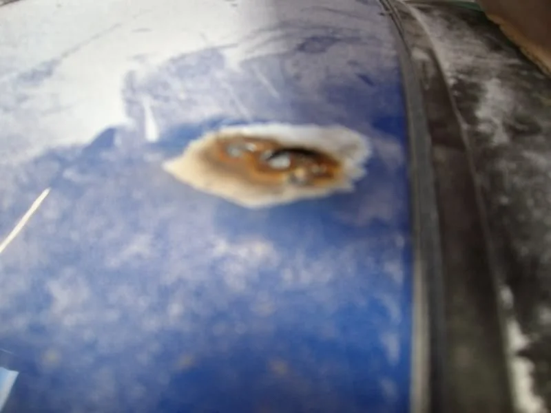

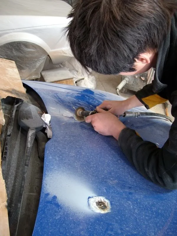

With that sorted, and the car stripped, i set out welding the holes under the side mouldings to help prevent serious sinking in the future, and also plates over the locks and door handles. So first of all i set out sanding back the area to reveal the bare metal, and began welding the plates needed to cover up the holes.
I then ground the protuding welds back to create a smooth as finish as i could :)

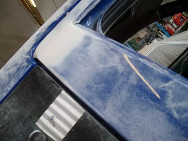

The i continued to D/A the area back, ready for its first layer of fiberglass.
Then its first layer of fiberglass was applied.

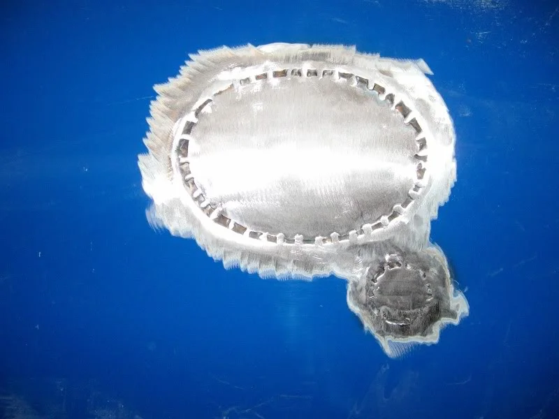

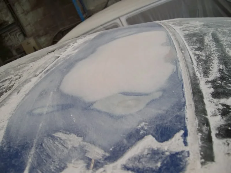

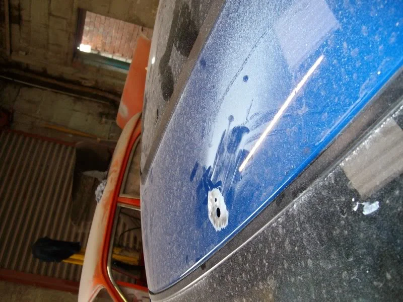

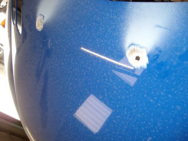

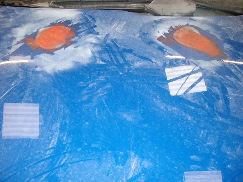

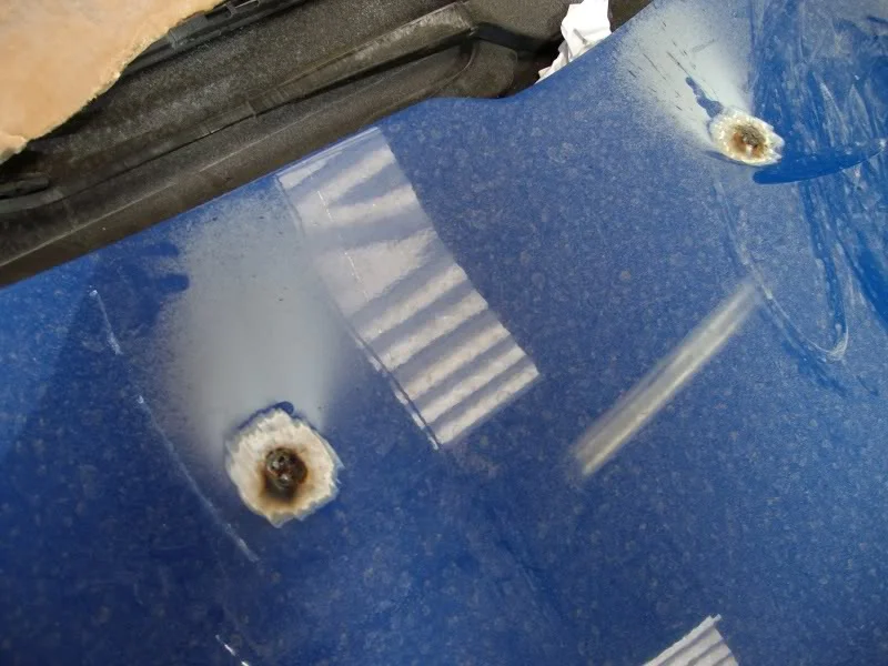

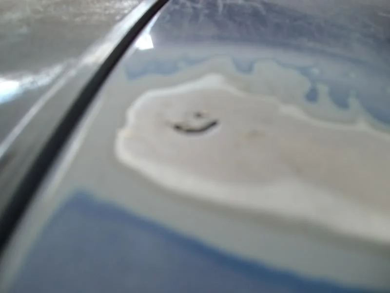

Whilst that was drying, i then set out work on the ariel and washer jets.
So first thing first; set out sanding back the area, ready for welding.
Washer Jets
Ariel
Then i welded them up :)
Washer Jets
Ariel
The again, i grinded the welds back, to stop them unwanted protuding.
Washer Jets
Ariel
The i applied the first layer of fiberglass...
Washer Jets
Ariel
And D/a back
Washer Jets
Ariel

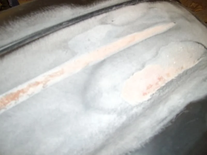

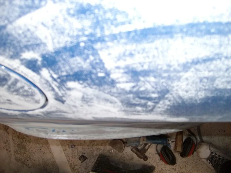

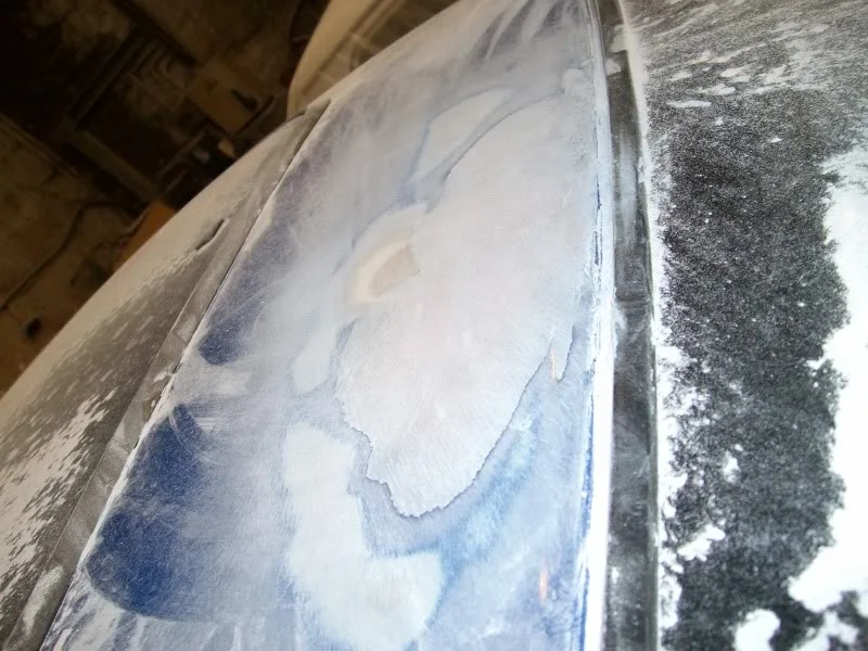

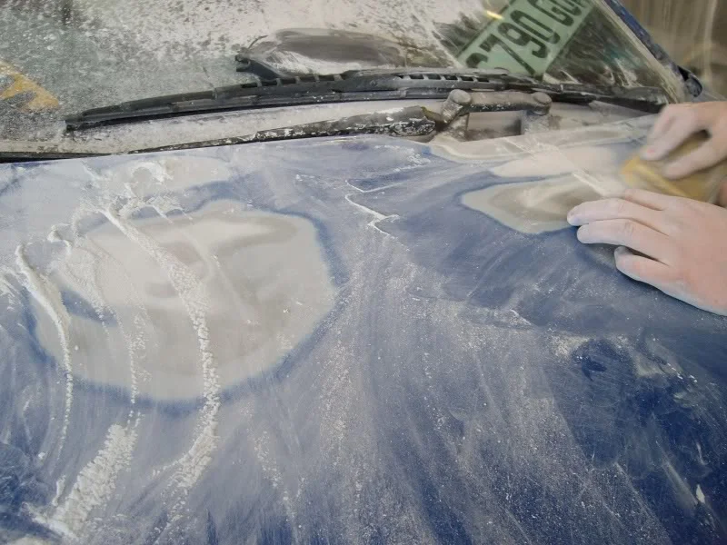

With that done, i decided to sand down the sides of fiberglass; D/A
And apply the first layer of filler....

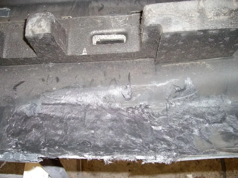

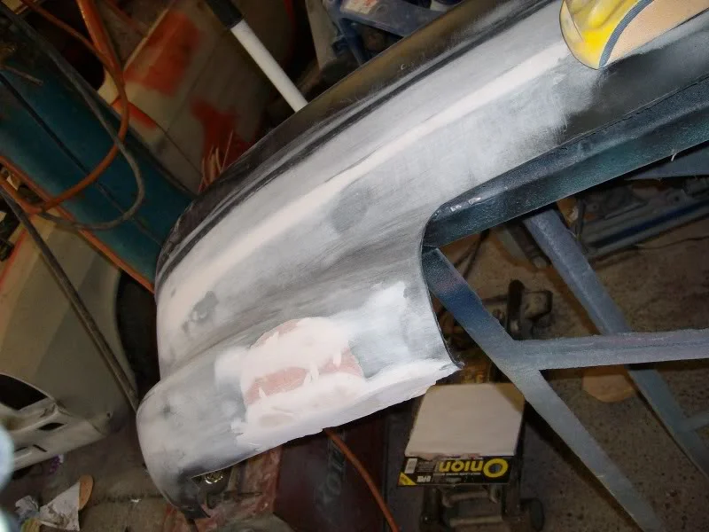

Ok then, so now i started work on the rear bumper

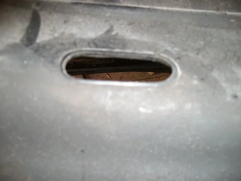

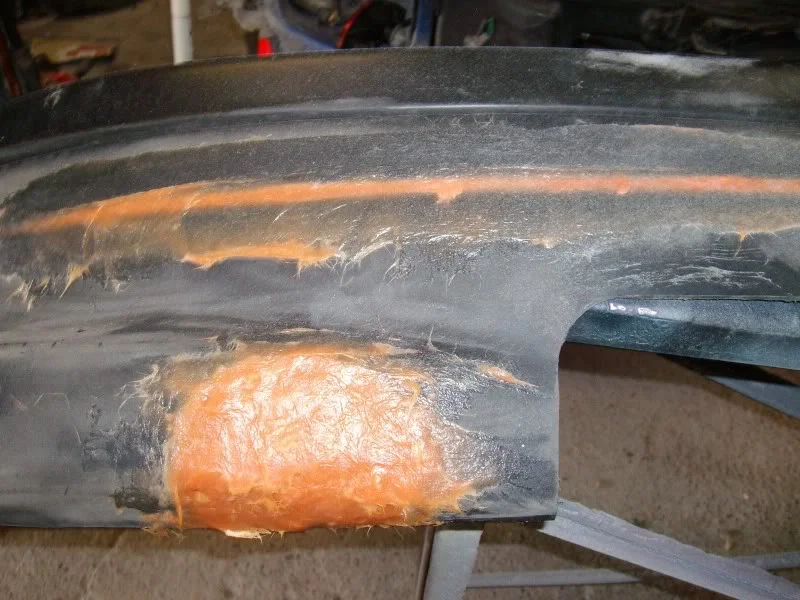

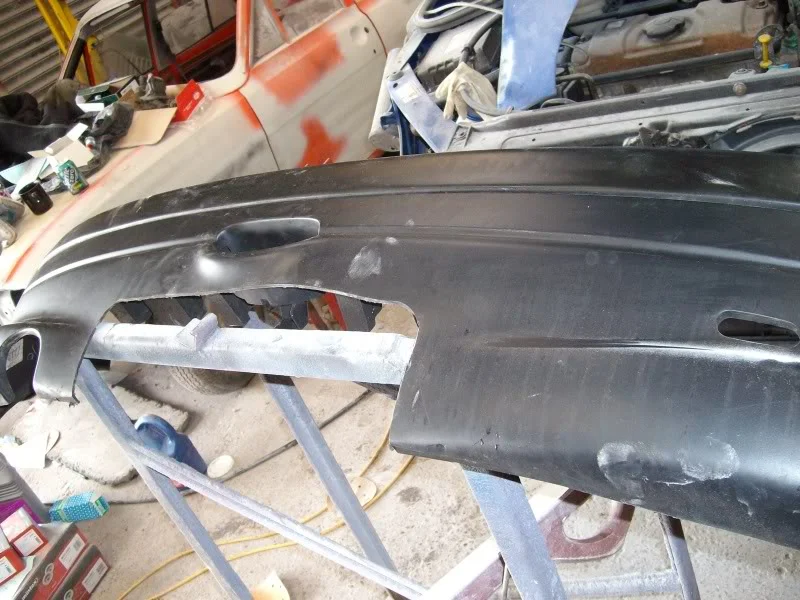

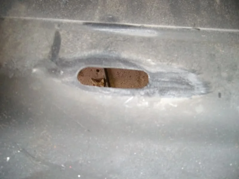

Removed and onto the bumper racking; ground down the towing eye and old zorst cut out ready for pastic welding

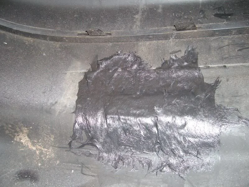

The i cut out erfect peices of plastic to cover the holes from the rear.
I then welded them into position and renforced them with a carbon fibre layer.
Flipped the bumper over, and have it its first layer of filler, covering the recess line, towing eye and old zorst cut out.

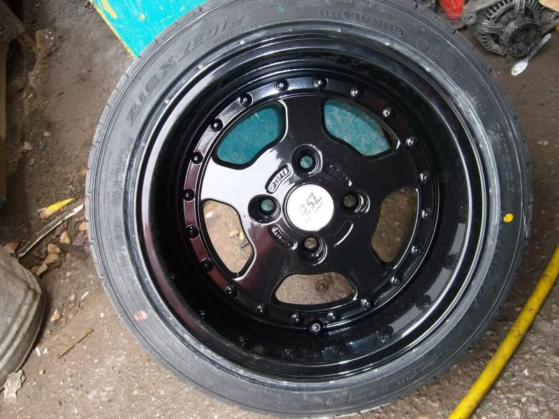

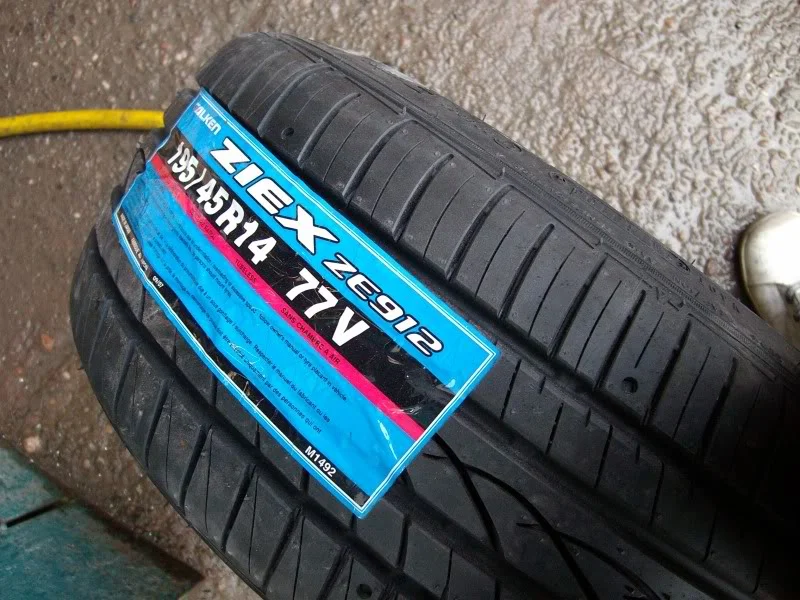

Theyre the origional RSL cults, however ive had them powdercoated black with new falken rubber fitted :)

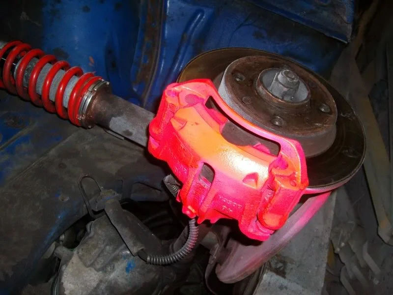

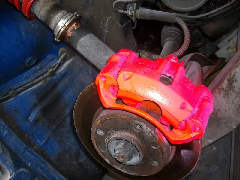

And I also painted my front calipers a florescent pink! :eek:

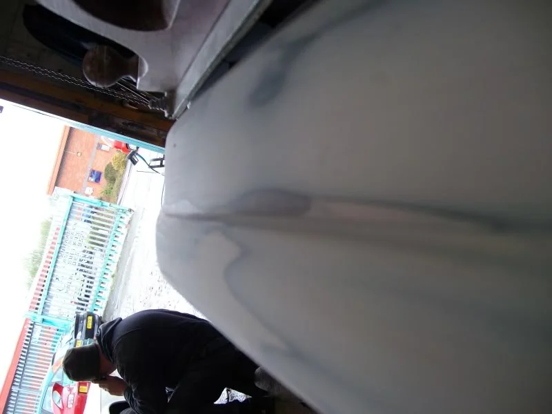

With the bumper dry, i sanded back the fiberglass
and applied and sanded back the first layer of filler...

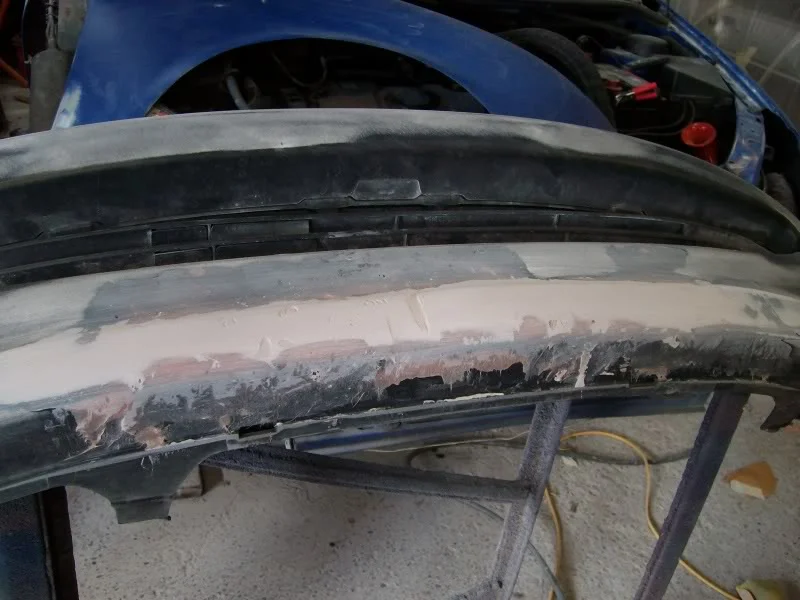

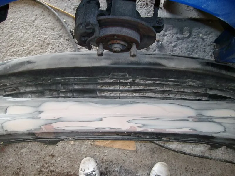

I then decided to crack on with the front bumper...
So off it came, and filler was applied to make a flase line through the origional number plate recess

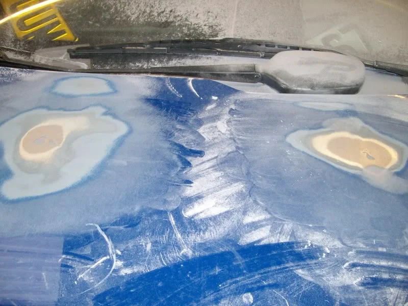

With several layers of filler & Fiberglass, i managed to get it looking like this; fully smooth ;D

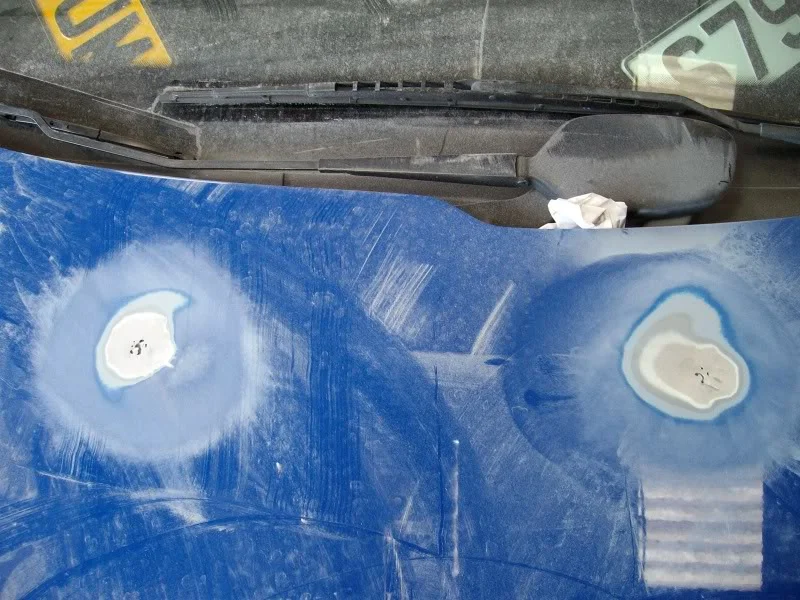

I then applied, a layer of filler to the ariel and washer jets & sanded back...
Washer jets...
Ariel...

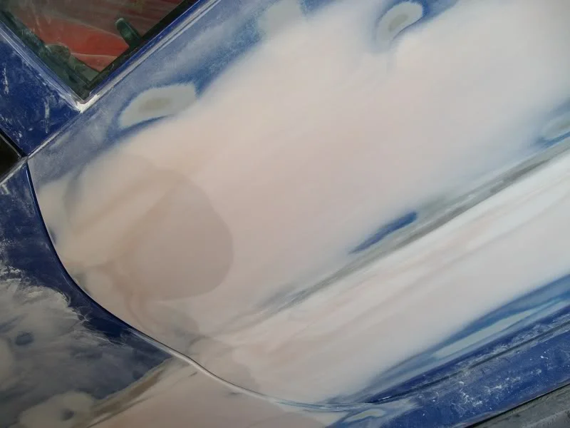

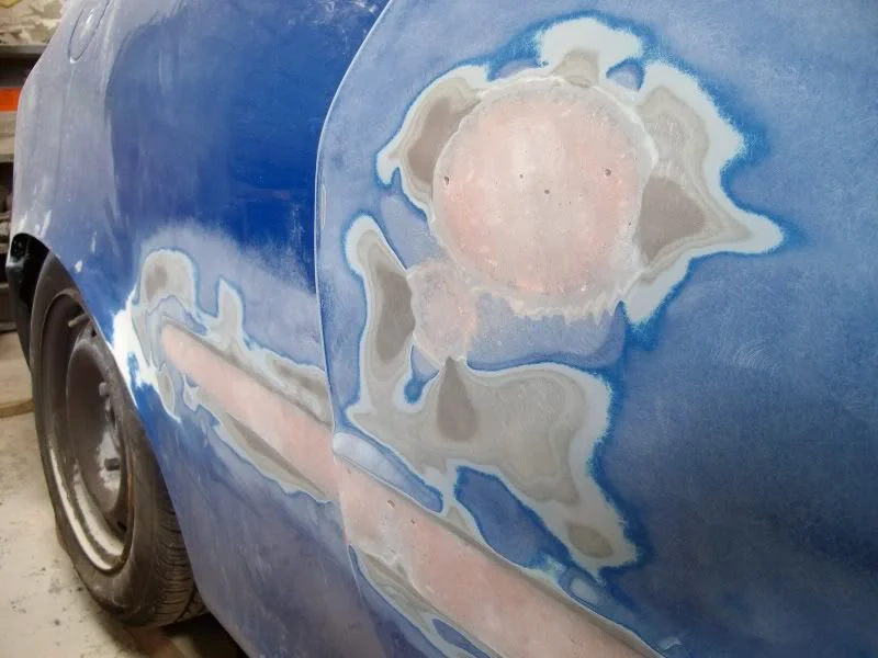

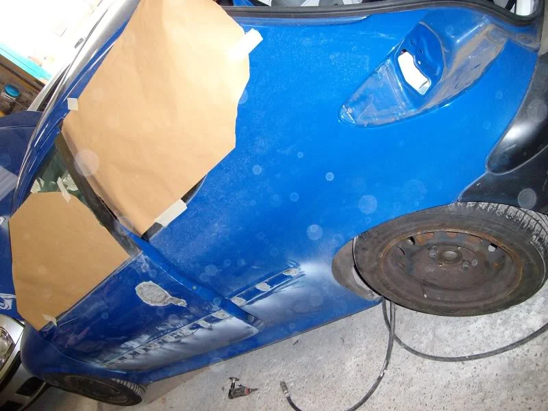

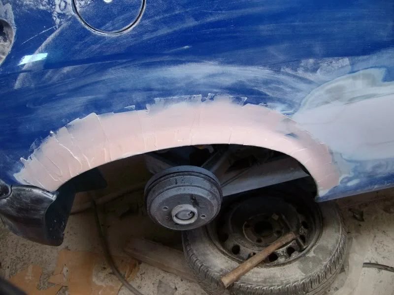

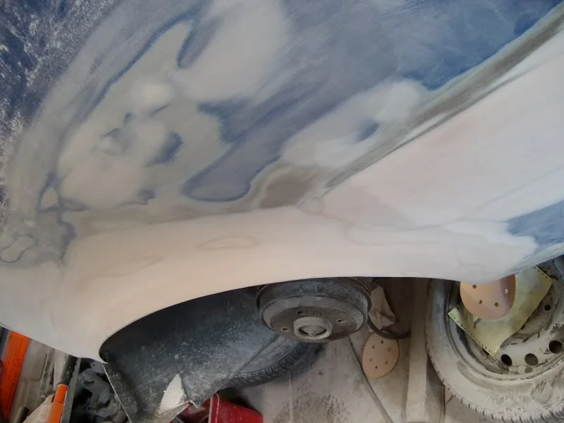

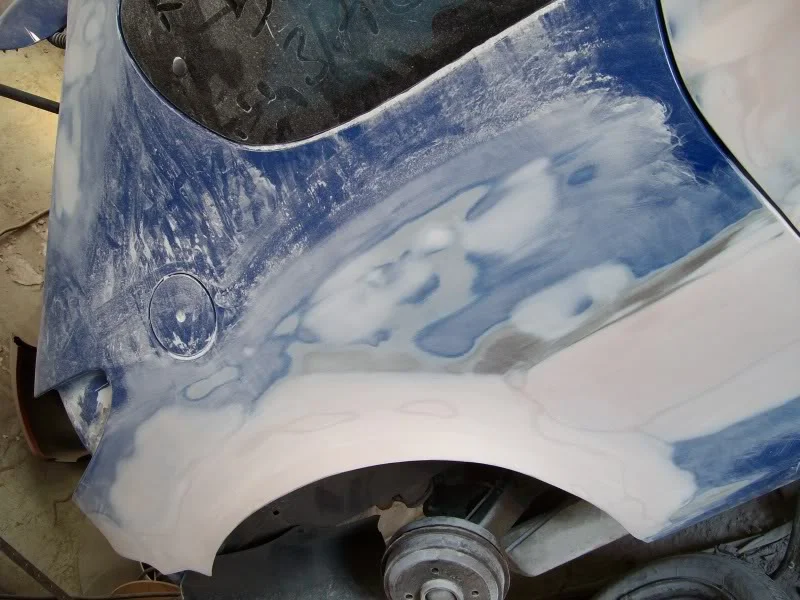

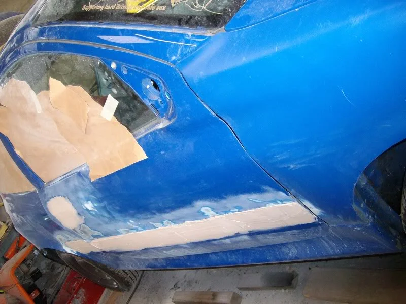

So with that done, i decided i needed to flare out the rear arches more, so out those mothers came!
And with their first layer of filler applied, they looked something like this...
And i left it there looking like this...

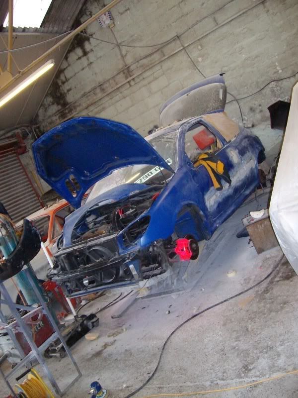

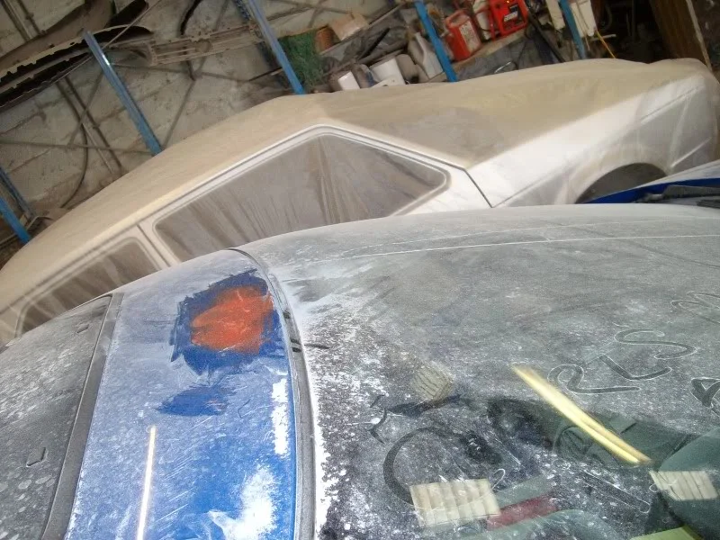

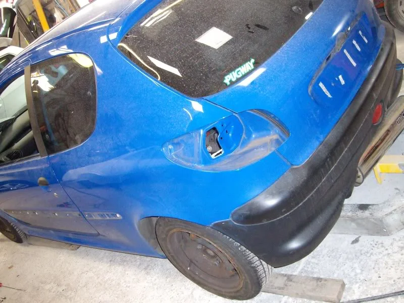

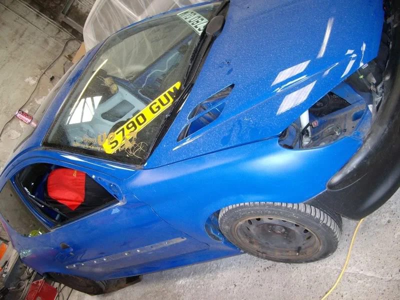

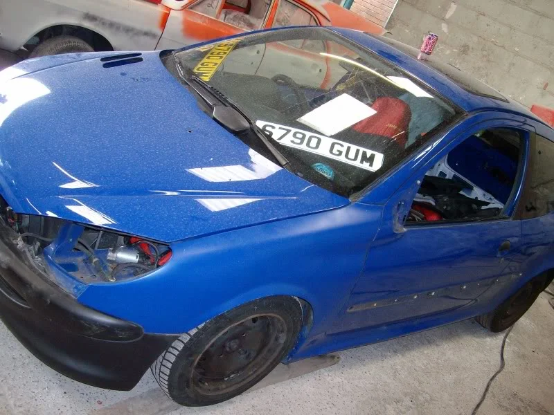

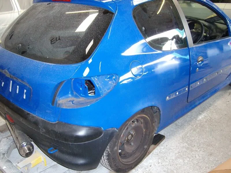

So thats my work at the bodyshop...i then left it in their hands, and returned to find this!
Smooooooth COMPLETE rear arches

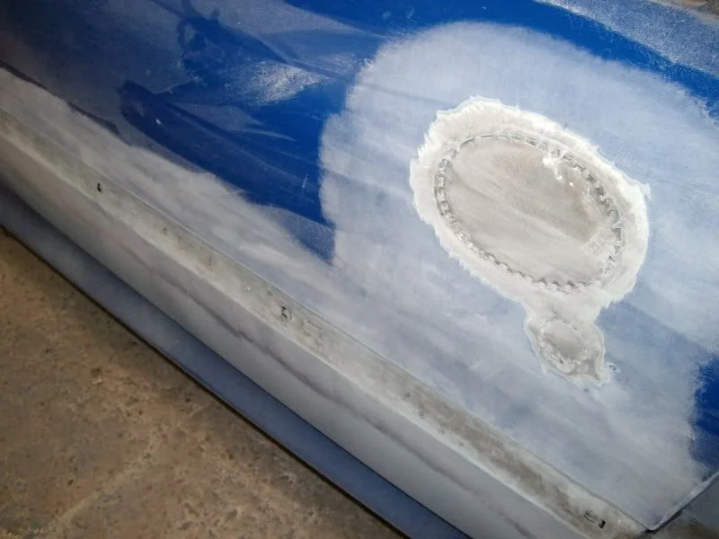

Smooth COMPLETE door handle, lock and side strip removal
Smooth COMPLETE door recess

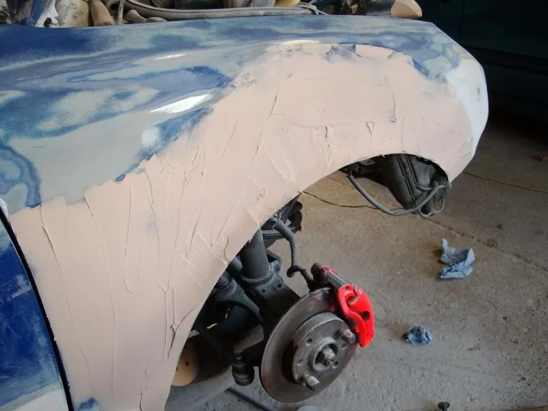

& the front arches flared to f**k with their first layer of filler on ;)

Looking very good so far, and i have liked all your cars so no doubt it will turn out a stunner!
Excellent writeup and plenty of pictures, not too sure about the exhaust but the rest looks tip top.
  Integra Type-R DC2
Excellent mate! Im sure it'll look the tits when its done. What ever happend to the Golf? Really liked that car. Was my desktop background for ages.
Rob
Always enjoyed your builds man, and this one is no exception, despite being pretty much anti 206, i'm sure this'll look quality.
Any reason you chose the 206 over all the other hatches out there?
Only things i'm unsure about are the exhaust, i think it should be straighter? i.e run more inline with the rear bumper, similar to how some old vw ones do and the front doesnt look that low for you!
Pep
  M2,XJS,S1000RR
Dude!
My mate owned this car about 11ish month ago!
I got him to buy it when I saw it advertised on another forum, it was so low it used to catch on cats eyes going down the motorway! He sold it as he bought it for a sensible daily driver but it clearly wasn't!
I'll direct him this way....
  172 Cup, AX trackbeast.
I appreciate the effort that you're putting in to it, but to my eyes I can't see that looking decent. Exhaust especially.
I'm not a fan of the Euro look.
Isn' the cold air feed a bit overkill for a 1.1?
  Rb 182
I like all the work going into it, all looks top notch.
But i'm not loving the exhaust. I hope ill end up eating my words as the rest of your builds have been top!
  172//Crap Micra//Bus
Some fantastic work going on there bud, brilliant to see you getting stuck in yourself. Not 100% on the 206 or the Xoust, but sure it'll come on well. More pic's of Golf required though TBH.
Lee
  BMW M2C
I'm really looking forward to seeing the finished product Ross.
As with your last two, it's not something I'd ever think of doing, but I love your cars. So many original bits, yet so clean and Euro.
I loved your clio and I loved you Golf. I hate 206s with a passion, but... I think I like where your taking this...
  RenaultSport 172.
cheers guys :)
yeah, appreciating this a little more as its all my own work :)
Some marmite mods on the build, but im trying to mix loads of modifying styles together to build something different. May work, may not :D
Addz
  Trophy, TVR Tamora
great thread, hats off for getting dirty and having a go at it! Looking forward for the next update
  ValverInBits
My thoughts exactly. Loved your previous work, especially the golf. Hope this one turns out well. Really hate 206s normally tbh.
Looking good so far.
  ITB'd 182...
Like the flare on the arches and the wheels also!
Just a little sceptical on the exhaust but hope i get proven wrong and love it :)
Good progress
maynard
  ph2 172 track car
real good work there, will be nice to see it finished! not too keen on the exhaust though.
  172
I think this is gonna look amazing, you just seem to know exactly what to do with your cars!
I like the exhaust....think it should fit with the look quite well.
I love projects and have a lot of time for your messing around :) so will watch this with a real passion :)
All the best with it chap
Jamie
  RenaultSport 172.
cheers guys...going off the last builds, i have a standard to meet ...fingers crossed i can meet it, or even better exceed it!...mixing the different styles together is deffinatly going to be marmite, but hey!...love the haters ;)
Thanks for the support guys !
liked the previous cars but not too sure about this yet. obv no-where near done so i look forward to seeing the progress!
