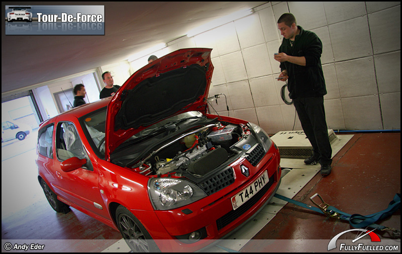

We made good time and arrived at TDF in the early afternoon. My trophy was in the final stages of being put back together and was due on the dyno later in the evening. I hung around and watched a few different cars on the dyno and was grinning from ear-to-ear when the Trophy made it's way over from the workshop. It sounded a LOT different. It was actually sharper, harsher and more like ITB's should be. Within moments it was on the dyno and Matt began to do his stuff.
The good news is that the Trophy pulled as-near-as-dammit 200bhp on the dyno with a healthy mid-160's lbft. Much, much better. And the sound... I can't get over the difference in sound between the time it went in and what I was now hearing. Loved it! But... things then went a bit wrong again. (Have you noticed a recurring theme here? LOL!) Shortly after the above video was taken, Matt was performing a few mid-range tests to check out the mapping and calibration when oil began to leak onto the dyno. (BTM Fred was in attendance at this point and I must apologise for not saying hello properly as I never twigged who it was until afterwards... sorry mate!)
The guys rolled the Trophy out and took a look... A few minutes later... dagnabbit, the cam seals had failed. It was now getting late on Monday night, my Trophy was not going to be ready and I had to again get back to Wales for work the next day. It was lucky that the recovery driver had hung around all day so I jumped in with him and he gave me a lift home. Due to work and personal commitments it would be the following Sunday before I would be able to pick it up... I was still feeling pretty cut-up about Matt's broken car but he was still calm about; despite informing me that it looked like it was the diff that had gone pop. Fair enough, it was one of those things but I still felt bad.

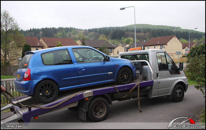

Eventually, Sunday arrived (last Sunday) and my girlfriend very kindly offered to drive me over to TDF to collect the car. Well, I say "drive me over" but I actually drove over myself in her car. Any excuse to get behind the wheel of her Type-R; and what a cracking car it is, too. Mmm, that gear shift is sweet. And so refined compared to the Trophy. Anyways... Matt had been busy trackside at Silverstone with various cars so we agreed to turn up in the early evening to collect it. Upon arrival the Trophy was sat waiting for me, idling over with a nice little burble thing going on. Paula and I spent a bit of time chatting with Matt (including a few potential future upgrade options for the Trophy) before starting the long journey home - and this time with my Trophy. It had been a long time coming. And was it worth it the wait...?
...definitely! The drive back was "fun, entertaining and interesting" and the Trophy was pulling like a train compared to what I was used to. Smoother, significantly more powerful, harder-edged sound, improved throttle response, the odd pop and bang... beautiful. I had to take a few photos when I got back home. Ooh - clean and shiny!

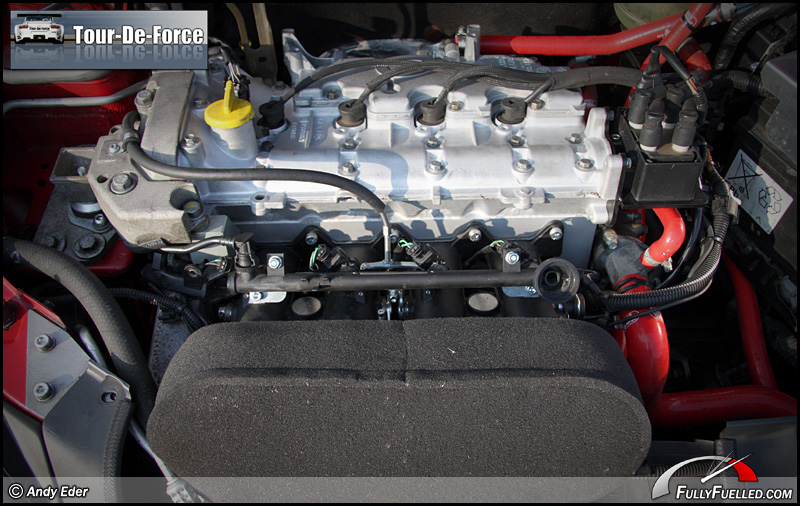

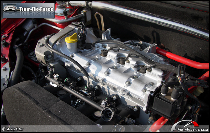

At the time of writing (as seen in the pics above) I am still running the crappy and self-destroying K-Tec filter. It is making a hell of a mess and I'm reluctant to run the car too much until I get a replacement sorted. The good news is that Matt has ordered me an ITG solution and has machined me a custom backplate to fit against. No more disintegrating foam filter and no more filter impeding the trumpets when the foam bumpers get compressed under heavy load... I can't wait to get the new one on to be honest.
So - briefly - what was done?
  • Cylinder head - and reconditioning of components
  • Acid bath dip
  • New valve guides
  • All valve seats recut
  • Head skim
  • Cylinder head pressure test
  • New pulleys, belts, tensioner and seals
  • Replacement of coolant (Motul Inugel)
  • Dyno runs (calibration / mapping)
  • Replacement custom ITG filter (will be arriving soon)
  • Custom machined backplate for filter (will be arriving soon)
