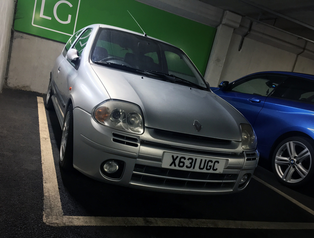

Few more bits done today and a much needed wash ? first of all before the wash fitted a few of the bit's I have been collecting.
New rear numberplate light - before
After

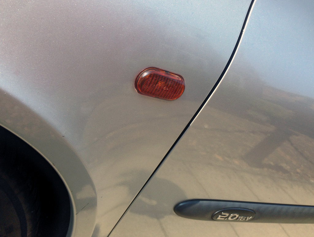

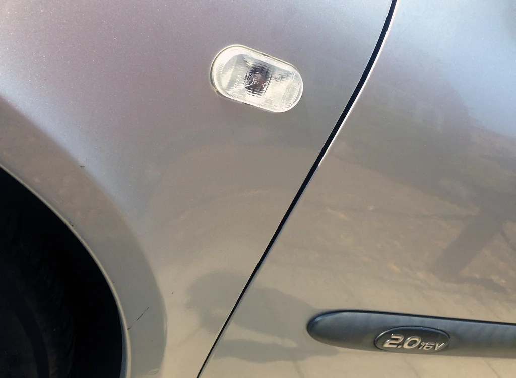

New amber side indicators - before
After
New amber front indicator bulbs - before
After
Also got some pics of the new rear bumper now I have given the car a wash, colour match looks great so far and it's in great condition, a lot better condition than the old one that I removed
Then managed to grab some pics after a quick drive out this evening ?

Looks sooo much better with the amber sides and bulbs, bumper looks great too mate!
Ambers had to be done, think it works really well on the silver and helps break it up a bit, bumper was sprayed when I bought it and luckily colour match looks good which was a bit of a result, have some other bit's to do just have to get round to them ?

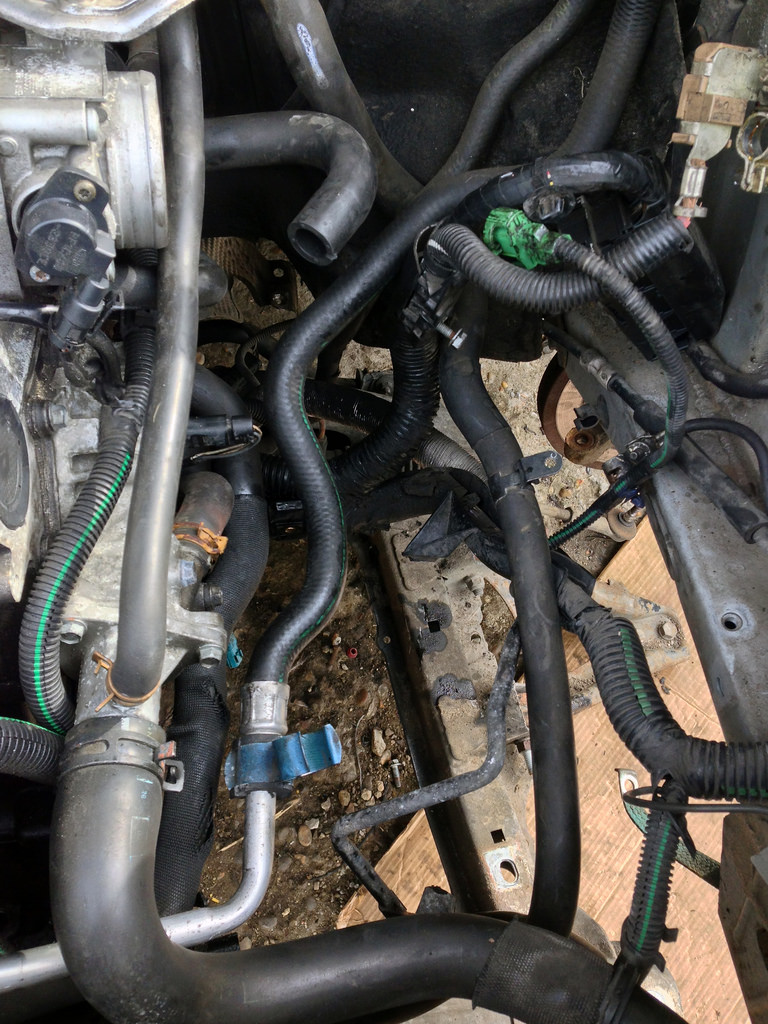

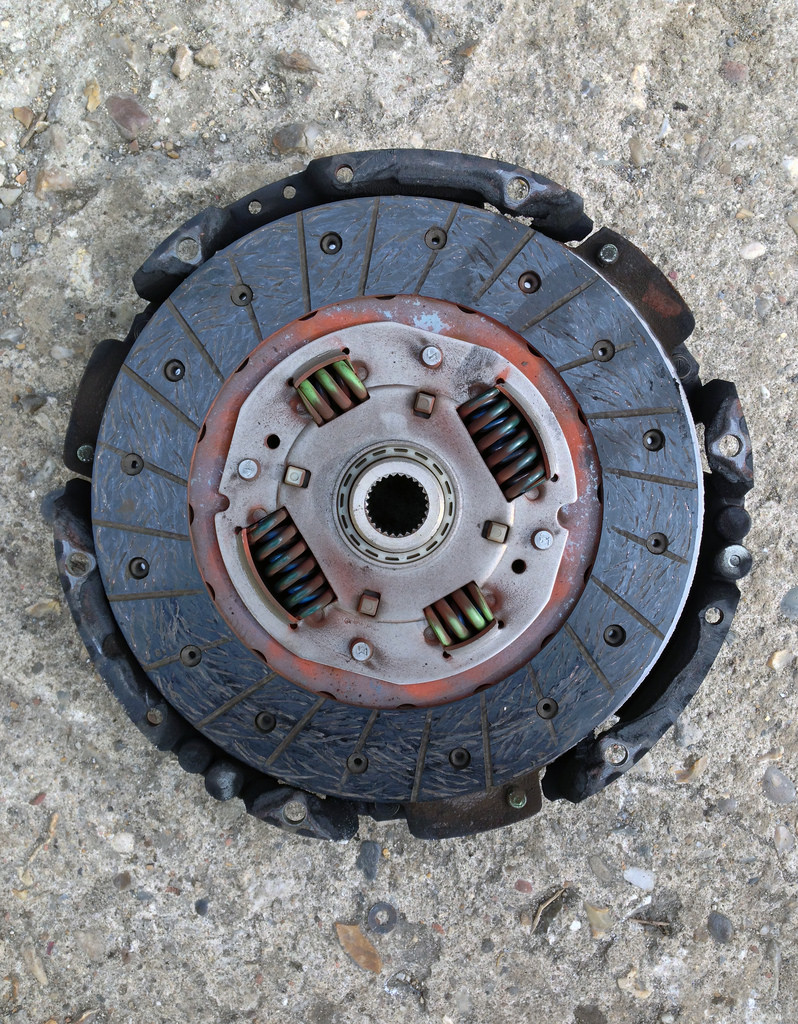

Productive day on the Ph1, gearbox is out no mean feat when we did it on a driveway but we got it done, have an oil leak which I am sure has been picked up on the MOT at least a couple of times but we know where it's coming from so that will be fixed at the same time as the new clutch etc. other than that all went to plan, all being well will get it all organised and back in in the next week or so, managed a couple of pics but they aren't the most interesting ?
Old clutch

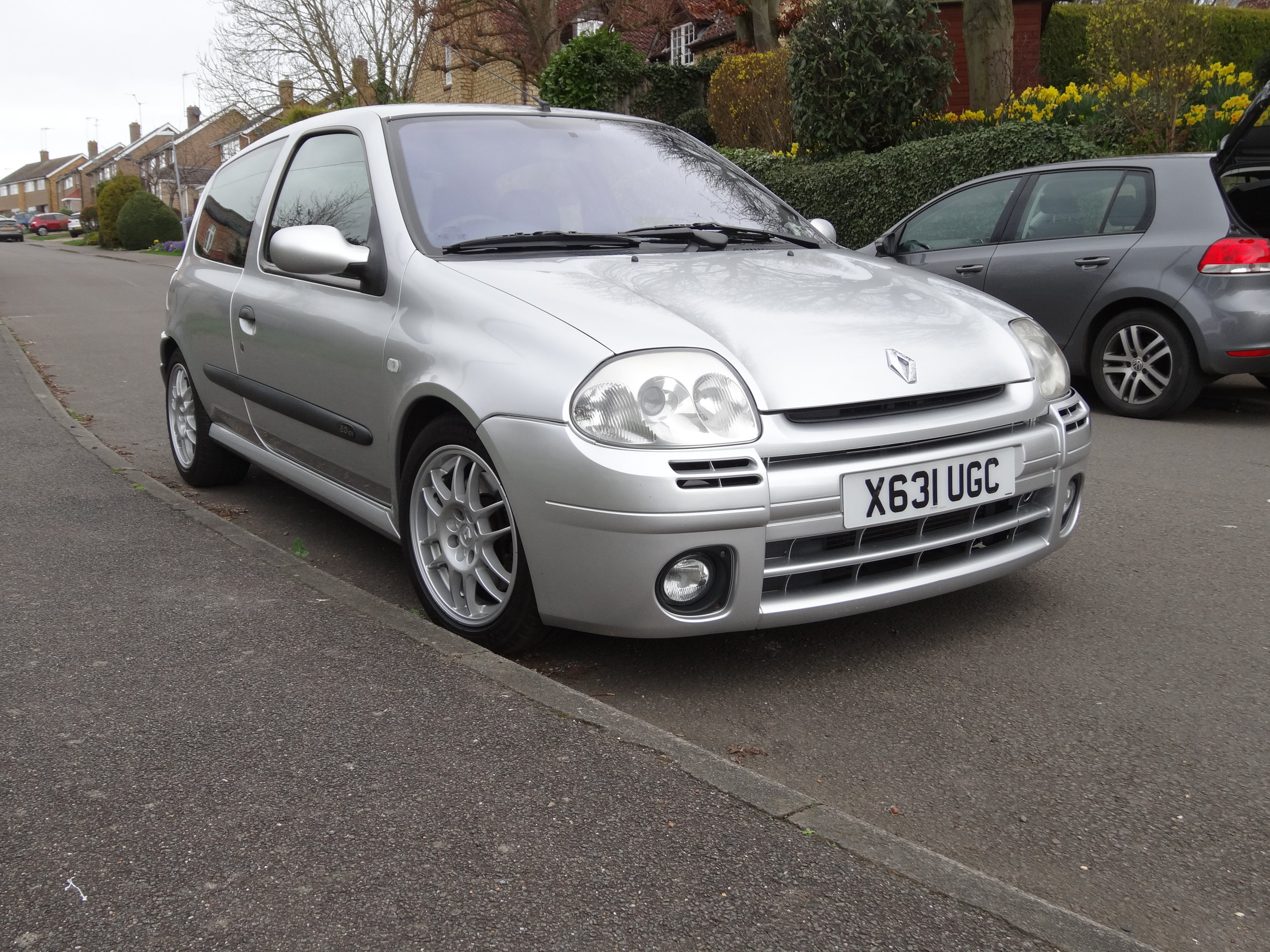

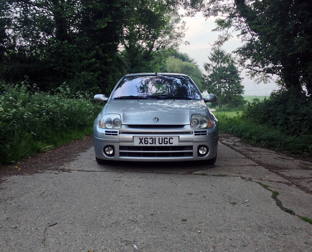

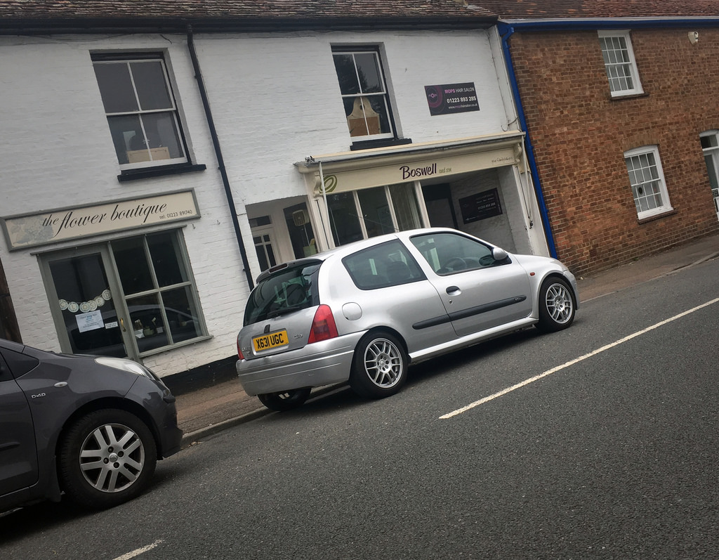

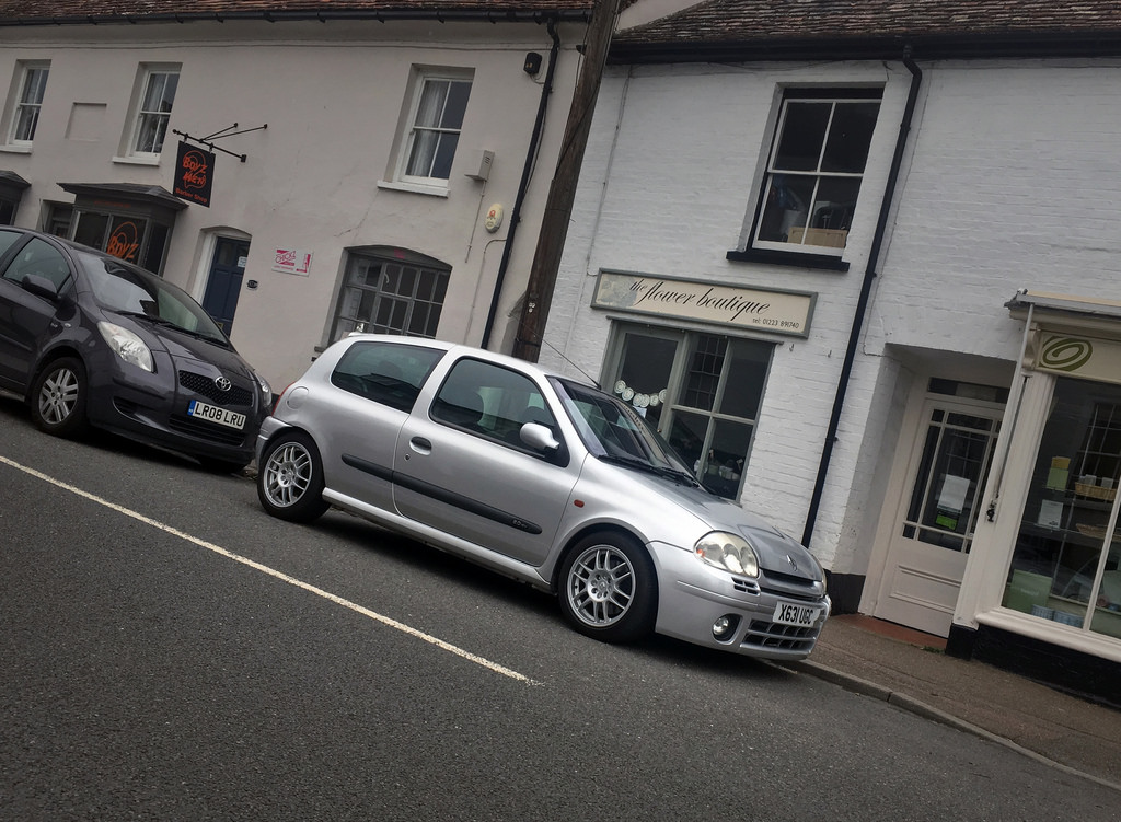

Washed the Ph1 this afternoon while it was raining ?few pics of how it sits at the minute, I haven't managed to tweak the coilovers yet although think the rear is as low as it will go with the adjuster still in, think I need to tweak the front a little still but impressed with the ride on the B14's so far just had a ride out for some cake. Last pic in the car park to show how the 20mm spacer fit's on the front ?and also shows how I need to get the rear spacer on!
mintno1
  Ph1 172 / Mk1 Valver
The new height (not too low) & spacing of the front wheels makes it look 'spot-on' - looks so tough in that rear-quarter view ?
Yep going to have a proper measure on a flat/level surface and make sure all heights work, then will get tracking done once I have done that, just incase! Coilovers came with camber bolts which aren't fitted but could add them if needed, will see what happens ?

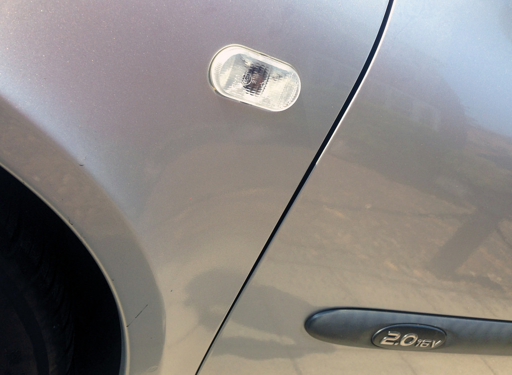

What's the crack with the door/wing in this pic
Looks like it's been painted and they have gone up to a tape line
Never noticed in person but that was a very sunny day though, would explain something though as the lacquer not quite the same as the other panels, plan on claying/machine polishing etc so will have a closer look and see, have looked back through other pics but don't have many of that wing/door. Can see very slightly in this pic but does look like it's in the lacquer rather than paint
But hardly at all in this one

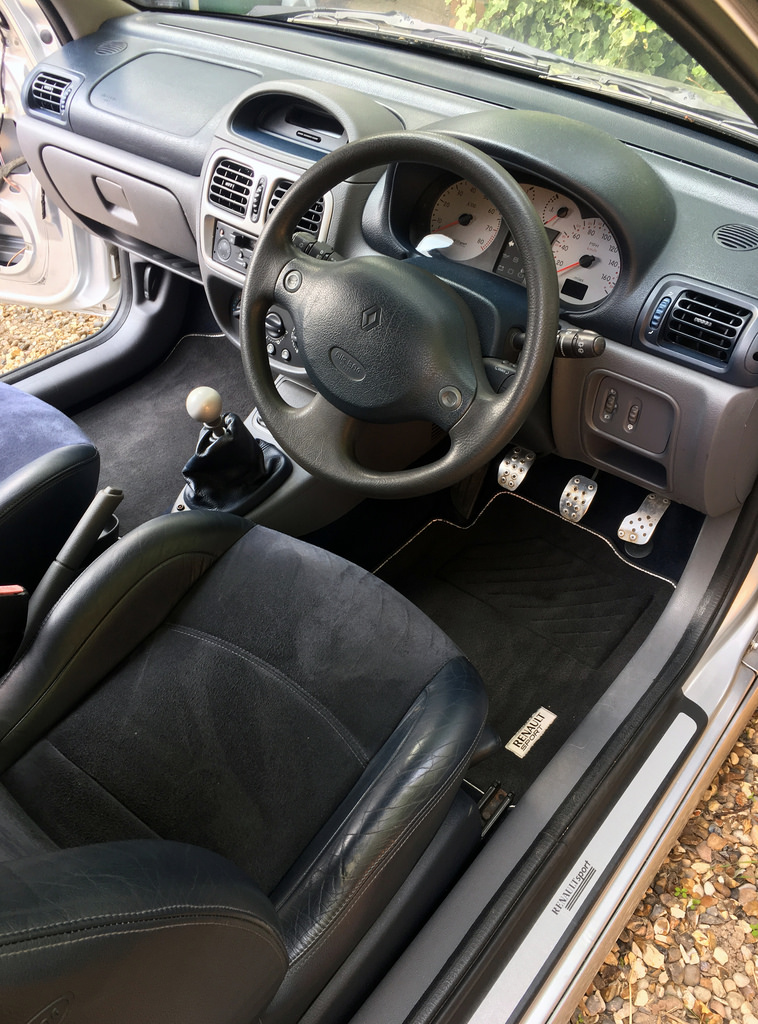

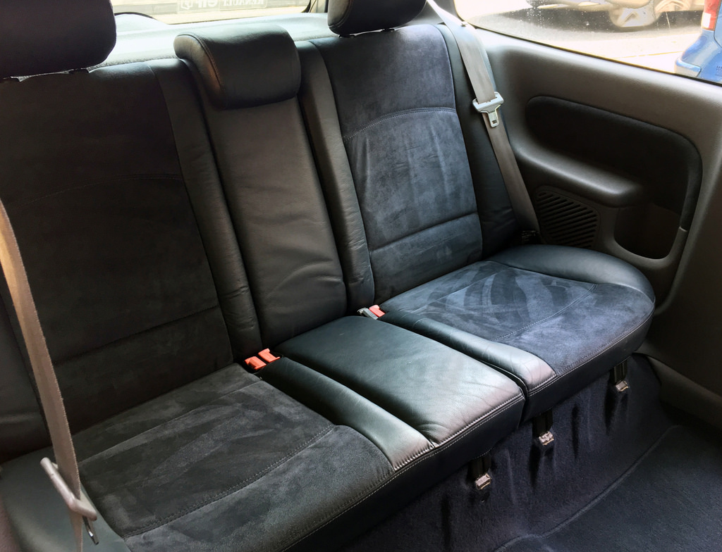

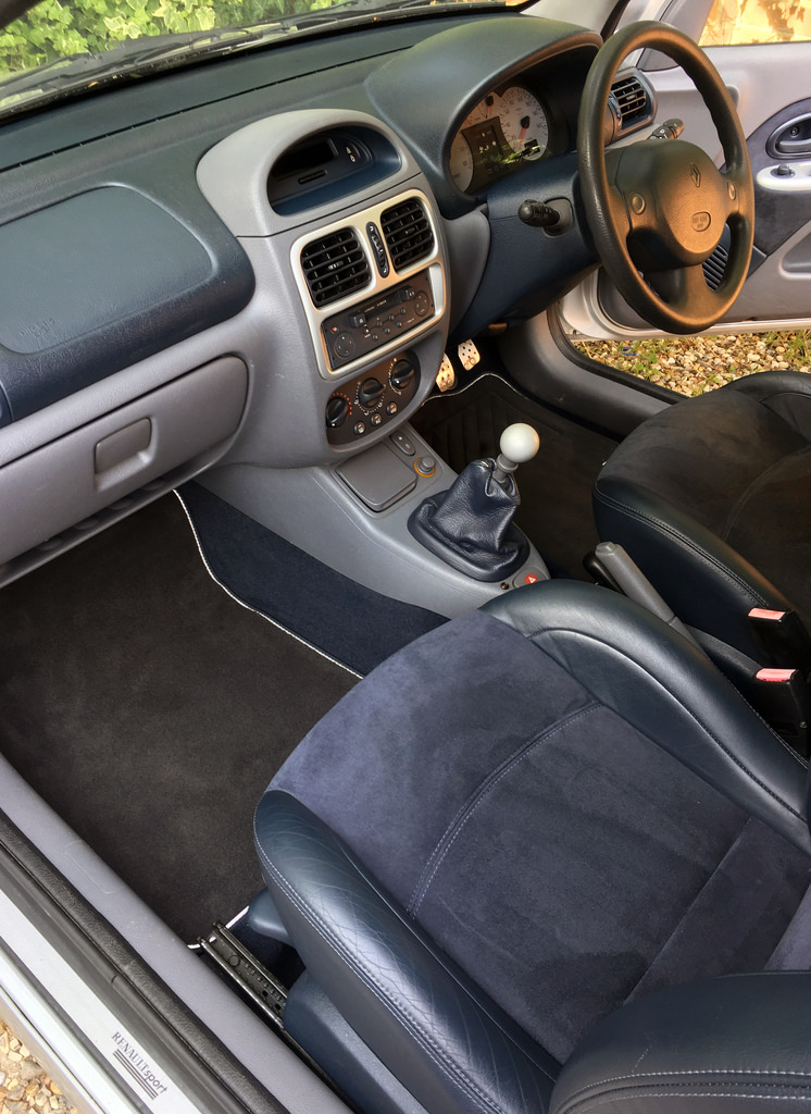

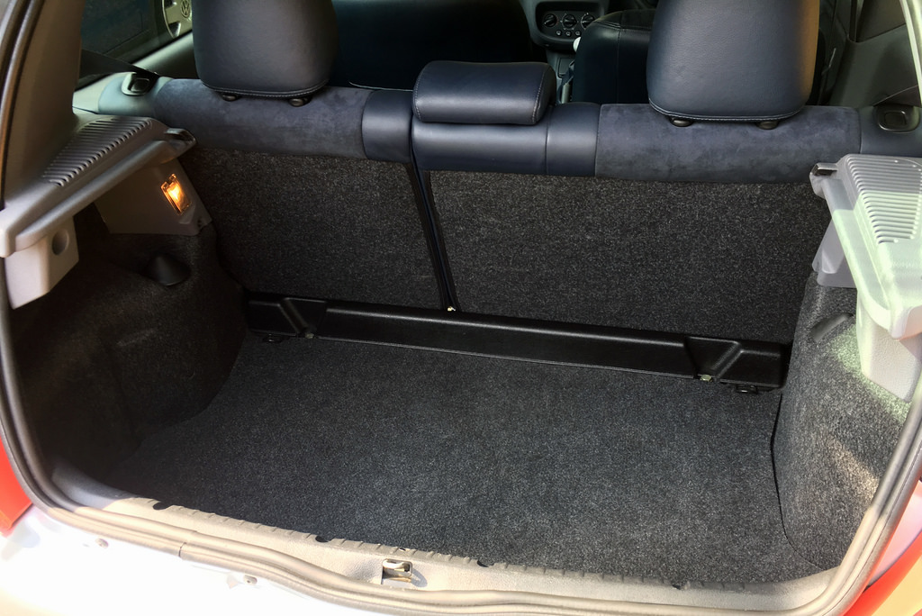

Few pics from today of the interior, was supposed to clean the outside as well but it hasn't happened yet ?cleaned all the mats, boot mat, parcel shelf with some carpet/upholstery cleaner I had for the sofa a little while ago. Also gave the interior a good hoover and wipe down, before they went back in. Also managed to get the central part of the dash with the clock aligned better as it looked a bit odd before @DerbyDan Need to get my proper Ph1 sport wheel sent off to be re-trimmed, might not happen till winter now though. Would also like to give the seats front & back a good clean but haven't managed it as yet.
mintno1
Cracking job in the interior. Satisfying isn’t it!!
It really is, want to get the seats out and hoover/clean under them but that will have to wait as well unless I get some time and motivation ?
Would like to debobble driver's seat as well, back seats and passenger seat don't need doing which is good ?
Looks so clean that, really does look a cracker this car - and yes it IS very satisfying getting the interior minty mint :D
The de-bobbler is such a nice little tool for pretty much pennies, made a decent job of mine - loads in the little bucket and didn't think mine were that bad!!
mintno1
Looks so clean that, really does look a cracker this car - and yes it IS very satisfying getting the interior minty mint :D The de-bobbler is such a nice little tool for pretty much pennies, made a decent job of mine - loads in the little bucket and didn't think mine were that bad!!
I do think the interior is in great condition compared to other Ph1's I have seen, still some bit's to do in it and de-bobbler is definitely happening soon, definitely a satisfying job, I do find it quite therapeutic washing/cleaning a car though ?
