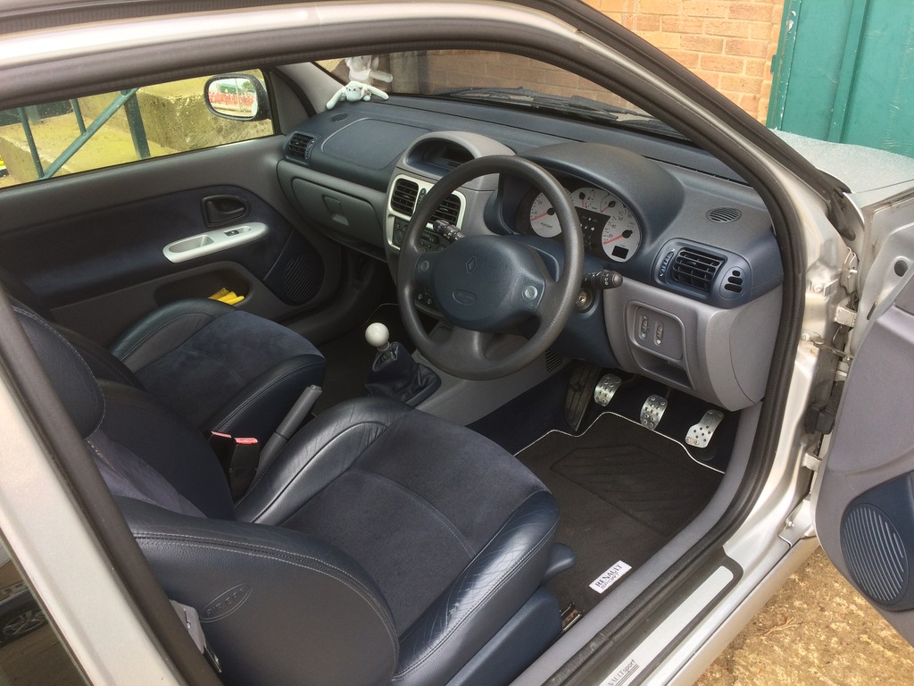

Firstly - some gratuitous pics of the Phase1;
The first thing I did was give the interior a good 'Hoover' + clean & brought was a set of genuine Renaultsport mats... I do rather like the interior on thes earlier Phase1 cars, they do feel that little bit more old-skool & the multi-tones of grey & blue is quite quirky that's for sure!!

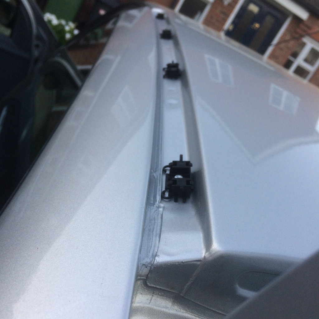

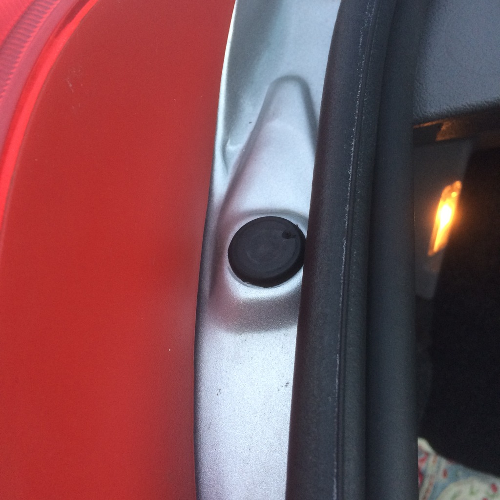

The three issues that were highlighted in the seller's advert for the car was an engine oil leak (suspected crank bearing seal) A leak letting water into the boot & the usual illuminated airbag/service light. The latter I've set about trying to solve but the oil leak is a bit beyond my skills/bravery!

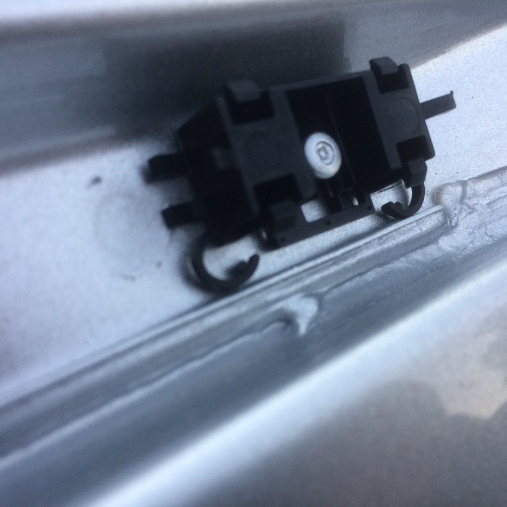

First I tackled the leaky boot, the water is coming from behind the L/H panel, so from doing some reading on here I decided to remove the roof strip on that side.... I cleaned out the gutter then ran a bead of clear silicone down the seam of the panels, I also removed the bung further down inside the boot shut & placed it back in with some silicone behind.... only time will tell if this has solved the issue as it only ever seemed to really leak if the car was parked at work with the front slightly higher than the rear.
I 'think' the original seam sealant may have failed at this 'blob' down inside the roof gutter?

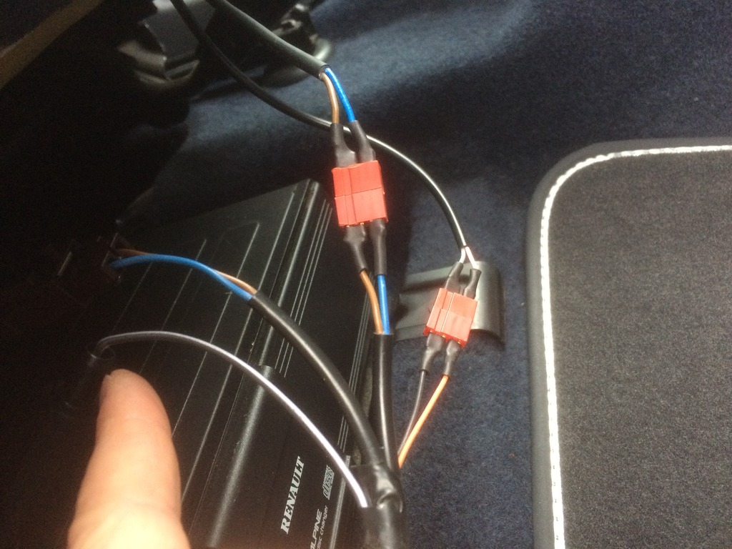

I then set about trying to solve the airbag light, by replacing the plugs under both seats with some that had left over in my R/C car racing kit;
...... & hey presto;
..... Except really it must have just been me disturbing the wires as the airbag/serv light has been on & off a few times since:disappointed:

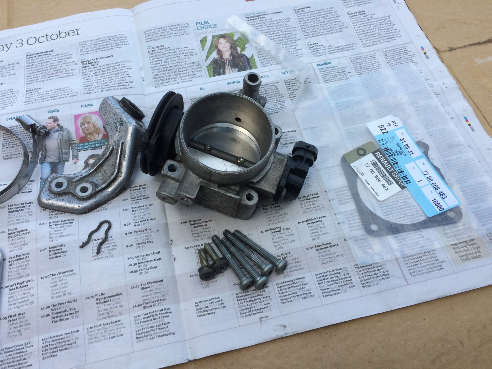

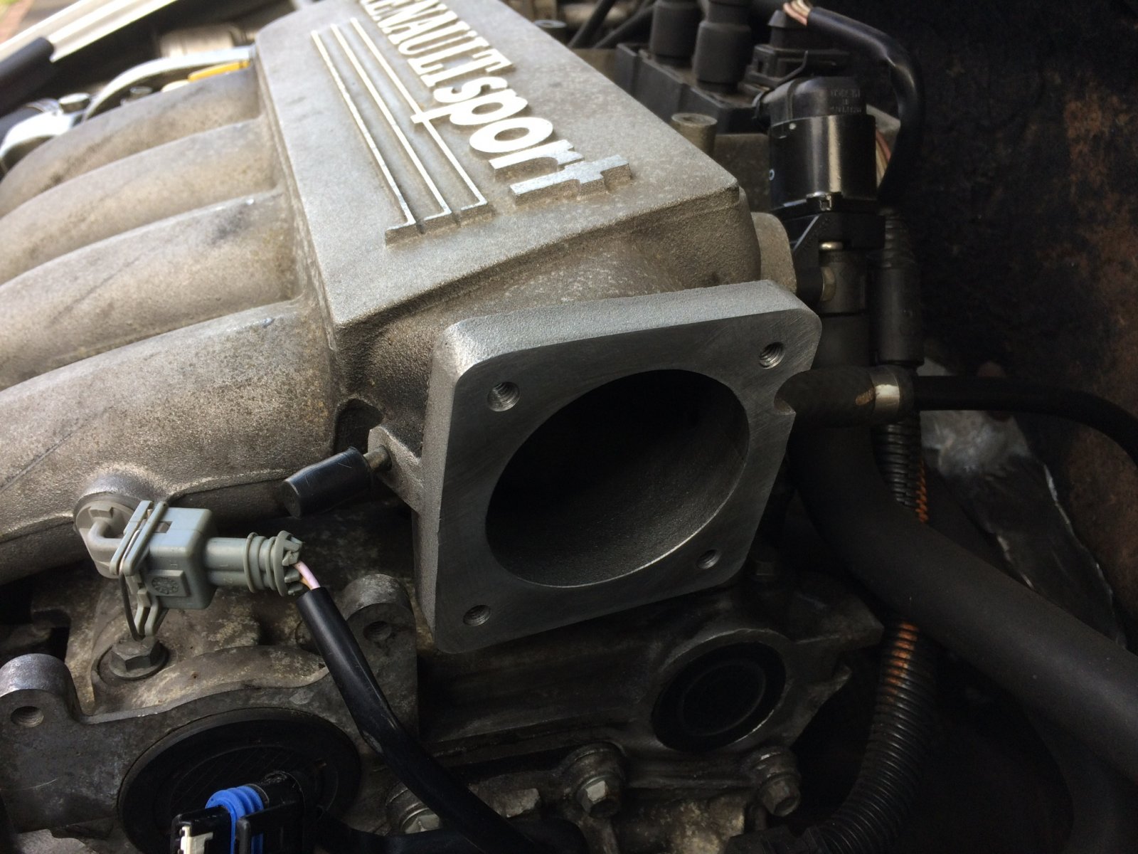

Throttle body cleaned & new Gasket;
Remains of old gasket (& additional silicone sealant) removed & both faces of throttle body & plenum cleaned up;
Annoyingly with it all back together it's now worse than before - it certainly hasn't helped the notchy feeling accelerator pedal - I'll perhaps remove it again & re-fit it with some instant gasket to make sure there's no air leaks, I will also have a look at the idle control valve.

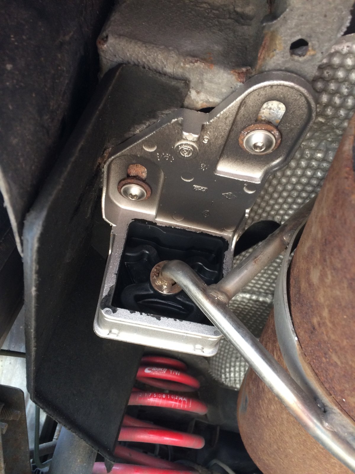

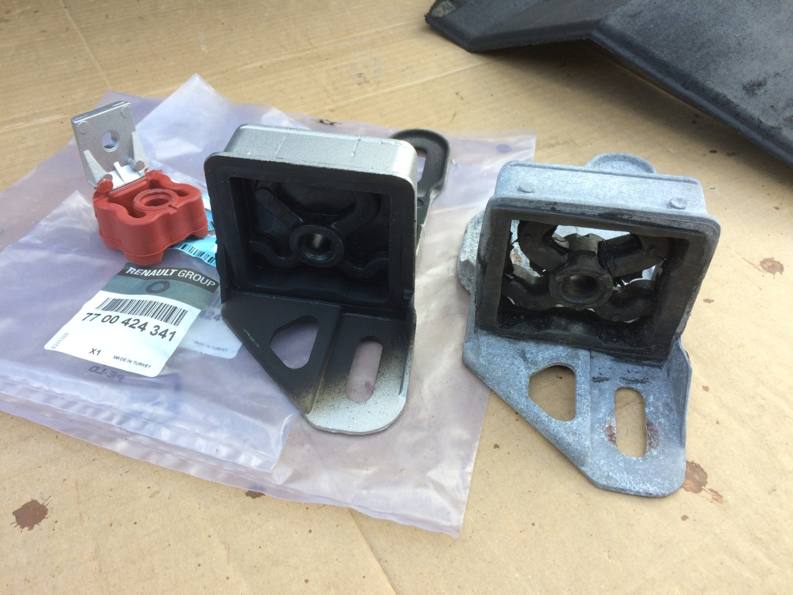

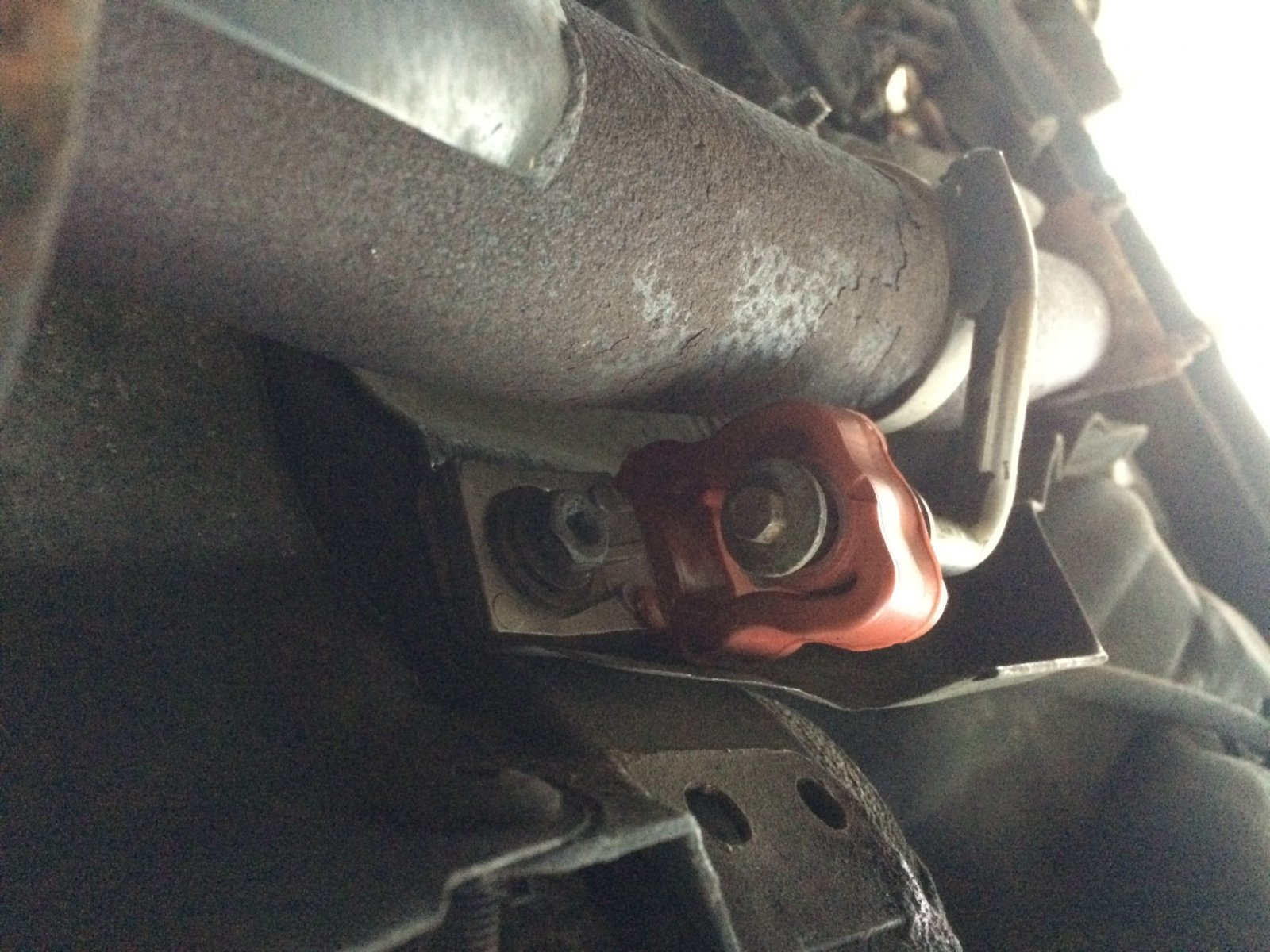

I've also replaced the two exhaust hangers as the rear silencer has started to knock/bang as the rubber has given way - again a common Clio problem it seems with aftermarket exhausts? TBH I can't see the new one lasting for long - but at least I can used the old casting to come up with an alternative infill of material that might be more robust.
No knocking now - so that's one result at least!

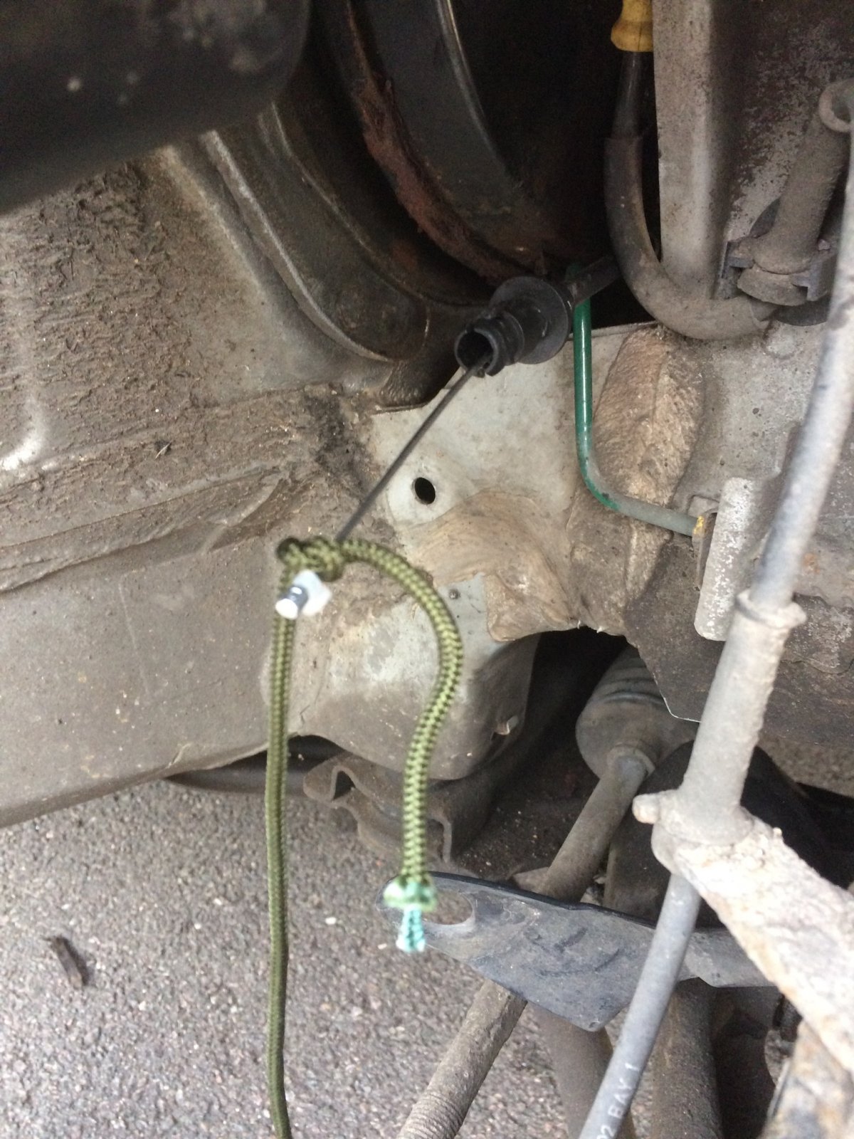

So today I renewed the throttle cable & whilst it hasn't solved the slight 'flare' of revs when arriving to a stop before settling back to the normal idle speed (I will take out the idle control valve & inspect/clean that up at another time). But I'm pleased to report that the accelerator pedal is now smooth & free, making the car far more enjoyable to drive.
The description/instructions from the link above was absolutely invaluable, but the job was not the easiest (for an amateur car tinkerer like myself)
First there isn't much room behind the bulkhead sound deadening - once the retaining 'buttons' have been removed & the material is pulled forward (I un-bolted the coolant header tank & pulled that forward too to try & allow a bit more movement of the sound deadening) - here is a photo looking down behind the sound deadening - you can just see the throttle cable down there!!

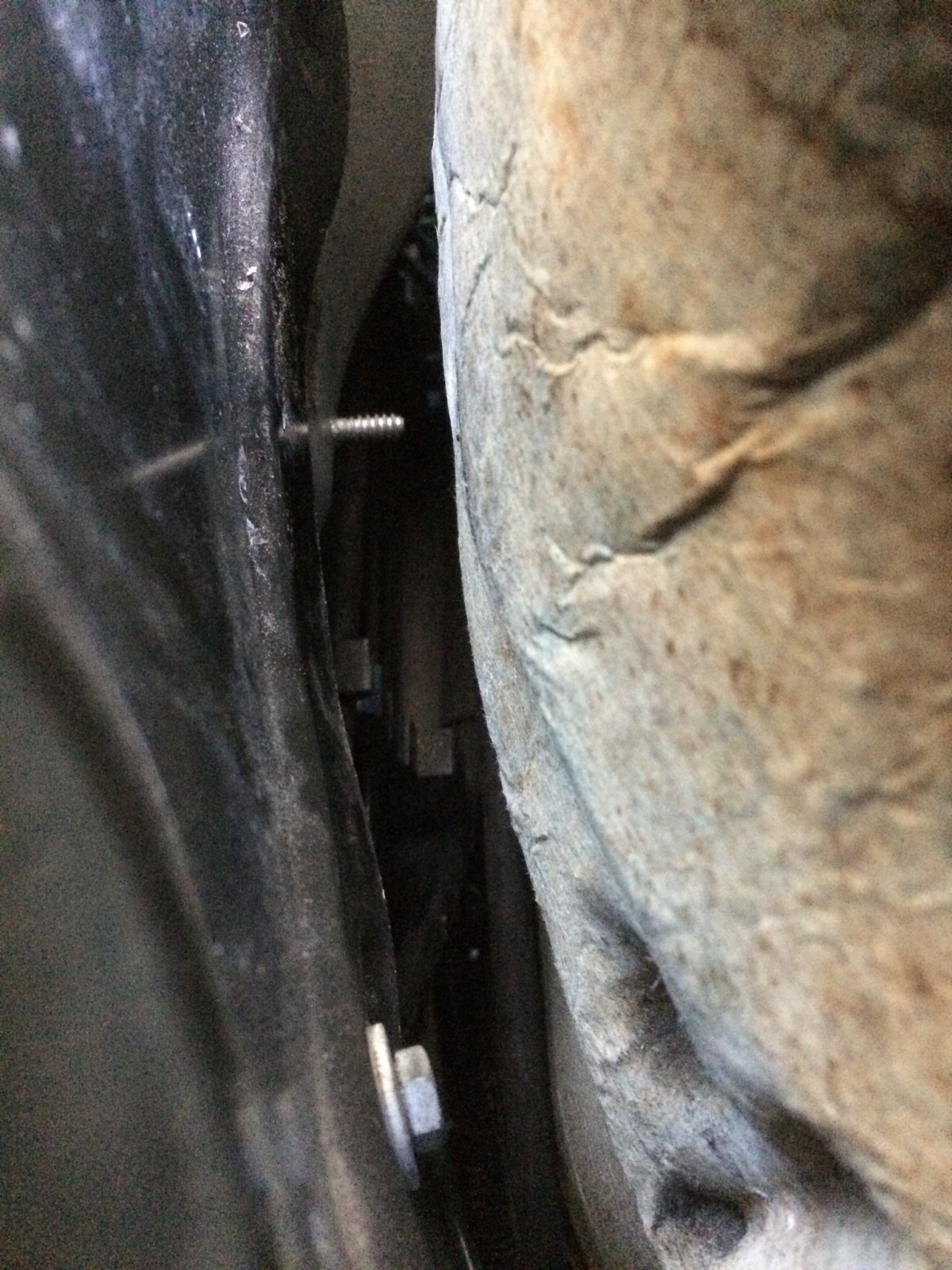

To get access to the cable where it comes through the bulkhead you have to lift up part of the inner wheel arch liner (on the driver's side)

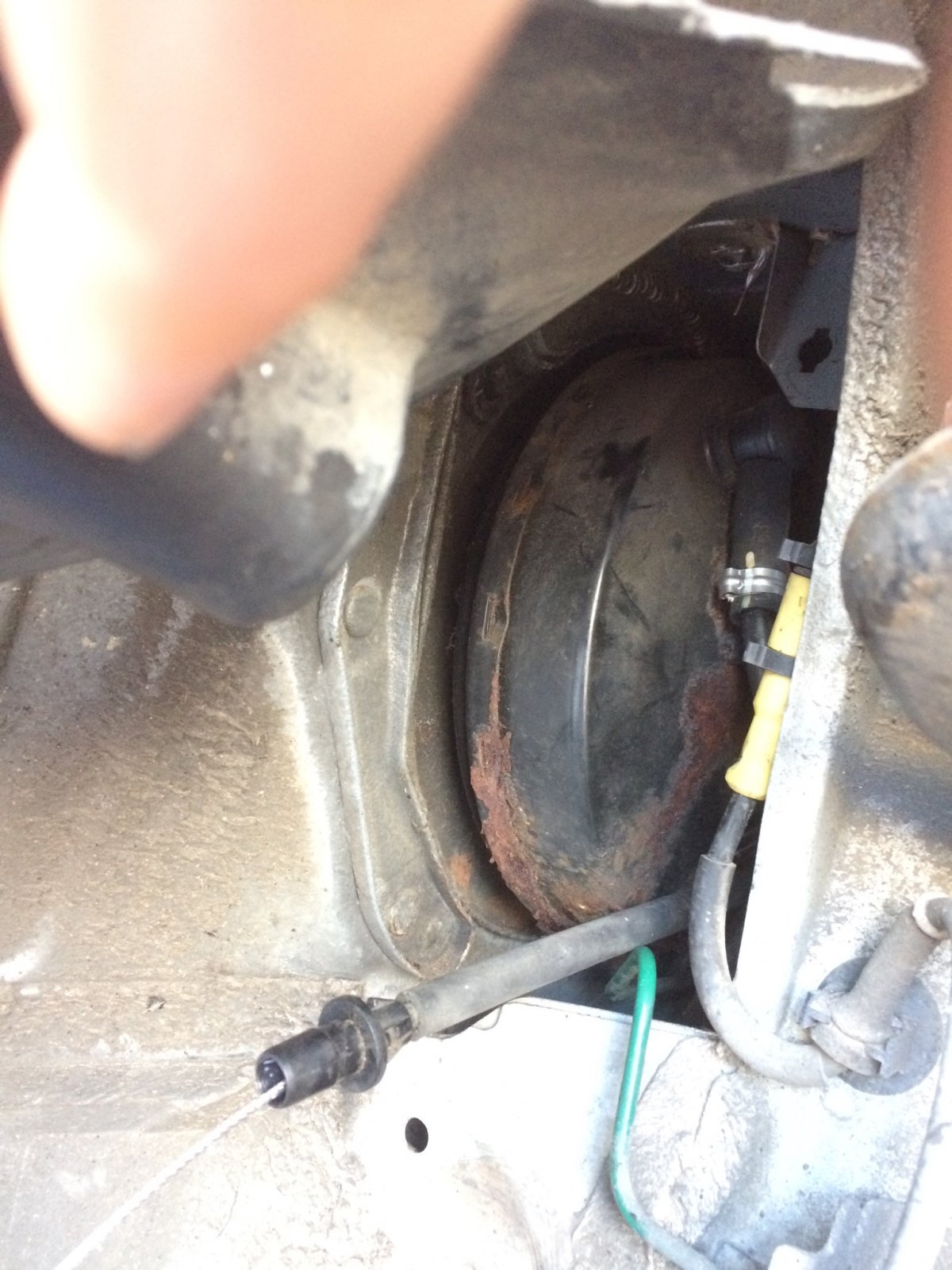

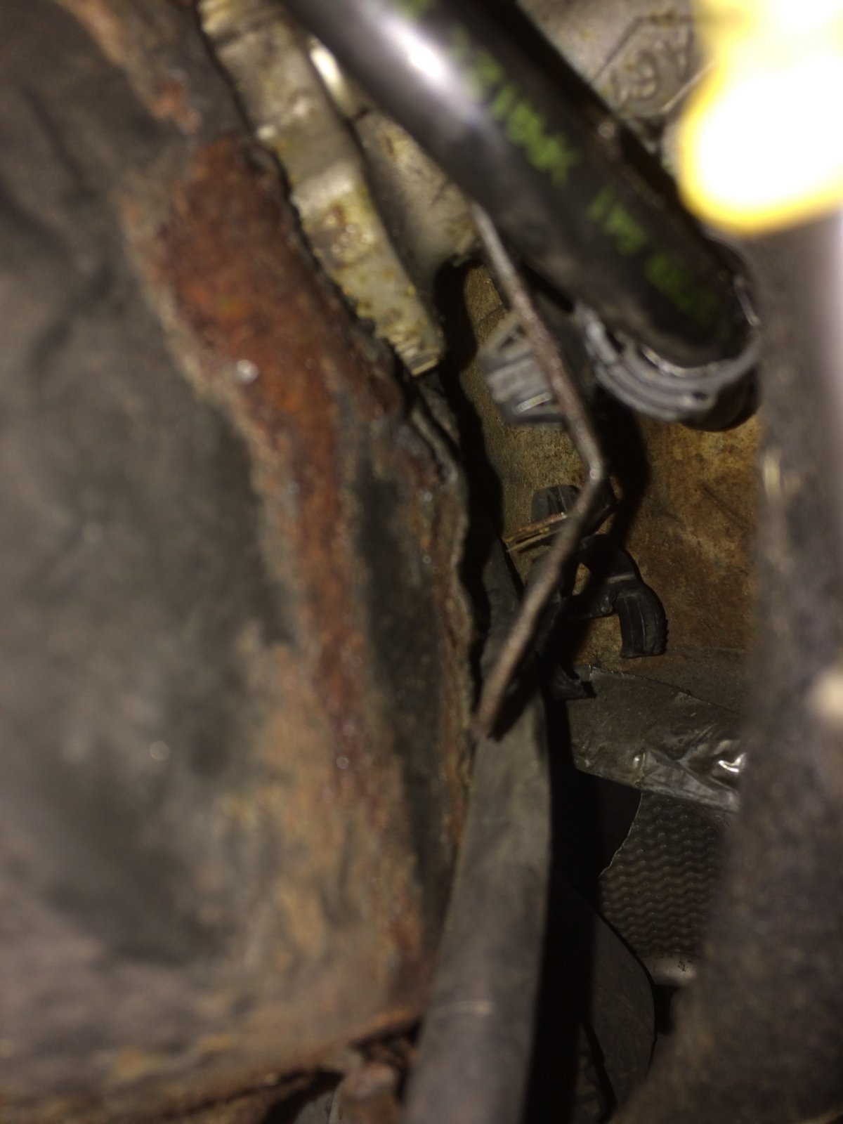

Difficult to make out what this photo is showing - but this was the hardest part of changing the cable, this being what seemed to have been the first cable change, the cable runs through two 'snap-shut' clips just in front of the brake servo, the first is fairly easy to undo, but the one further inside the car requires the use of a long screw driver to un-do the clip & free the cable. The photo shows the area after the cable has been removed.
In order to ensure that the new cable follows the same route as the old one, I tied a length of string to the end of the old cable before pulling it through & out of the car, the string is un-tied, then tied to the same end of the new cable, The new cable was dragged back through using the string, but I did have to stick my arm down behind the bulkhead sound deadening to ensure its clean passage past various obstructions.

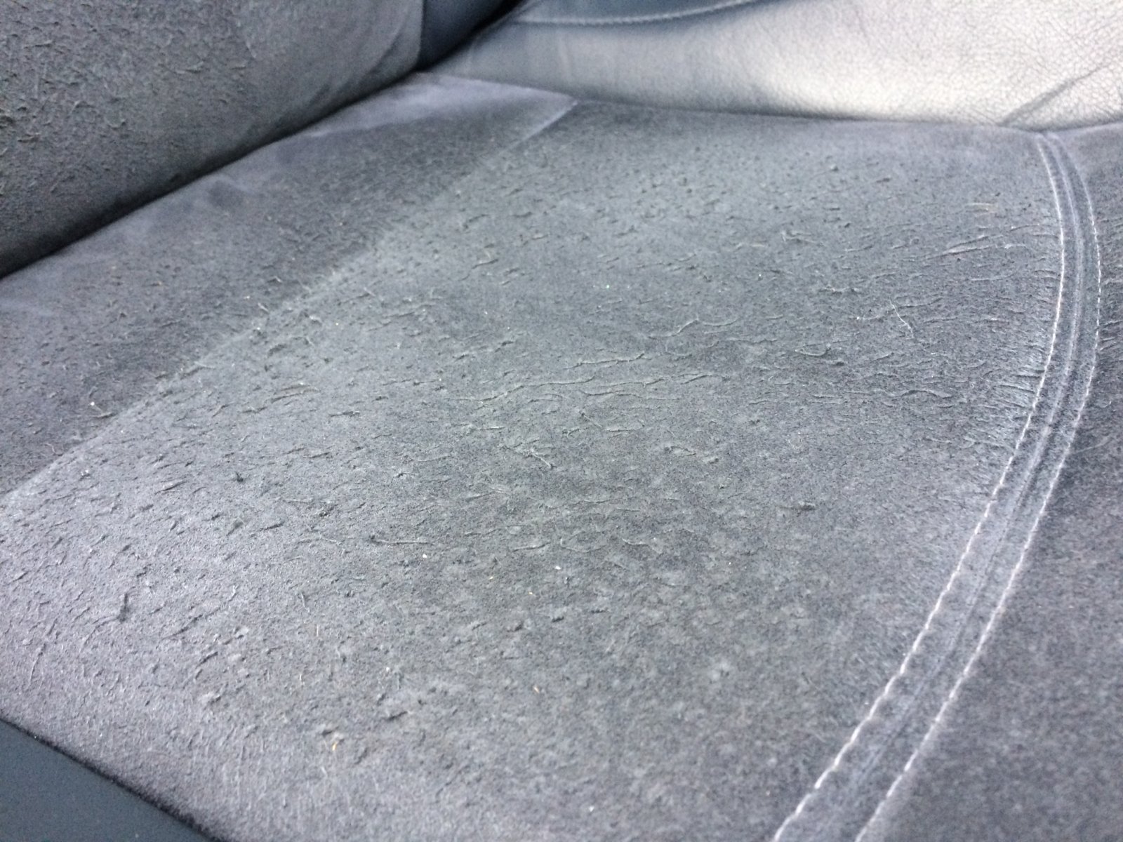

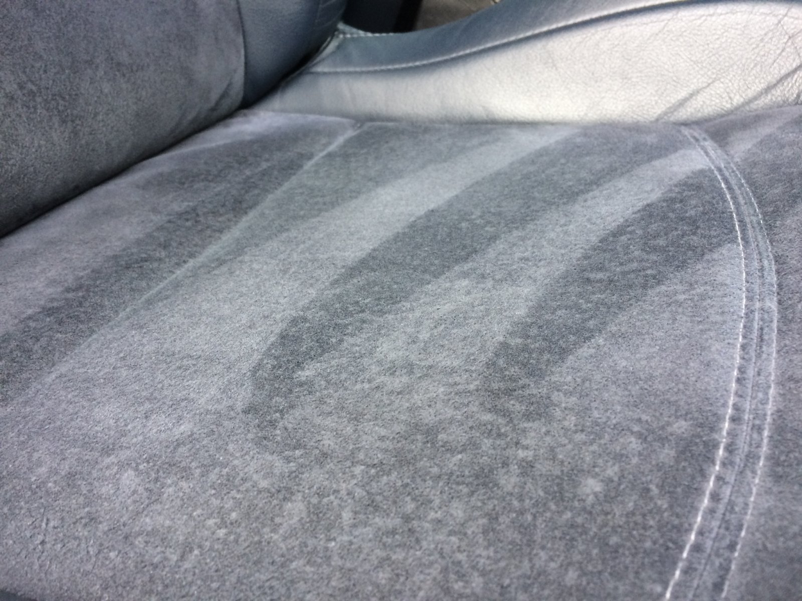

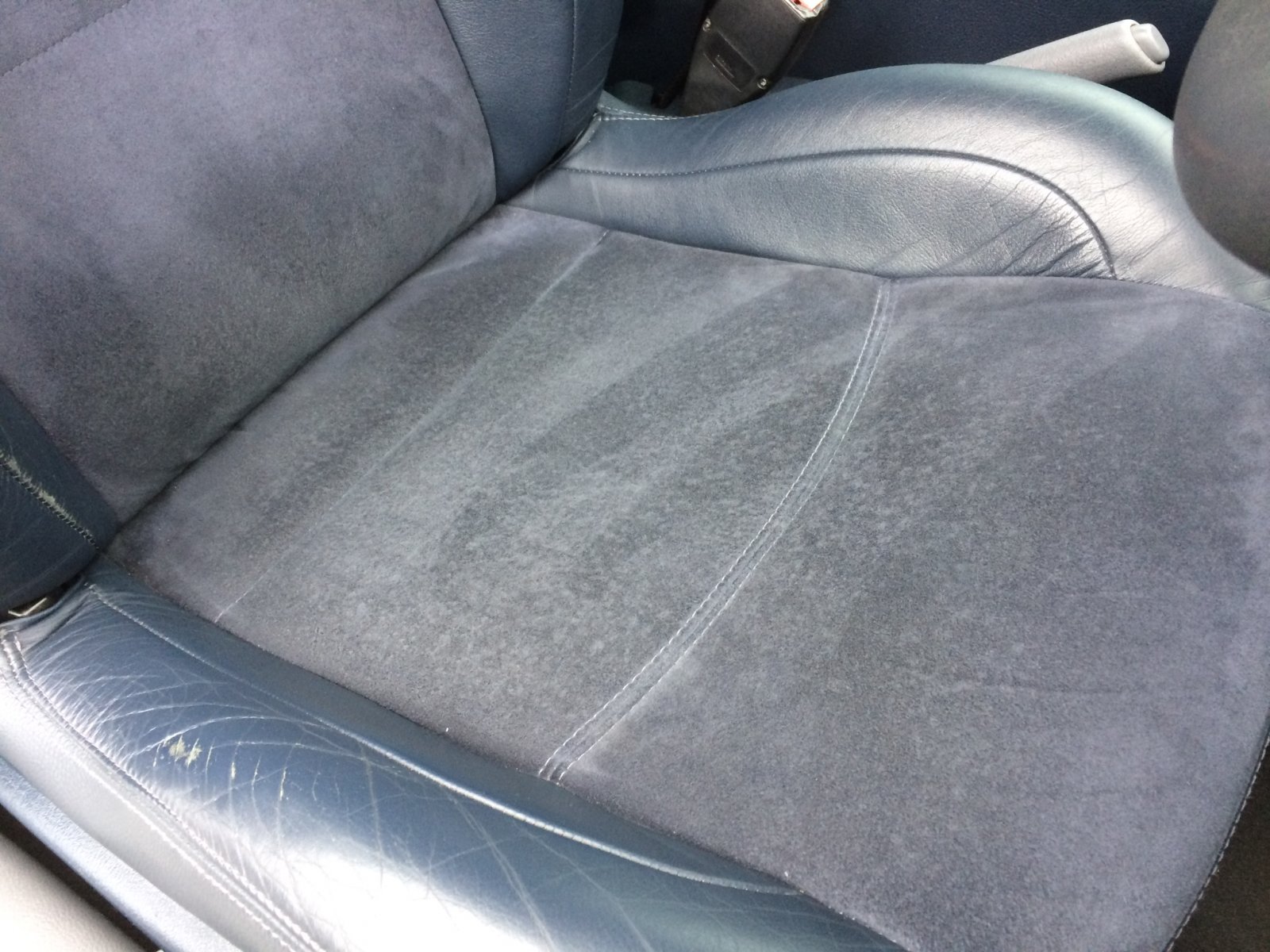

Said to myself that I wouldn't do any work on the Clio this weekend - but I couldn't resist trying out the de-bobbler machine thing that arrived in the post on Friday. I spent a good few minutes tackling the front seats;
Before;
After;
Looks better I think - I'll give the fabric itself a clean soon too.
Its a great mod to do for such little money!
It also works well on the door cards too.
Certainly £5.99 well spent! The alcantara material on the door cards is actually in great shape, it's just a shame that there's a split in the grey vinyl down near the speaker grille, it's really the only thing that lets the interior down.

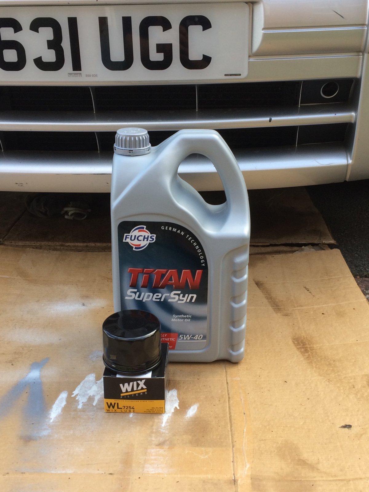

The previous owner claimed that my Ph1 Clio had an oil change every 6k or so miles, but hadn't actually kept a record of any of the servicing that he had done, but just from meeting the seller I was confident that he had serviced the car regularly - I did however have a receipt for the Cambell etc having been done in early 2013. I was keen however to do an oil change asap as I was unsure of when it was last done. So the weekend before last I dropped the old oil out (which I'm pleased to report looked pretty fresh anyway) & replaced it with some Fuchs 5wt-40 from Opie Oils (heard good things about this fully synthetic oil over on the Integra forum & it's pretty damn cheap too!) along with a new Wix oil filter.
.... removing the old oil filter was a right bind, but I got there in the end, with a bruise on each forearm as a memento of my efforts!!

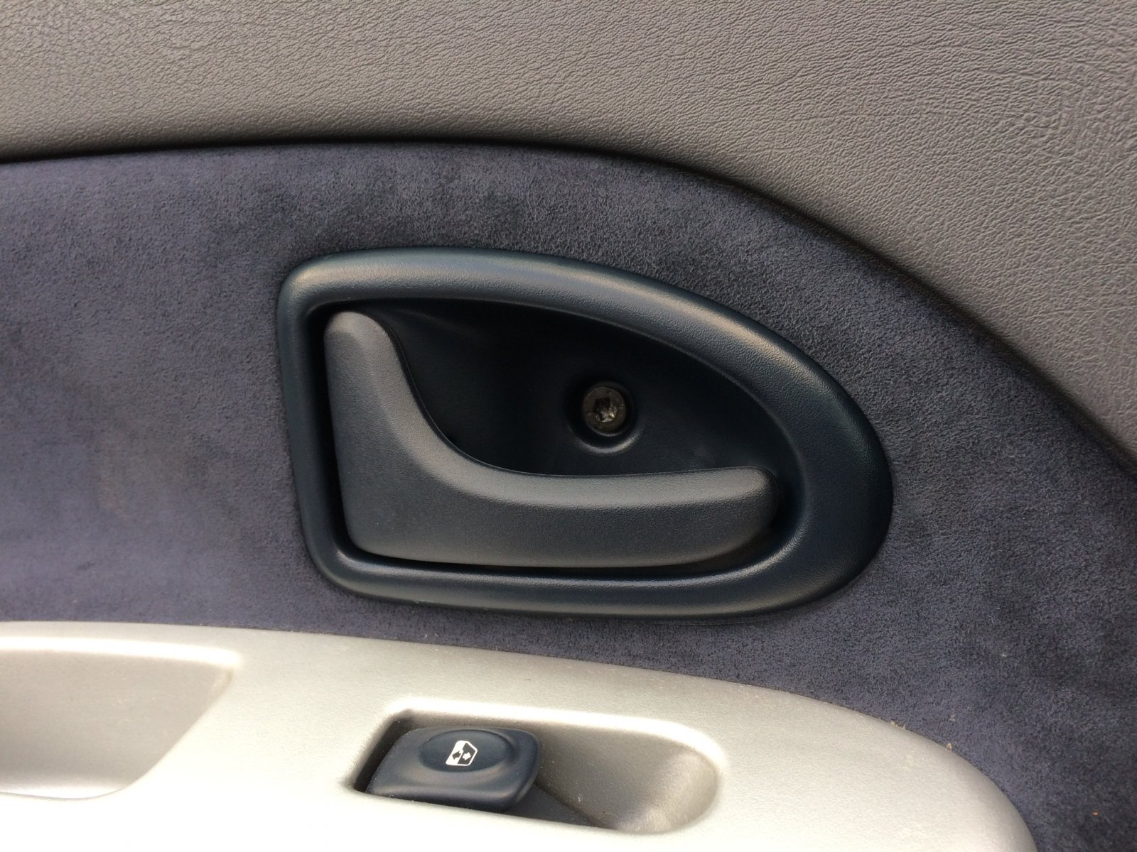

I also replaced the passenger internal door handle with a new one - there wasn't much wrong with the old one apart from a white mark that I couldn't remove - & it was cracked in the back around the fixing screw which was just bugging me.

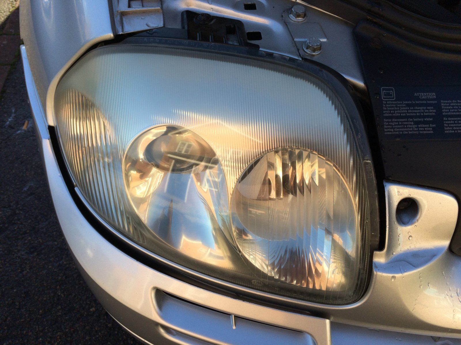

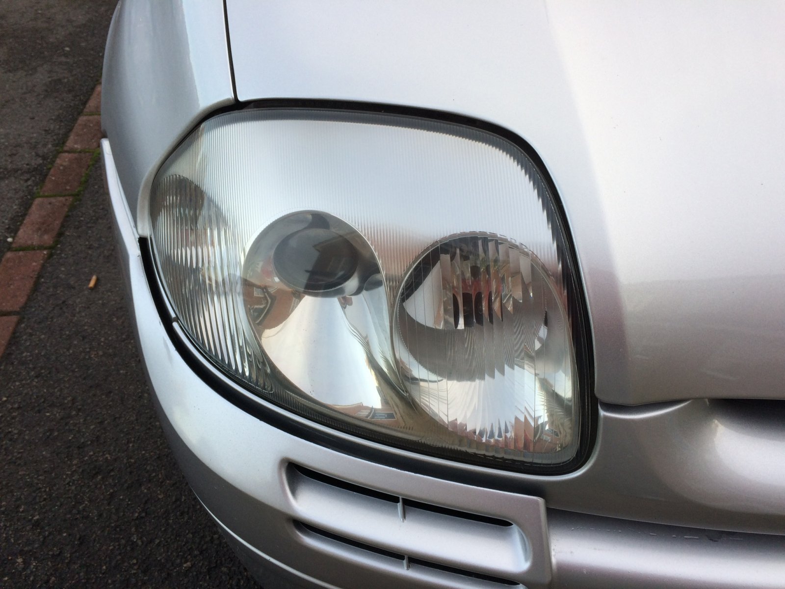

On my return, I then had a go at renovating the headlights, they weren't too bad, having by the looks of things having had a 'going-over' sometime in the recent past, but as I had some pads left in my 3M headlamp restorer kit, that I had from having done the DC2's lights I thought I'd give them a quick going over...
Before;
After;
..... not massively different by the looks of things!!

Looking good bud, you should have really fitted a Renault oil filter though.
There was a tread posted about non standard filters.
I'm sure it will be ok.... for sure I would have preferred/brought a genuine Renault filter (& I will next time) - but unless the WIX filter is of such poor quality that it doesn't actually filter oil - or worse still breaks down inside then I'm it will do the job - certainly better than not doing the oil/filter change.

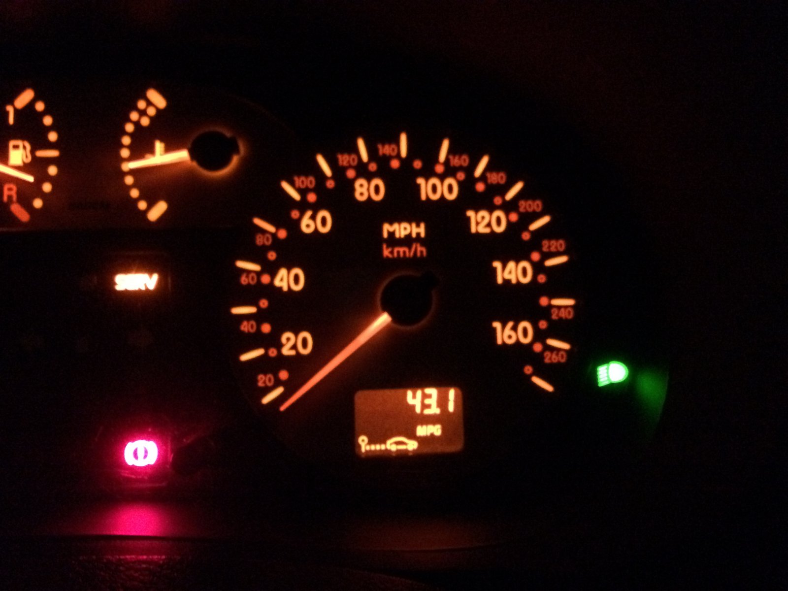

I took a couple of shots whilst I was away on my little road trip....
Should be bang on half mate
If that's the case then I'm not going to worry! I know the system could do with a flush - the previous owner said it was the one thing that he hadn't done in his ownership he was going to do it but hadn't got round to it, but gave me the (genuine Renault [type D?]) coolant he was going to use - so will get round to doing this soon & pop in a new thermostat whilst I'm at it. My old Honda would run at just below half way on the needle - so not concerned here...

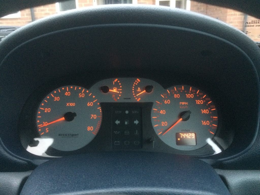

chris blue
  clio Sport 197
My temp gauge just under halfway too, coolant good level, good condition
Will leave alone, but might be the stat i spose
