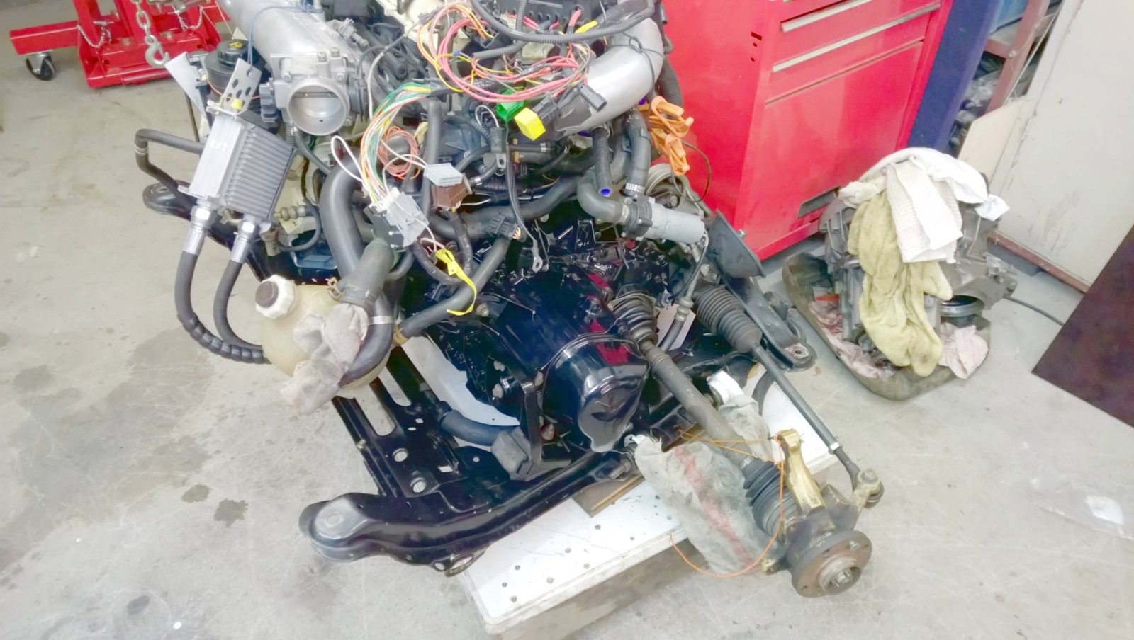

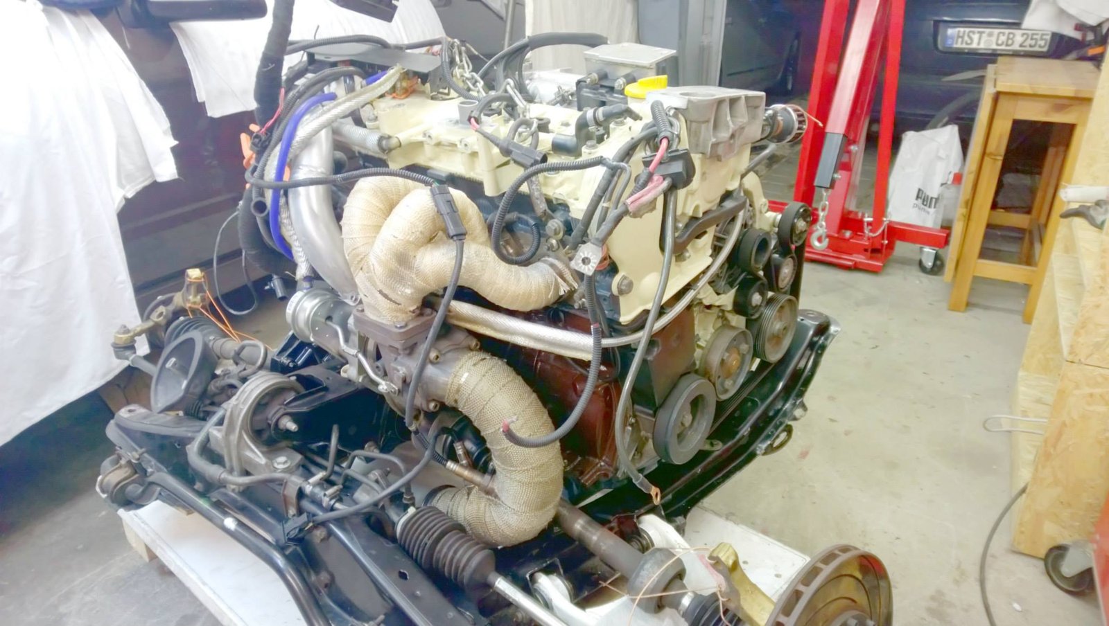

i own R9 and i love it and its my daily driving car lately the fuel prices gone high and i want to swap an F4R or F4P engine in my car problem is i cant weld any engine mount in car Chassis or the car will fail in registration inspection and i notice some R5 owners swapped F4R with no top mount i know that two mounts of gear box will fit the 3ed mount in engine block will it fit to ????
P.S : the engine in the photo not mine i got from internet
1426082
1426083

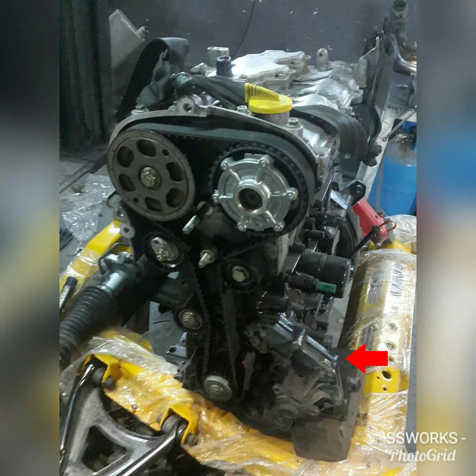

i found these photos the driver side is clio engine mount the rear mount is megane 1 the passenger side its beneath the engine so i cant see it
