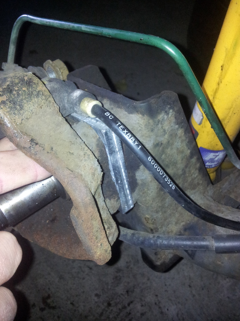

This bit?

Sorry abit of confusion here. I mean behind the stub not the disc. Basically where you Would put camber shims.
You can put metal plates between the stub axle and the arm, just like the shims as you say. There is quite a bit of thread left on the bolts but the different 1*2 models have different thickness stub axles as std.

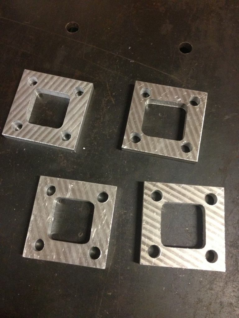

Ed.innit - they look perfect. Why have you Got four? Where did you get them from?
  E46 M3 + Ph1 172
A mate made them for me from ally, they weigh grams each, alot less than any other spacer, and there is no rotating mass, much better and cheaper than a conventional spacer..
Was having 2 made for me, so may aswell make 2 spare ;), maybe selling a set, will see if I can fit 2 spacers each side first ;)
Wonder how much interest there would be if I had 10 sets made?

I have a piece of alloy left over from a piece i got of ebay (originally to make an inlet manifold to take jenveys on my modified 105e anglia) because it will be held between 2 pieces of iron i believe it will be perfectly adequate. i have no access to any major equipment any more so its hack saws and files plus a little pillar drill i have. Just takes a long time but its very cheap.

There must be some kind of backfall/downside??? Geometrey etc???
Why must there?
No rotating mass
No longer wheel bolts needed
No extra load on the bearing
Gives you a wider track

Obviously machining them at an angle would massively increase the machining costs..
May look into getting some made.
