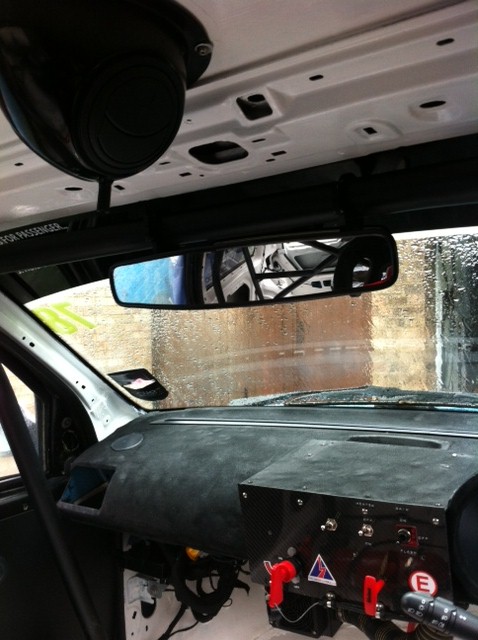

Pete got me in the mood for getting round to fitting my wide angle rear view mirror, was a straight fit and was amazed how well it exposes the passenger side blind spot.

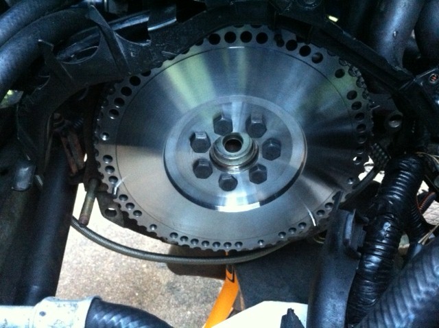

Fitted the TTV lightweight flywheel and brand new clutch

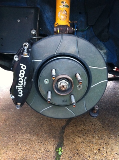

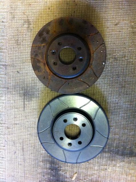

Replaced front brake discs, the old ones was 2 years old and had pretty much seen a lot of track day miles, surprised that they hadn't had worn down.

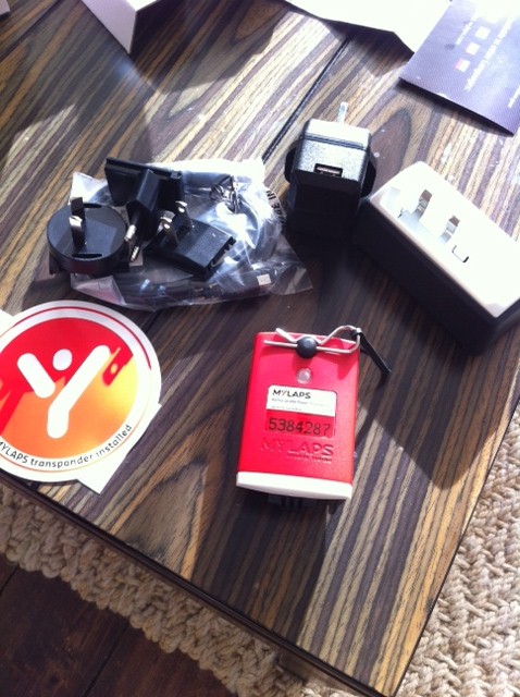

Also ordered a Mylaps transponder with 1 year subscription (£130), thanks for the heads up Dinger (over on TARC).
