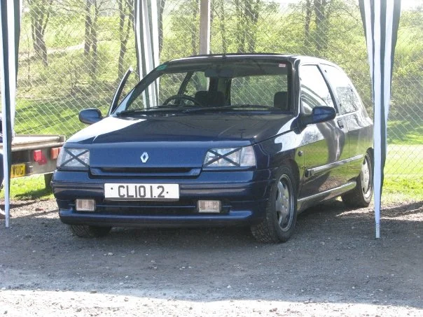

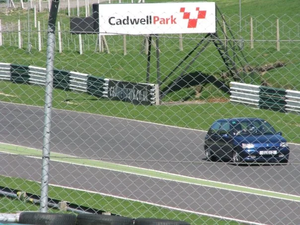

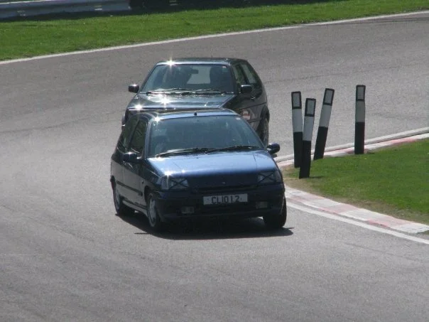

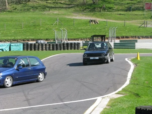

Hi, last monday i did my first track day at cadwell park, the RSI did me proud!!! except around the higher speed corners, the rear of the car wanted to go to the front!!!!, not nice!! i have lowered the car all round by 60mm but havn't changed the dampers, is this the problem? the back end still feels very soft and a bit bouncey

a few pics at cadwell

If anything the rear end look WAAAAY too low...
Looking at those images the rear has gone lower than 60mm?!
What set-up are you running on the front springs and strut wise?
  clio RSI + EVO X
Yeah was thinking the same that the rear is to low, maybe needs to come up 10-20mm, im running standard shocks on the front with GMAX springs -60's, just made my own strut brace which seems to be doing the job ok
