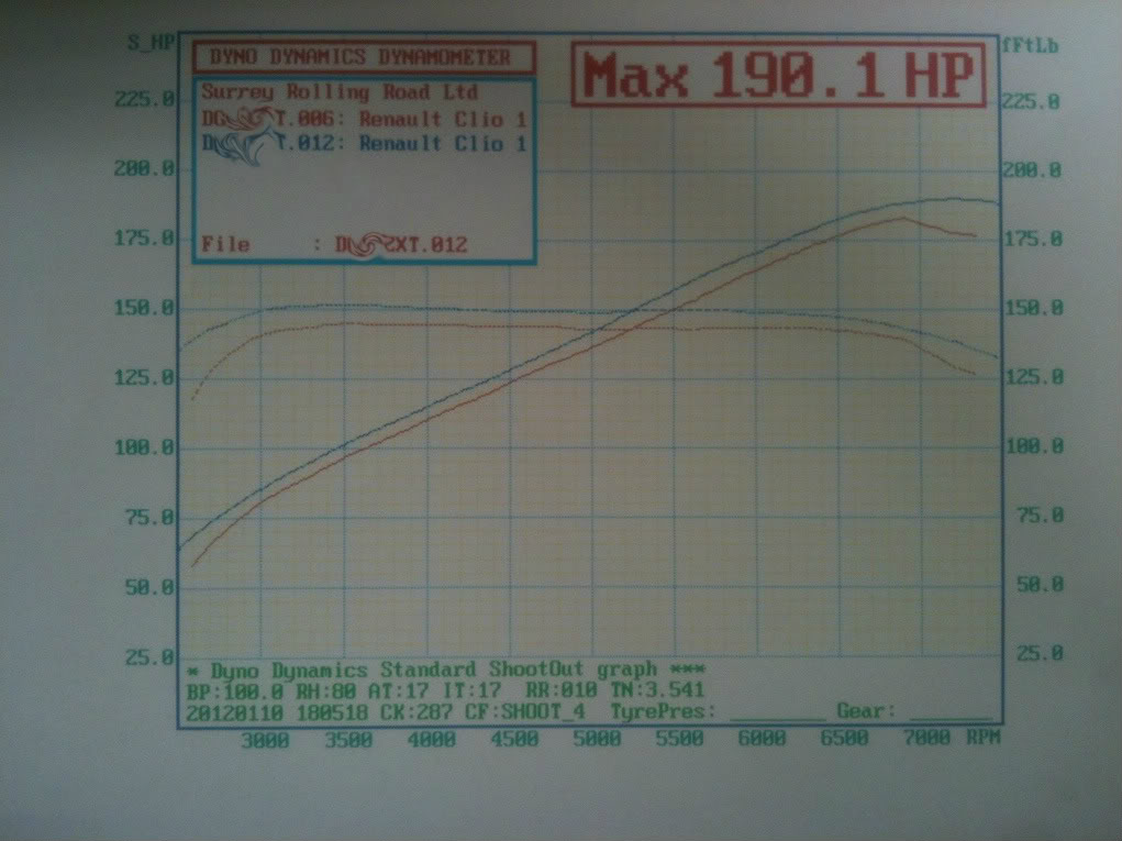

RS2 makes 150lbft for almost entire rev range and 190bhp on standard engine :)
  182/RS2/ Turbo/Mk1
I remember someone on here recently (laine I think it was) saying that he hadnt seen an RS2 making 150lbft so I thought this graph might interest him and others.
I was down at MWMsport earlier today and they'd just got back from Surrey Rolling Road where they had been mapping a Trophy with an RS2 on it.
Ignore the lower lines, thats just the graph that was from when they started mapping it (was on an RS Tuner map before IIRC), the higher line for each is the finished result.
Pretty epic I reckon, not just cause it makes 190bhp, but far more importantly because it makes 150lbft from 3Krpm to almost 6.5Krpm
Just goes to show how important the mapping is, the MWM map has pulled an extra 12lbft or more all the way from 2.5K to 7.5K, thats almost 10% for the entire rev band of the engine :)
Bet its an absolute little rocket ship now, fantastic torque at ANY rpm you choose to bury your foot! :D

Well its a bit of both really, if you are still making good torque at high rpm then by definition it translates to good power as well of course as one is a function of the other.
The key thing is the spread of torque through the portion of the rev range, especially in the portion of the rev range that you are personally likely to be driving in.
And in the case of this map, it really doesnt matter where you drive it, rev it to 7500rpm on track and its pulling hard, but plant your foot at 3k on a dual carriageway and its just awesome for all of it!

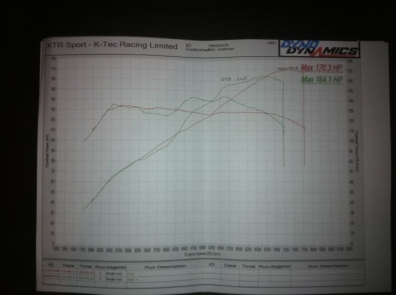

Compare it to something like the nasty peaky graph that ktec put up for their 438cams for example, and although that does make more peak torque briefly it only does so for a very narrow 1500rpm window between 5K and 6.5K, and the RS2 beats it for torque everywhere else for the entire rev range right from barely moving upto 7.5K, and the difference in smoothness between the graphs is astranomical, the 438 one looks like a map of the himalayas where as this is just absolutely perfectly level for almost the entire rev range.
Its not just a level torque spread "for an f4r" it just is incredible for any N/A engine, I cant actually remember ever seeing any 4 cylinder engine with a torque curve as impressively shaped as that in my nearly 2 decades of being into modified cars!

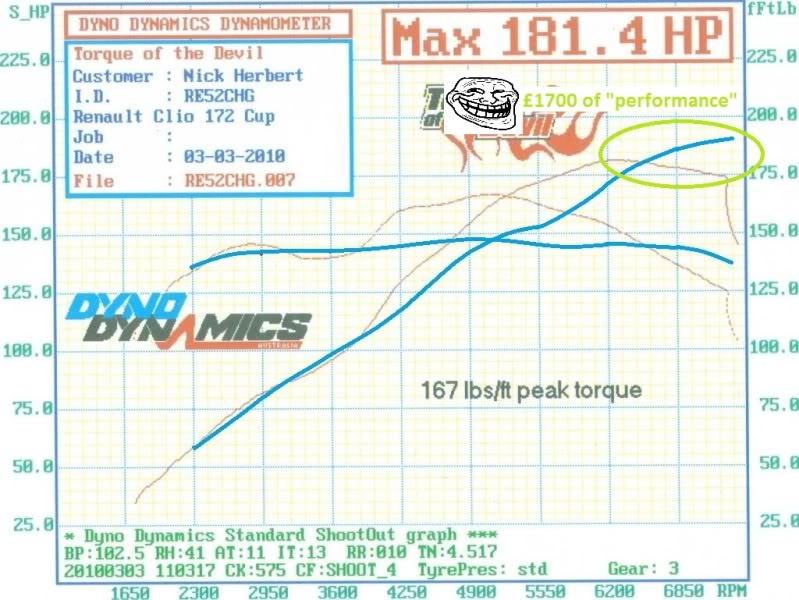

Oh look another graph RS2 vs Stock 172 cup, im still failing to see this "broad range" of torque the RS2 seems to anihilate the stock manifold with?
All the RS2 does is remove a massive chunk of mid range torque which people seem to w**k over because its "so flat and consistent", and add a small amount of power top end. I could do this all day loing...

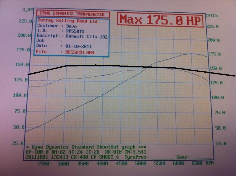

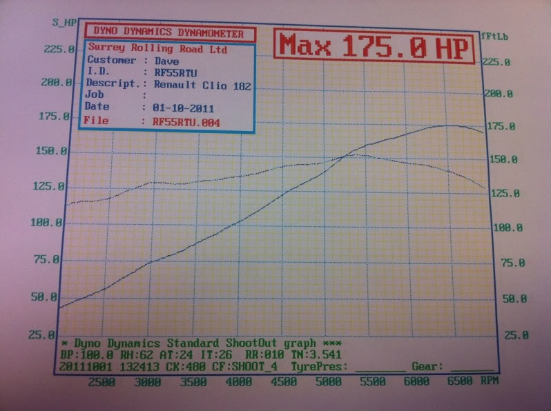

When compared to my graph (also at SRR), which is for a fairly standard, healthy Trophy, the torque is held at peak for much longer, & the power keeps coming after 6k. Seems good enough to me.
Im sure someone can overlay it.
As both are so recently done at the same dyno, I would think that charlie can probably be asked nicely to put them on the same axis for a decent comparison, and its a fair one in that they are both same age trophy cars with same exhaust manifold and all that jazz, but even still its two different engines so not really a totally accurate comparison, I think that the before and after of our car will probably be the truely fair test :)
I'll have a go at overlaying this latest trophy rs2 onto that for now though as its the closest to an accurate independant comparison we have so far.

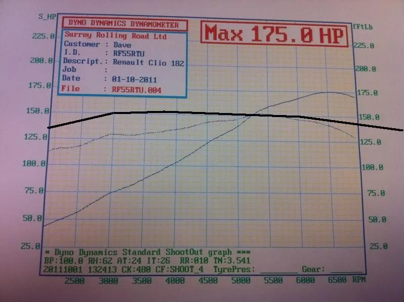

Dave, here you go mate, this is your very healthy 175bhp standard inlet trophy compared to the RS2 one from yesterday in terms of the torque curves, forgive the crudeness of my "overlay" but its within a couple of lbft of accurate everywhere so certainly more than good enough for a decent comparison :)
MASSIVE difference! And would be even more apparent how much better the RS2 is at the top end where its useful on trackdays etc if your graph went to 7500 as its very apparent that your car would have been dead in the water by then, probably down near 100ftlb judging by the curve its tailing off with.
