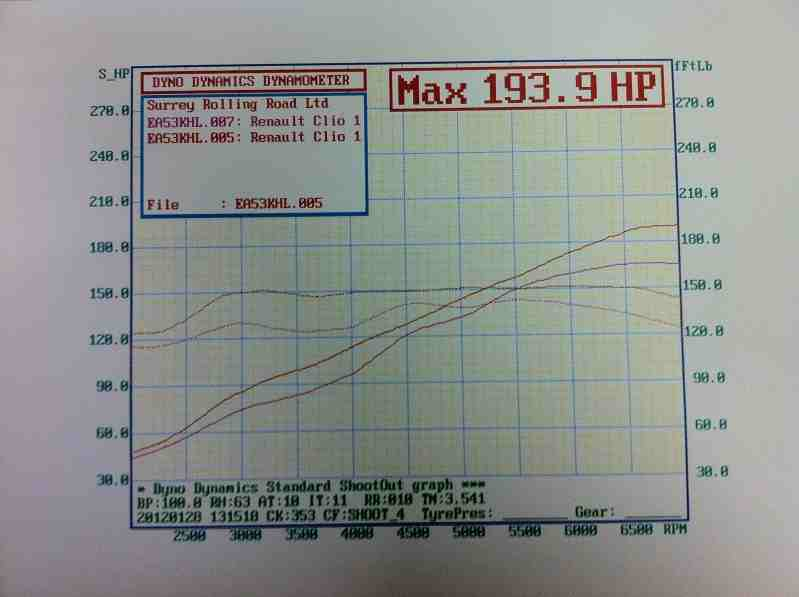

Just got back from RS Tuning... I was shocked at the first run of 183hp then the second run saw 201hp but after I stopped running round like an excited kid I realised that was a spike on the rollers (All them torques yo!) but the final result after some minor tweeks was 196hp with 152lb/ft. so I've actually gained 6hp and lost 1lb/ft which doesn't sound *that* great but when you see the two graphs overlaid it's obvious that the gains are real and most importantly use-able (It bolts like a stabbed rat from 4k now). Paul said he probably could've gotten another 2hp but as I'm 100% made up on ITB's and management now in the new year with these cams (There's loads more potential from them) so we decided the extra dyno time and ultimately money wasn't worth it so we made sure it was safe and left it at that until the new year.

Good to see it works with cams. But with Itbs you'll see another 10-15bhp and lbft.
Interested to see the graphs overlayed too.

The only place the 421's seem to have lost a little (and I mean a little) is 3.2-4k but everywhere else the new curve is ahead. Add in the Cup aux setup and new suspension I'm running and the car is an absolute dream to abuse.
