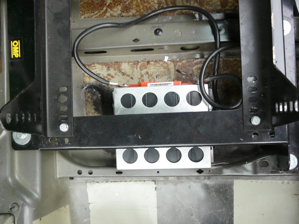

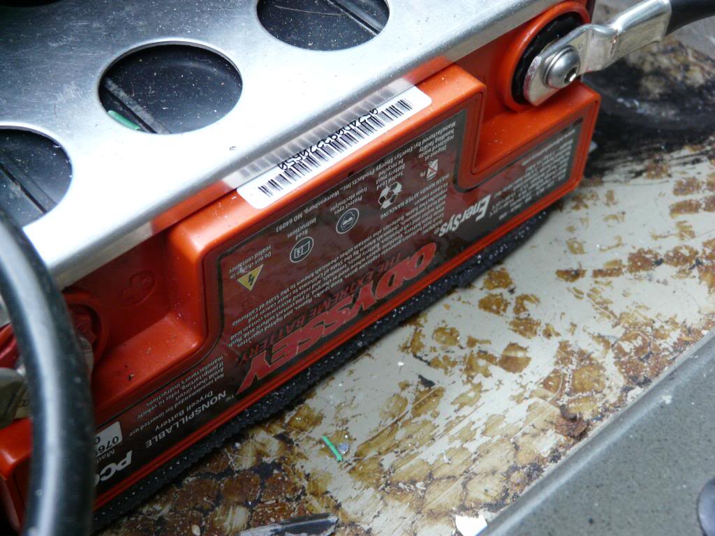

Finally got round to fitting the battery and mounting it under the seat. Was alot easier to fit than i first thought.

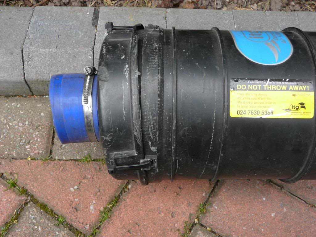

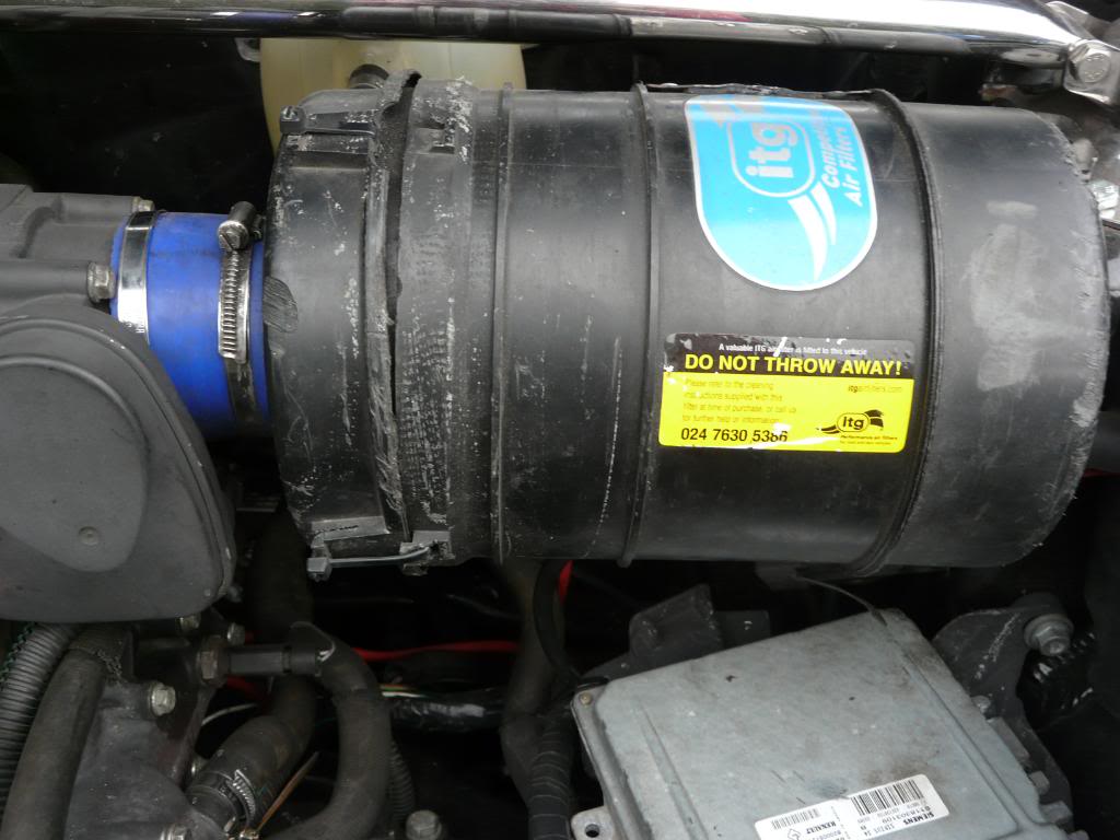

Got a straight bit of samco hose of f0xy so i have the ph1 airbox coming straight off the TB. Dont think it makes much difference apart from less restriction due to removing the standard induction elbow, and its also made abit more room in the engine bay and made things look a bit tidier.

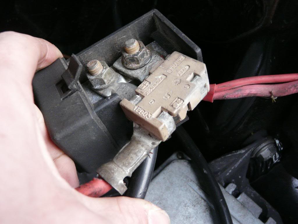

First thing i got round to doing was fitting an Odyssey battery that i got off jay (burp). Not go any real pics of fitting it so i just took a few after it was in haha. Was quite easy to fit and sat perfectly under the passenger seeat out of the way.

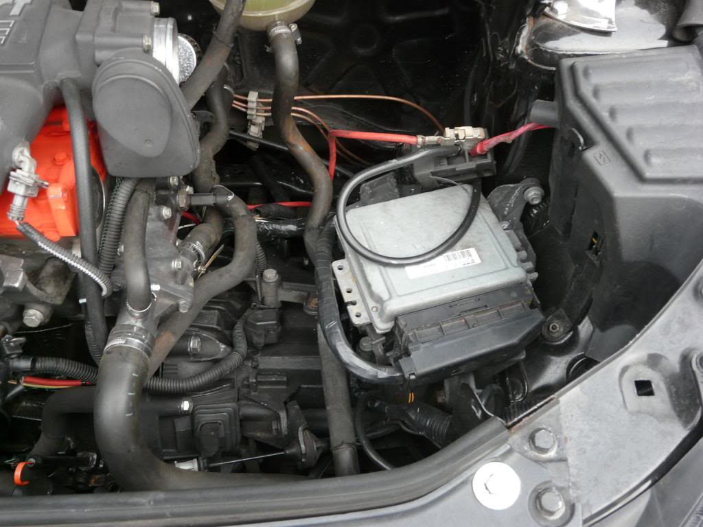

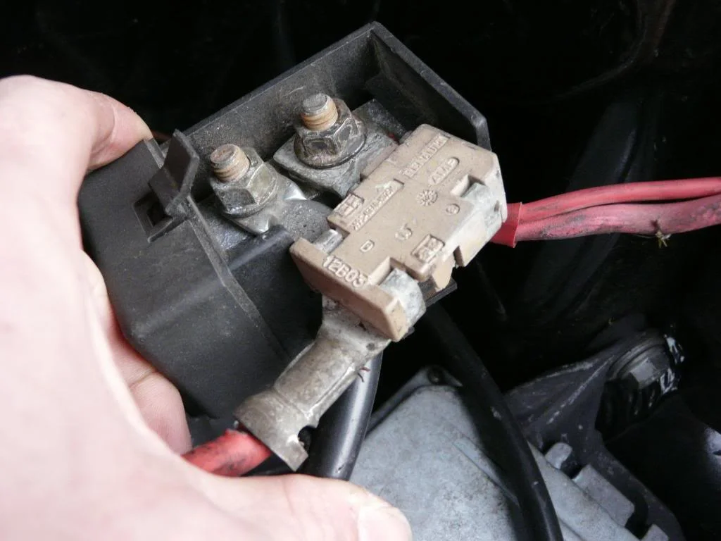

Picked up a connector of Adam so that i could join all the wires togeather in the engine bay....

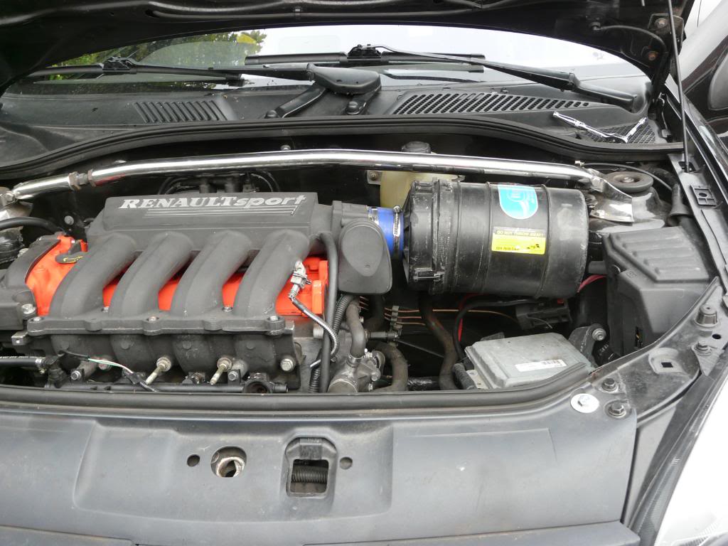

Well now that the battery was moved out of the engine bay it gave alot more room at the side of the engine. I decided to mount the ECU on top of the gearbox mount as it sat perfectly there and was out of the way.
Next thing was to have my ph1 airbox coming straight off the throttle body..... So i got a bit of silicone hose of jord and fitted it. It makes the whole bay look alot tidier.

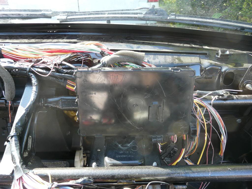

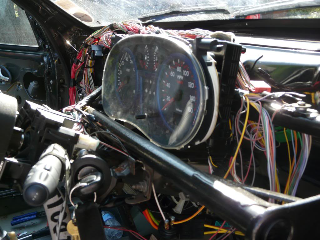

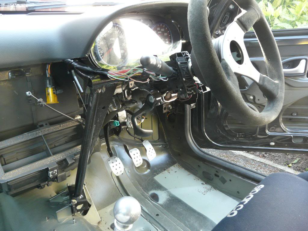

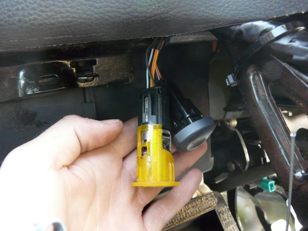

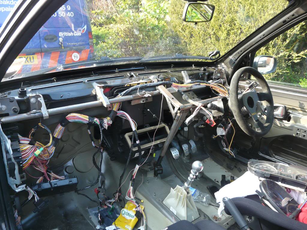

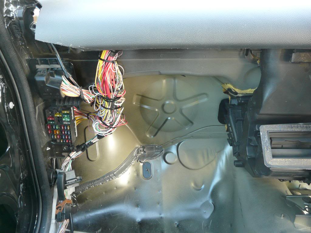

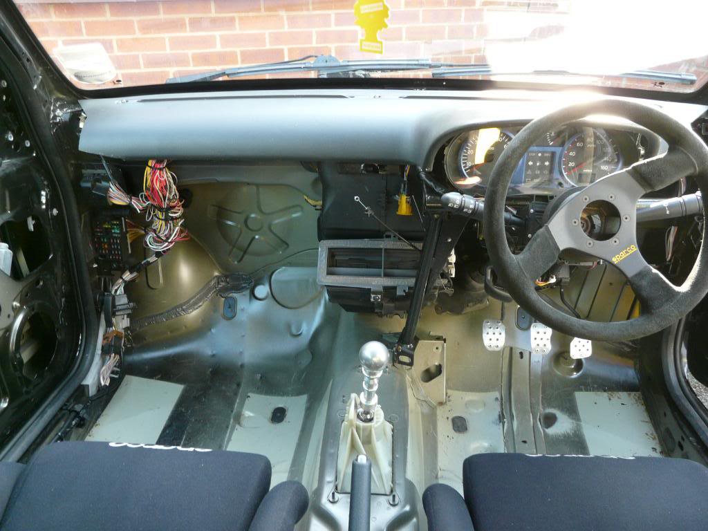

Since i have fitted a MK1 dash into the car. I cut the passenger side of the metal frame off that normall holds the standard dash in, and mounted the mk1 dash to remaining half and used 2 of the existing holes near to the windscreen to screw the back down.

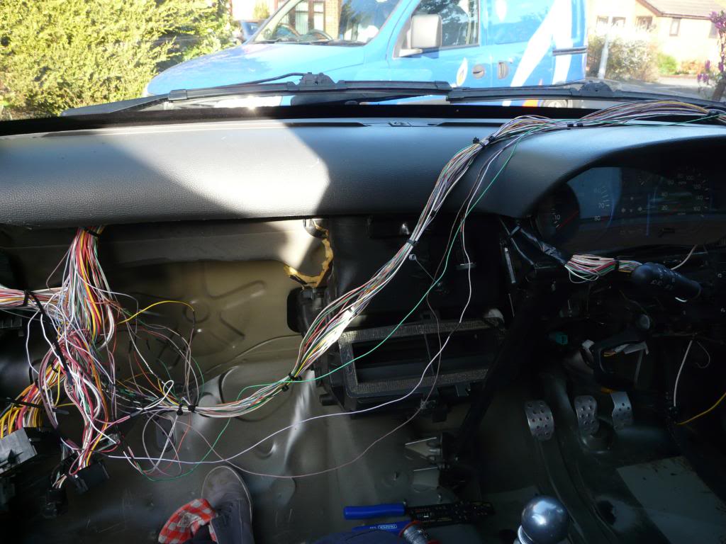

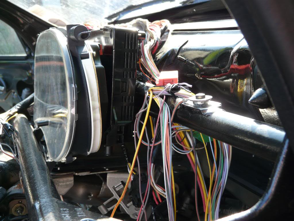

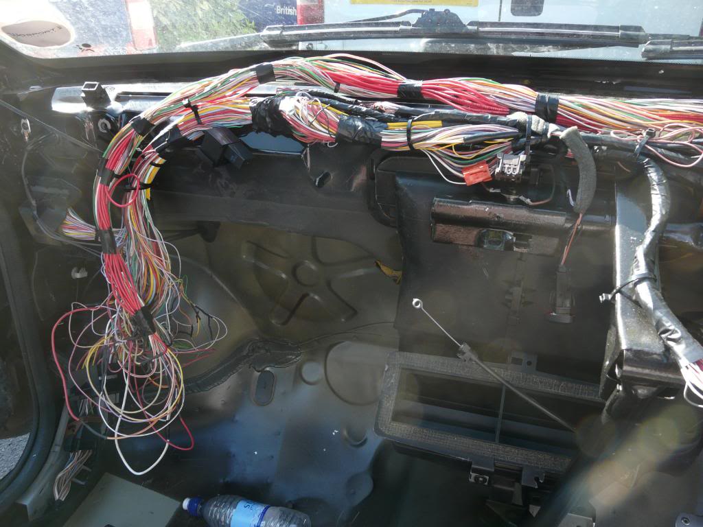

After the dash was in the uch, and fuse box were just hanging down on the passenger side. Ive decided to mount the uch behing the clock and run the wires under the dash. This means extending all of the wires that go to the uch.
1 connector done....... 2 more to go.......
Will post more pics up as im going to finish the rest of the wiring this week.

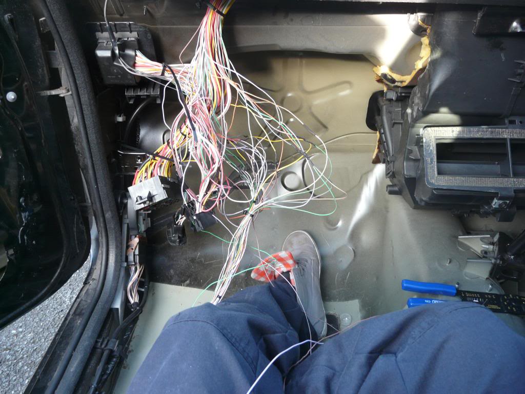

Well ive spent the last few days sorting all the interior wiring out. Mostly moving the ecu to the other side of the car so it sits behind the clocks as its going to be out of the way there. So after moving the uch, i decided to cut a few other wires down and move a few other bits. So after hours of re-wiring i came to start the car and.......... Nothing.
First thing was check the fuses...... one fuse had blown...... replaced the 5 amp fuse..... Nothing. Eventually i tracked it down to a broken wire after several hours with the multi-meter. I then replaced the wire and took the car for a drive to check everything was ok. Down the road onto a major roundabout seccond in line at the lights and then the car decides to cut out. Rang the AA got the car home.... another few hours looking at the loom and found on one wire.... there were a few strands of the wire sticking out of the heat shrinnk and touching the chassis.... fixed that and its all wrking fine now. All the loom had been tidied up and as a result of that the whole inside of the car looks alot tider now. Will take some pics tomorrow and post them up.

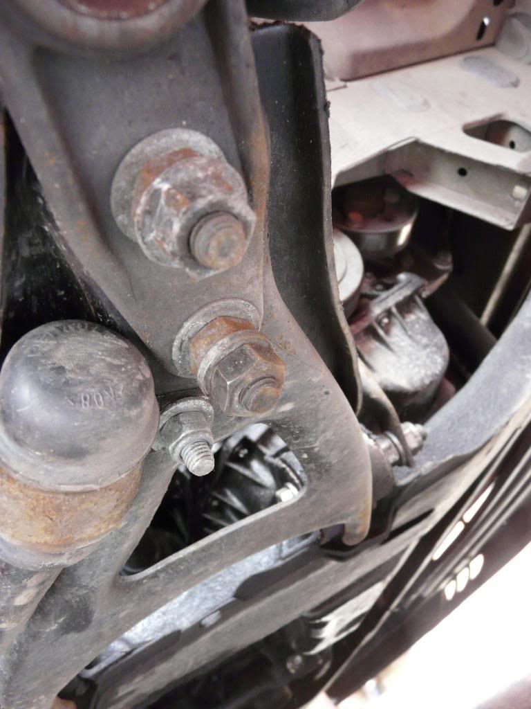

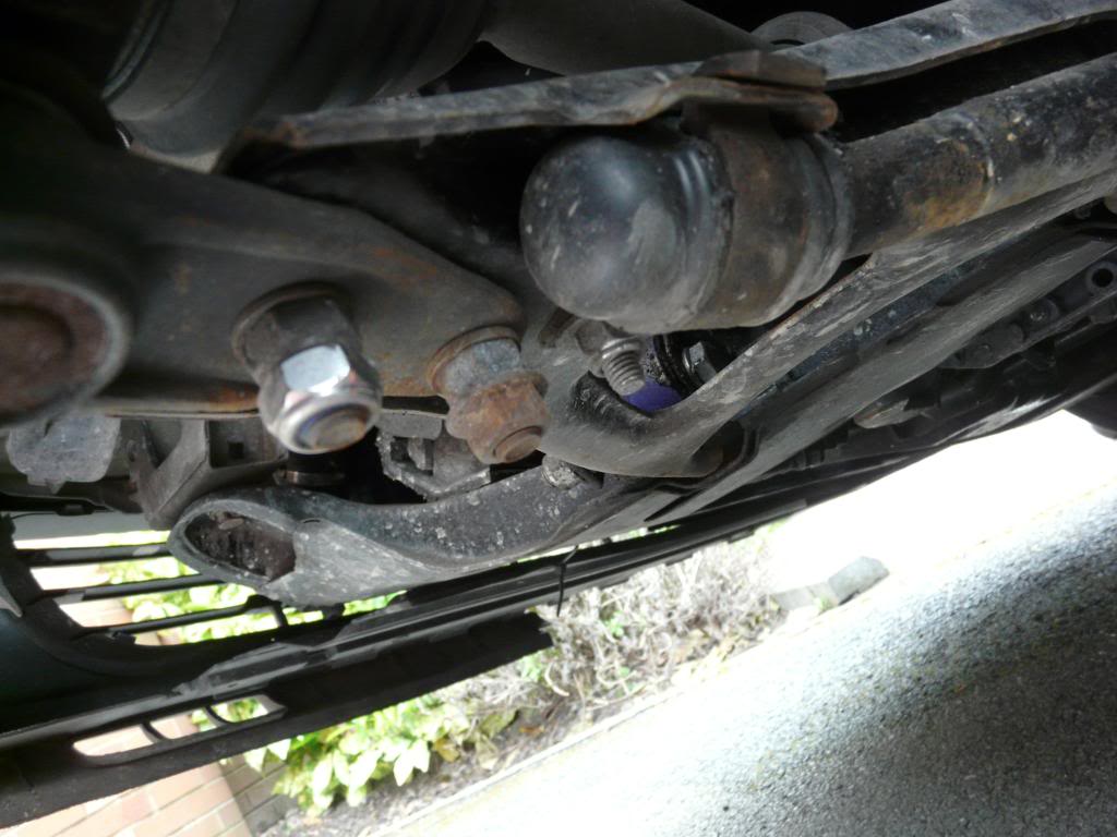

Ahhhh... was drivng about over the weekend and i suddenly developed a knocking when setting off and sometimes under braking. I thought hmm this sounds similar to last time the ball joints came loose. So anyway got home and...... no it wasnt the ball joints.... i checked to see if they were all tight anyway...........
Still havnt found the cause of the knocking but im going to have another look tonigt now it has finally stopped raining.

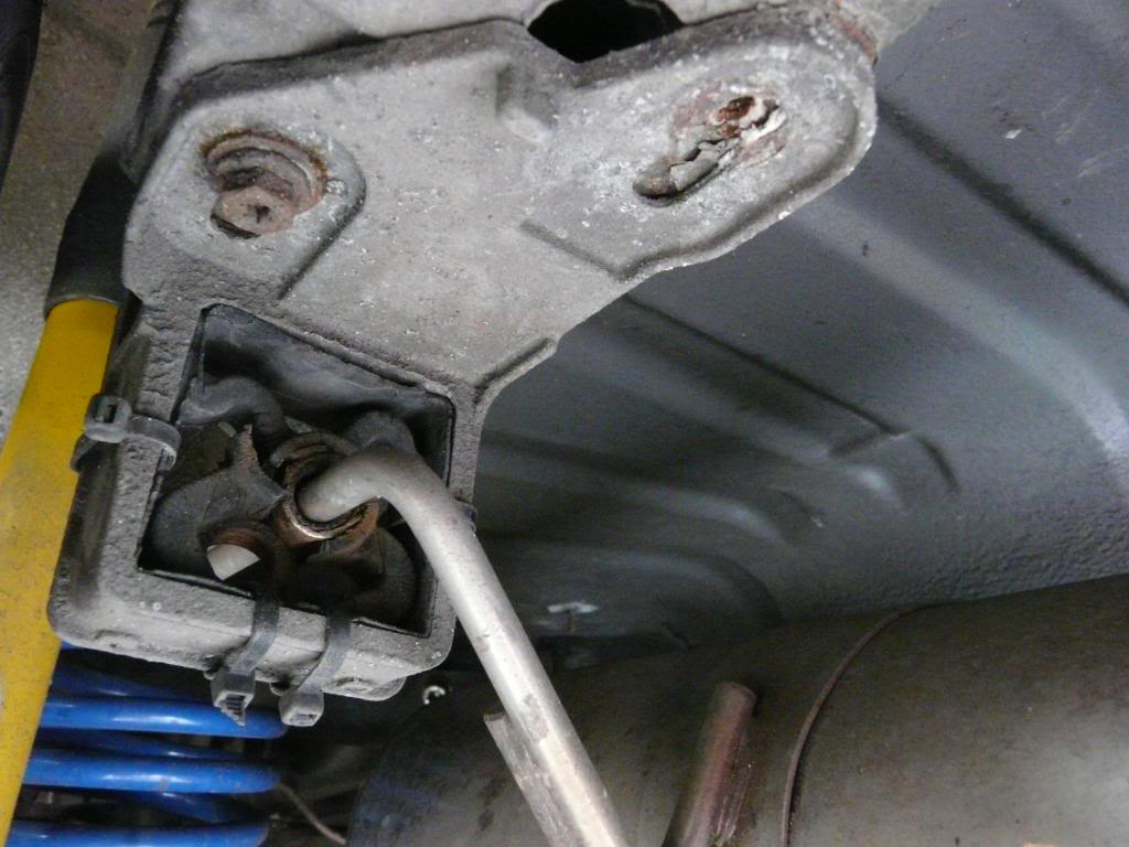

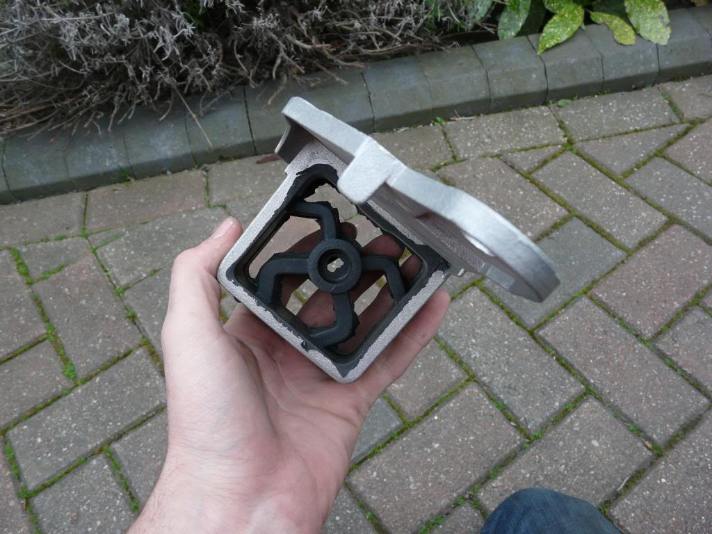

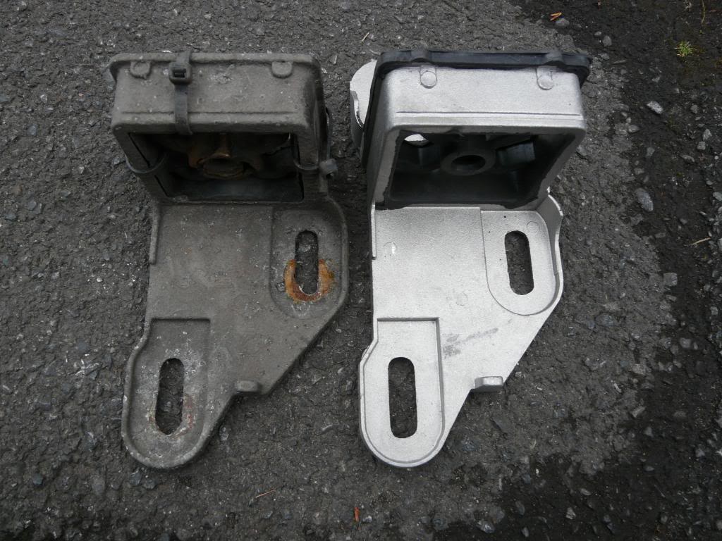

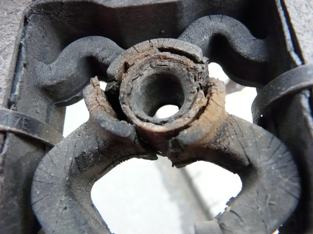

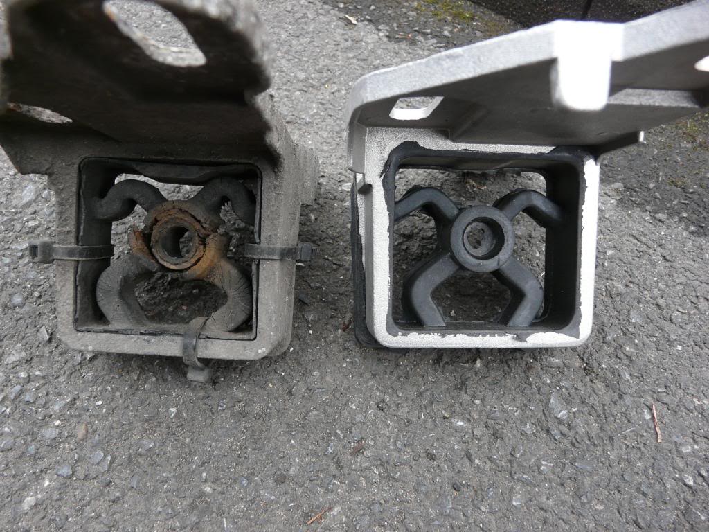

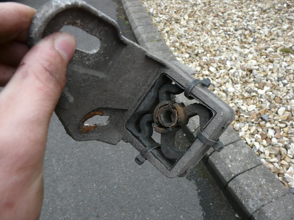

Whilst the car was jacked up i decided it was about time i changed the exhaust mount. Got another one a few weeks ago but never go around to fitting it. My current one is just a mess lol.
After the old one was removed i greased the bolts up and put it all back togeather.....
Job done. NOw all i need to to before my first trackday it to find out what this knocking from the front end is..........:S

Well the squeeking has stopped now, i just greased the dogbone mount. It may just be me......... but i cant find anything that is loose.

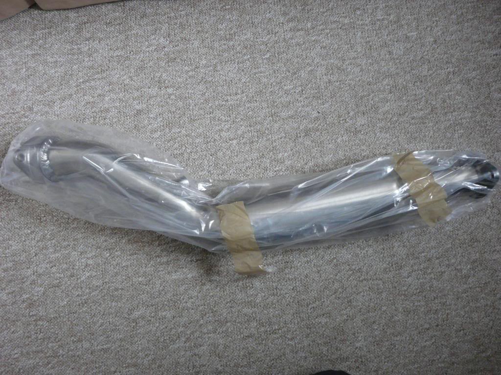

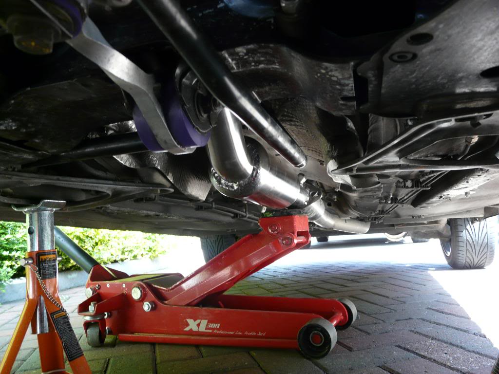

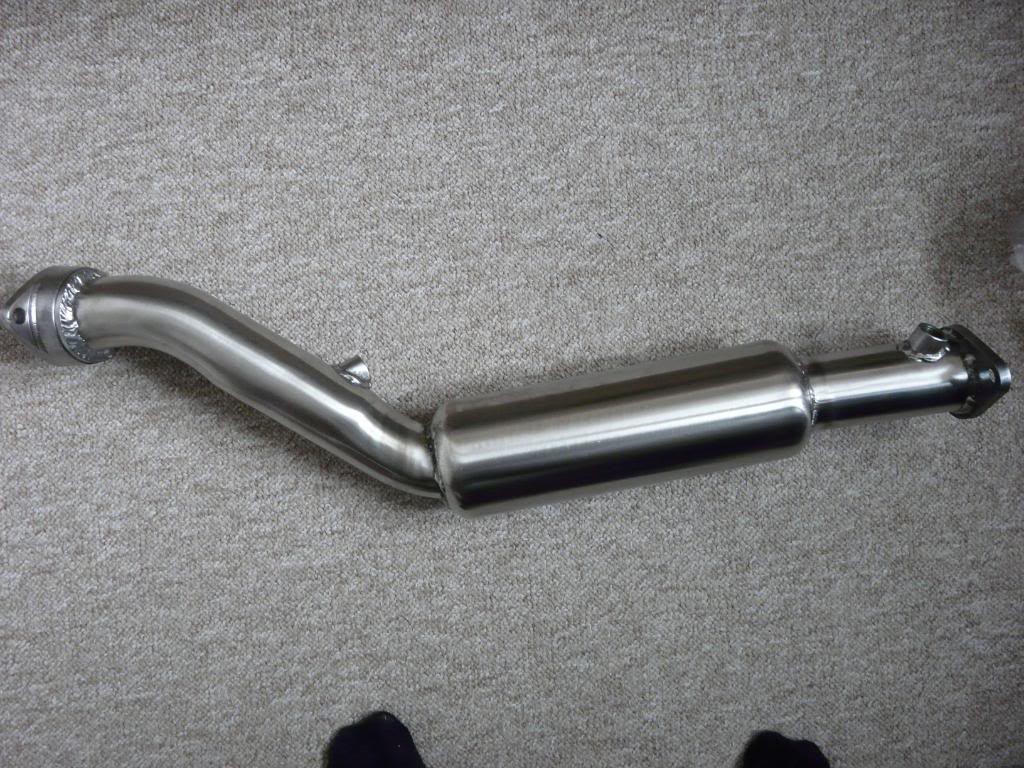

Since the car has been built i have had a proble with the gear linkage catching on the lamba sensor. The linkage catches the sensor in 1st and reverse, ive been toying with the idea of getting a sports cat for a while. Anyway i had to nip to NorthWest Performance to pick a few bits up, and got on the subject of silenced de-cats. So i decided to get one of the silenced de-cats whilst i was there. A few pics.............
Going to fit it tomorrow if it isnt raining..... More pics then

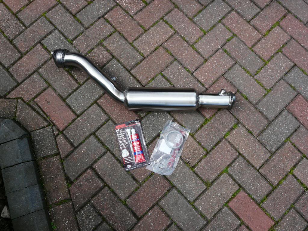

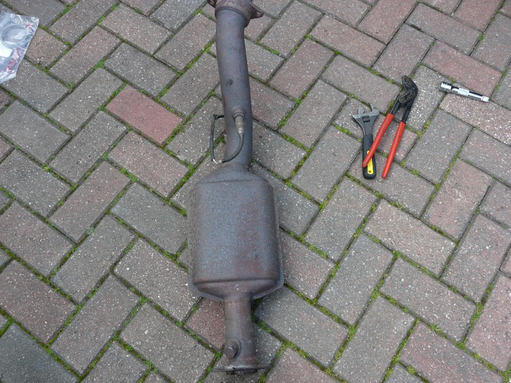

Right well after waiting round for a gasket for most of the day, i was able to start putting the decat on this afternoon. Was a pain to put and was very time consuming. But i got there in the end.
Now for the pics.....

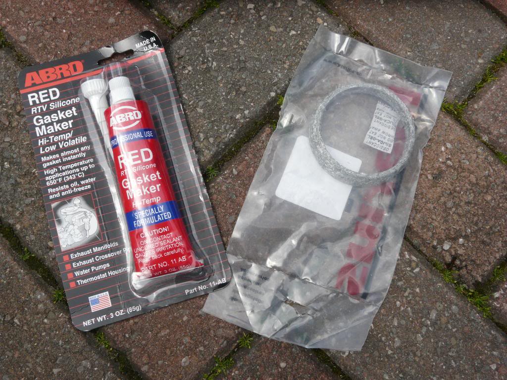

I picked up a new gasket for the maifold to cat, the current one has only been on a few months but as it has already been compressed i thought it was best to buy another one for the sake of £3. I also picked up a tube of sealant for the flange on the cat back all purchased for under £7 bargin.

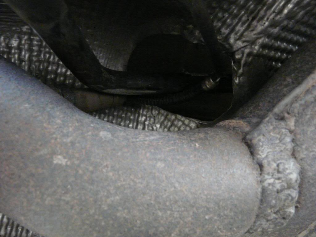

As said before the lamba sensor is catching on the gear linkage for some reason. That was one of the reasons for changing. Managed to get a pic of it but its not ver good.

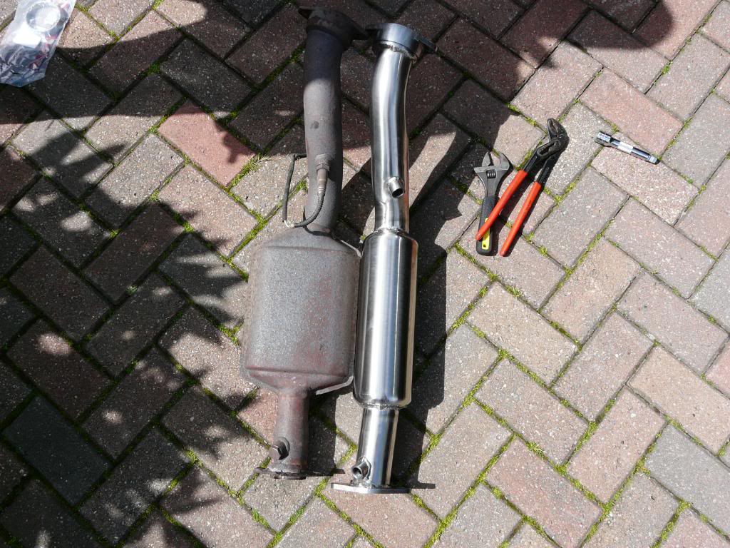

The standard cat....
Took a while to remove as i was on my own but after a few choice words it eventually came out...
Old and new :D
Next was to remove the lamba sensor and the bung at the rear of the cat..... easier said than done lol.

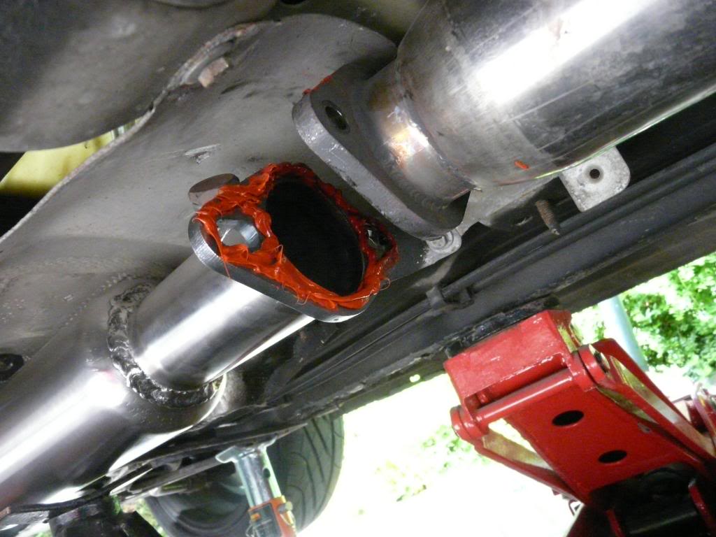

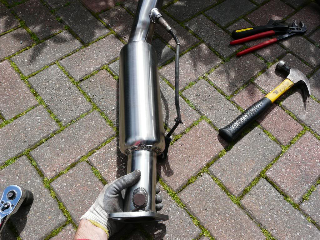

Next was the fun part. Putting the new silenced de-cat in. After abit of rigging with the jack and a axel stand it eventually went in.
Tightened the front up slightly before putting the sealant on the flange to join to the cat back.
Then tightened everything up and waited for it to set.....

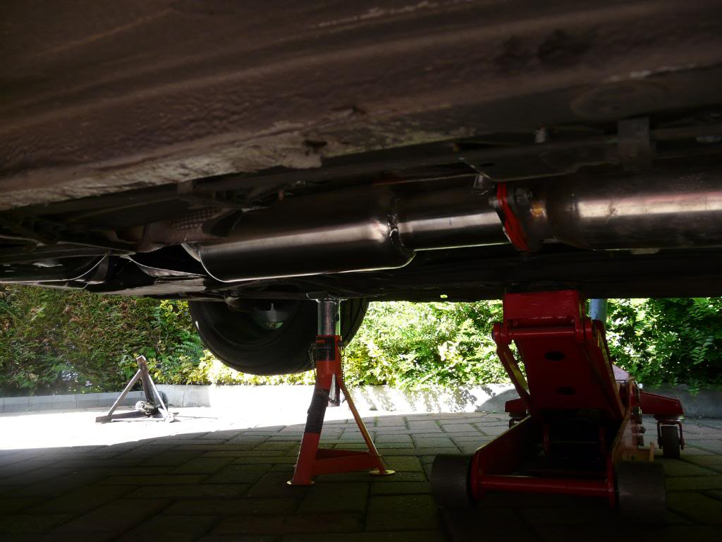

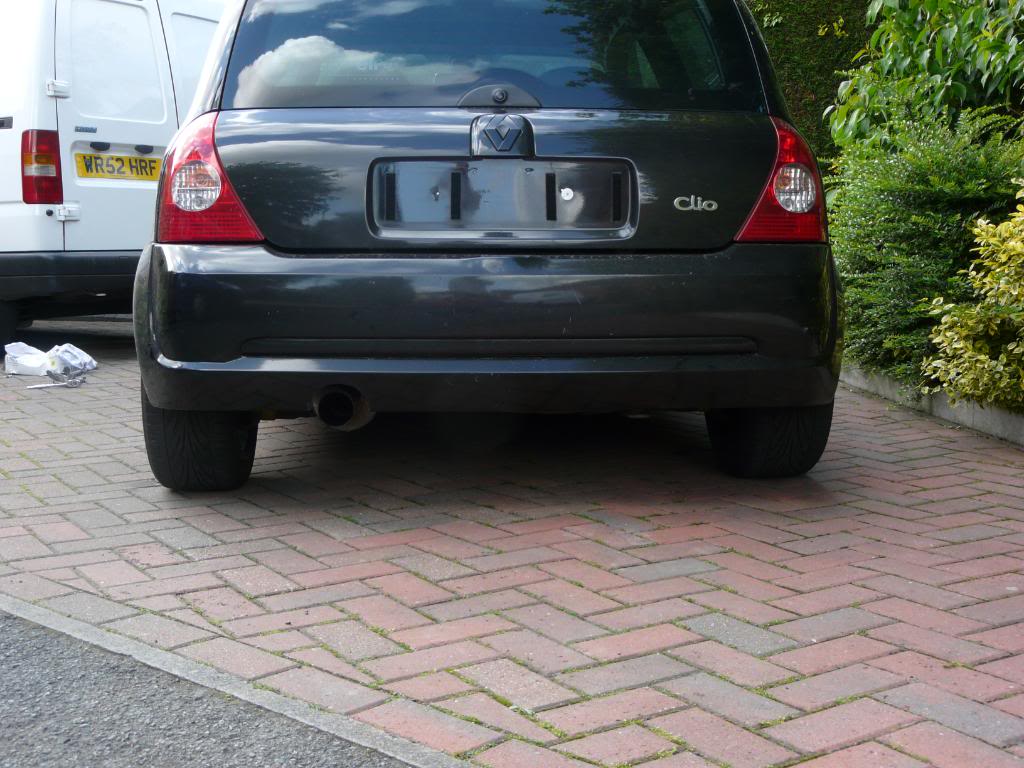

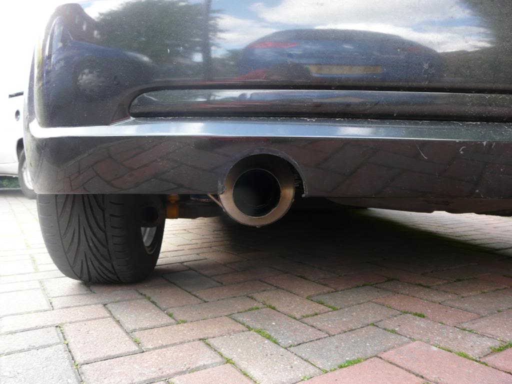

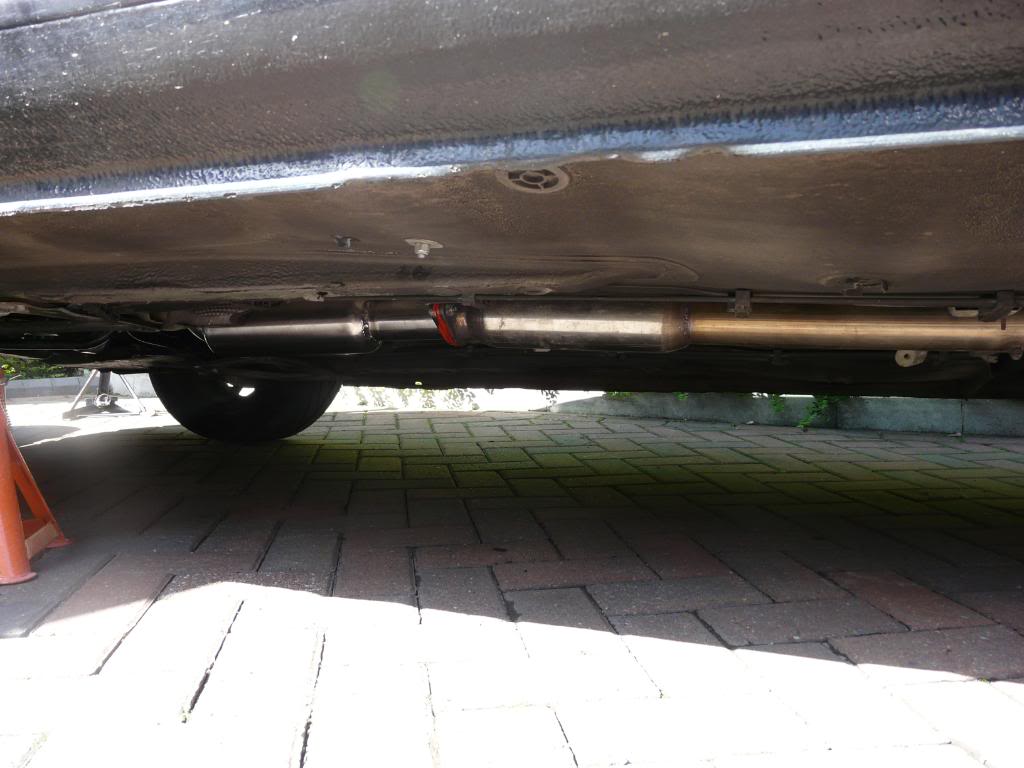

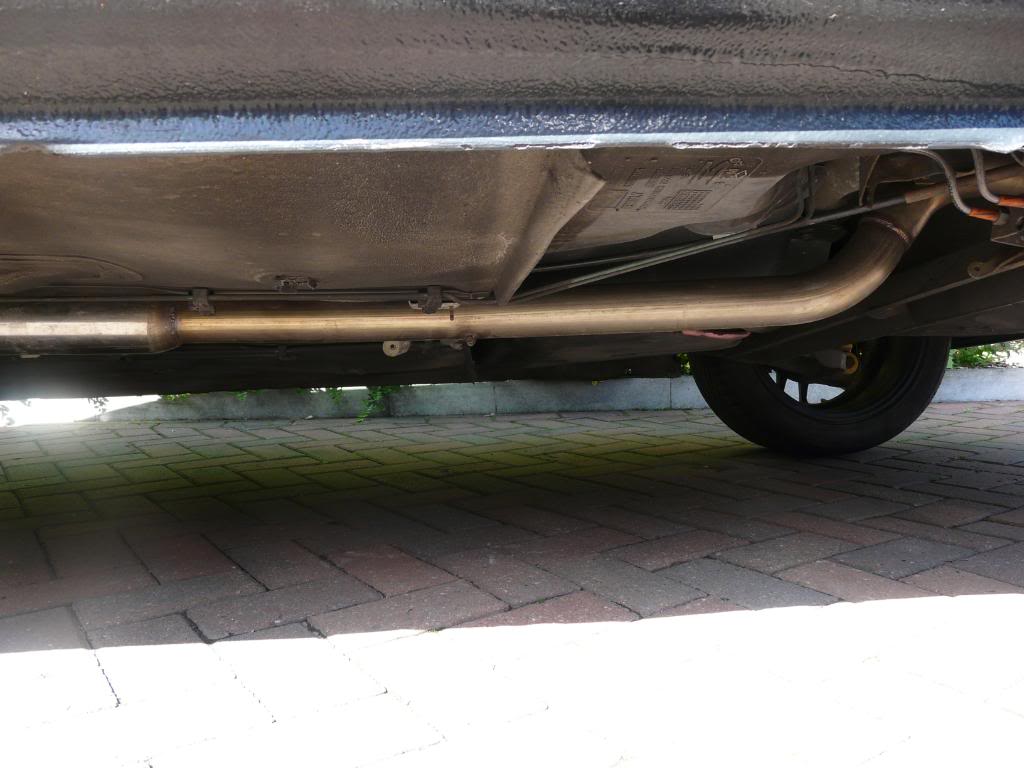

Managed to get my Yozza to sit in my cutout aswel... it still needs to go to JP exhausts to get sorted properely. But this will do for now.
So there we go Silenced NorthWest performance decat with a Yozza Race cat back.... Lovley.

Looks nice mate. Exhaust looks spot on, may be you wont need to get the bend adjusted after all?
  BMW E36 328
Re: 1.2 Track car Conversion
Thanks mate, Still need to take it to JP to get it sorted out properely. But it looks miles better up in the bumper.
