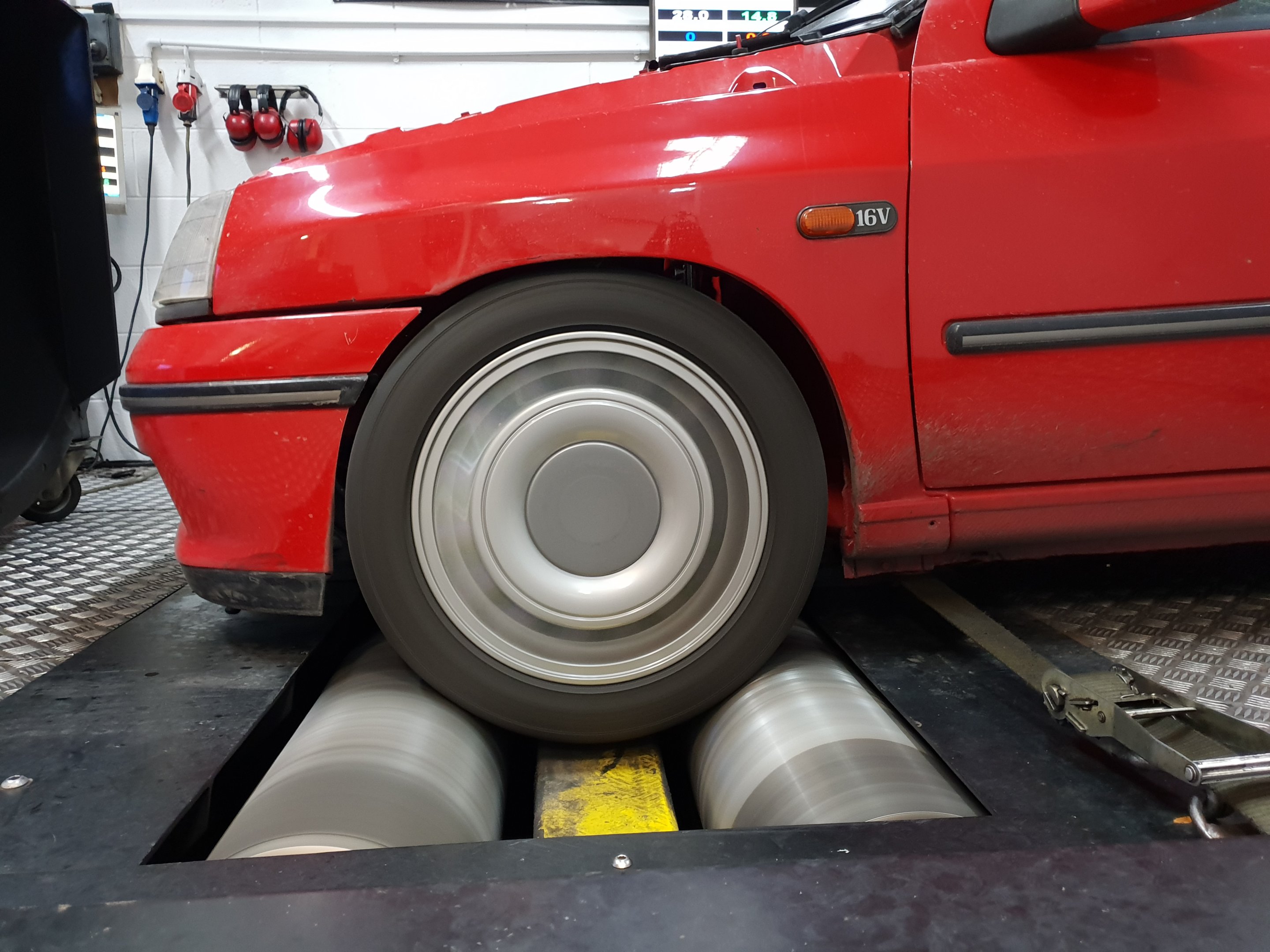

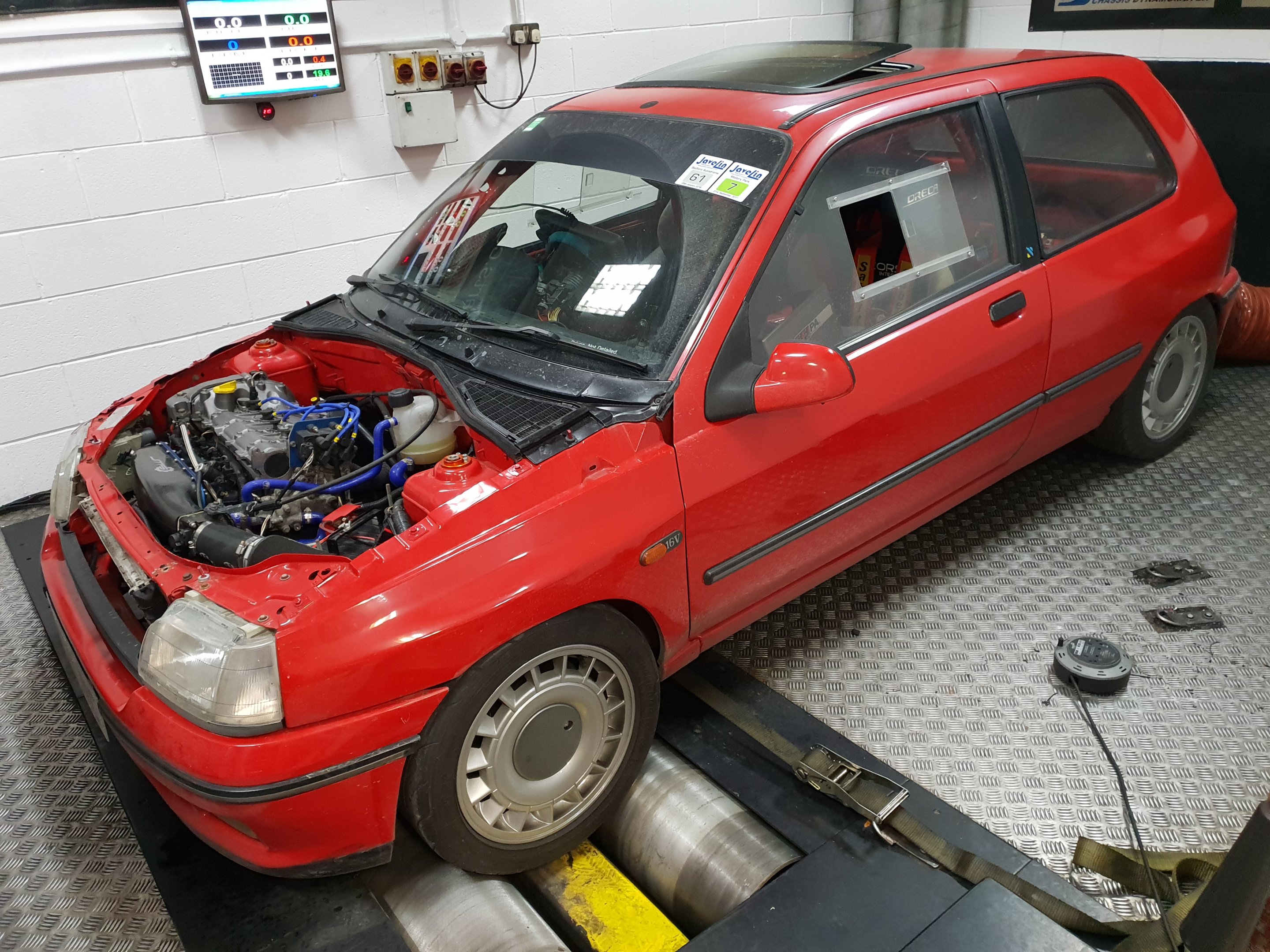

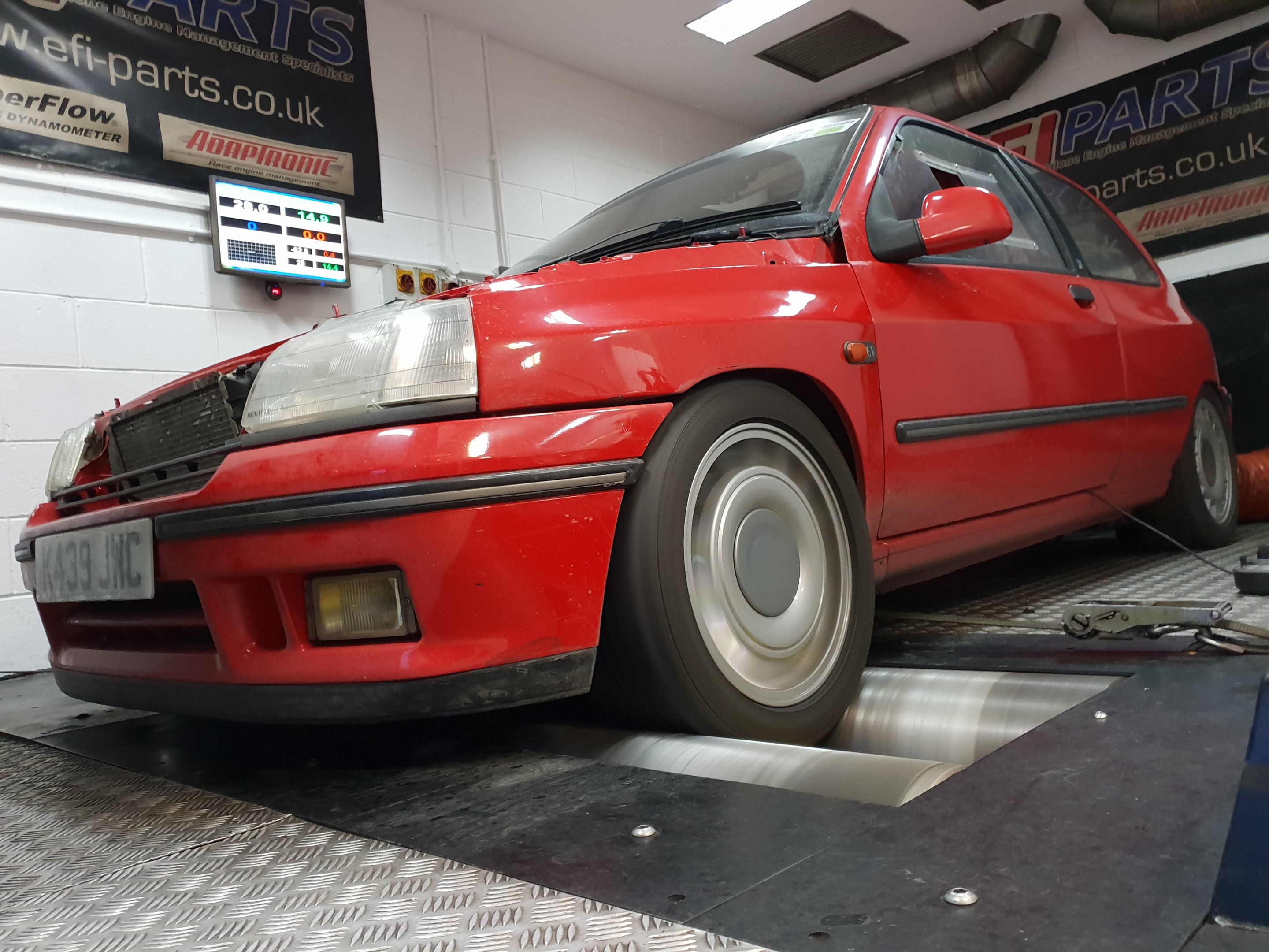

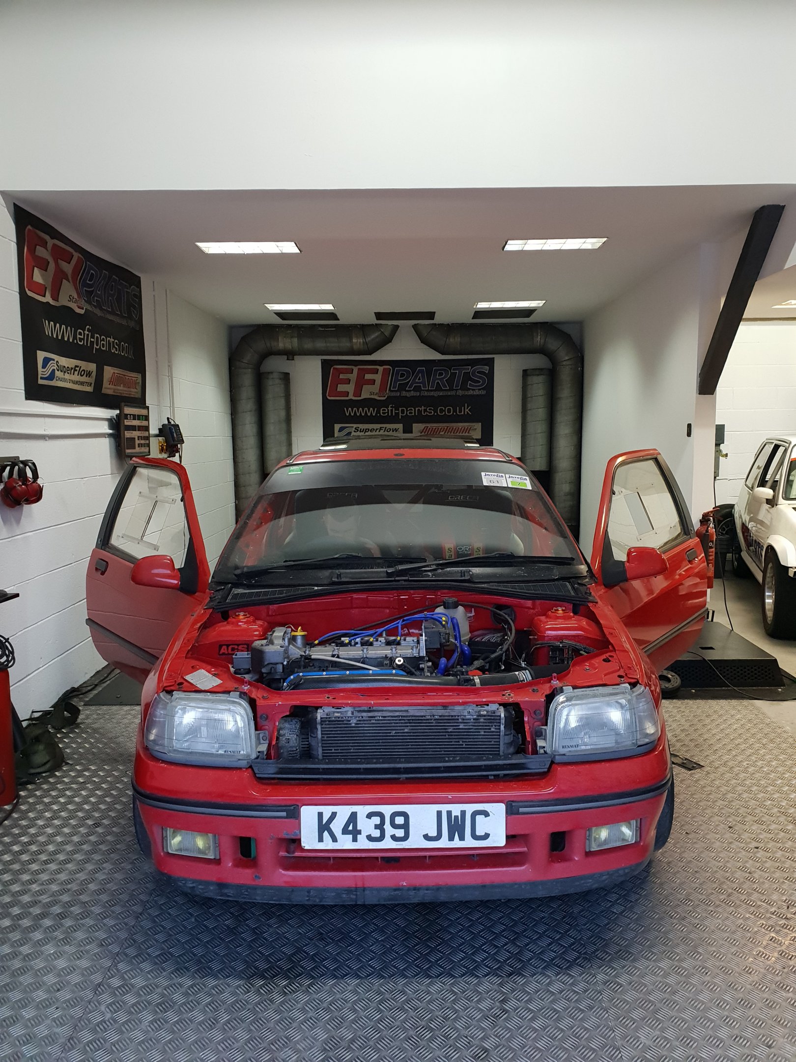

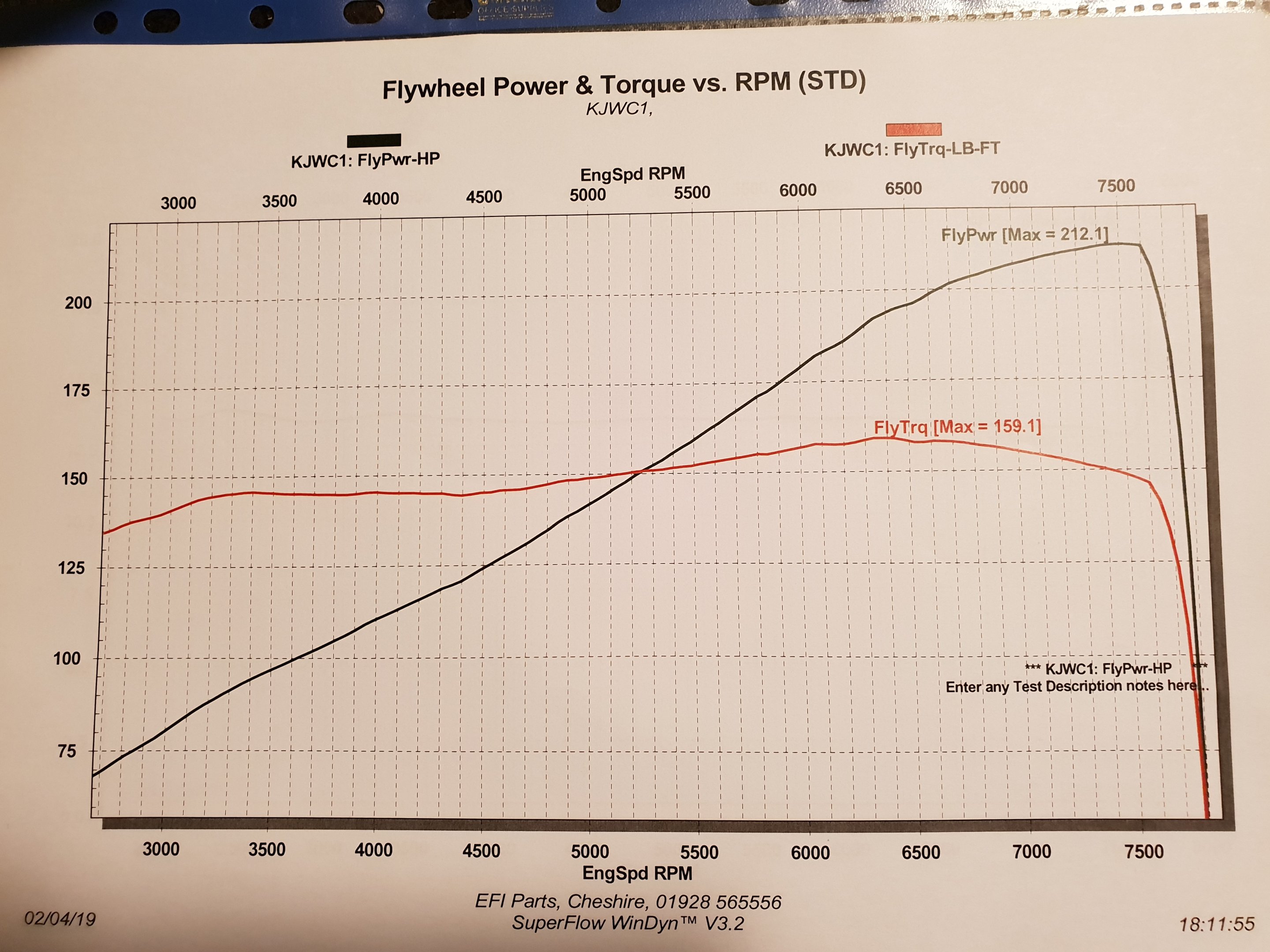

Took a trip over the pennines today to visit @bloke to get the 197 cams timed in then straight over to see Chris at EFi for the whole setup to be mapped.
Cold and foggy trip in a car with no..... well no anything really. But the result was a surprise to say the least.
Thanks again to both Chris and Carl, I'm a happy chap.

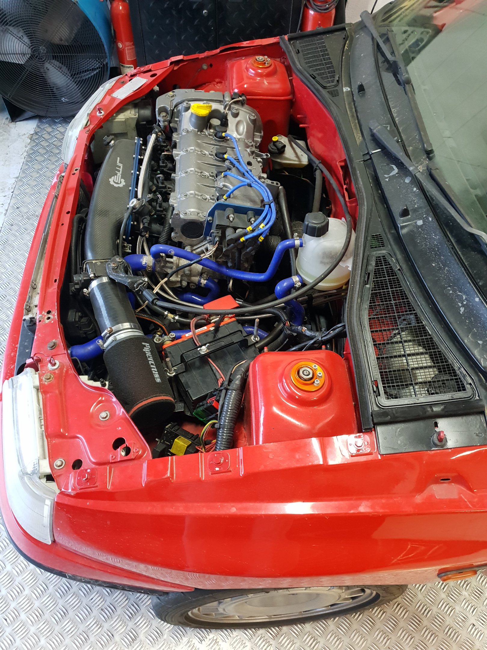

So spec is:
- stock engine
- 197 cams timed to suit
- RS2 inlet manifold
- 197 injectors
- 182 exhaust manifold
- pas delete
Mapped on shell vPower
Cheers
Ben
_Tom
Amazing. Must be rapid. It ran 14 secs at pod with a lower power F7R and full interior. It must be ballistic on track.
Kudos to you.
