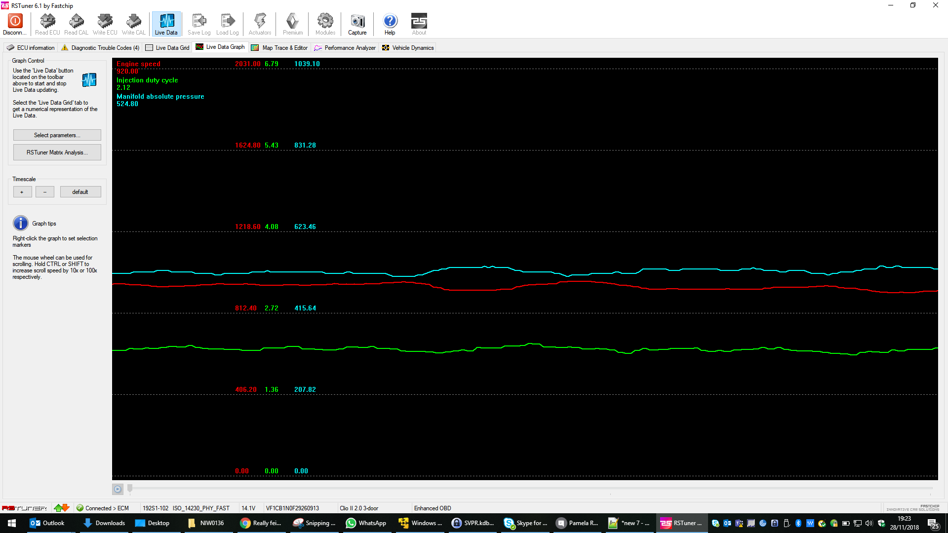

Just checked the MAP sensor anyway.
MAP engine off - 1039.10
MAP engine running - 4-500
  dan's cast offs.
4-500 On idle is a fair variation. Can you graph it and see what it's averaging. Also injector duty cycle reading at idle.

that's high, can't think of exact range reno state but that's over it for sure. what's it read with ignition on but not running? duty cycle isn't bad so could be timing related dependant on what map is with ignition only.
  2003 Clio 172
1039 with engine off buddy.
