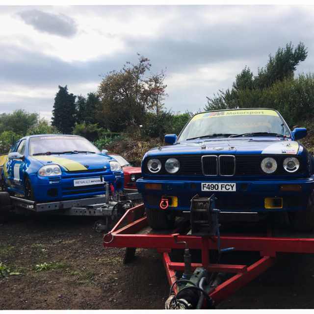

All loaded up ready for Tuesday after a busy day!

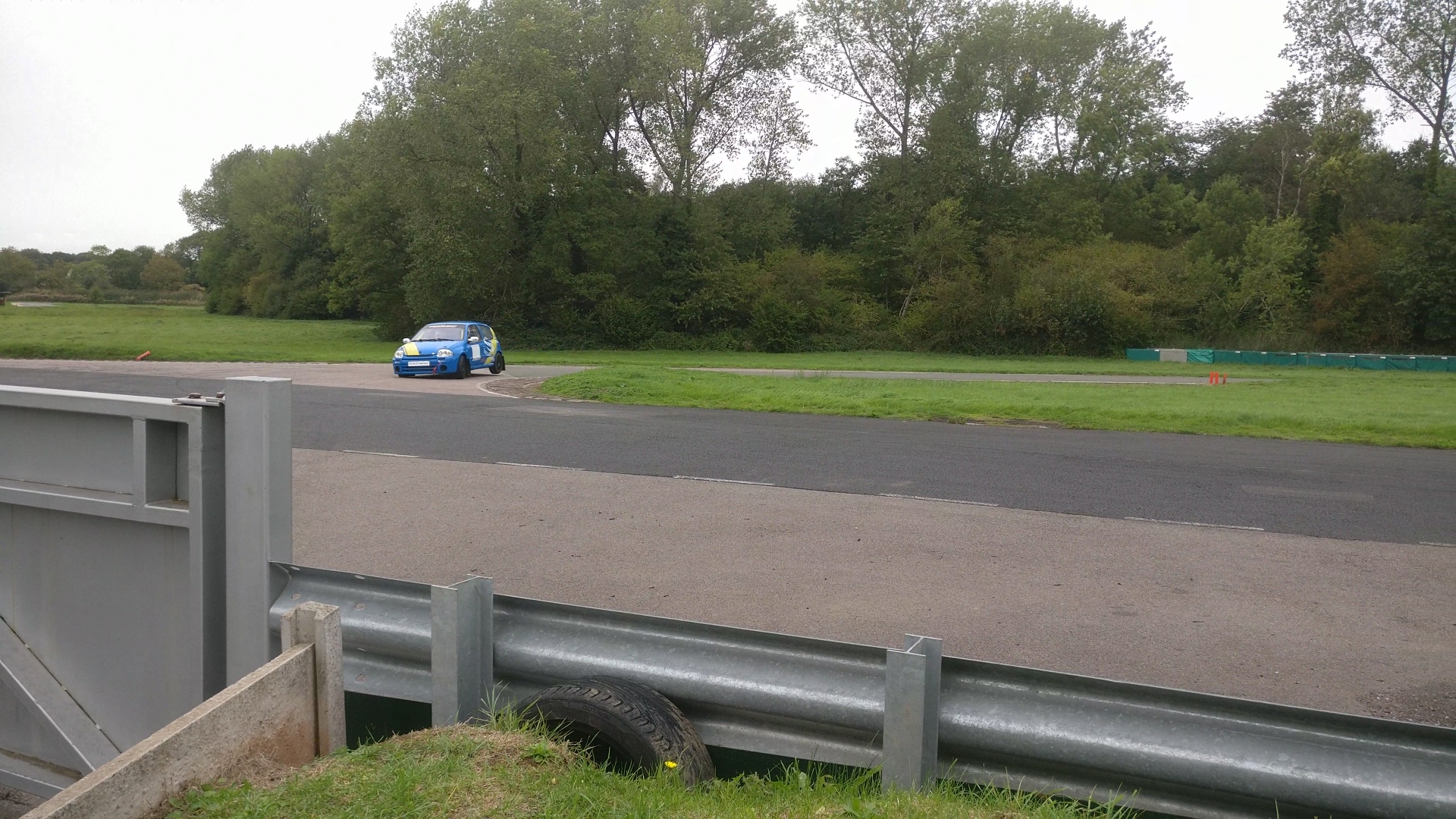

So we made it to our first track day on Tuesday hassle free, until we got there...
On the parade lap we begun driving around the track slowly as you do and got to the straight and the car started misfiring and wouldn't rev over 3000rpm ? Everyone was so confused as we'd been driving up and down the drive hassle free and the car was running spot on. After a bit of investigation when we returned to the pits we decided it sounded like a fueling issue - we've always been curious as to why our fuel pump was so noisy compared to everyone elses, it sounds like it's just sucking air and no fuel. Unfortunately we didn't bring a spare pump with us so I had to drive home to get one along with a crank sensor and coil pack just in case these were causing the issue.

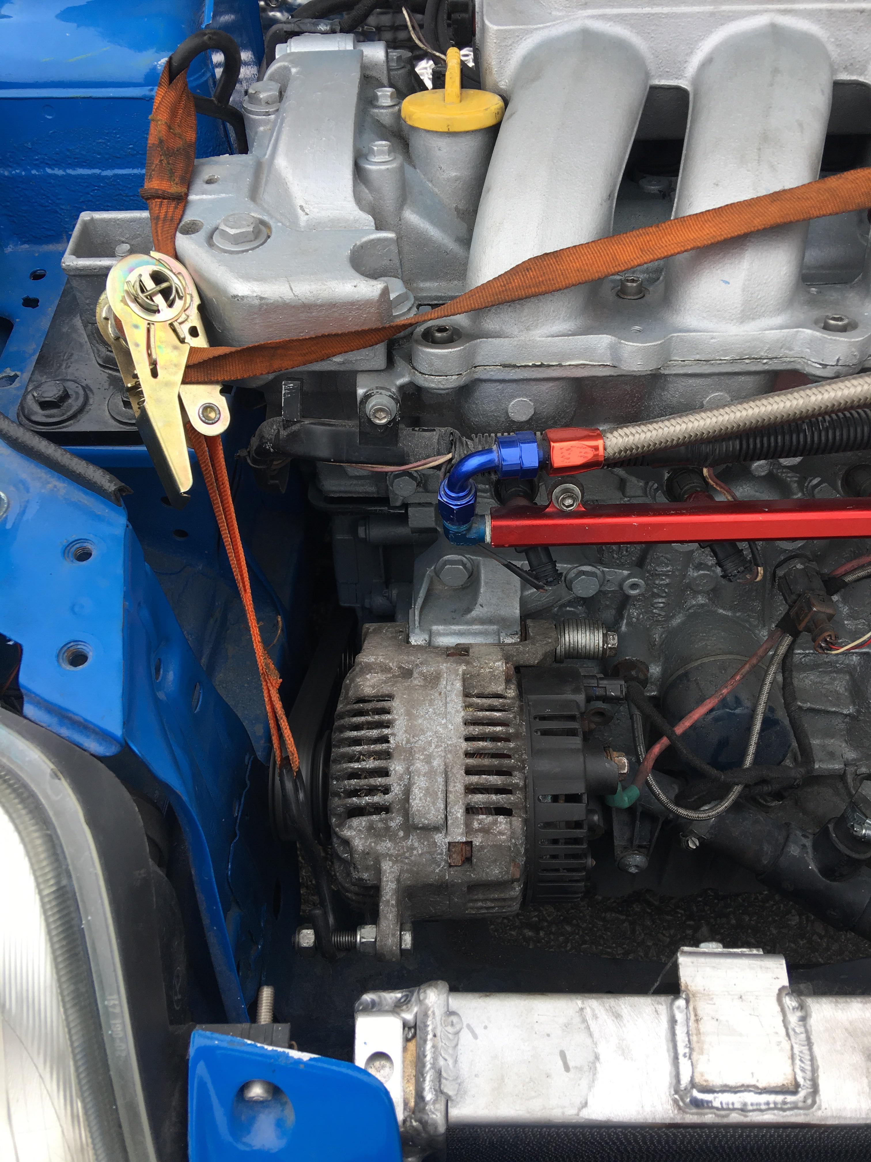

When I got back after an hour or so we took off the pump and replaced it with the spare. Tested it and still the same. Tried upping the fuel pressure on the regulator too and no joy. Unplugged the speedo drive to eliminate an electrical fault, changed the crank sensor and coil pack just to rule them out and still the same story - won't rev over 3000rpm misfiring.
We then went back to the idea of a fuelling issue and I suggested removing the fuel filter out of the system to eliminate that, just as a temporary measure to prove a point. Our Sytec filter is the smaller one of the two they make and our idea was that because of this it was restricting the flow of fuel to the pump. After taking it off and re-connecting the pump with no filter on we started the car. The pump was now silent like it should be and the car ran like an absolute dream much to our happiness ? We we're all so relieved.

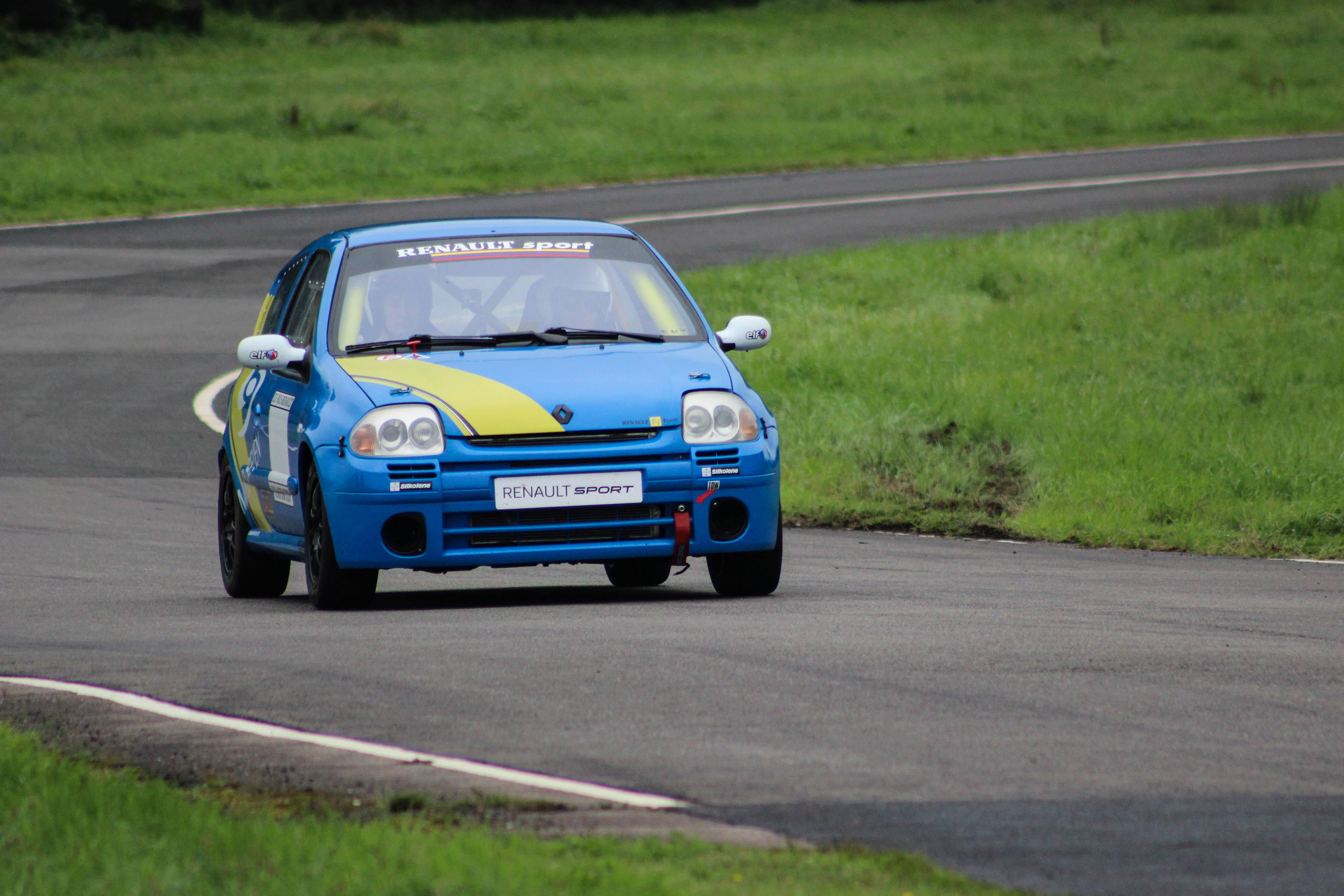

Here's the first ever pics of our car on the track - a proud moment for everyone involved ? It is so responsive to drive it's amazing.
The only crap thing about the car is the brakes. They are absolutely shocking due to having no movement in the pedal ?? After our next track day I'm buying a floor mounted pedal box and fitting that - eliminating the bias box which clearly isn't working for some reason after trying everything I can think of to fix it. Think after another test day I may also buy some 4 pots for the front depending on how it turns out.
Hydraulic handbrake works very well! ?
However it wasn't all fun and games for us in the end after all. Due to removing the filter the pump slowly started becoming more and more noisy as the afternoon progressed and we managed about 15 laps in total before the misfiring issue returned.
We knew it would happen but we enjoyed ourselves so it was worth killing the pump and filter... Also we forgot to plug the speedo drive back in after excitingly fixing the issue and rushing out on track and so that plug has now been ripped off lmao? You can see it under the car in the pictures hanging around lol.
Yesterday Pete took the filter apart to see what crap was stuck in it and it's now pretty obvious why we had an issue. Aluminium filings from when we had our filler cut off and re-welded.
Obviously we can't just leave this now as it will just do the same again so the plan is to siphon all the fuel out of the tank and then clean it out until we can no longer see anything else other than fuel. Our existing filter has been cleaned out and so is safe to re-use but I've bought another one (bigger this time too) along with a metal filter element for piece of mind that the paper filter won't collapse.. Will maybe do the same with the pump depending on what we discover.

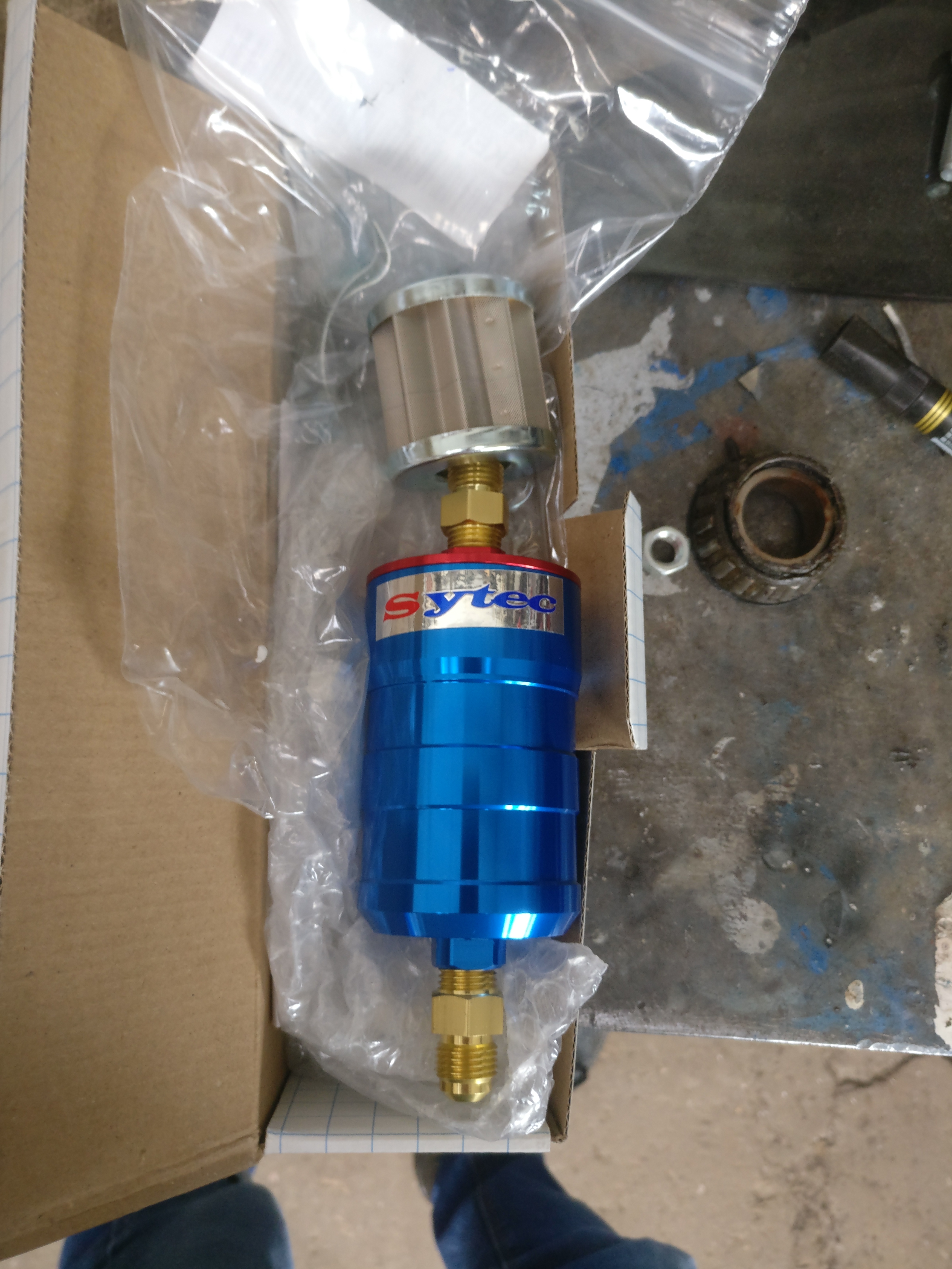

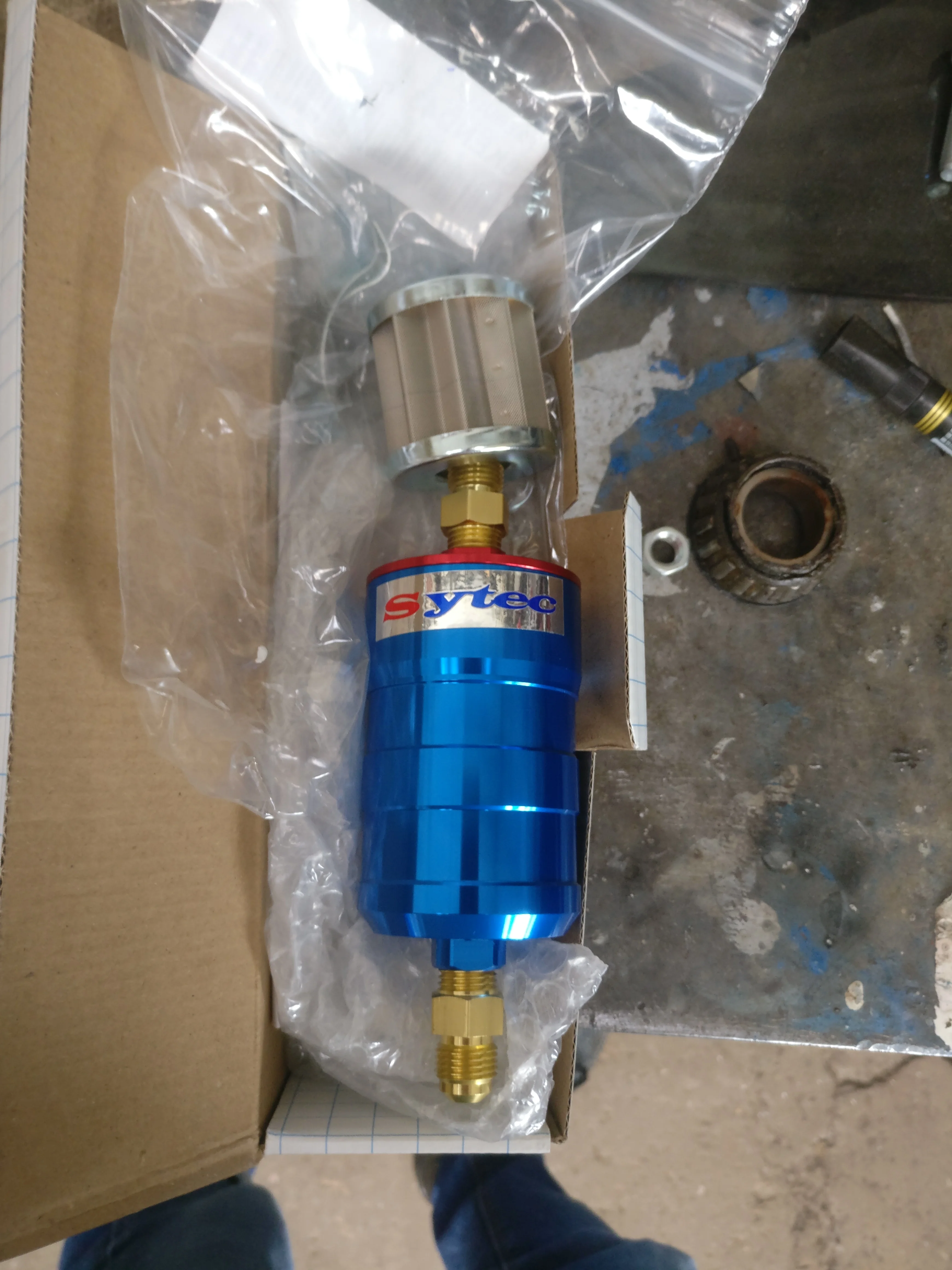

Good news!
The bigger Sytec filter turned up yesterday, as well as the metal gauge filter element to replace the standard paper ones. Changed this for piece of mind as I know people who have had their day ruined by the paper ones collapsing so may aswell fix that problem before it ever arrives.
Fitted it last night and the pump is back to being quiet again ?

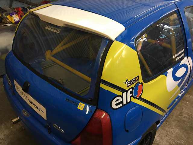

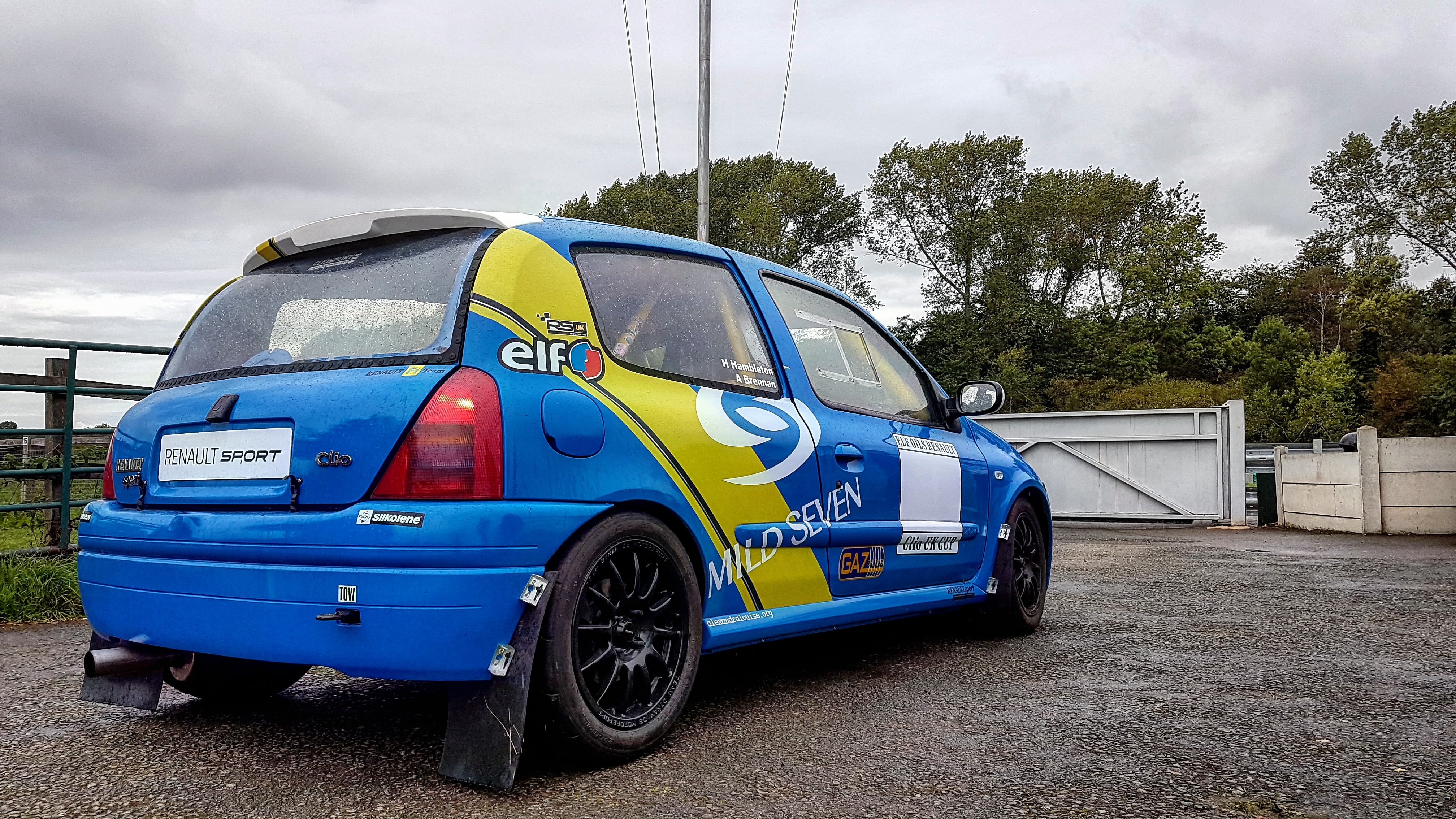

Tonight Alex painted a nice edge on our polycarb rear windows to give them a nice finish they've been lacking. Used matt black polycarbonate paint which worked a treat.
Takes your eye off the million rivets we had to use on the rear window ?
While she was doing that I was redoing the tracking as we discovered the steering wheel was slightly off centre when driving at Curborough - should be all straight now!

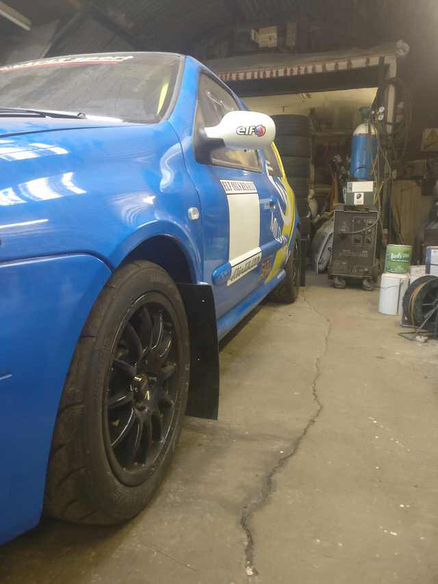

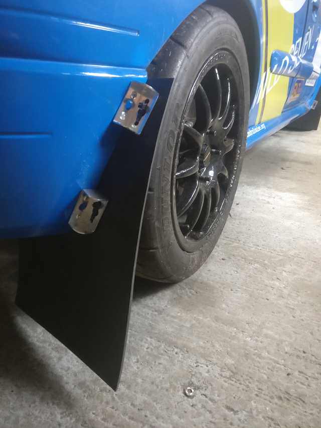

After that we both jumped on fitting our mudflaps which I've made out of 4mm black rubber to meet MSA specs. All 4 are now half secured on, so no pics yet until they're all on properly.
Car just needs the mudflaps finishing up, a quick check over, a wash and it's good to go for Saturday!

  • Front and Rear mudflaps are on.

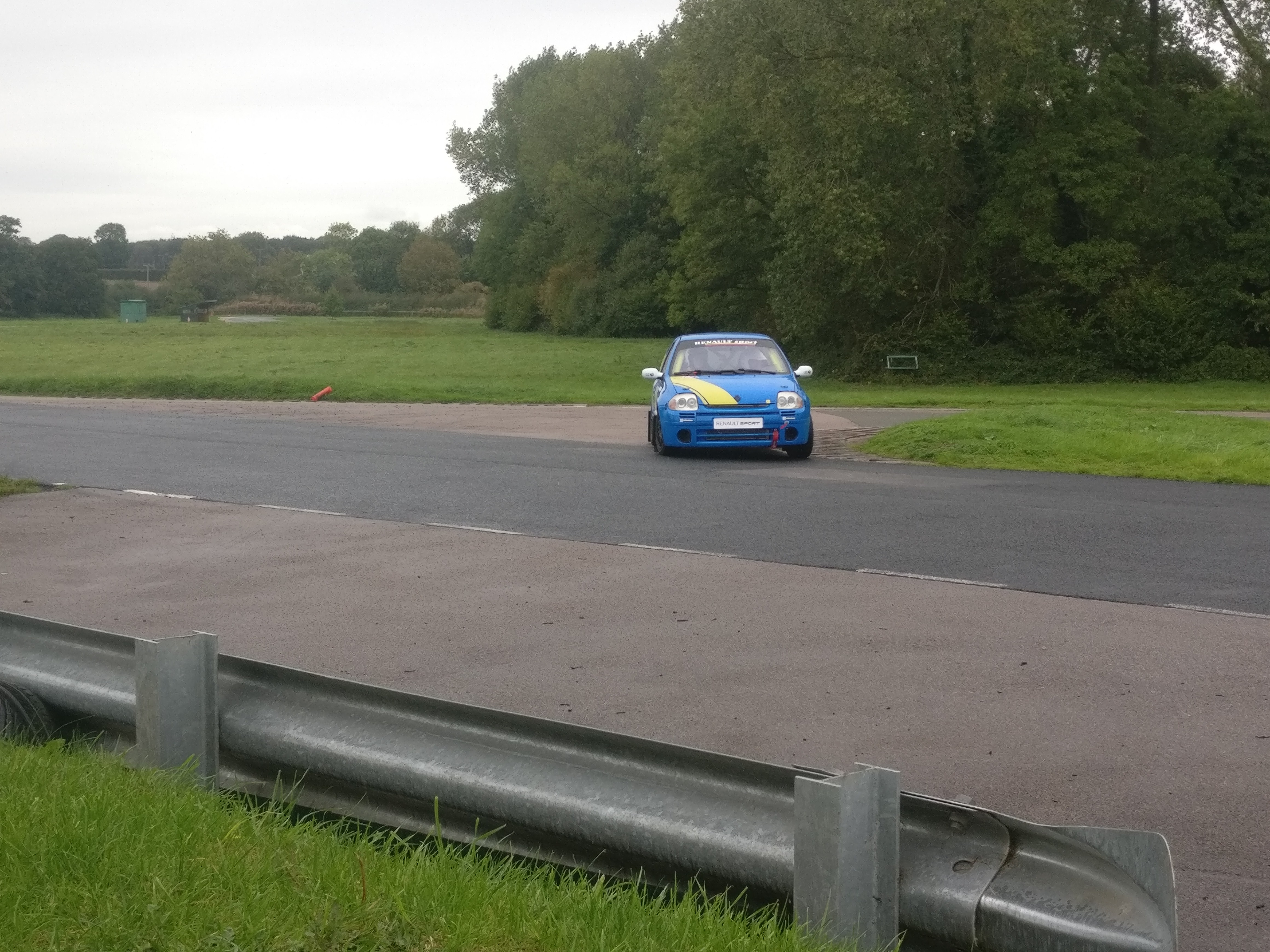

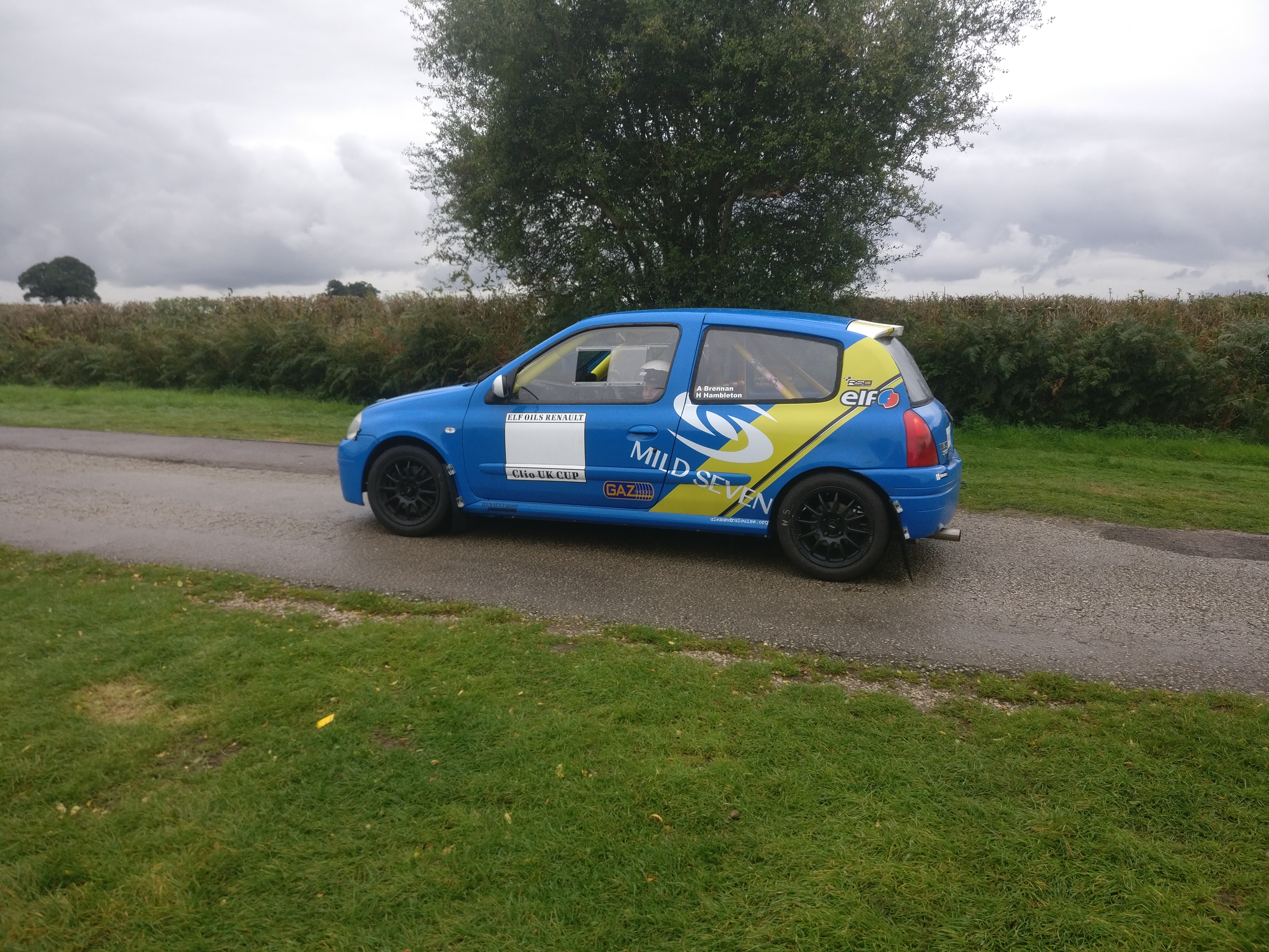

Had an absolutely awesome day Saturday. Stayed dry in the morning until lunch and then rained all afternoon but that didn't stop us blasting around for the entire day pretty much non stop.
Car performed perfectly, really happy with the setup. Only thing that needs changing regarding setup is the brake bias is way too far on the rear as it kept locking the rear under heavy braking and flicking the back end everywhere ? Was very fun tho catching it... and spinning ?
Photo Creds: Jamie Fowkes for this one.
Only came across two issues the entire day. One being the car cut out after coming in off a run. We bump started it as it wouldn't turn over, sounded like the battery was dead (which it was). Tested the voltage at the alternator and it was dead. Luckily we had a spare alternator with us! However, it wasn't a Cup alternator and so the mounting holes are slightly different on the front. We thought it was game over - I spent ages ringing local motor factors and none of them had one in stock of course. But Pete being Pete didn't give up and raided the van for random parts to make it work. Using the standard rear facing mounting holes he bolted it on while I pulled the alternator up as hard as I could to tighten the belt. Then to keep the tension on the belt we put a ratchet strap on the front of the alternator to hold the tension - pure genius.
This amazing invention lasted the entire day ?? - without any fault at all

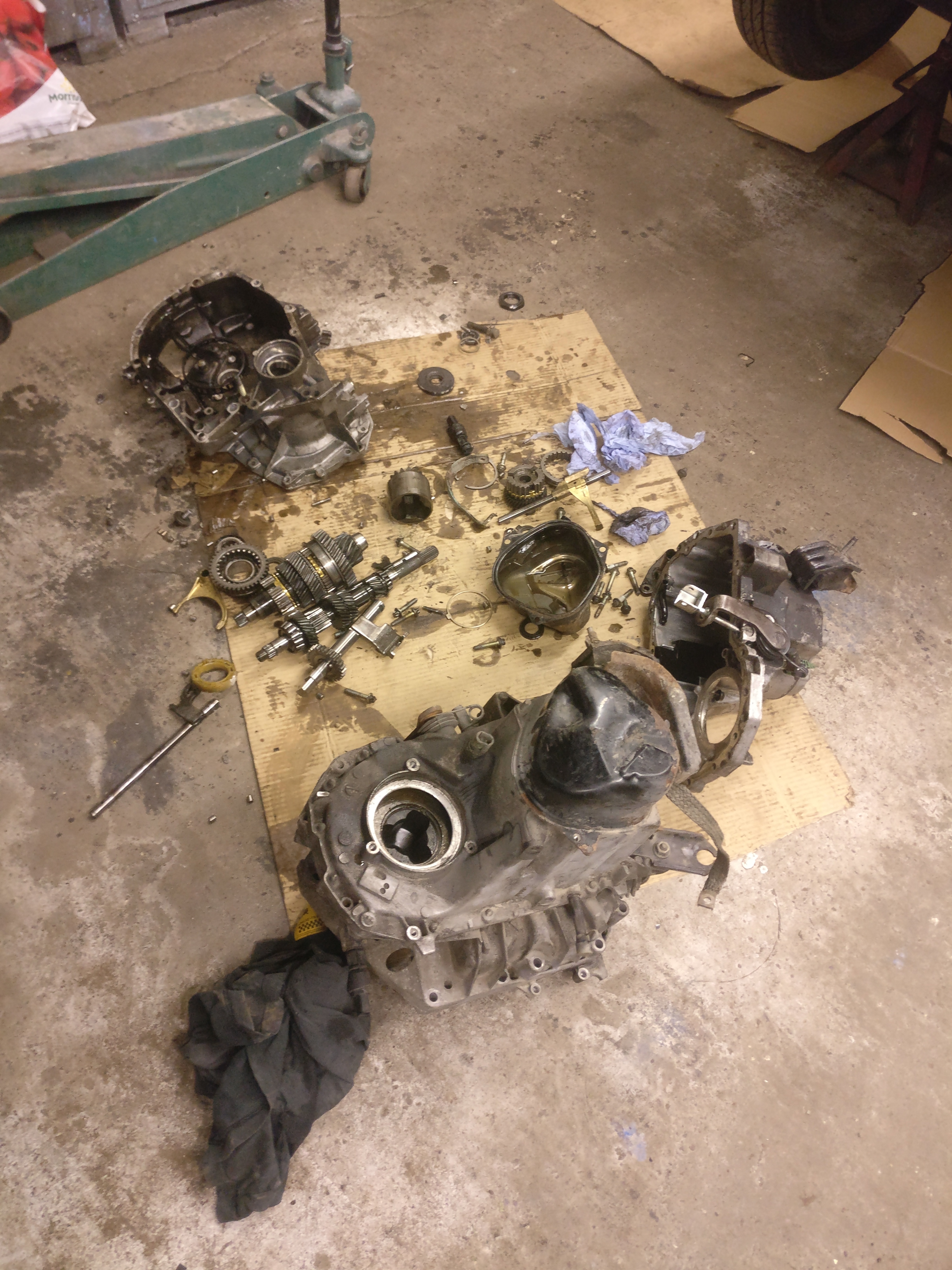

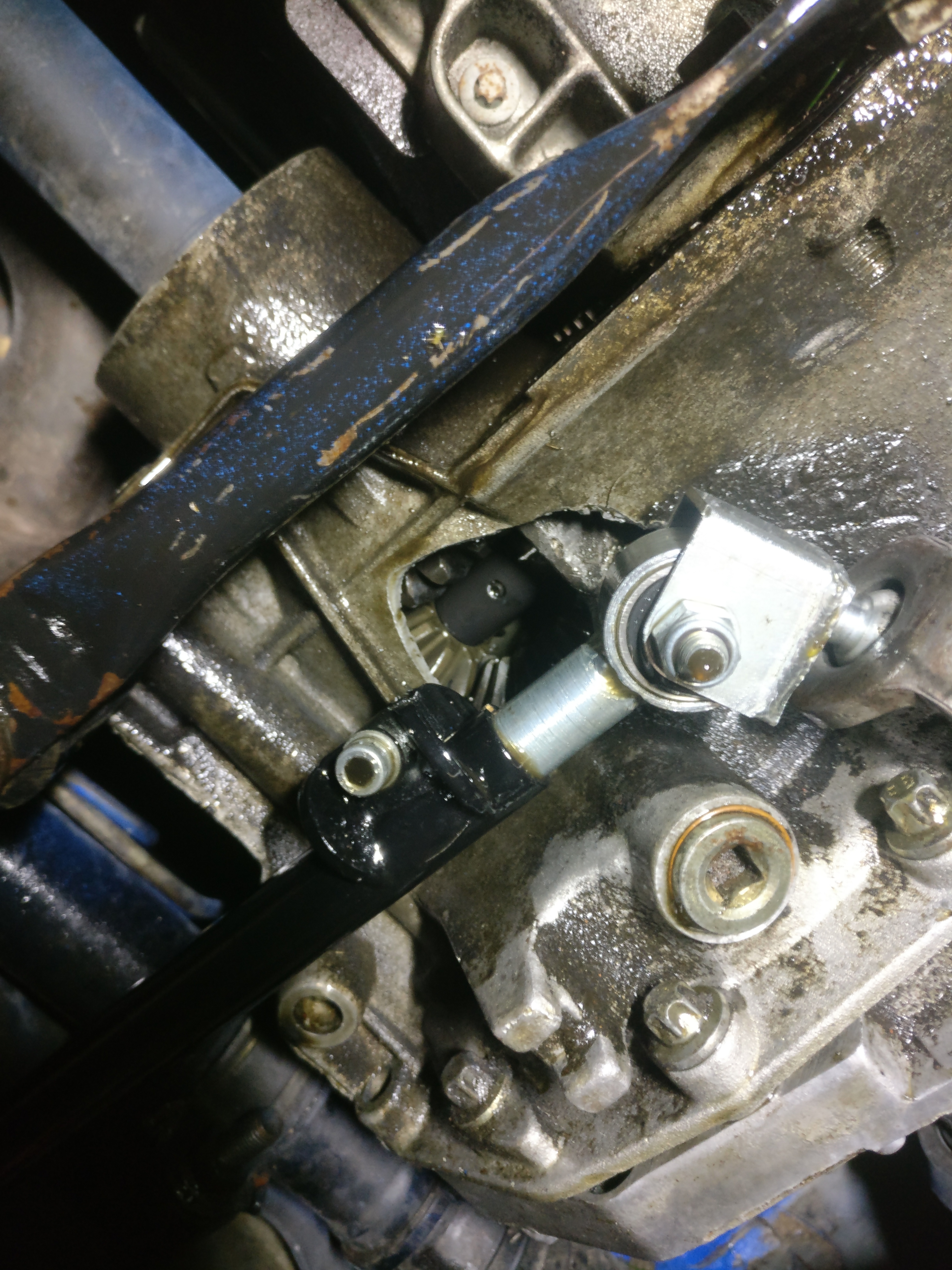

Probably not to many peoples surprise, the gearbox had ? itself.
We got it back home and stripped the box down and found that the planet gears in the diff had some teeth sheered off - no messing about, we ripped it to shreds?
After a lot of head ache research we weighed up literally every option of gearboxes. We decided that the best option practically for us is to do the 02M conversion. So we bought a whole kit with a quaife LSD in. It was dirt cheap and we couldn't turn the offer down. Granted we are now taking to living on the streets, but at least the clio will be happy???

I do love Clios but the gearboxes appear to be really poor for rallying. Like really poor ?
Is the 02M difficult to fit? Are there any good ratios for it?
It was a shame it broke tbh I feel like the ratios were pretty much bang on in 1st and 2nd maybe not 3rd. I just don't wanna have to fit a box every time we use the car so gonna try the 02M for pure reliability.
It doesn't sound too bad. Luckily the kit we've bought is off a Clio already so has all the hard work done really. New box, shafts, different mounts, custom flywheel, VW starter, VW clutch and adapter plate. Then you have to cut a bit of the subframe out I believe. Can't wait to get it tbh so I can start the work.
Regarding the ratios I'm not really sure. I've tried looking into it but theres loads of variants of the box and I'm unsure which one it is I'm recieving. I'm hoping in the back of my mind they'll be half decent but I'd expect them to probably be longer ratios than the Clio box :( Will just have to see and if its absolutely awful will sell it and long term buy a Sadev haha. Looking forward to driving with it though, I've never driven a car with an LSD in before so I'm hoping the benefits will outweigh the ratios for now - I know it's not ideal for rallying but I'm poor and not using a Clio box again lol.
