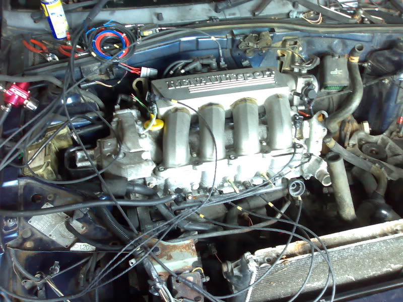

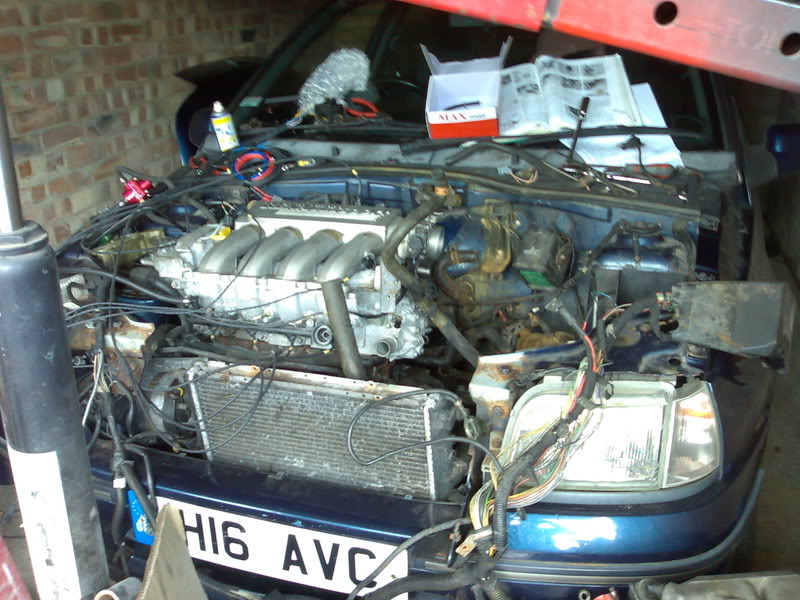

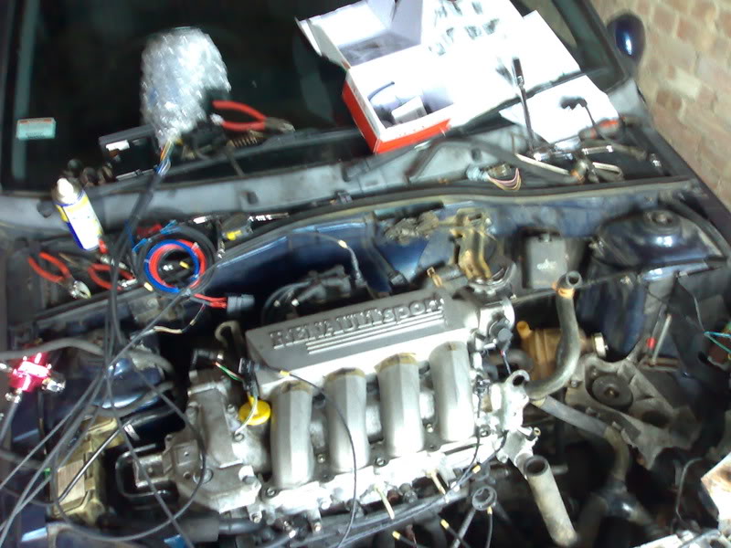

Right couple of engine pics and one of the manifold being trial fitted.
Needs a bit of adjustment but looks the nuts!

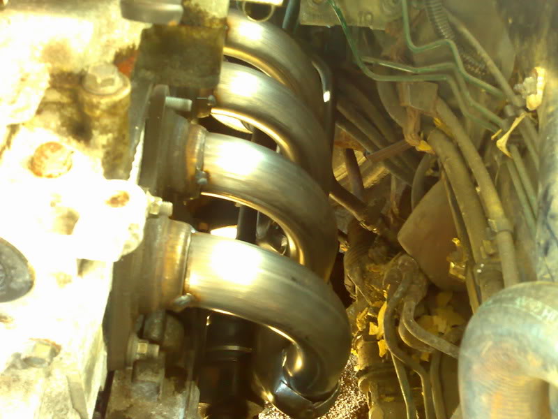

Powerflow in Bury St edmunds.
They're good mates of mine and good lads!
They made up the bend and Y pieces for me then my dad welded it.
Were in the third stage of getting the manifold ready! Little adjustments keep needing to be done!

UPDATE: Manifold now fits as it should not fouling anything!
One step closer!

sorry couldnt get pics up quick enough m8 hows it goin u had it turnin over yet ( manifold loks good ) yeah mine is a very tight fit

Started ripping out ecu and ecu loom last night, just finished to tonight now so I have just the main car loom in!
It was a right mess and only had to cut and join 3 wires!
PLumbing shall commence at weekedn finally and hoepfully enough time to wire it up and fire it up :D

Plumbed it all this morning with only one small leak which was on a join! SO well happy with that!
Omex all wired in bar a few that didn't need to be!
Set everything right and turn the key and it won't fire!
Just cranks over :( seems the injectores are ceased? Can this happen after sitting in an engine for 3 years that hasn't been used?!

i assume you are using the omex because the engine has fbw throttle? (sorry cant see it clearly in the pics) i am going the other way and using cable throttle and using standard 172 decoded ecu pinned up to car loom :)
