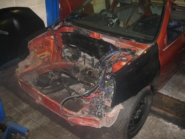

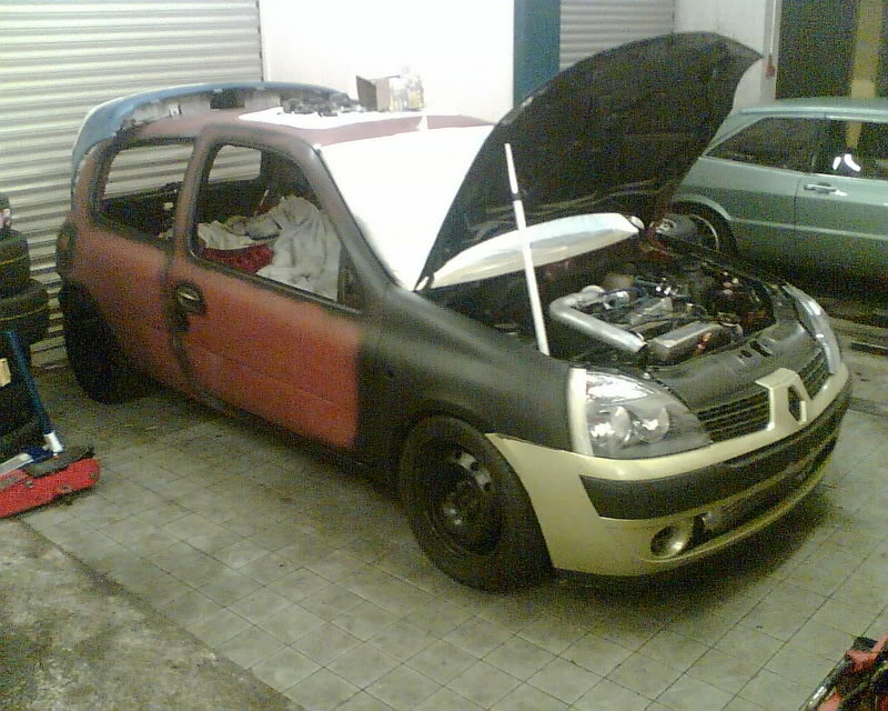

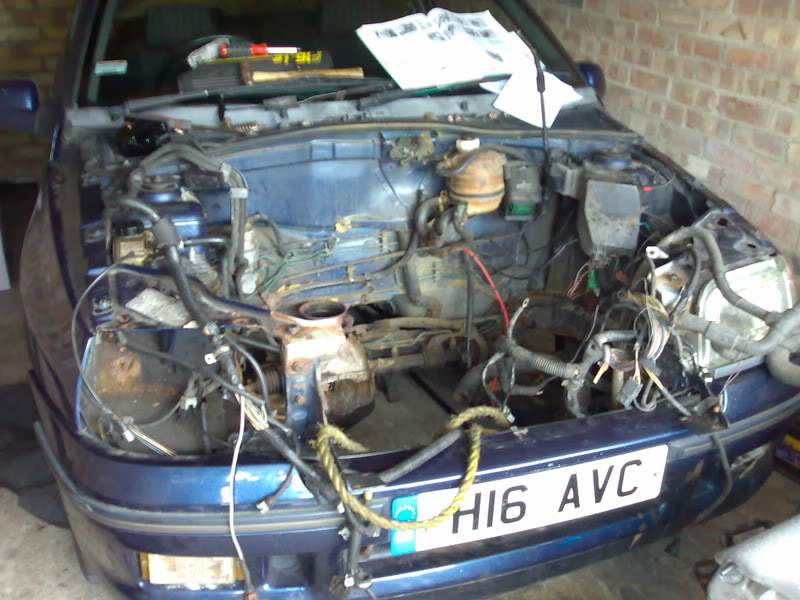

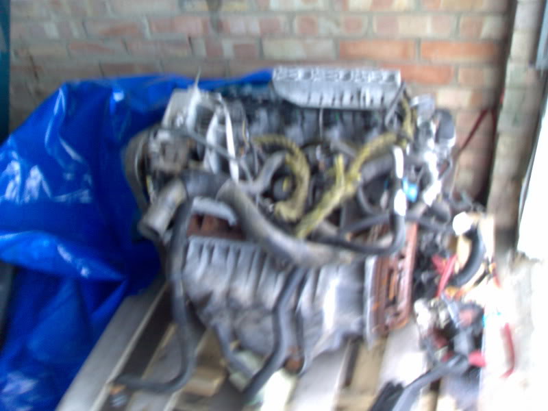

Anyway, Its a K Reg Valver shell with rust galore, Engine wasn't working had willy wheels and got it for £250! Not bad in my opinion!

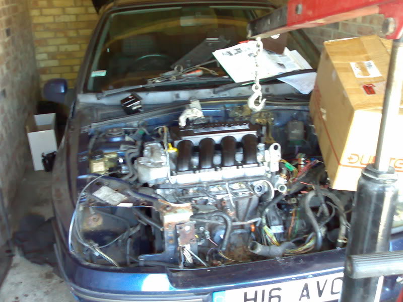

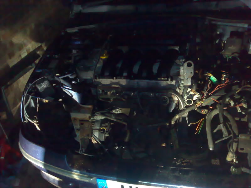

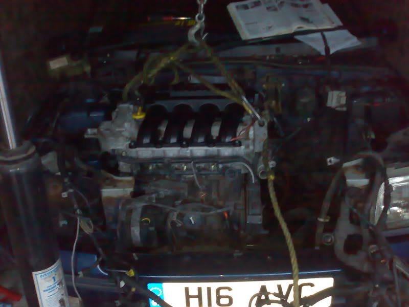

Currently the engine is fixed into position but hanging also, we also managed to fit PAS unlike the previous one on here :D
Now just got to do all the little things I can while engine is out (belts, clutch, engine bay shine!)
Running on Omex 600 unit, but just standard at the moment, then throttle bodies or turbo, still deciding! And maybe something else but thats secret at the moment ;)

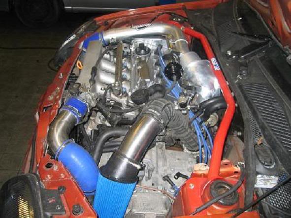

Yep its slightly differen engine same series as such though.
A member on here has done one and there another 2 been done.

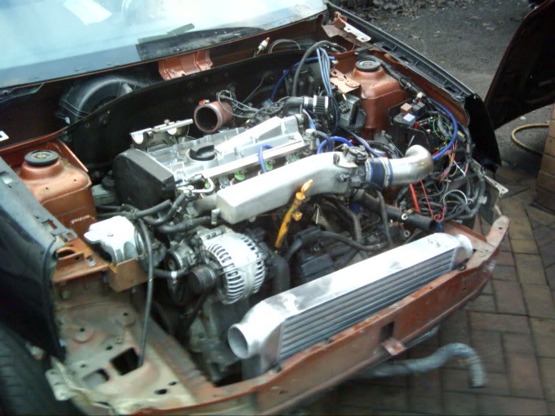

You need to realy cut the subframe a bit and weld some box section to get the strenght back if your using the 6 speed box the 5 speeds fine the VAGs a bit smaller in theory just the bigger box being the issue.
  St rollin on Borbet

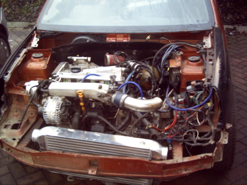

here's some picture of a 1.8 vag engine in a mk2 don't know if this with help

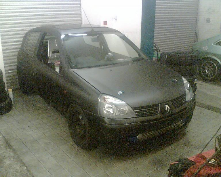

Matt black is the man to ask

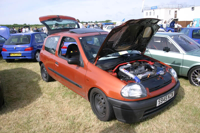

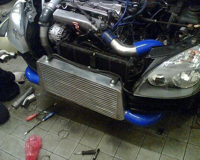

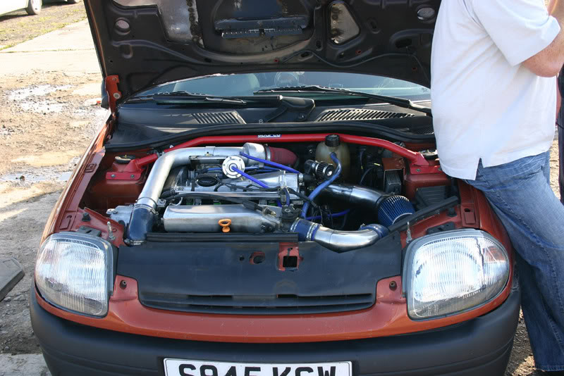

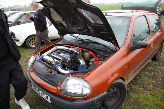

1.8 T engine is a doddle - you can run a specially designed DTA wiring loom to fit and run the injection / Turbo on the vehicle. Me and my mate ( Jordy ) have done both a 172 and a 1.8T conversion in my clio and the 1.8T engine was just as easy.
Heres a few of the several hundreds of pics i have

I'm finding mountings really easy as basically the same.
Using Omex unit and Cable throttle as omex cant use FBW, just had cable one come through!
Also managed to run it with PAS unlike wayne.
Also the omex unit as its just plug and play basically and can't be arsed to pin it up, also easier when I TB it!

Engine went in last night, we are using the 172 standard manifold but cutting it becuase its way to short, and turning it into a 4-2-1 manifold that fits!

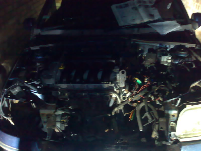

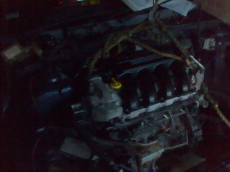

  Some of a Clio 1.8 16v
