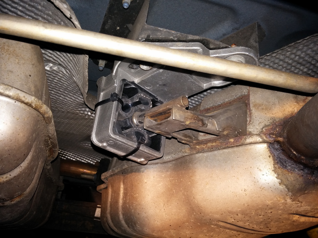

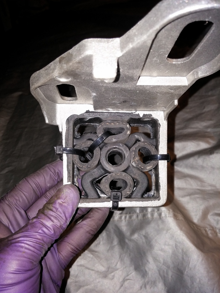

This is what i've done
Then you can cut a bit of pipe in half and fit that to either side dependant on how much you want it shifting 2mm or so at a time. They've lasted me 7 months like that now with no sign of the original hangers failing despite how cheap they were!
The above method still gives the exhaust a tiny bit of give too so it's not completely stiff which is what you want for the centre section, joints and hangers.

I've got them (prima) on my car as i got fed up with the standard ones breaking, even when i done something similar to the above by inserting multiple bits of piping and several cable ties but it still sagged after a while followed by the exhaust knocking.
the Prima ones do not have any room for movement but my janspeed/ktec supersport seems to fit fairly straight, im going to use some metal ties to straighten the right pipe slightly.
ive had them fitted for about a year and i havent had any issues (touches wood).

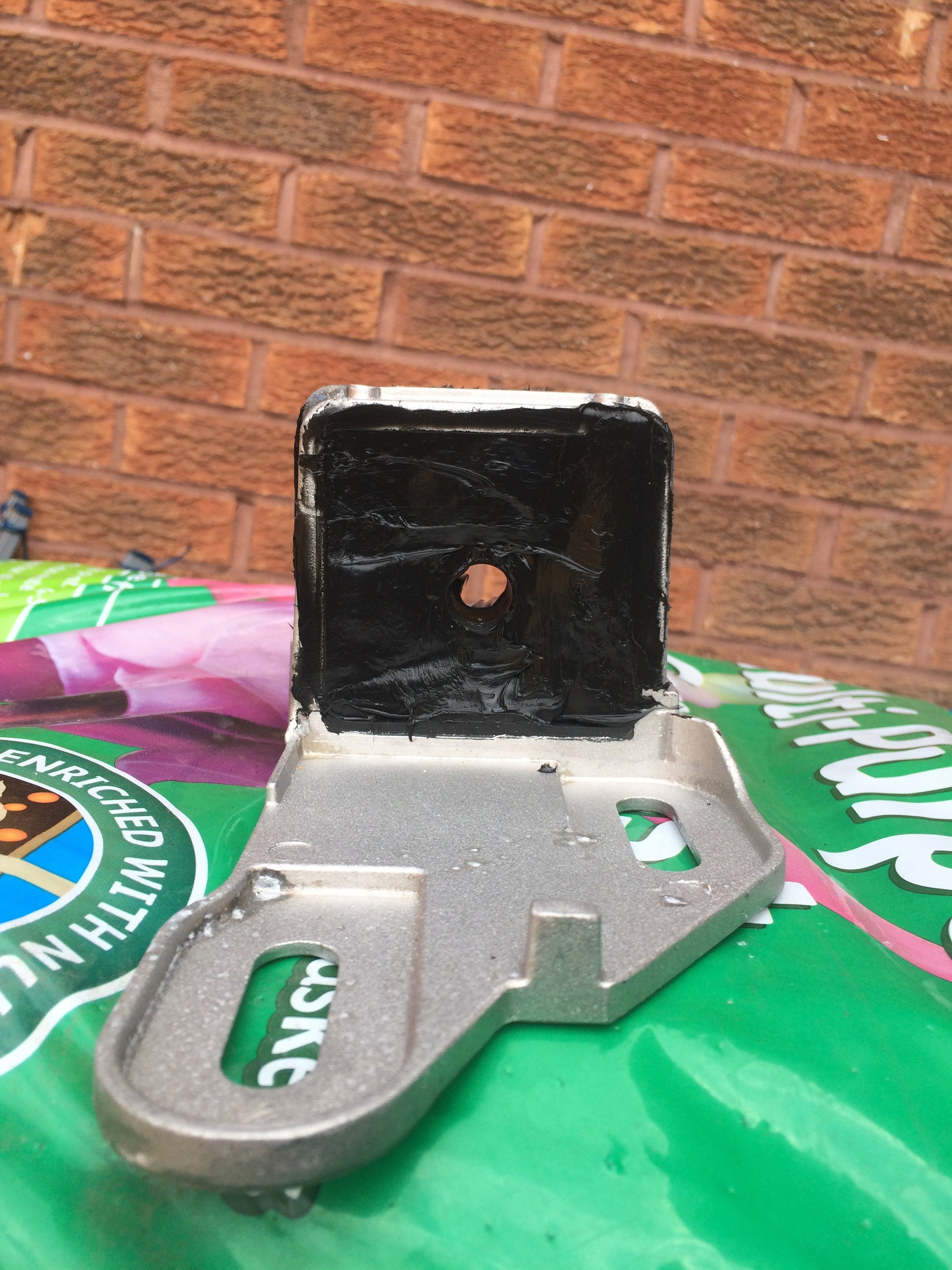

I'm gonna do the fill it with high temp sealent, I'll then wrap it in good old duct tape or something so it can't break down and fall out.. Shazam..
Read it in the other hanger thread, sounds a good idea as it strengthens the existing like the modifications above..

I pumped my standard mount full of tigerseal, and smoothed it off with an old credit card, leaving it for a week and will report how it goes.

After masticing the whole house, I found a bowl of water and wetting the credit card helped to smooth it, im quite happy really it looks almost factory. If it doesnt work I will go for a Prima mount. I had the sealant anyway so hasnt cost anything.

I too use the "Powerflex bodge" Granted, it's not the prettiest mount ever, and many cable ties are needed! However it does the job and I haven't had any issues. If I get any further issues though, I will be getting the Prima mounts for sure!
Jekyll
If your doing it pikey style then get some bits of tube/old sockets or even card rolled up and wedge them in the lower triangles. Then get some tiger seal and smear the whole lot up, both sides (obviously tidy it up and leave the exhaust slot) and let it set for a good 24hrs. Cost me all of £11 Inc the mount! Still spot on till this day over a year later.
The prima ones look proper quality though and will last a long time. Both the prima and the pikey versions will have hard rubber but there will still be flex so best of both. Poweflexis just too pikey and didn't work IME.

It looks sh1t but the sealent is both sides and covers all the existing rubber.. It feels pretty tough already but might just wrap it in duct tape to hide the hideous smoothing I did and keep it super solid..
