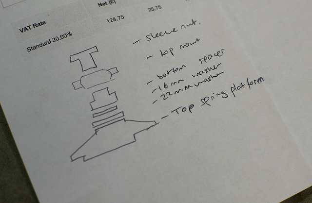

The diagram is correct, is the top nut been tightened down? i have a few threads visable above the nut on mine

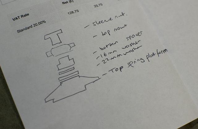

I would hazard a guess that you have to work the damper rod through the top spring cover & the 22mm washer on assembly, and it is the 16mm washer that actually seats at/on the shoulder at the base of the threads.
Jekyll

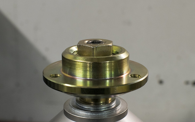

So what are we saying to do? The bottom spacer just slides over the rod and sits on the washers. There is nothing to clamp it down. The bearing/top mount slides over and it's the sleeve nut that clamps it all down. I don't get how it can compress more?
@STEVE.M @npt
What I`m thinking is that the top spring platform and the 22mm washer, which is there to spread the load, slide onto the smooth part of the damper rod, and that the 16mm ( I/D ) washer seats at the base of the threads.
The fact that you cannot preassemble the leg, or see what is going on is a pain.
If the platform has got trapped off centre, rather than slid below the shoulder could be the problem.

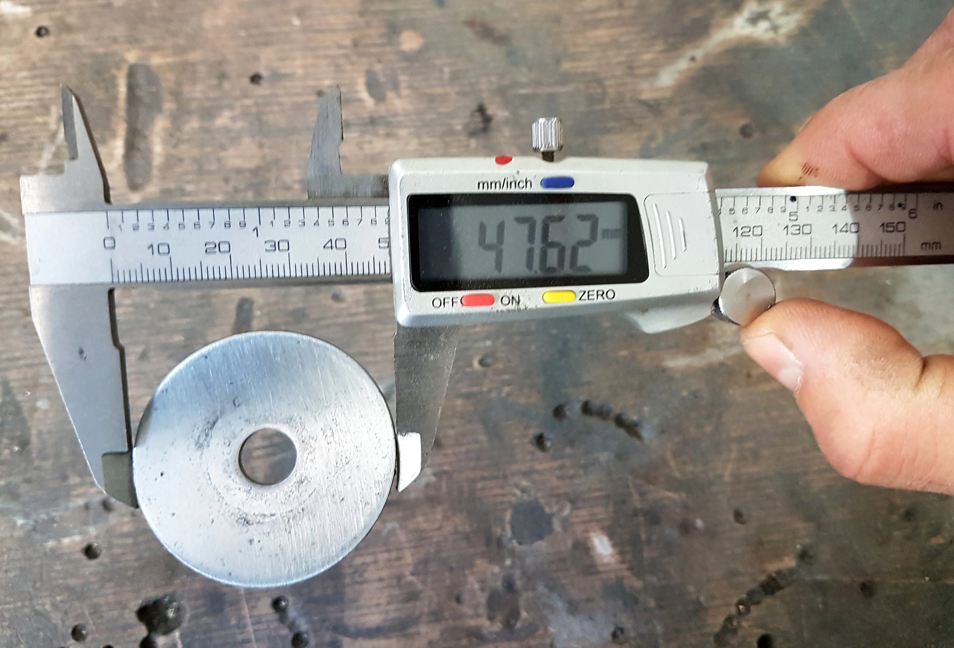

Your washer looks to have a big OD, and perhaps the 16mm ID? I have some washers at work that are large OD, small ID so I may drill them out to 16mm.
@robbie1988 now has my coilovers - I wonder if he could measure the spacer for you ;)

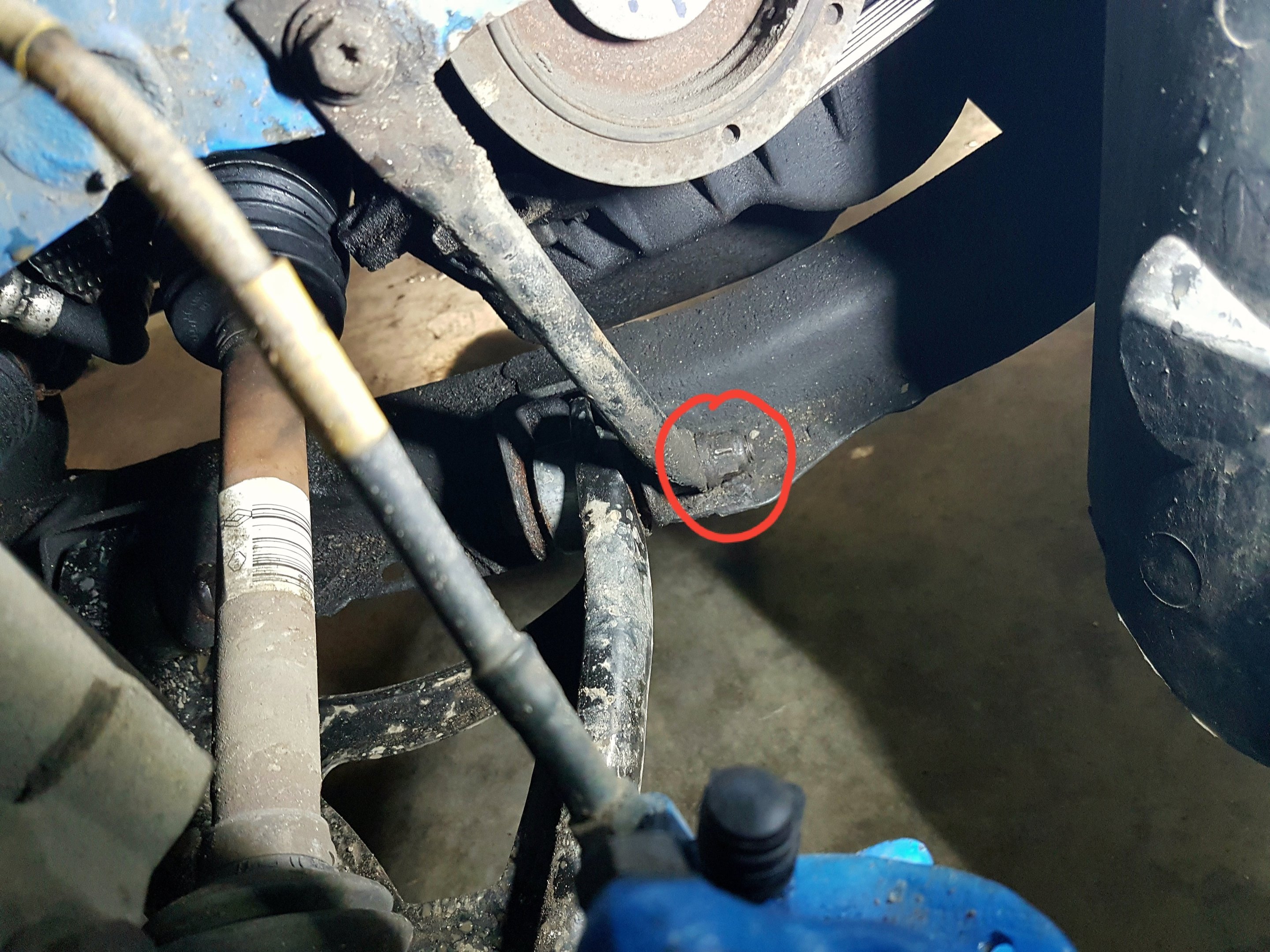

So I took it all apart last night and changed the washers with the above drilled out to 16mm. Gave the car a quick drive and the noise was still there. I decided to check all bolts and nuts, suspension related as I've recently changed my ARB bushes and lower arms too. The noise turned out to be the nut that holds the stabilizer arm on the lower arms was loose! Gave this a tighten up and drove around the farm and the noise had gone. I guess the arm was knocking and creating the sound through the chassis that sounded like top mounts.
With that, this morning i took all the shocks off and changed the top mounts to the original washers and refitted it all. Drove around the farm again and no noise. So I'm happy it's cured and that it wasn't top mounts related.

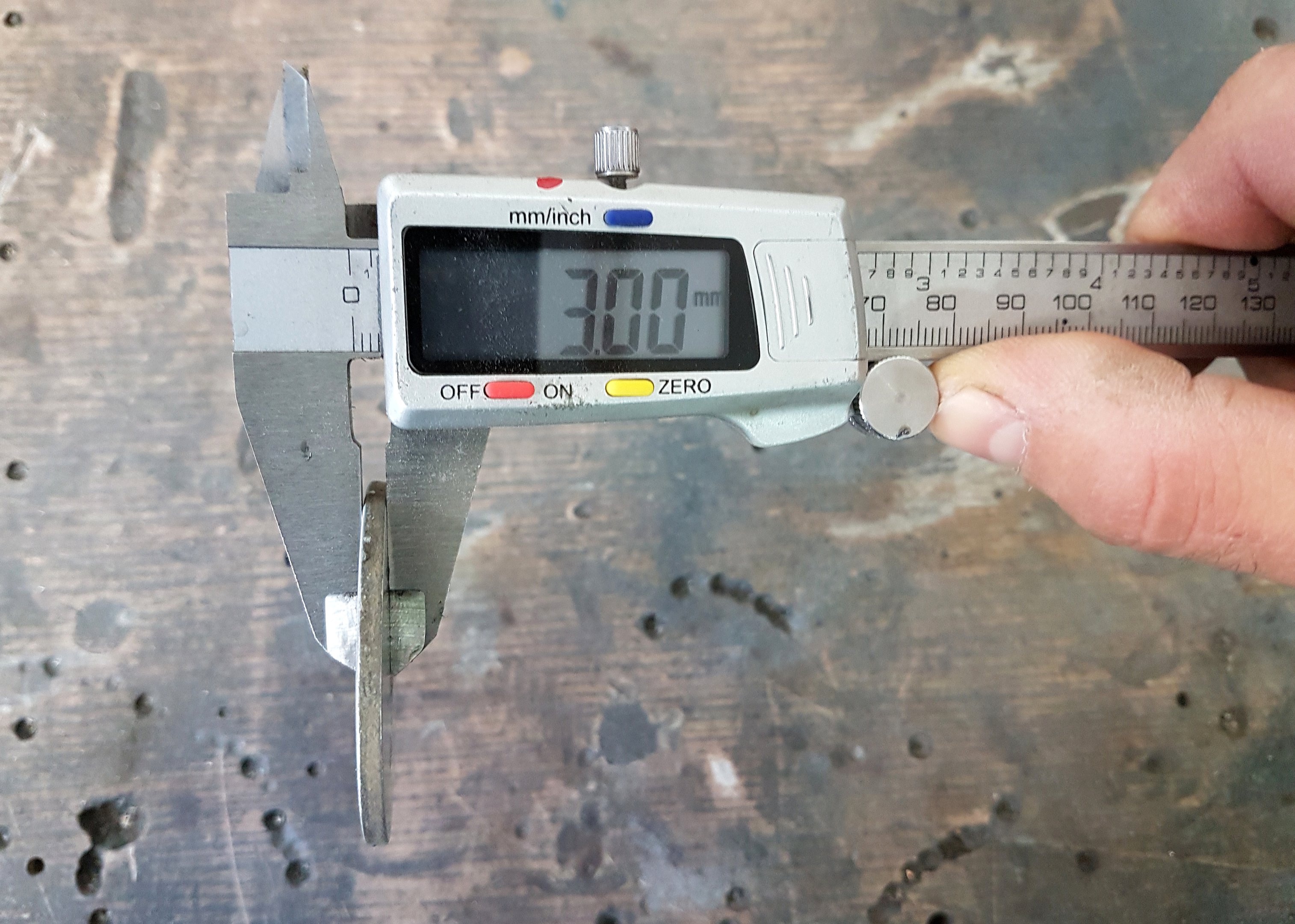

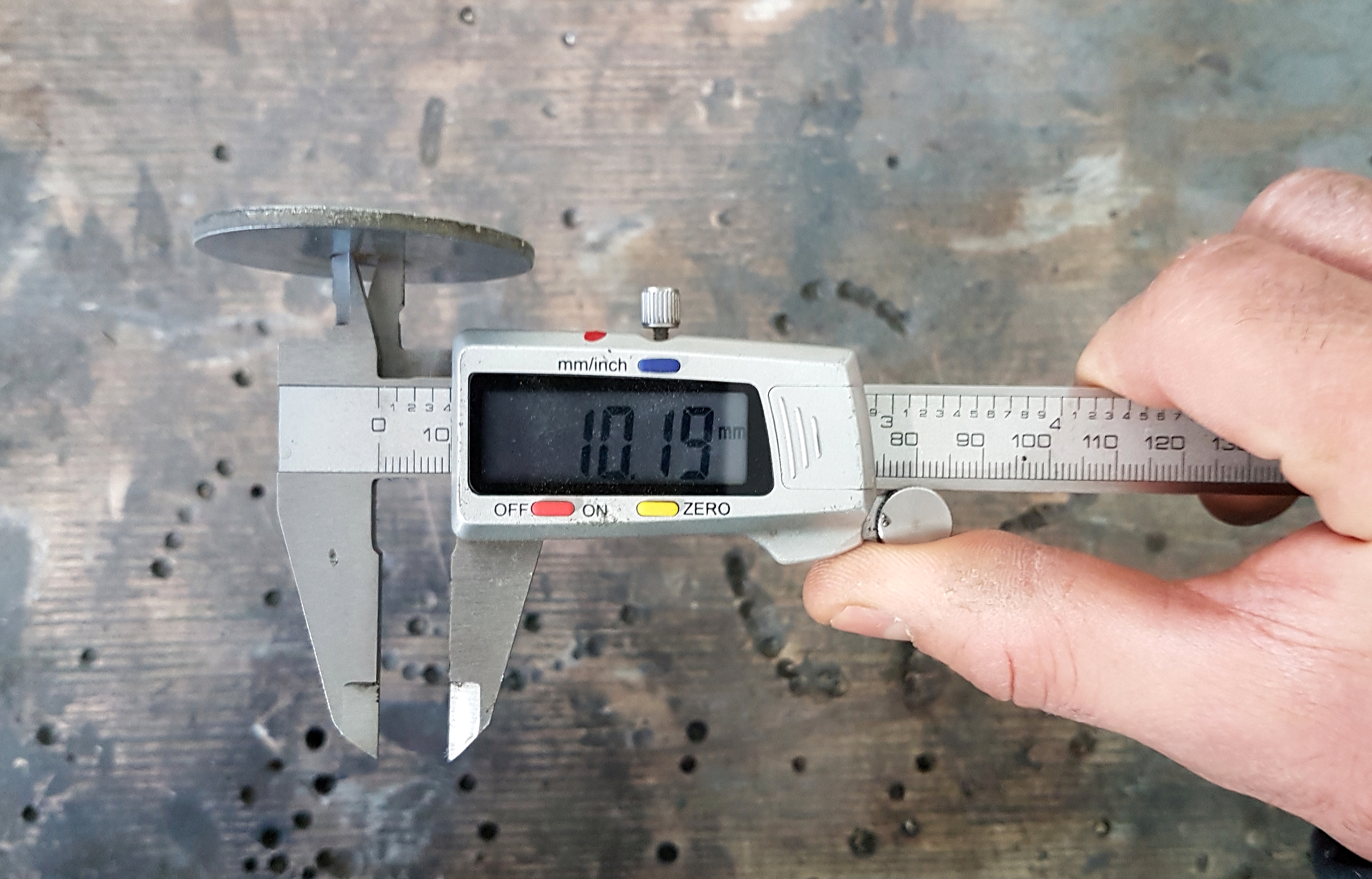

Just for future info, the reason for the washers underneath our top mounts on B14s is because, for some strange reason, the locating spigot for the top spring cap protrudes through the top spring cap by a fraction of a mm. If you put our lower spacer straight onto the locating spigot the top spring cap isn't clamped up tight and rattles. The 22mm washer bridges the gap, the 16mm brings it down to something reasonable and then our lower spacer on top of that.
