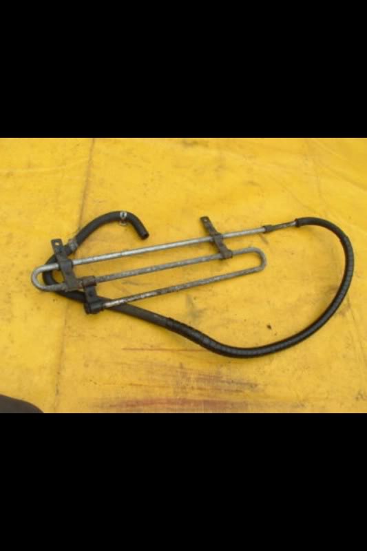

How can I help cool the system ? Iv just brought some pipe from a focus which has a much longer metal section, so should help with cooling.

The pipe I have brought not sure if it will even fit will be a bit of an experiment really
