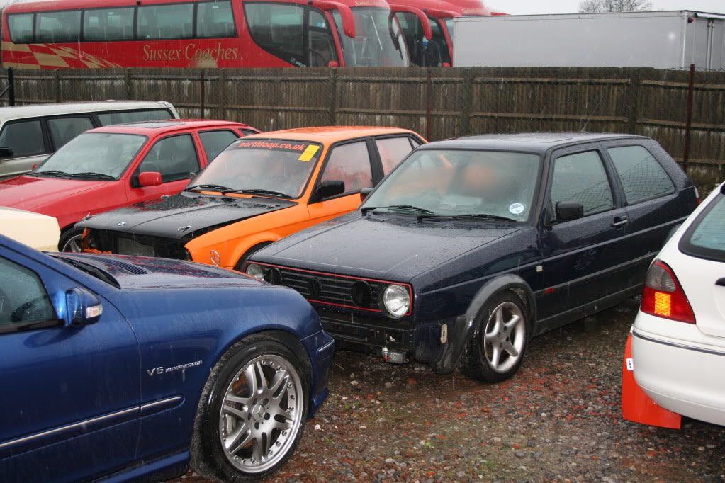

New Mk 2 track shed

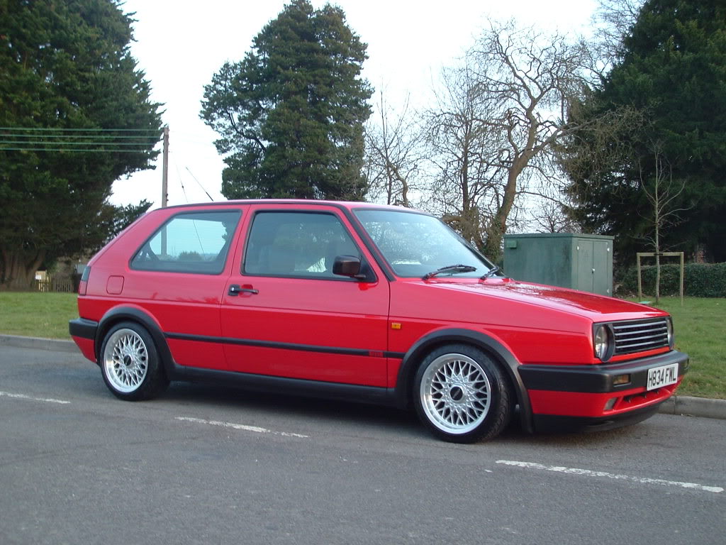

body looks nice and tidy,bbs wheels would make it - are those TSW Stealths? Mate used to have them on a 205 xs
  E90
No idea mate, have these lined up for track, will probs spray those ones black aswell, or some lairy colour LOL

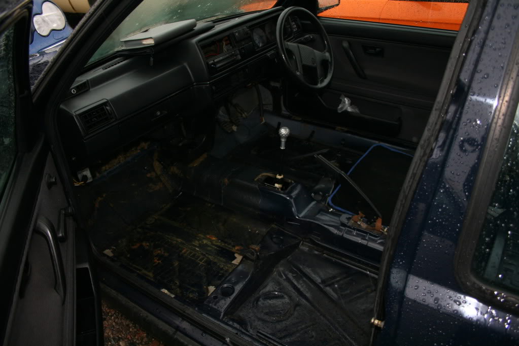

Yeah, no heat at all. On a dry normal temp day though the temp guage reached the first bar and goes no futher. The other night at about -56 degrees, the engine overheated in 3 miles. Thinking its got no anti freeze in it and the thermostat is fcuked.
Think your on the money with the overheating in low temperature.
If you get the anti freeze and thermostat sorted and your temp gauge reading normal and still no cabin heat then try the heater valves, its should have had them on the recall.
You can get new ones or just remove them but then you run the risk of the matrix going unless you change it for a Mk3 one

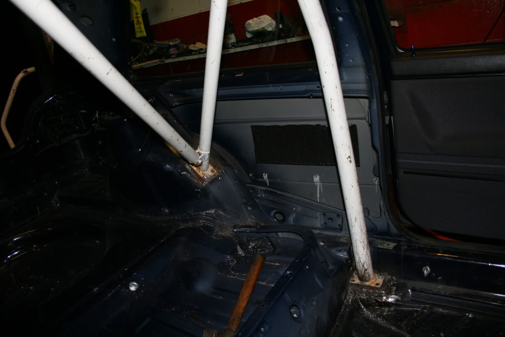

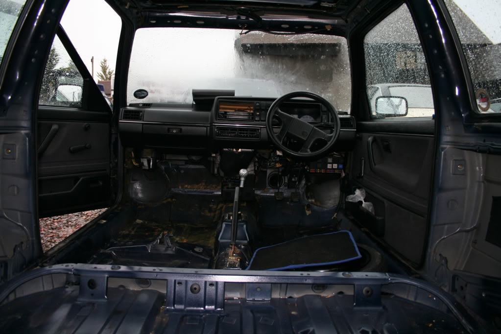

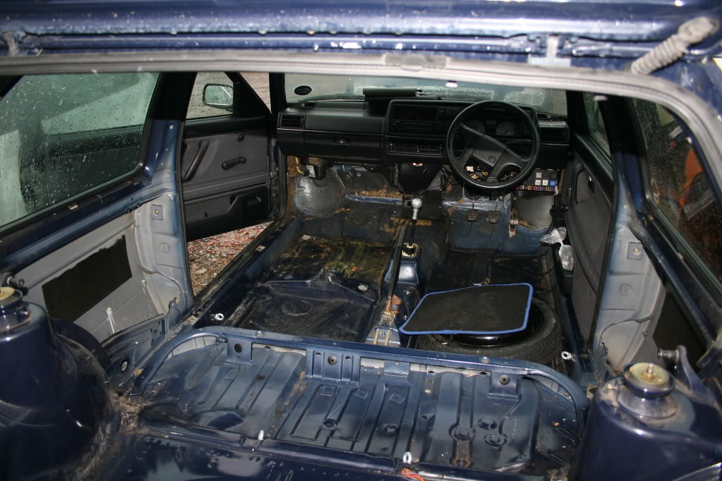

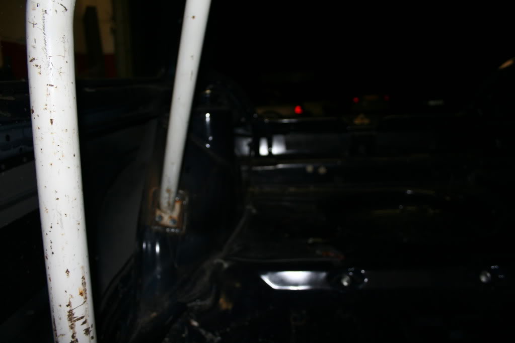

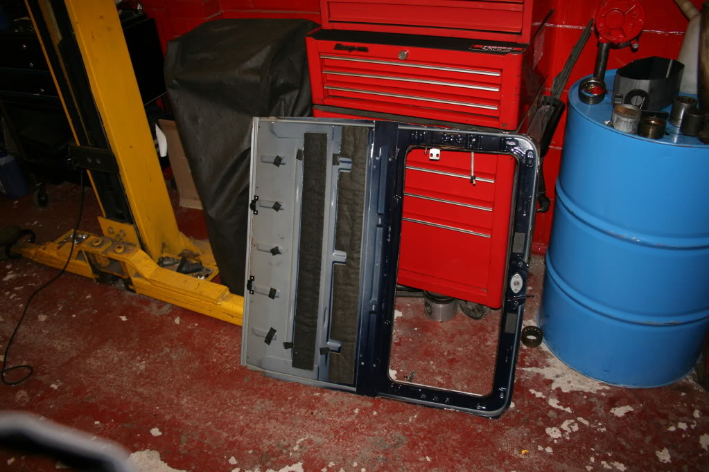

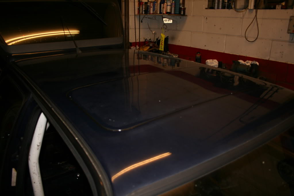

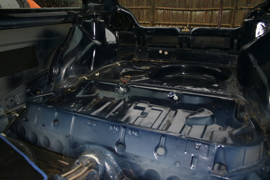

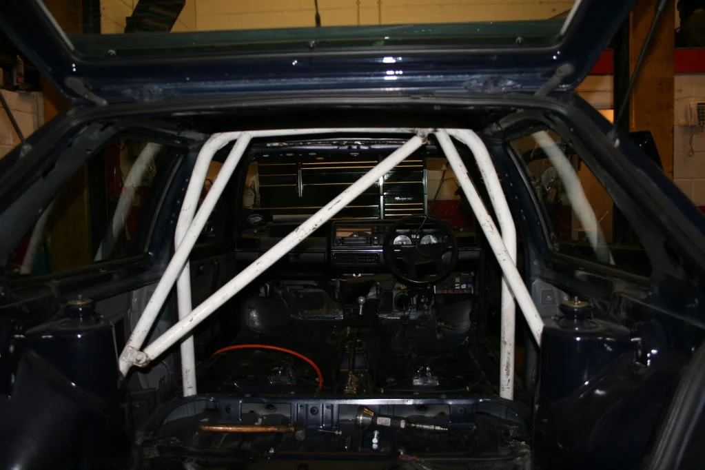

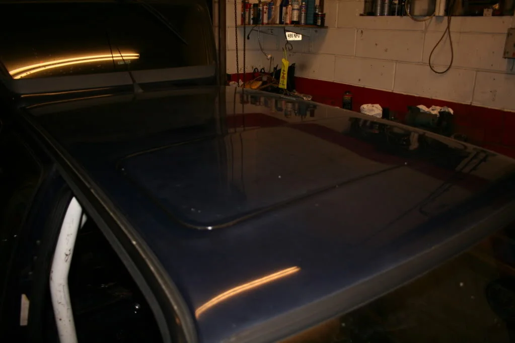

Update, sunroof out and welded up and sealed, Cage plates in for rear hoop, front being done as we speak, then cage is off to painters.
Rear hoop in position, bolts just dropped into holes
Sunroof carrier that was cut out from inside the car
