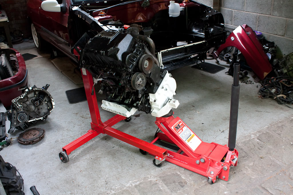

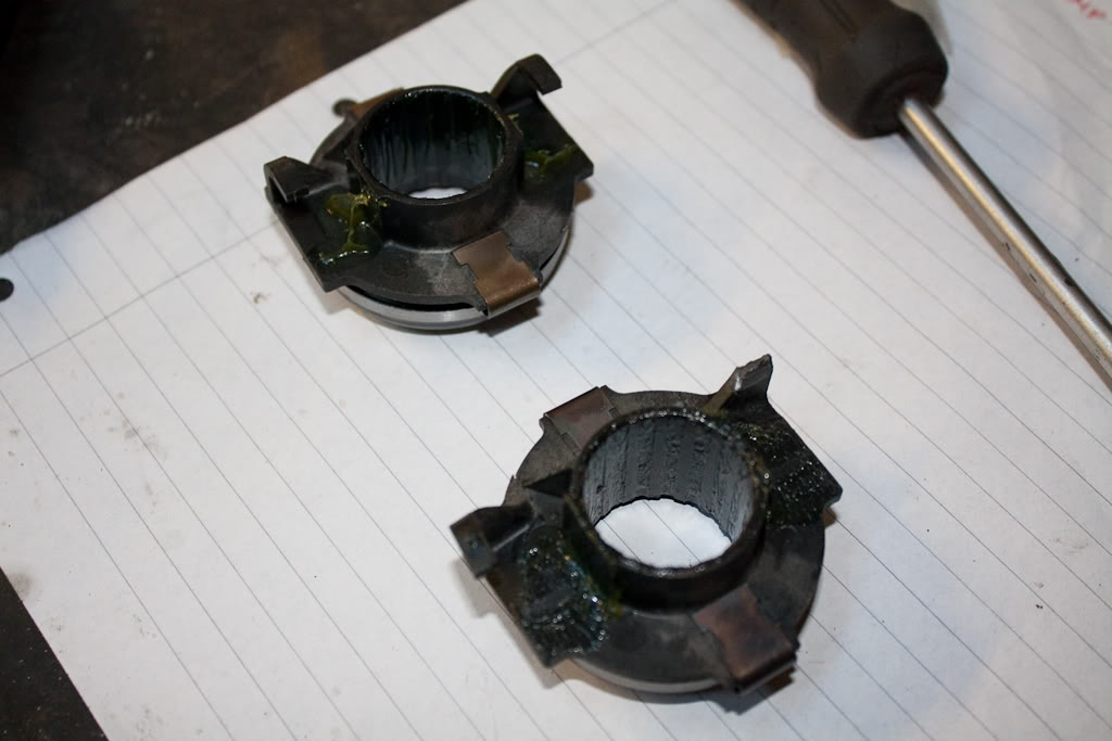

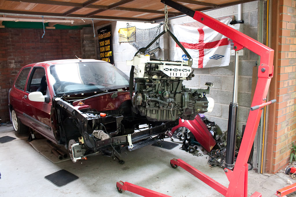

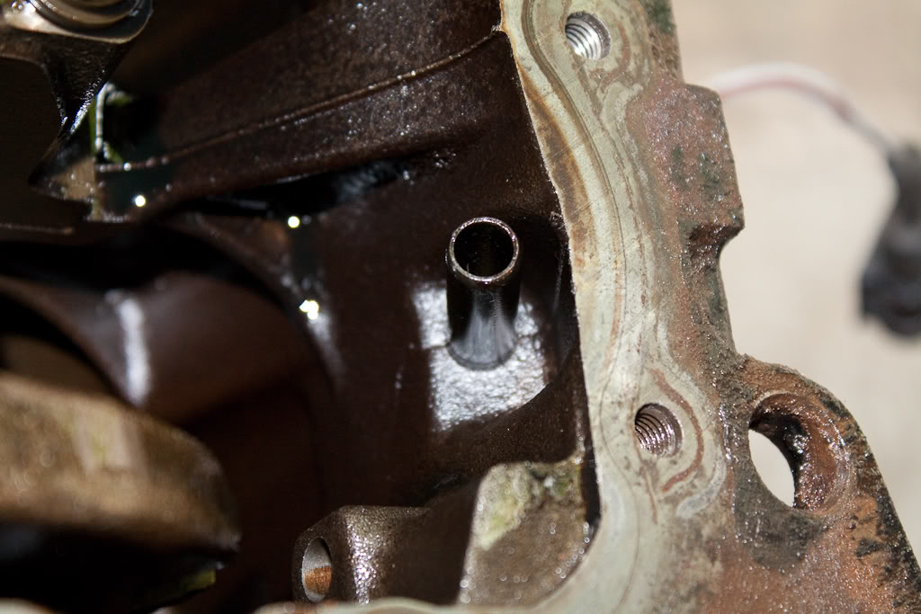

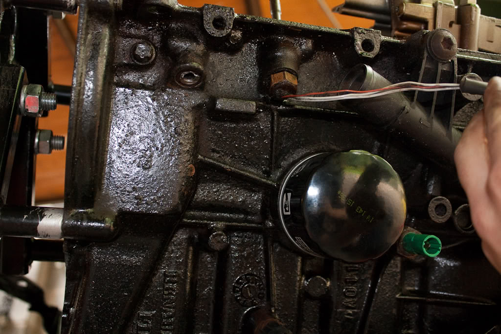

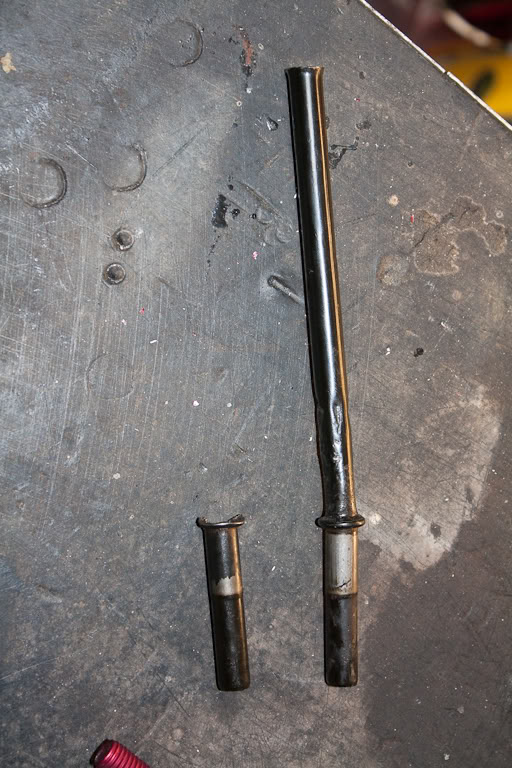

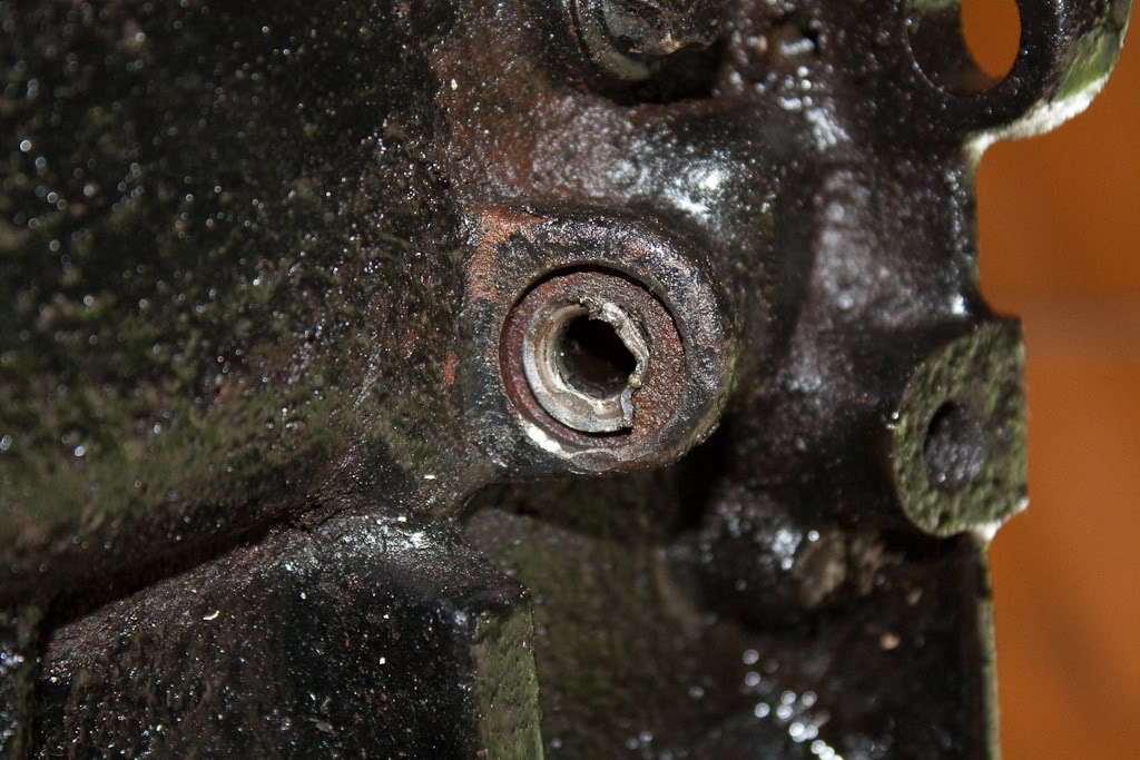

Having a look at the dipstick we thoughet it was something like an outer casing where the new dipstick would push into, i was wrong and it was the actual dipstick and had been snapped off, so this ment the engine had to come out, gearbox off to then discovered i had fitted the releas bearing wrong. (need to buy a new one) Opened up the sump and it took the whole of 5 seconds to knock the dipstick out and then fit the new one. Everything is now ready to go back in.

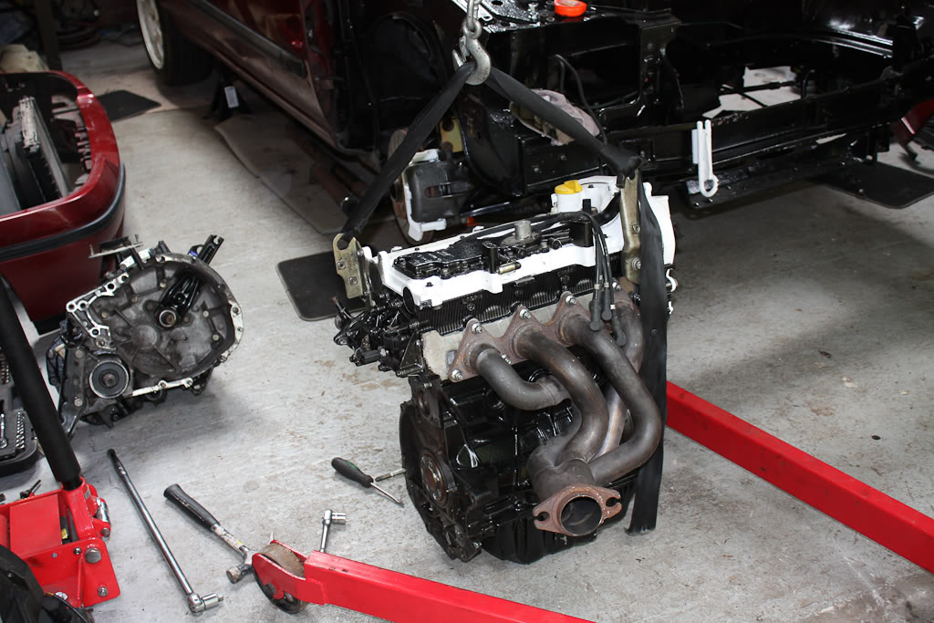

Engine out
Gearbox split, clutch and flywheel off

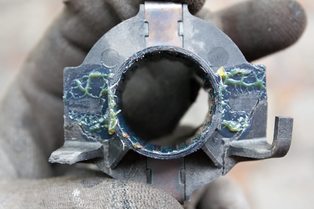

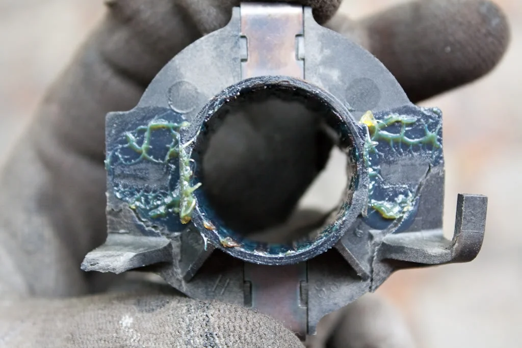

To then find this that id fitted wrong
Engine was then put on to the stand and then the jack under for more support

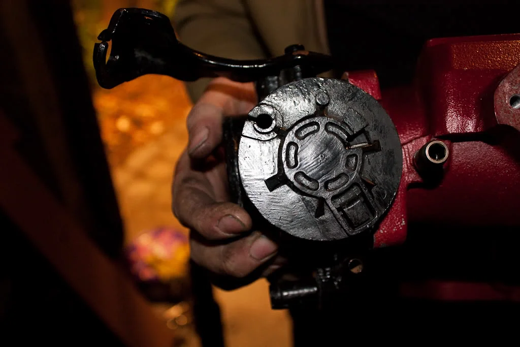

Dipstick were it had split
Inside the bottom end view, placed a bolt ontop and then hit it out
new one beside the snapped one
The new dipstick was fitted and then everything else refitted, cant put the gearbox on till i get a new release bearing and then i can put it back into the car

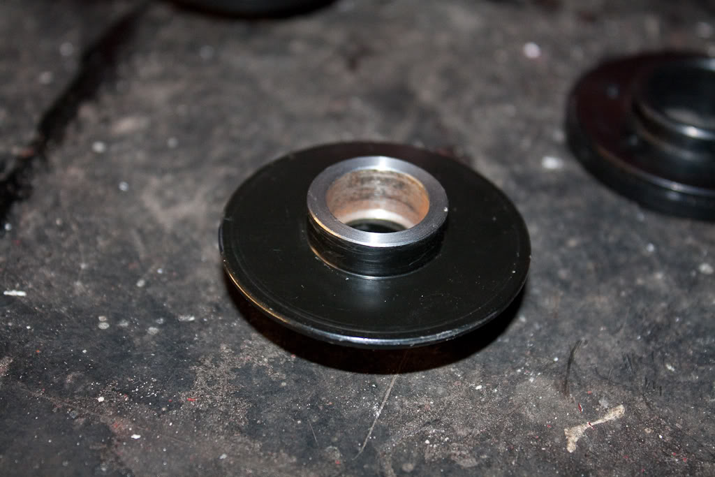

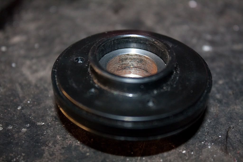

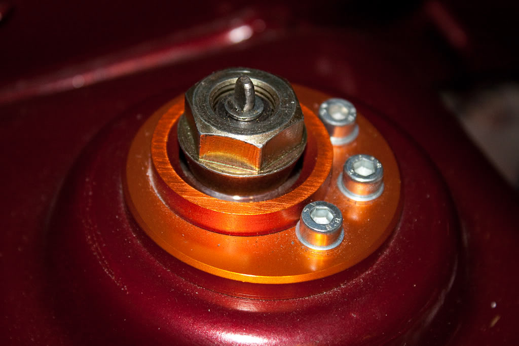

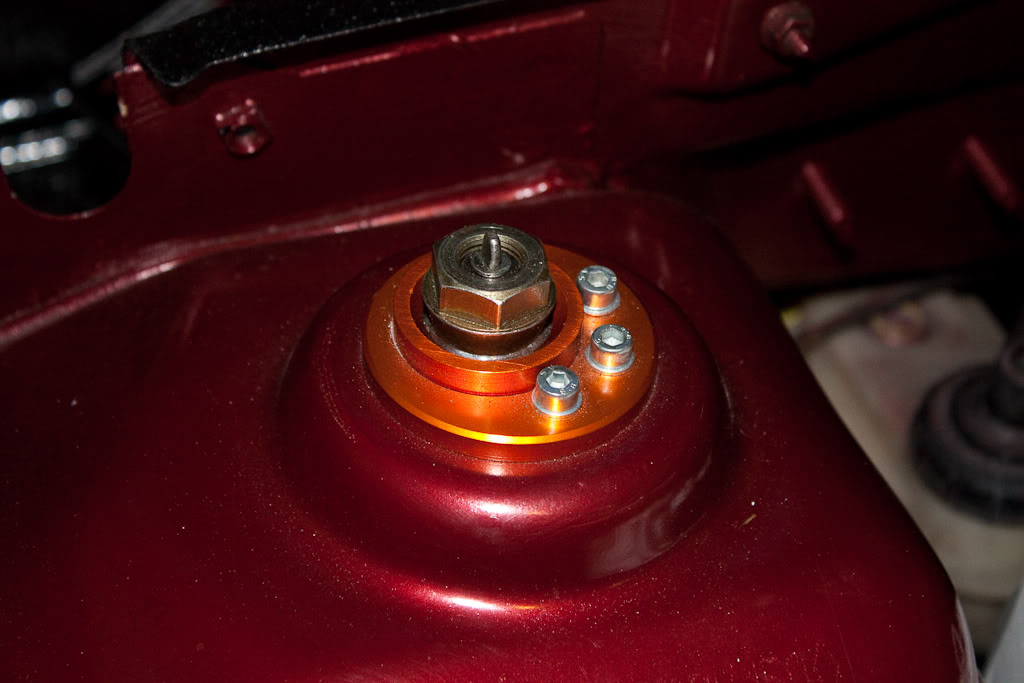

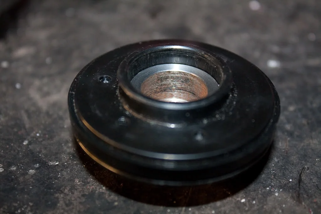

Since i cant do much with the engine ive had the little black bit from the topmoutnt milled down 6 mm so the suspension will fit
(fits on the underside of the topmount to align the shock)
This bit not to sure wot its called
This now allows the thread on the suspension to come up the topmount more and i can now get the nut on, some of the people on the ast group buy have had this problem, i think im the first to try this and it does work

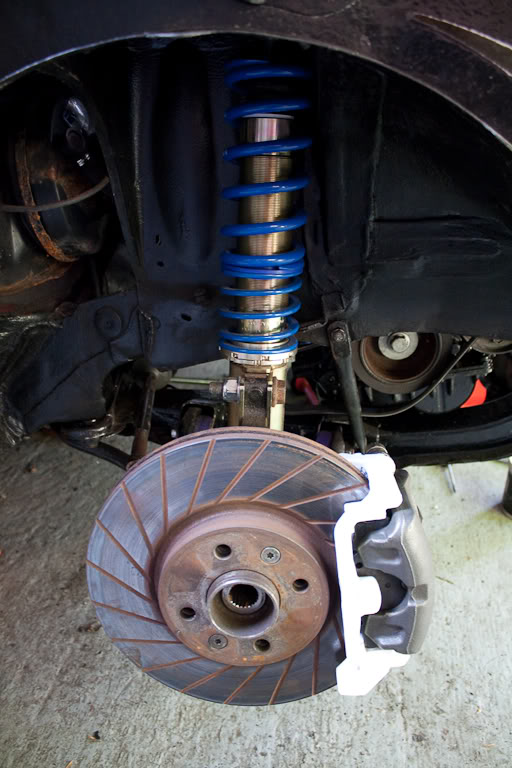

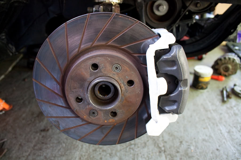

The front brakes have also been fitted

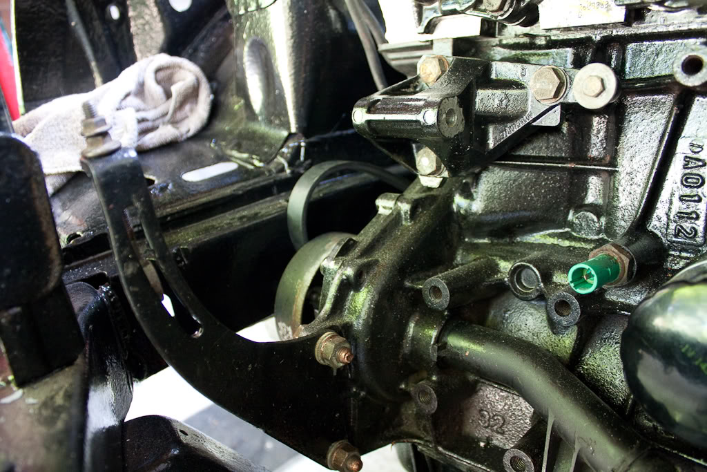

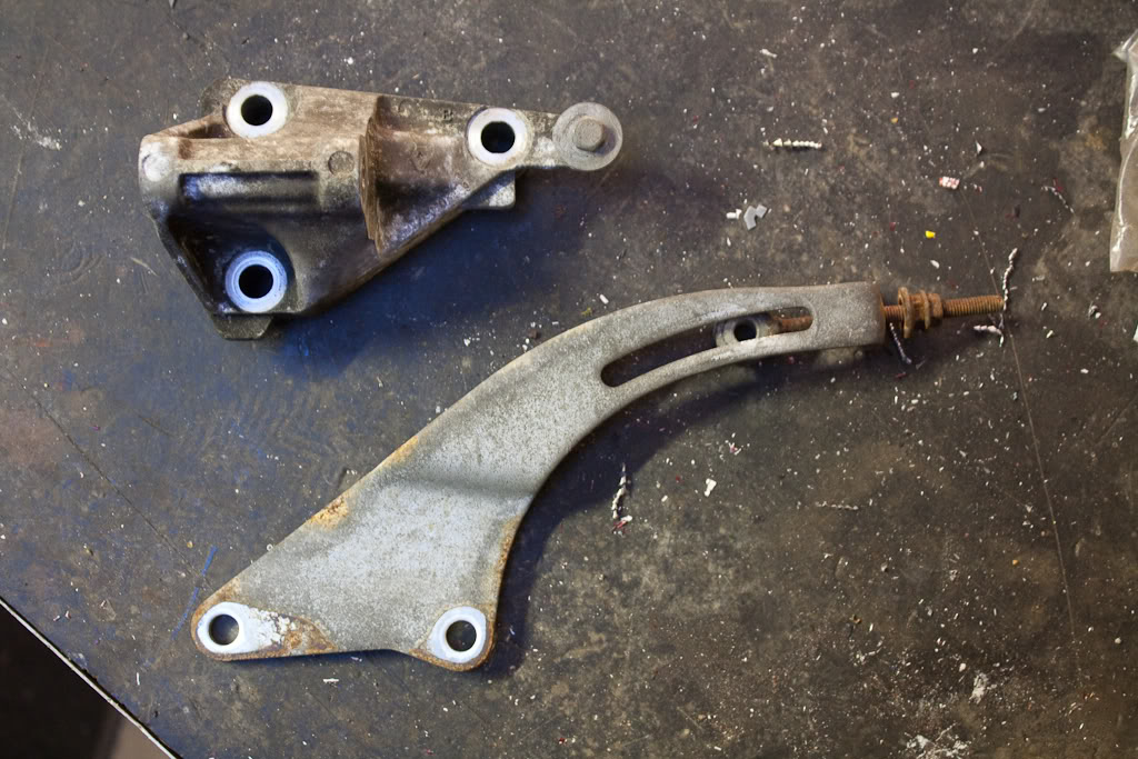

Found myself the non pas brackets off the volvo 480
Test fitted and painted

Cars looking great! Will have to give the topmount thing a try
Seems to work fine, also when i put the nuts on i put loctite on the thread too just to be extra safe

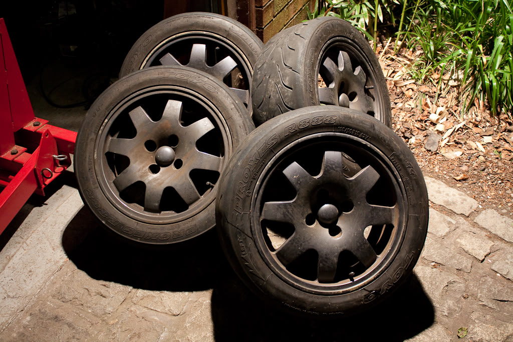

My oz f1's have now been sold and gone to a good home, the reason for selling them is the offset of them 45 and i wanted something less like another set of williams wheels 37 or something with a similar offset. Lo and behold! a set came up on the bay and i picked them up lastnight, not a bad price too.
Williams wheels + R888 still a little bit of life in them but not road legal, id say i could get a track day out of them

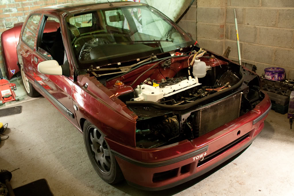

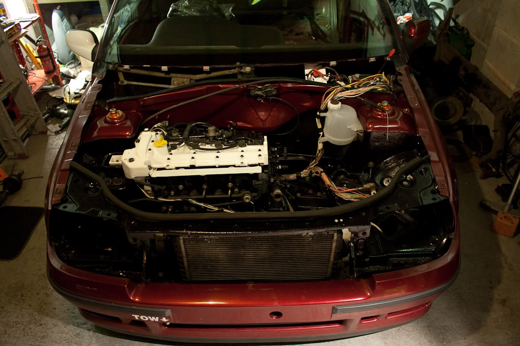

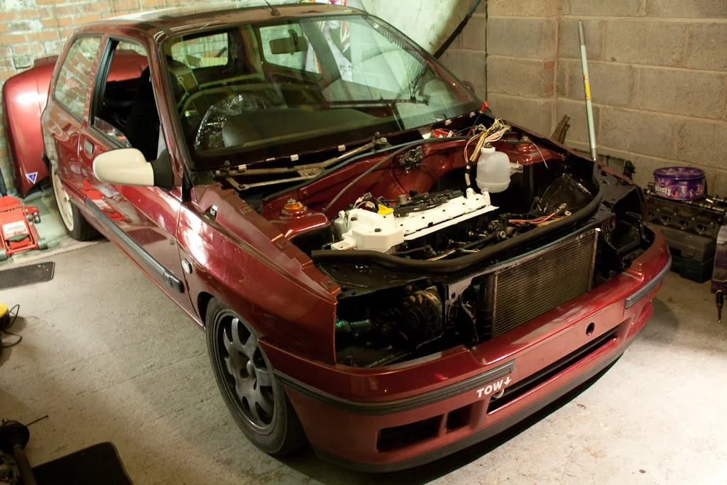

Engines back in but plenty to do now!
Cheers guys, the first day as f0xy said its going to be the day after fcs at rockingham, looking forward to it but its going to be a rush

So... the new clutch release bearing that id been waiting for turned up at renault yesterday, Big thanks to jord for going to get my parts as i was at work and wouldnt of got the engine back in if he hadnt of picked them up
new release bearing and the snapped one
gearbox then went back on and then lifted into the car, alternator and 4th mount also fitted. Tonight im going to go and sort the wiring out :dead: not my best point lol

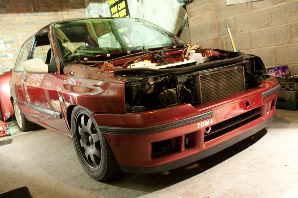

How the car looks now

Black wheels look good. Are they staying black or all going white?
Not really decided but im liking the look of the anthercite wheels, so think they will stay like that

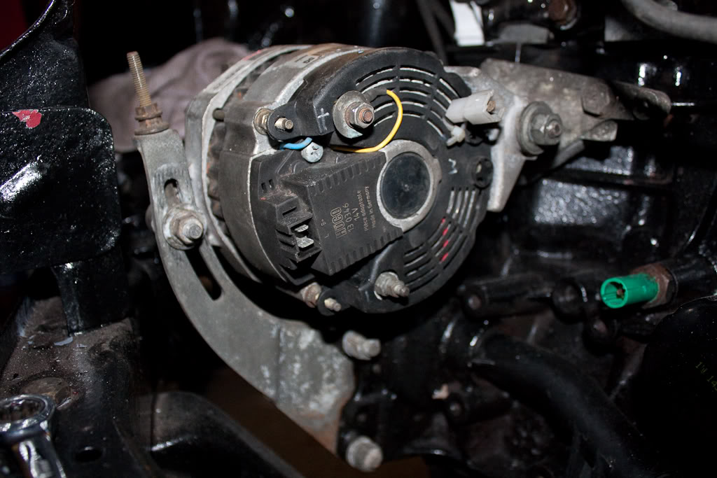

Ive not read about using the volvo 480 brackets before though, I would love to get rid of my Aircon, would these brackets work with the original alternator rather than the cup setup? Im unsure of which your using.
Hes using the valver alternator, im using one from an espace diesel with the same brackets (Come on a 480 or a low poverty spec Mk1). The normal 172 alternator does not fit (well my 172 Ph1 didnt line up), but im guessing the cup one might.
