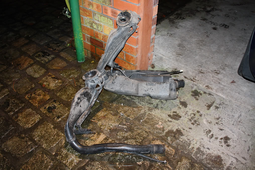

Finally got round to buying the 1.2 fuel filler to get rid of the valver auxiliary tank, you can see the size difference in the pic
From this
To this ..
Now fitted on the car, had to get a few clips and block one of the breather holes up and all was fine, fitted first time

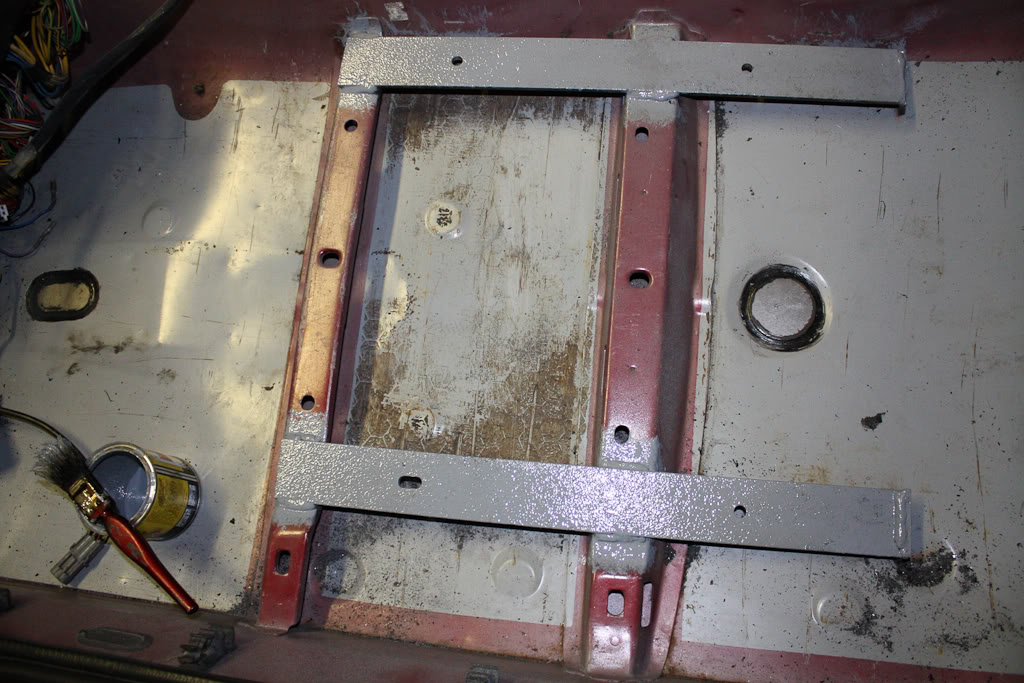

The plates that i had made have now been stuck down, the reason for me doing this was the old ones had bits missing and just kept falling out of place
once the plates had dried got abit giddy with the anti rust/primer paint doing the seams and seat bars

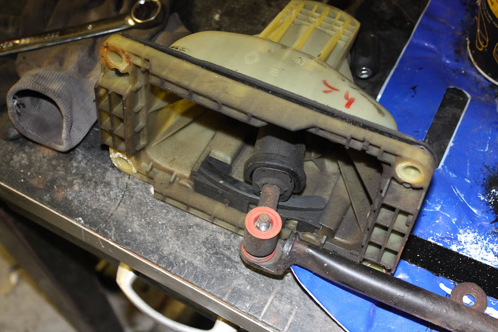

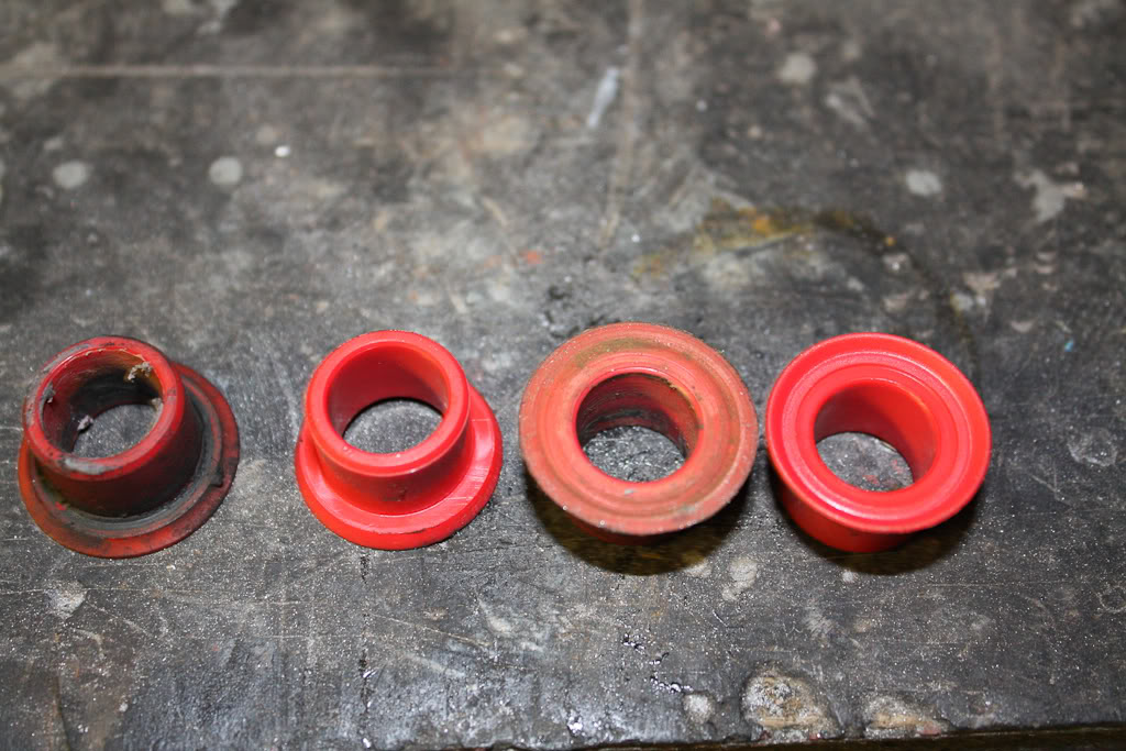

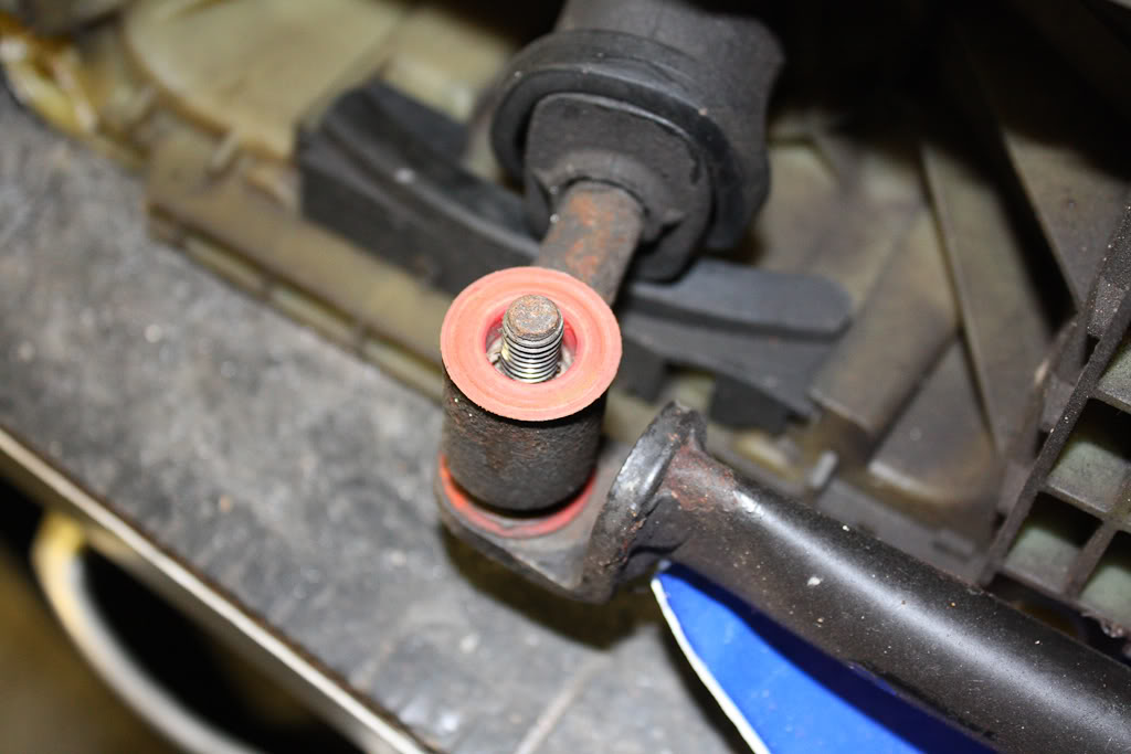

Ive had some gear lever bushes bought some time ago but never got round to fitting them so whilst the car is up on axel stands i thought id change them 5 min job
As you can see they are faded and squashed, the new ones were put in with loads of copper grease, will see if this makes any difference.
The whole thing then fitted back onto the car

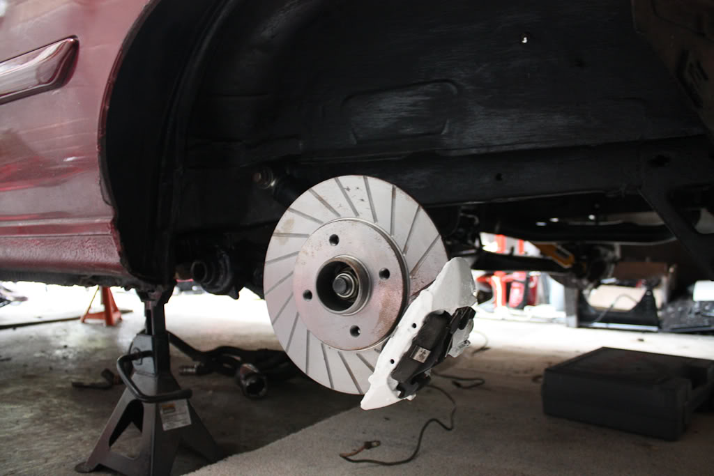

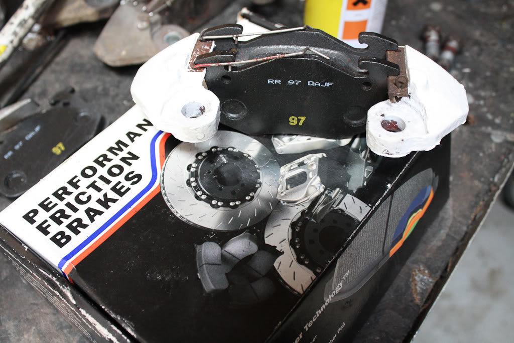

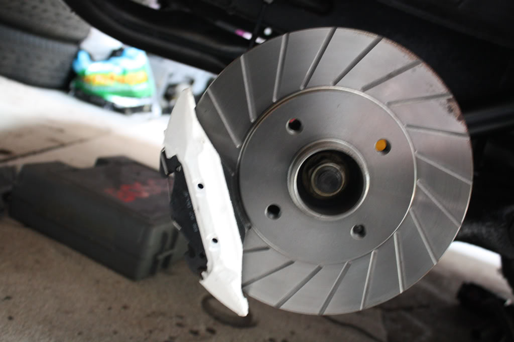

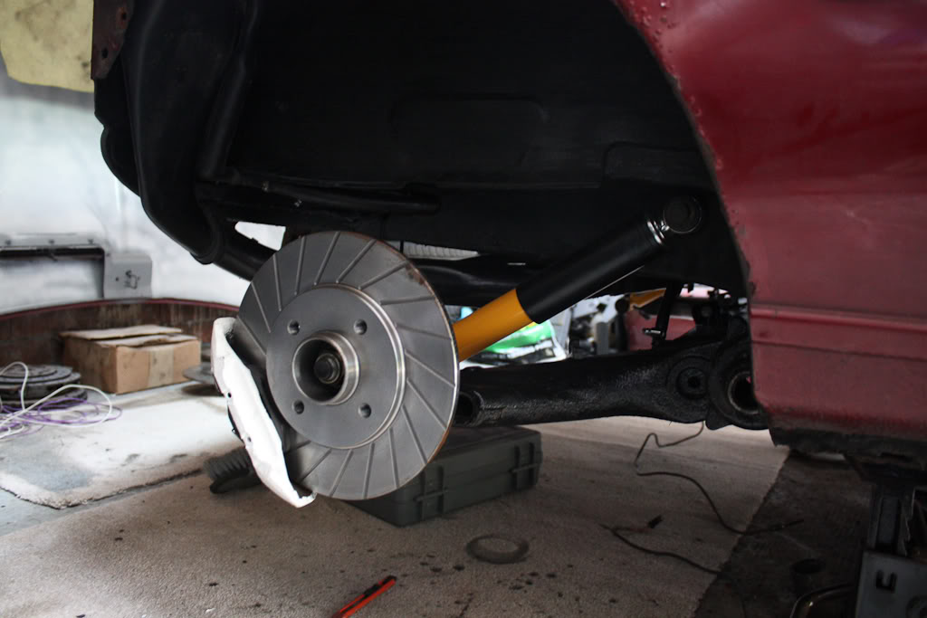

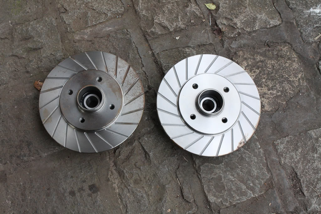

Picked up some new rear discs the other day, not to sure wot make they are as i got them off some one on her that bought them and the abs ring didnt fit so got them on the cheep, as in not running abs this want a problem for me, verry happy for the price :D

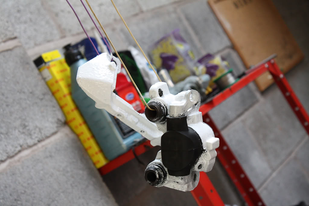

Painted the calipers and carriers in white (wounder wot colour they will be soon)hope this was the right colour to pick, but its different not seen anyone else do them white so ill stick with it for a while
Both pads were then fitted into the carriers, the rear pads i will be running are PF97's (same as the front ones)
Verry good pads im told
The lot then got fitted to the car new discs, new pads and calipers looks cool imo
Offside
Nearside

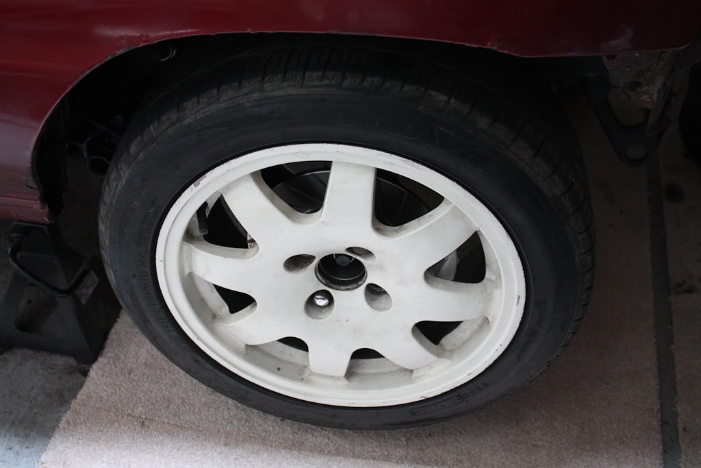

Then got a little board and fitted some wheels to see wot they would look like under the wheels
Williams wheels
172 oz f1s still need painting white

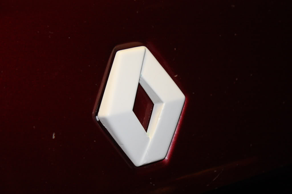

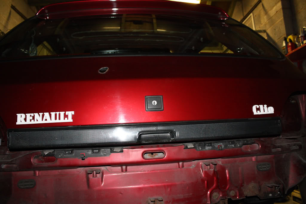

Bought two new rear badges from whiteley, renault and clio both are now sprayed in white and fitted
also sprayed a new front badge as the other one had finger marks and dirt on it not good

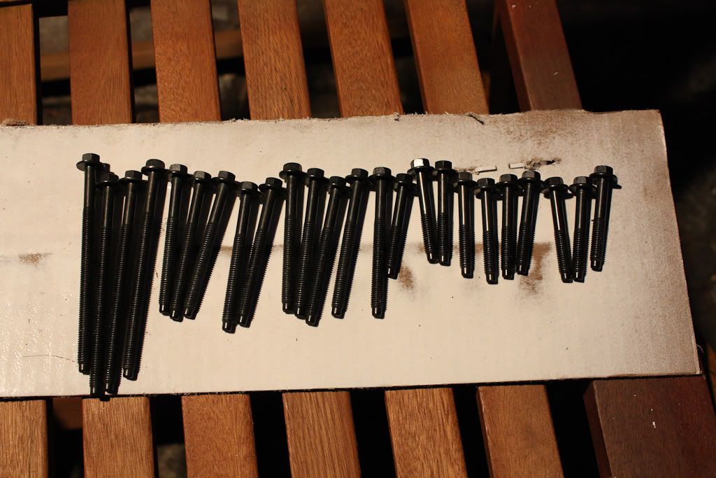

The bolts from renault finally arrived on monday for the rocker cover, nearly fainted when they told me the price for 24 bolts.. £44 :mad: and 2 of them are the wrong size and my luck they are the ones from france so got to sort that out quick.
I gave the job of unwraping them to riggers lol
24 expensive bolts

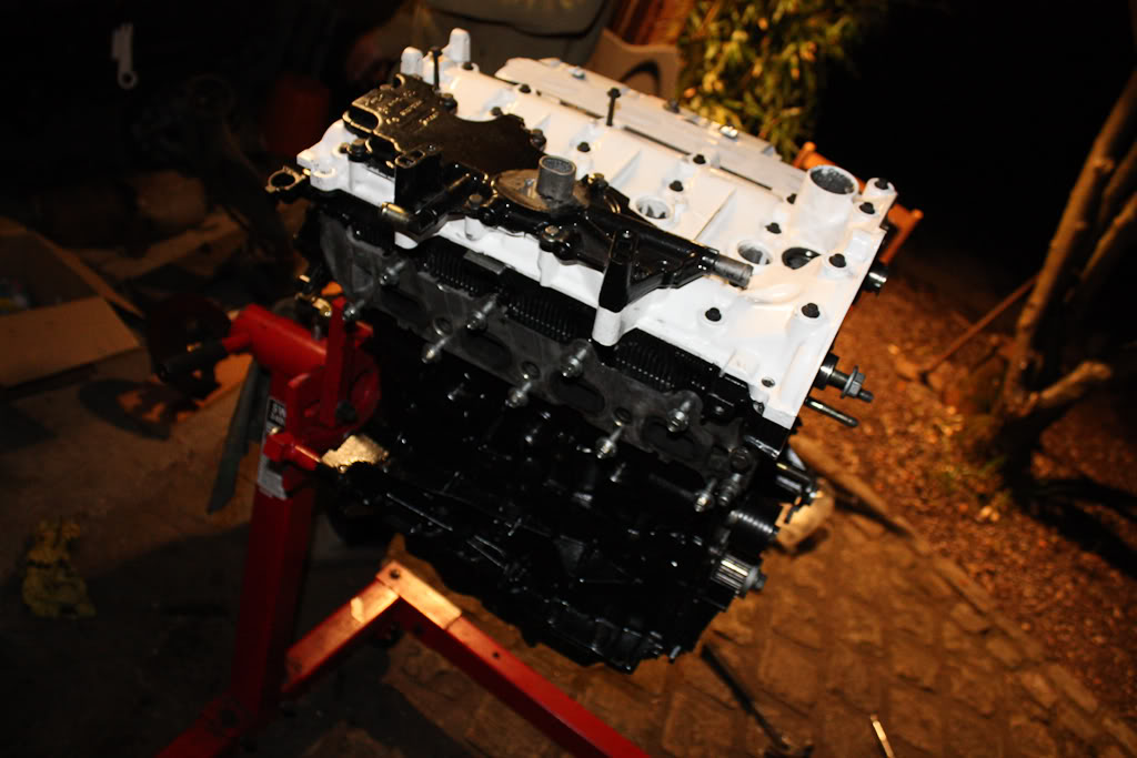

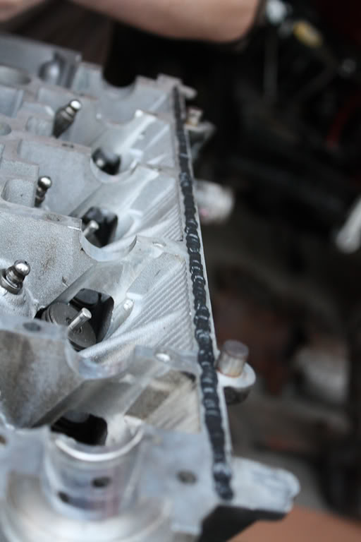

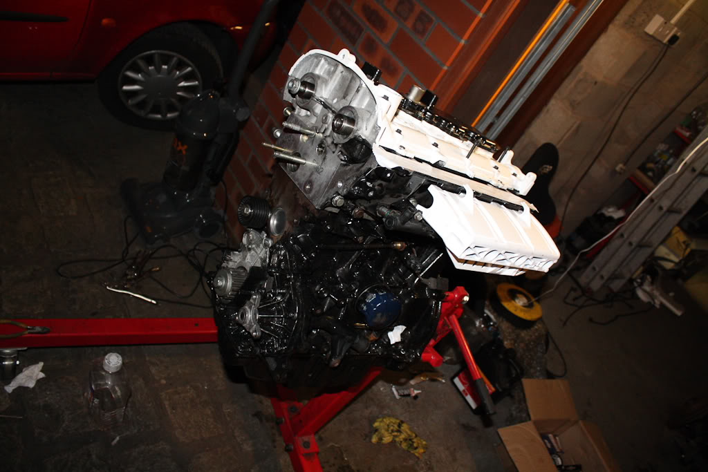

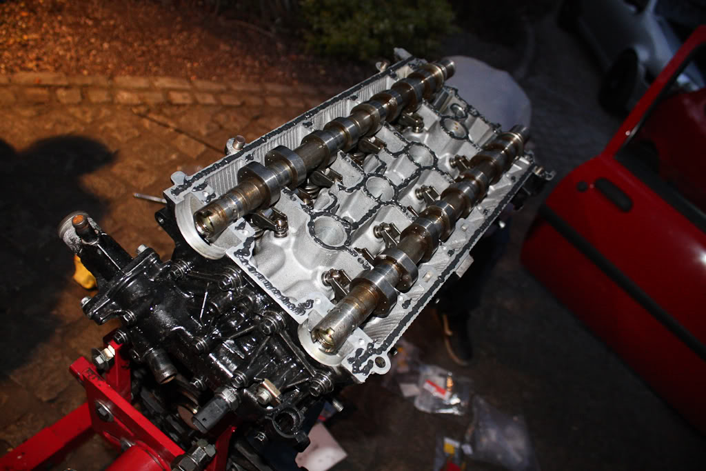

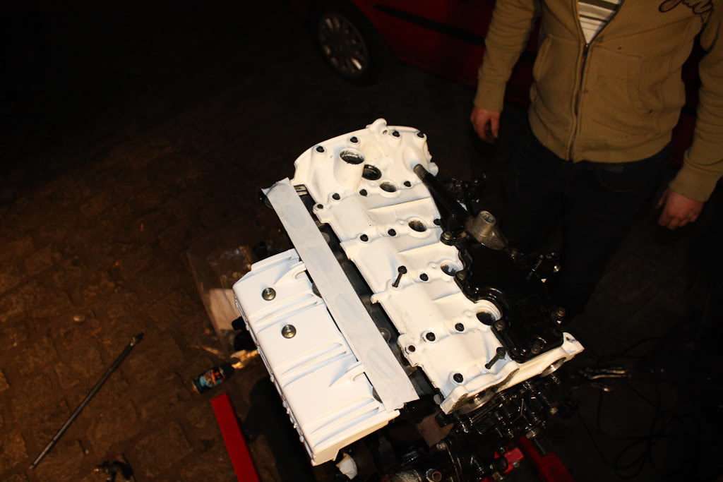

This ment i could get crackng with building the engine up, pulled the engine out of the garrage for abit more space to work on it. Gasket sealent on, lifters and tappets into place, cams in and rocker cover down, then bolted into place
This is when i found out the 2 bolts were wrong as you can see from the pic, the bolts were the medium size ones so i moved them for the smaller ones till i can get 2 more small bolts

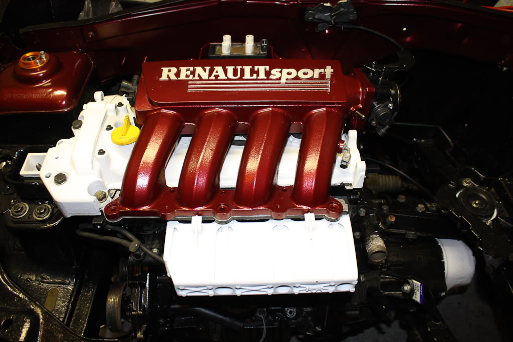

Few shots of the engine
As you can see ive fitted the lower inlet, fuel rail, injectors, breather plate, fuel rail guard and a new thermostat. A lot more to do on it yet and a few more bolts to get also

Not a good idea to have paint on the area where the rocker cover bolts will apply pressure. Very good idea to mask them before painting.
  Mk1 F4R
Yep true i was told about it but forgot to scrape the paint off as id put the gasket sealent on and needed to put the rocker cover on. Will it be ok if i take them out 1 by 1 and scrape it off and then refit and tighten them back up?
  182 trackday racer
Its hard to tell what it will do to the sealant. From what I understand torque sequence is very important to eliminate strange loads in the rocker cover. So honestly I dont dare to tell you it will be ok.

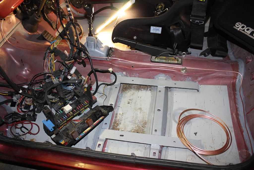

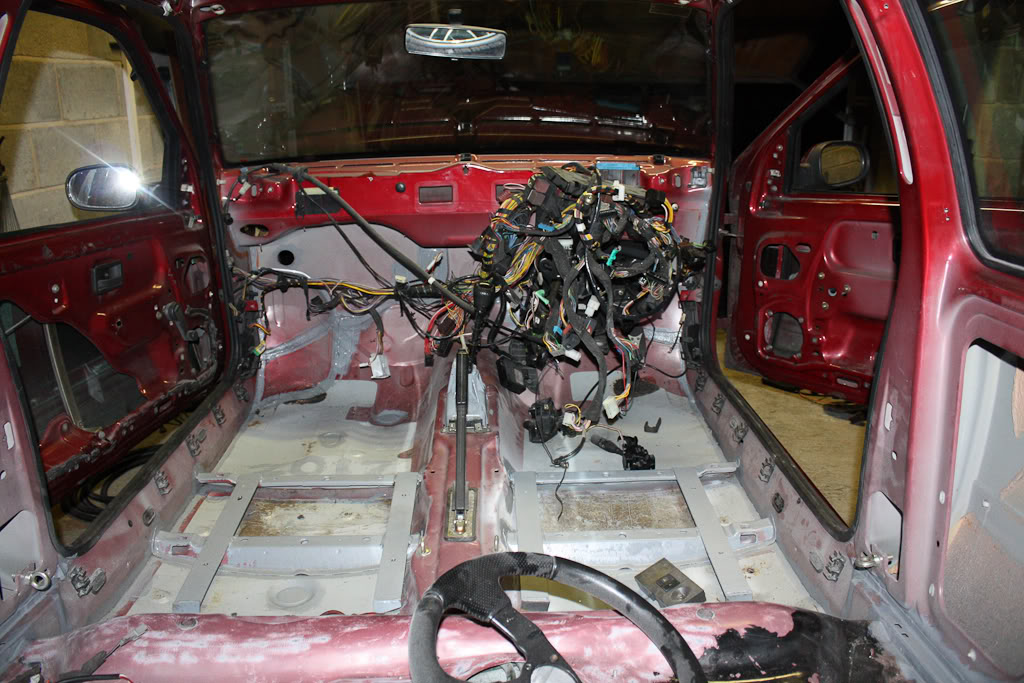

As the rear break lights and speaker wires run all different ways round the back of the car ive unwraped it all and taken out what i dont need boot light ,speakers and stuff for the boot wiring. Now its all cut down ive drilled a hole behind the drivers rear light to put the wires through, they will then be running behind the bumper and then up into the passanger side rear light, the wires running to the passanger rear light have been extended about 12" so they will reach, its all now in conduit and in place lets hope it still works fine.

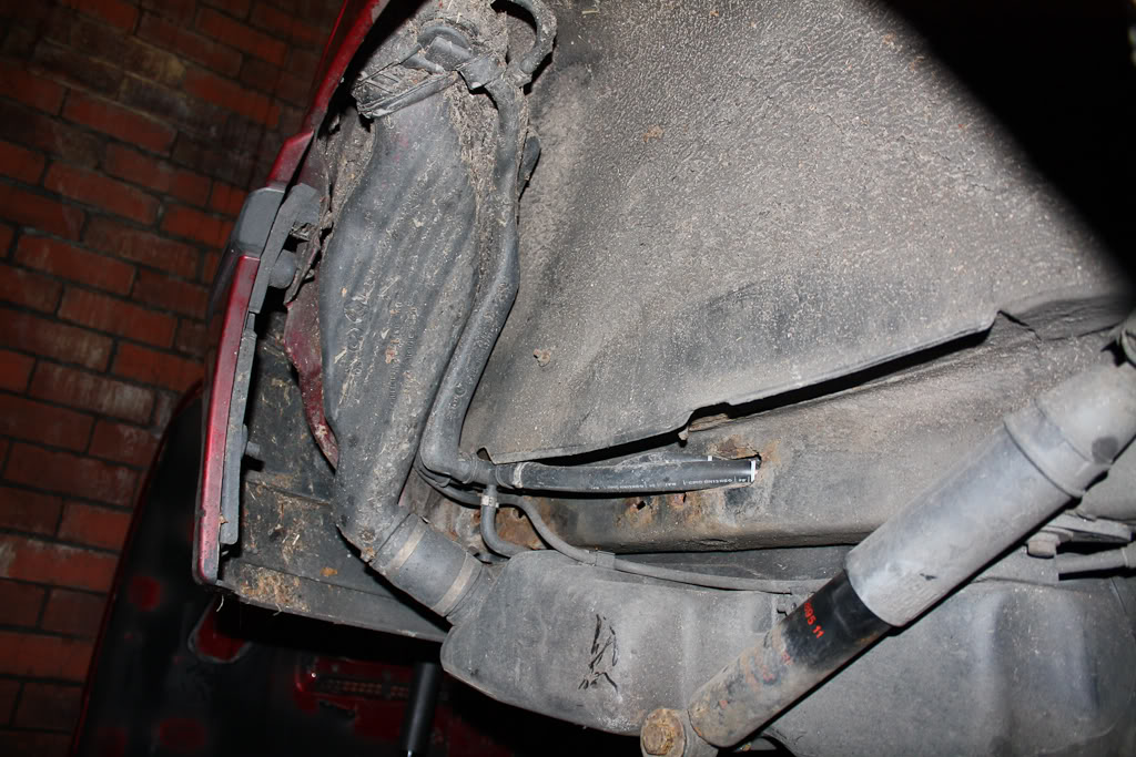

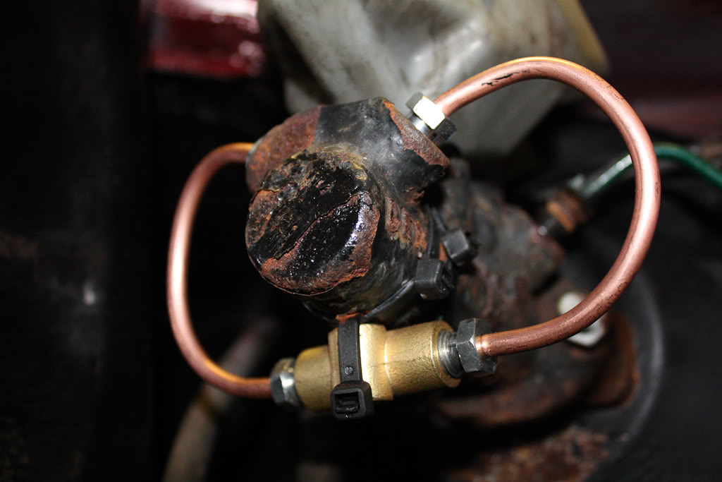

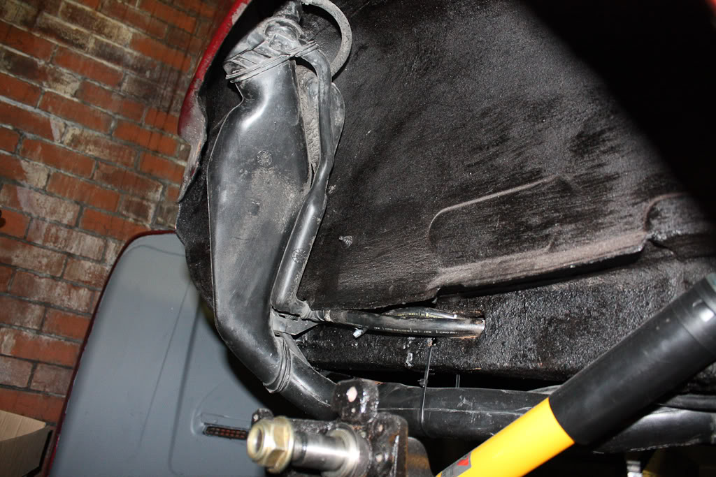

As ive taken the rear calipers off i also took of the lines that go to the rear beam (these ones came off fine) who ever had the car before me has changed most of the rear break lines and made there own out of the copper pipes kits you can get and its not a verry good job they have done, had the blow tourch on the bolts that go into the bias valve block just above the rear beam and none of them will move the only thing that did move was the bracket holding everything up, so im now thinking of re-doing the whole car 2 lines to the front calipers and 2 lines into one and then run through the car and putting a manual bias valve nr the hand break that will be to hand, then spit at the back to run off to the rear calipers with braided hoses on the beam still. Hope this works out ok and isnt to much cost wise. Just need to get a flaring tool, ohh wot fun this car is turning out to be problrm after problem hopefully itll run out of problems soon :(

Got a few more things to get to finish off the engine and then i can get the gear box and stuff on and then drop it in, hopefully soon

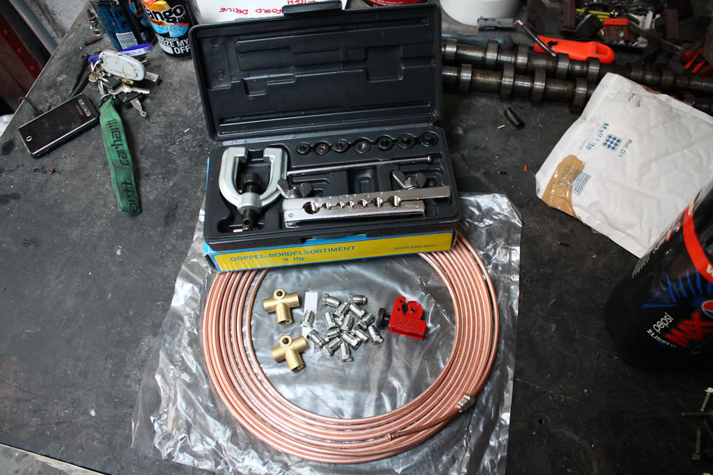

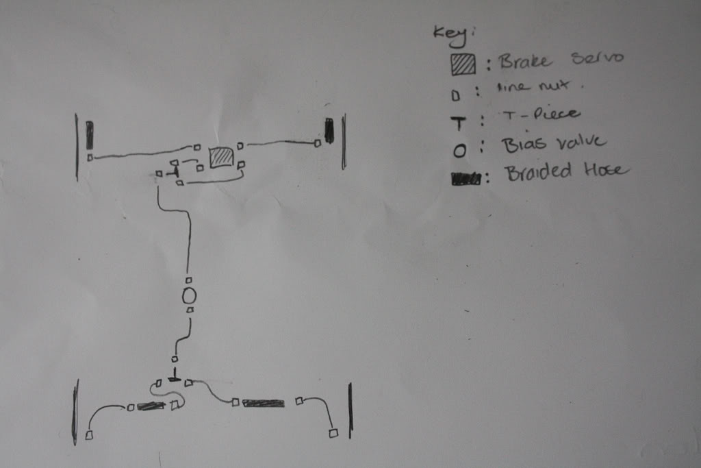

Few parts acquired on sat to sort out the new brake lines as the old ones were all a mess and the rear bias valve was rusted and seemed to not be working very well, so ive decided to rip it all out and start a fresh
This is how its going to look
The new parts got the lot for £36 from the local car shop not bad as the flaring tool alone on machinemart is £25

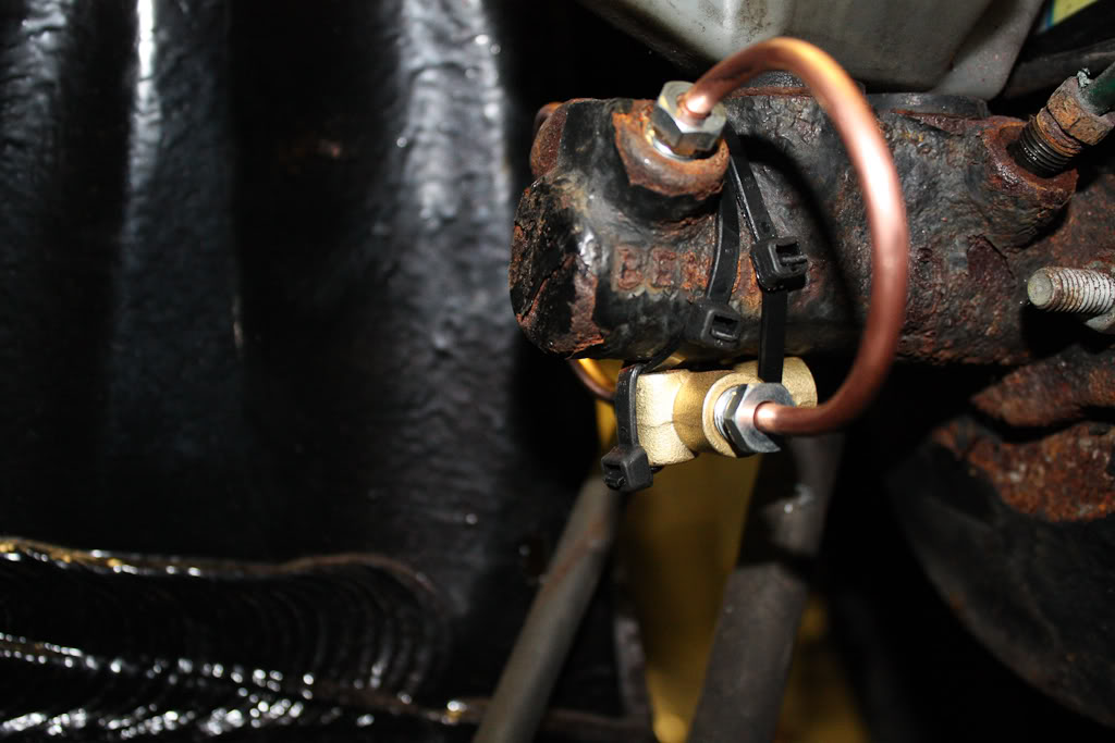

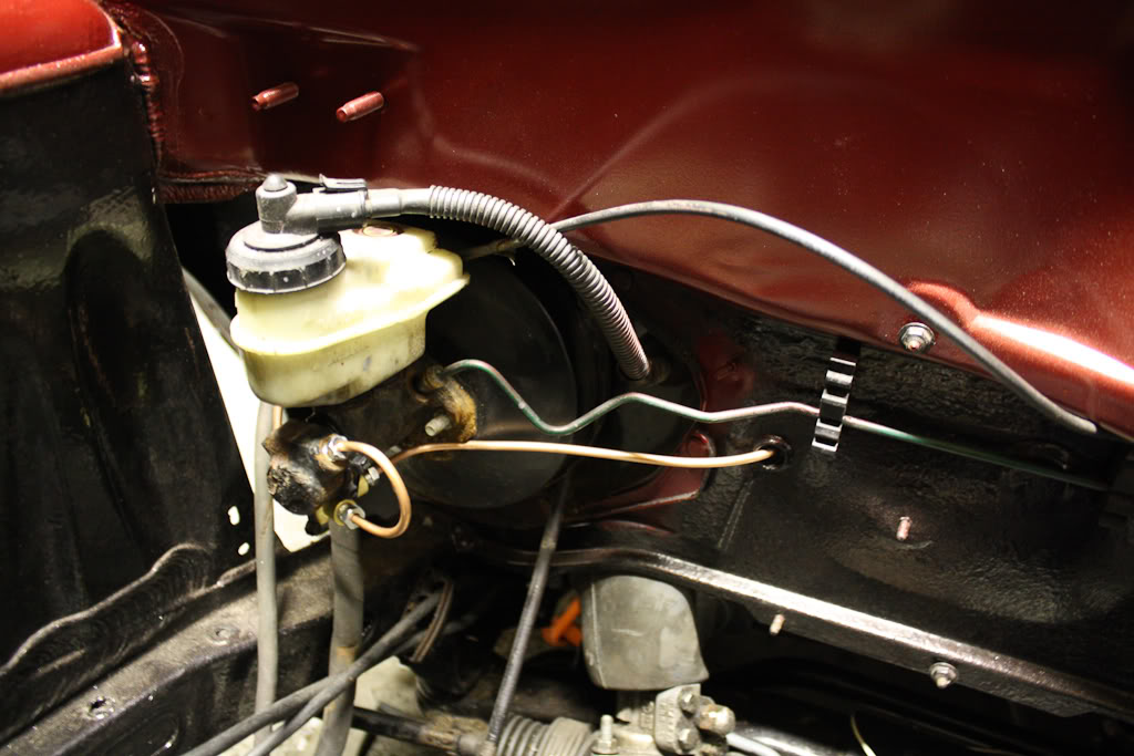

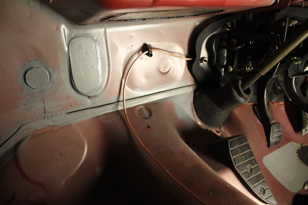

Done a little on the brake lines lastnight. As im running a single line throught the car ive run 2 lines into 1 using a t-piece, thing is i forgot to put the line on the farleft nr the wheel arch in the back hole so both are in the front 2 of the master cylinder, they used to be diagonal front right and rear left looking at it. Do people think this will be a problem or should i put it in the right hole, shouldnt be a problem to make another one up Done a little on the brake lines lastnight. As im running a single line throught the car ive run 2 lines into 1 using a t-piece, thing is i forgot to put the line on the farleft nr the wheel arch in the back hole so both are in the front 2 of the master cylinder, they used to be diagonal front right and rear left looking at it. Do people think this will be a problem or should i put it in the right hole, shouldnt be a problem to make another one up
  Mk1 F4R
Not posted in a while so....

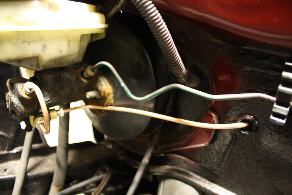

Ive finished off the brake lines on the engine side, ive put the line throught one of the grommets in the bulk head

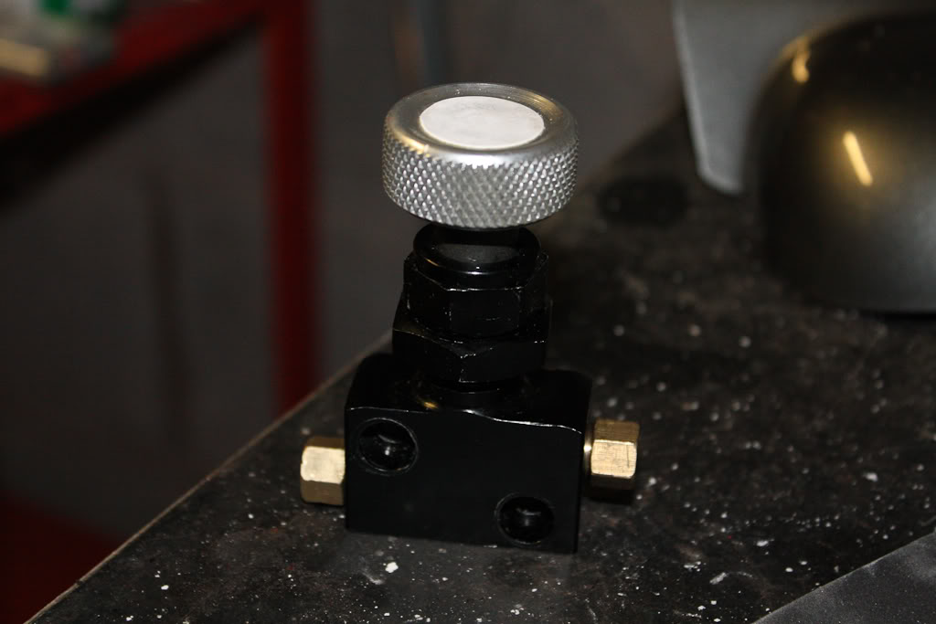

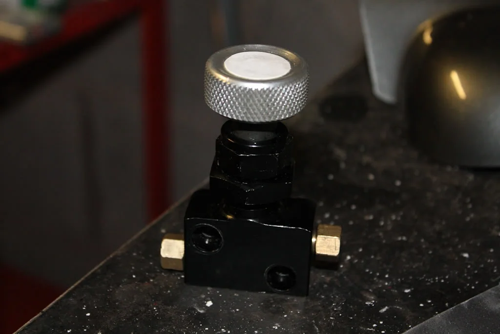

The inside view and were its running, im putting the bias valve on the side of the gear lever
Bias valve has now turned up so this will be fitted shortly

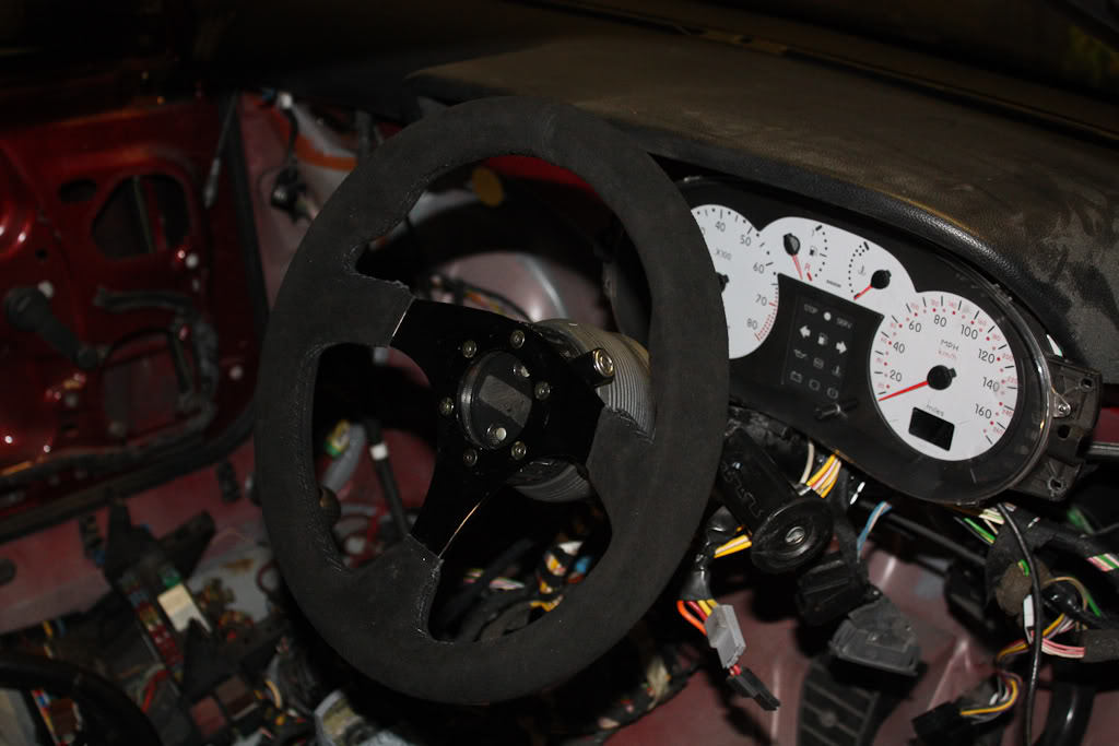

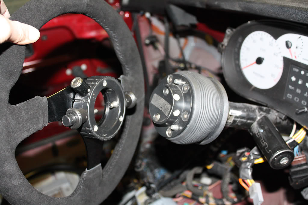

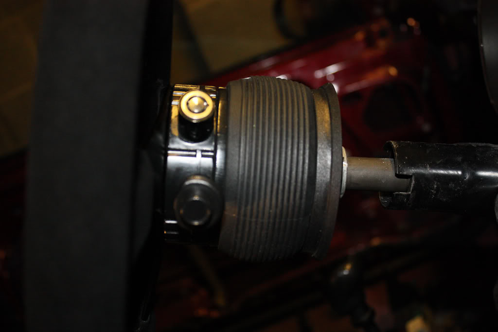

Ive been waiting for the boss to turn up so i could fit my steering wheel, whilst waiting for this to turn up a snap off boss came up on cs so i bought that too as he lives quite close. The boss has now arrived so bothe have been fitted

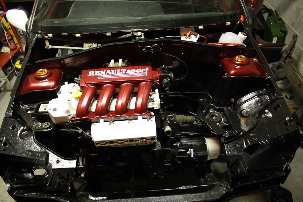

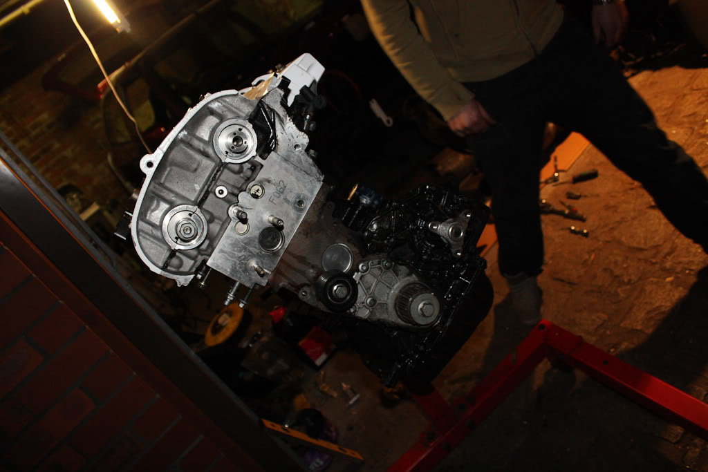

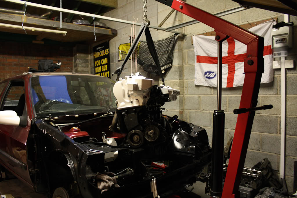

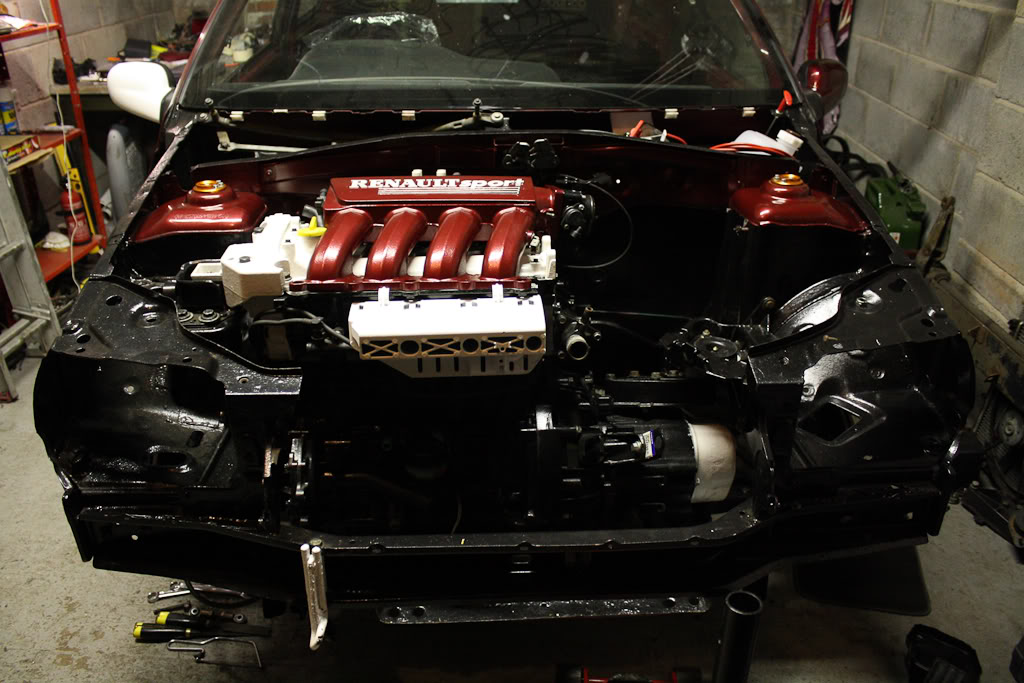

NOW for the best bit and finally its in, after waiting for so many bolts and other things its all together
Had a little struggle with the garge door and the crane lol as there was only me
Still alot more to do, more later
