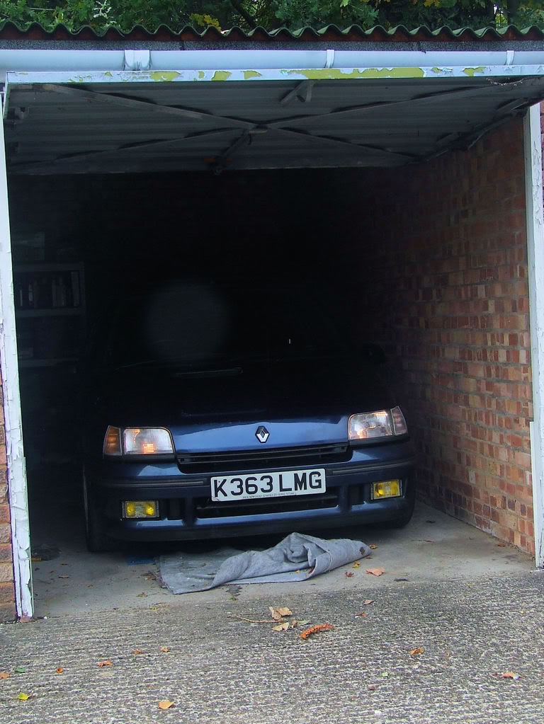

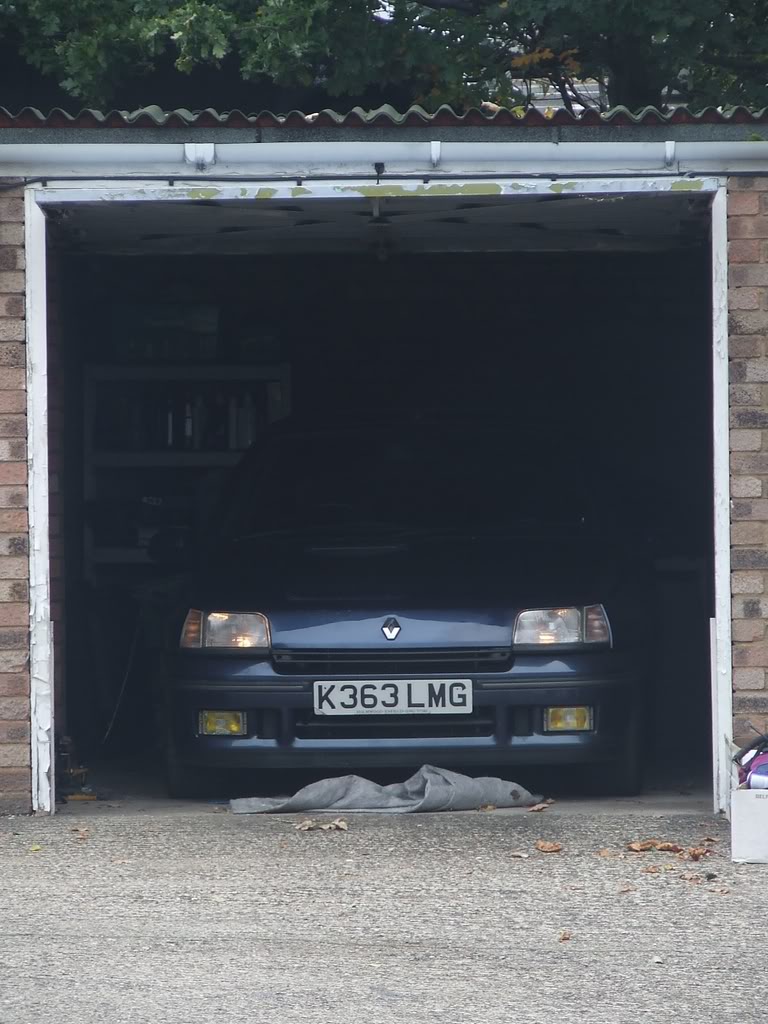

I've moved and acquired myself a garage... so now I'm not doing everything in the elements! :D
new theatre of operations :evil::
still got the trusty valver too! :D
