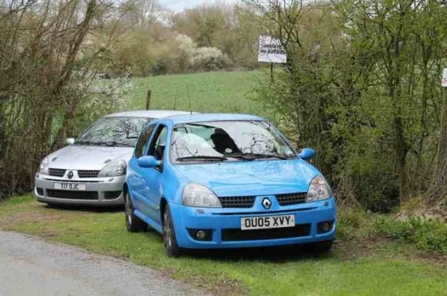

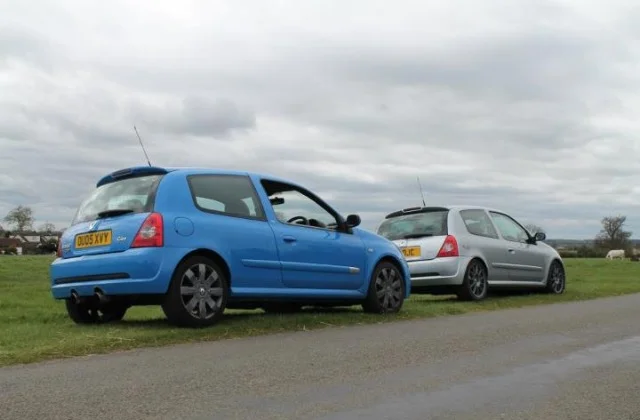

The only pics i have atm are the two below. Not the best either
Plans sound spot on. Looks like you've got a few quid to spend!
