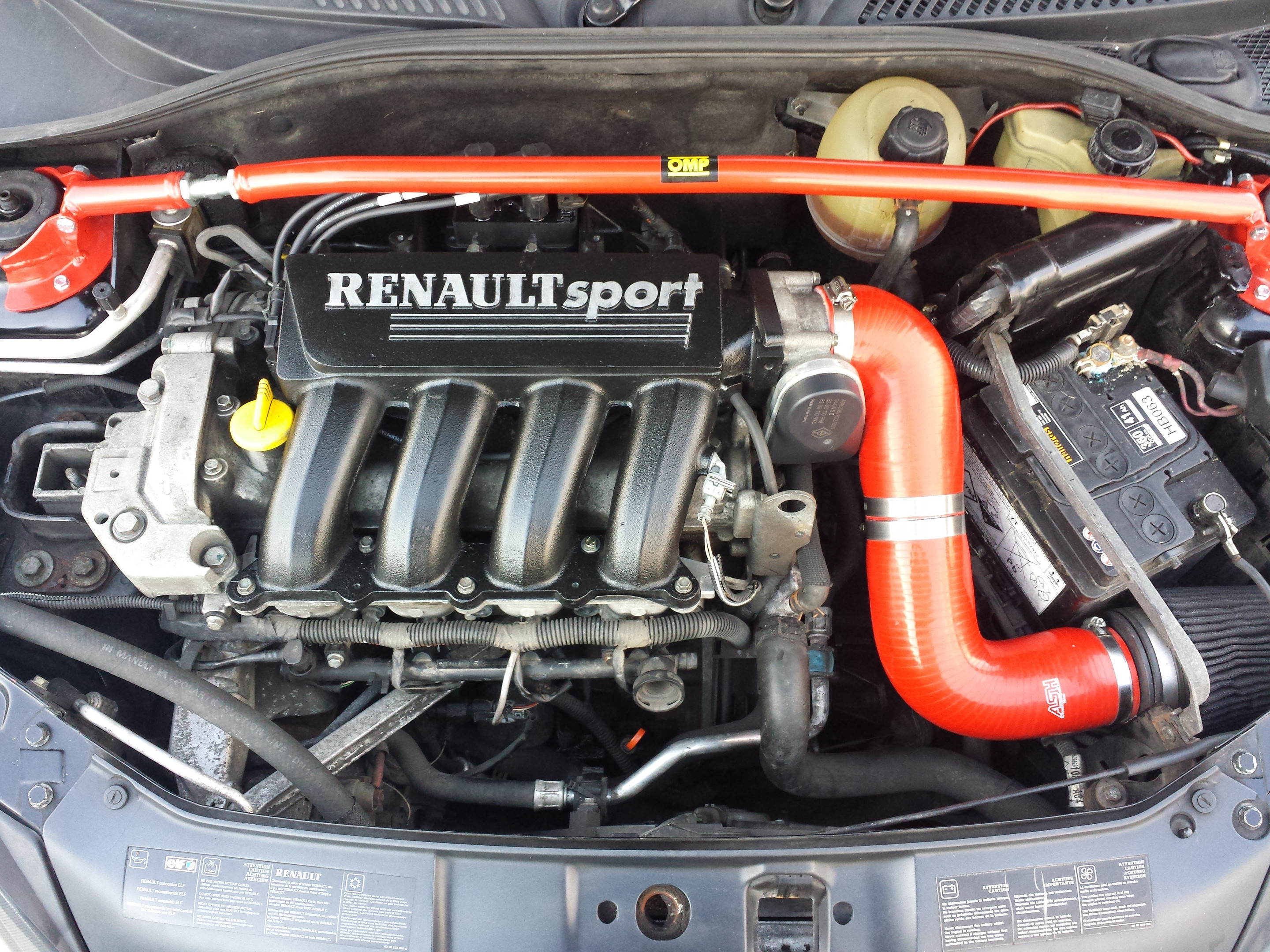

Purchased my new 182 a few nights ago and there's a funny spot between 2-3 k rpms where it "bogs down" and doesn't sound quite right.
This also happens higher up the revs to a lesser degree but none the less still noticeable at wide open throttle/the hesitation is still there.
The situation I have found is worse on a colder night which makes me believe the cars running lean. I have measured throttle body on my 2004 clio 182 and it's 64mm which I thinks oversized and causing my issue ?
Can any body help me out with this ,is the body correct or is this my issue?

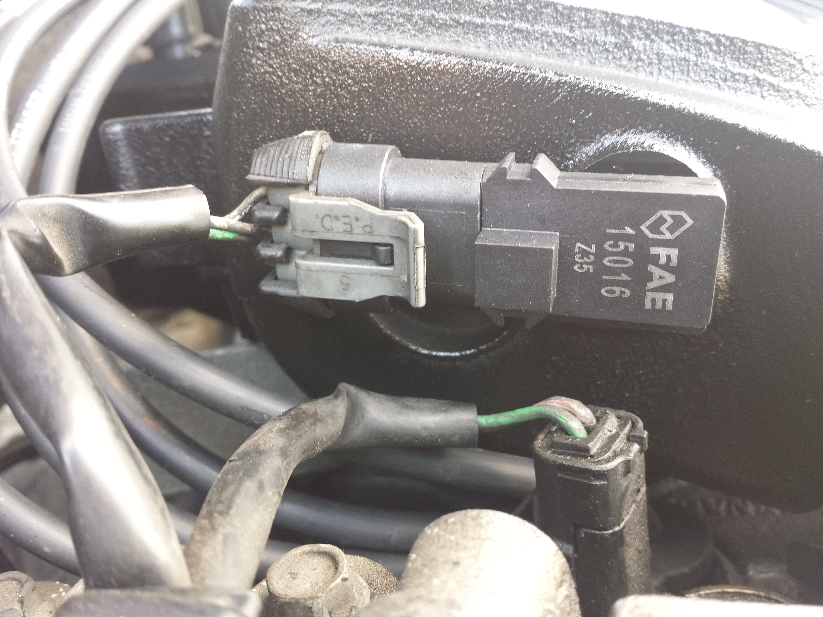

Think this maybe something to do with it.

ok so today i took of the manifold,blasted it through with carb cleaner (whole can of it) and replaced the gasket,cleaned air temp sensor,painted manifold and also fitted new map sensor.
SOO ANY WAY IT TURNS OUT IT WAS FAULTY MAP SENSOR
never got round to fitting new lambda but will very soon as i have it ready to fit
thanks for all your help and i am just gald its now working !!!!!!!!!!!!!!!!!!!!!!!!!!!!!!!!!!!!!

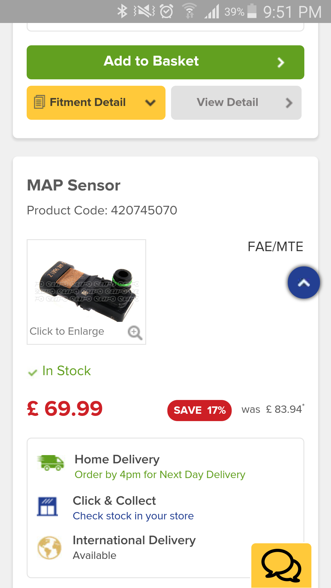

for anybody needing a part number from euro car parts
