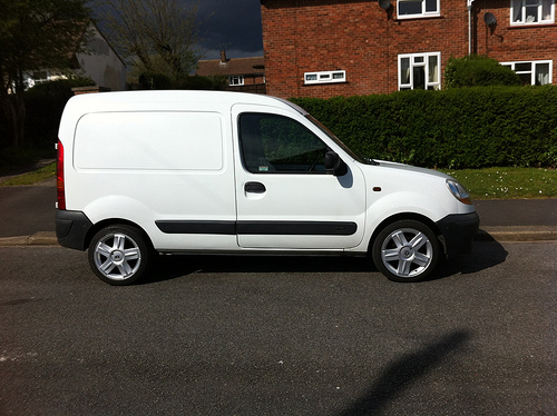

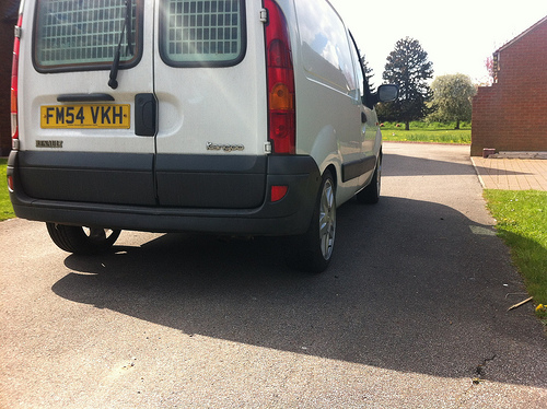

Quick pic of the van after fitting the 172 wheels.
Van after fitting wheels by ashleyt33123, on Flickr

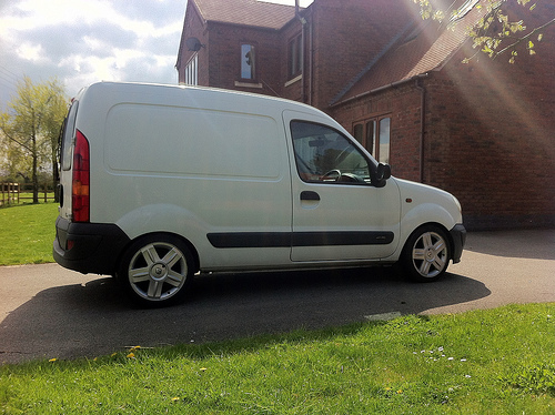

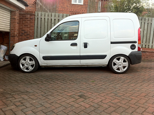

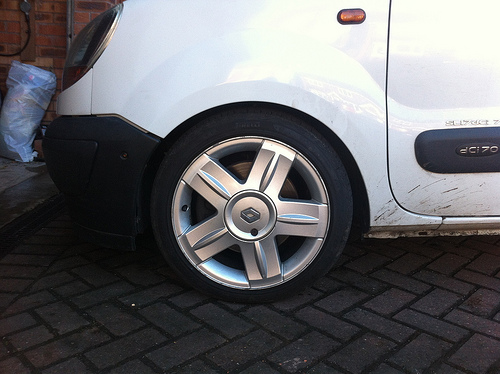

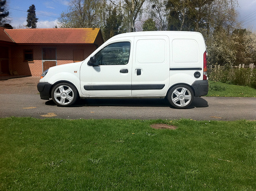

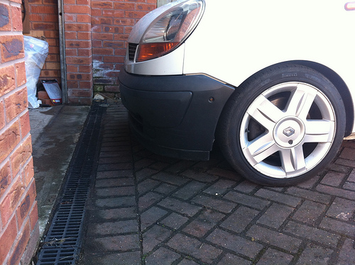

  Kangoo 172 Cup ;)
The back has dropped a little bit more now i have covered 5 miles or so in it, but quite happy with it, handles great and the rear wheels dont catch which is a surprise after trying different hub-centric spacers to stop the wheels catching before I dropped it.

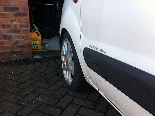

  Kangoo 172 Cup ;)
That is superb!
What does it drive like now?
To be fair, it feels very close round bends to a 172. Not trashy, just firm and flat! Think one of the front disks is a little warped but I will change them if it does not bed in well.
