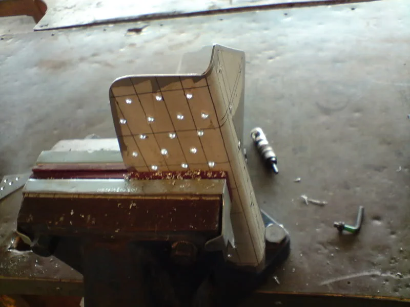

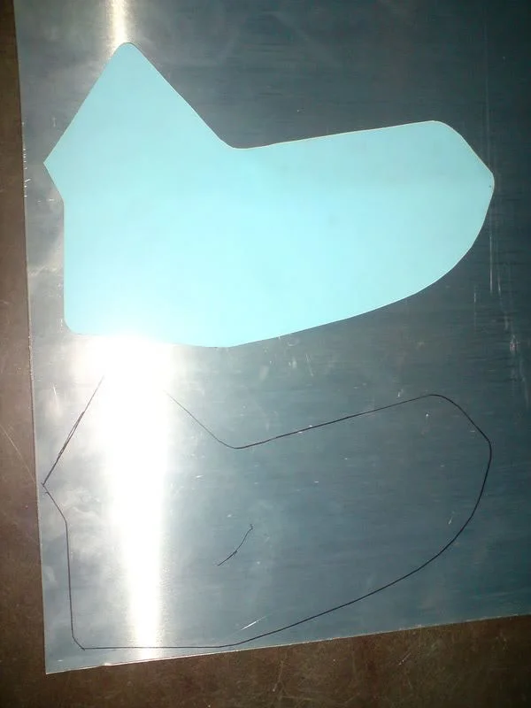

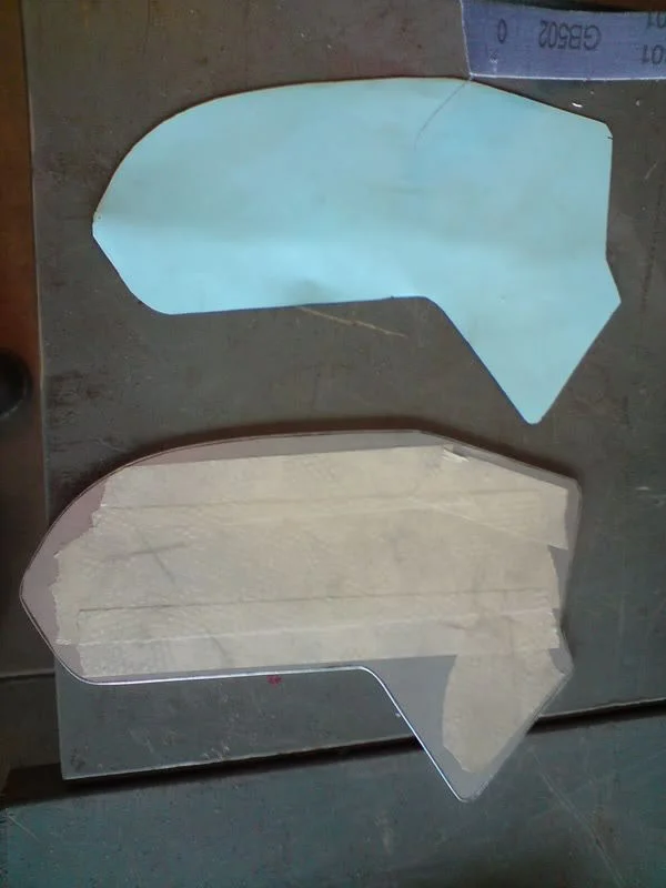

Started off taking the footrest off and making a template, I wanted to bend the side over to make it look better so added that onto the template.
Deburred edges

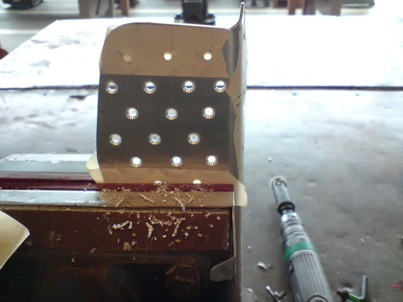

Measured out and drilled the holes
Countersunk the holes
Riveted the plate to the pedal

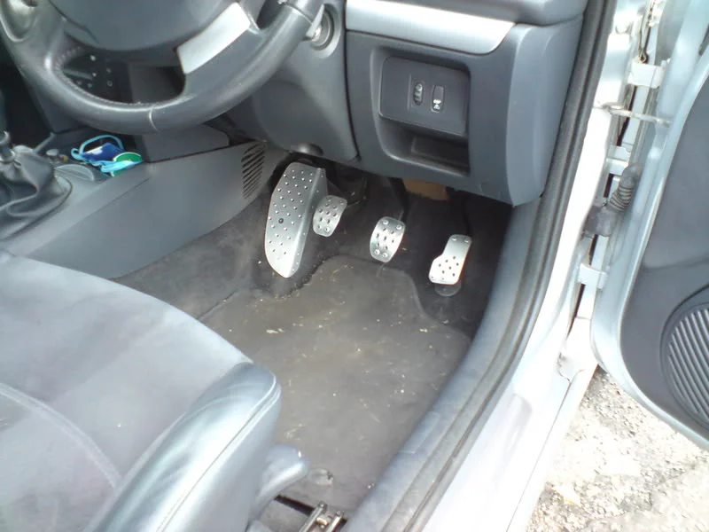

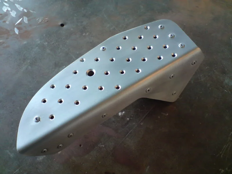

Finished article on a dirty car
I might be willing to make more just wondered what the feedback would be like. I know there is one someone else makes on cliosport and hope its not patented, but this is slightly different in design anyway ;).
Fire away!
