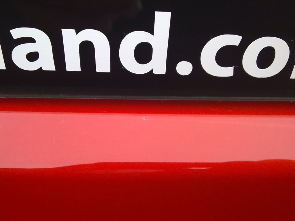

Right, I just read theduck's detailing thread and seeing as there is more than one Mk3 Clio out there besides mine thats rusting, I thought I would throw up this thread to see just how many there are.
Can you please post pics of your rust, and a brief description, and what if anything Renault have done. Would also be good to know how old your car is. Here is a quick pic of mine but the damage is running the length of this shoulder on both rear side windows. The worst spot is just below the "D" in the sticker. Im going to get more pics later.

Zippo, yeah mines a 2008 car, though I know for a fact it was sitting unregistered for a while before being registered in March last year. I got her in October. I went down to the dealers yesterday and told the rep that I had 2 issues with the car. 1) the adhesive on the rear lip from the SX kit has failed and 2) RUST. He pretty much went white and said show me. Hes told me to speak directly to the service manager on Monday morning. Ive a feeling they will be all over me now considering the hassle I had with my last Mk3.

Its real rust alright. Like I said in the OP, its come up thru the paint layers, discoloured the paint around the area where its breached the lacquer and theres discolouration runs on the worst bits. And its getting worse. I hadnt noticed it on the bootlid until today. The door sills seem ok for now.
You say respraying wont fix the problem? Is there any way to cure this apart from a new car? I wont be taking a Ph1 Clio anyways, I will be waiting for the Ph2 then. Unless he wants to give me the keys to a 197, but this time Im not paying any extra. Jeez, rejecting 2 cars in 5 months. Not a great record in all honesty.

Well, first off I havent been anywhere near a gritter!! And secondly, I wash my car once a week, sometimes more often and Im always careful to wipe down the hard to get to places such as the petrol filler area and the window shoulders in the picture I posted. There was just one bubble at first and over the last few weeks Ive noticed more and more blotches. And the damage has also popped up on the drivers side and now on the bootlid too. And I know the difference between a stone chip and rust damage. A stone chip has a characteristic depression of the metal where the stone hits. These blotches and bubbles dont. The metal feels level and where the breach occurs it even rises up slightly.
Anyways, small update. The dealer phoned me a little after 5pm to tell me to bring the car down at lunchtime tomorrow (Tuseday) and they will have a look at the car there while I wait. Surprisingly, Renault are taking this extremely seriously as a representitive from Renault Ireland's technical division will be there waiting for me to look the car over. Now, whether this is because of the dreaded R word, or because of the hassle I had with my last Mk3 I dont know. It could be a combination of the two or just a lucky happening where the chap was available. Thankfully Renault Ireland seem to take things more seriously than what I hear about Renault UK. They seem to have a proper sense of customer service, which is refreshing.
