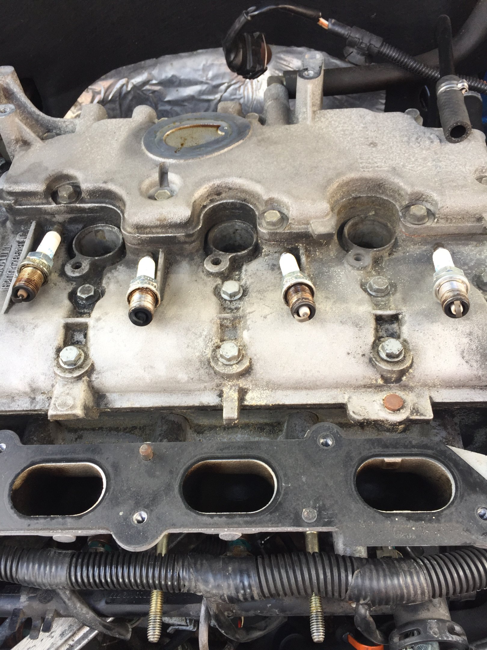

hey people,
Had the engine management light start flashing yesterday and lumpy idle. Progressively getting worse, the plugs, leads and coil have already been changed prior to this happening. Thought id have a look at the condition of the plugs today. Number 3 is very sooty (see pic) could this be a faulty injector? Im getting the P0300 code which is missfire but doesnt really let me know more than that. Anyone else had this?

Yea thats what mine was mate, when the car is running, unplug each injector and ill guess that number 3 doesnt make a difference to the running of the engine.

Orderd 4 new injectors. Will report back with the outcome. From the searches iv done and other people’s experiences looks like the culprit. Thought it felt a little down on power recently :smile:

So, just to wrap this thread up for anyone in the future, they have been delivered and been Injectors fitted, flashing engine light, pop pop bangs have all gone so if you have a flashing engine light, running rougher than norm, and possibly a sooty spark plug or 2 then it will probably be an injector/s
