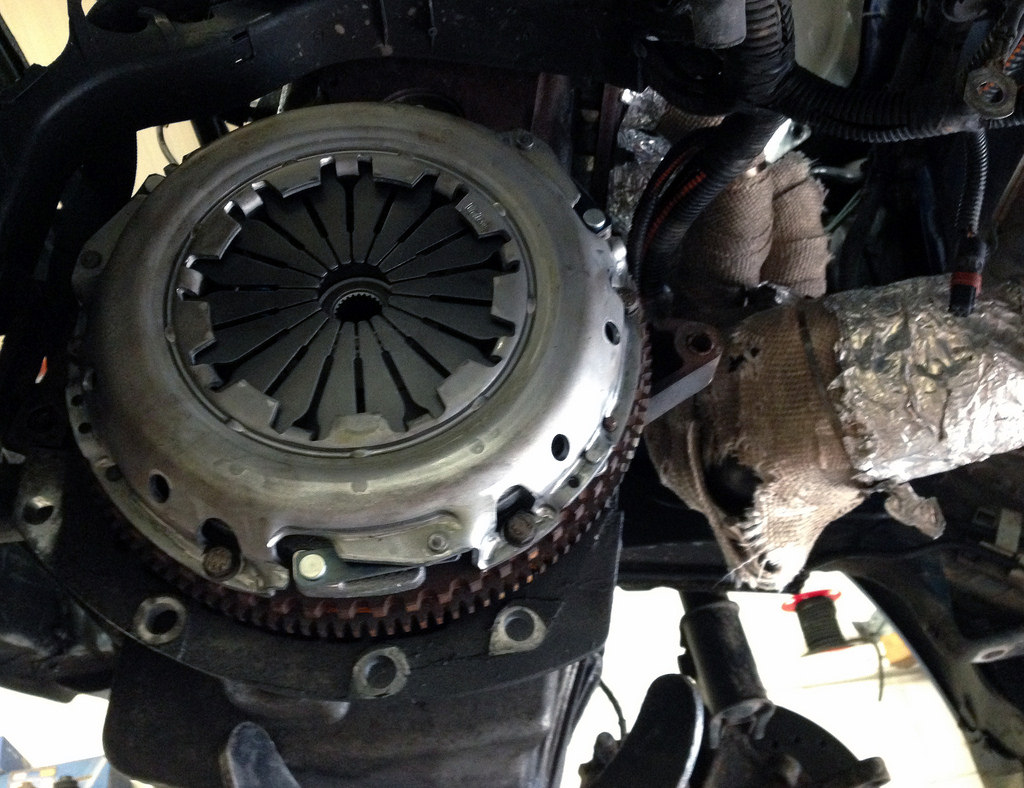

Well today was the day the list of things that got done thanks to @AlexW was
- Ph1 gearbox
- New OEM Valeo clutch
- PMS gear shifter
- Starter motor
- 182 manifold
- Decat link to exhaust
- Spax RSX coilovers and tracking
- 3mm rear spacers
- 16mm front spacers
Some were planned some got added as we were going :smile: save to say it was busy, Alex is a star, what we managed to get done was impressive! I have a few pics I will upload tomorrow and will try and get some pics of the car as it is now, takeaway time now :up:
mintno1
  Ph1 172 / Mk1 Valver
Well it was a busy day yesterday, didn't get many pics during because I'm a bit hopeless :smile: I was helping with the work though so that's my excuse
New OEM Valeo clutch in situ

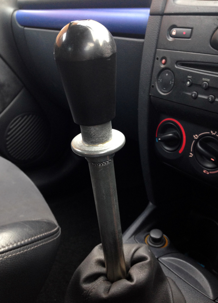

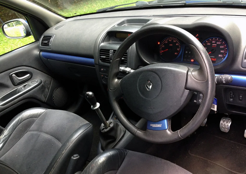

PMS gear shift in place, very interesting picture 😂

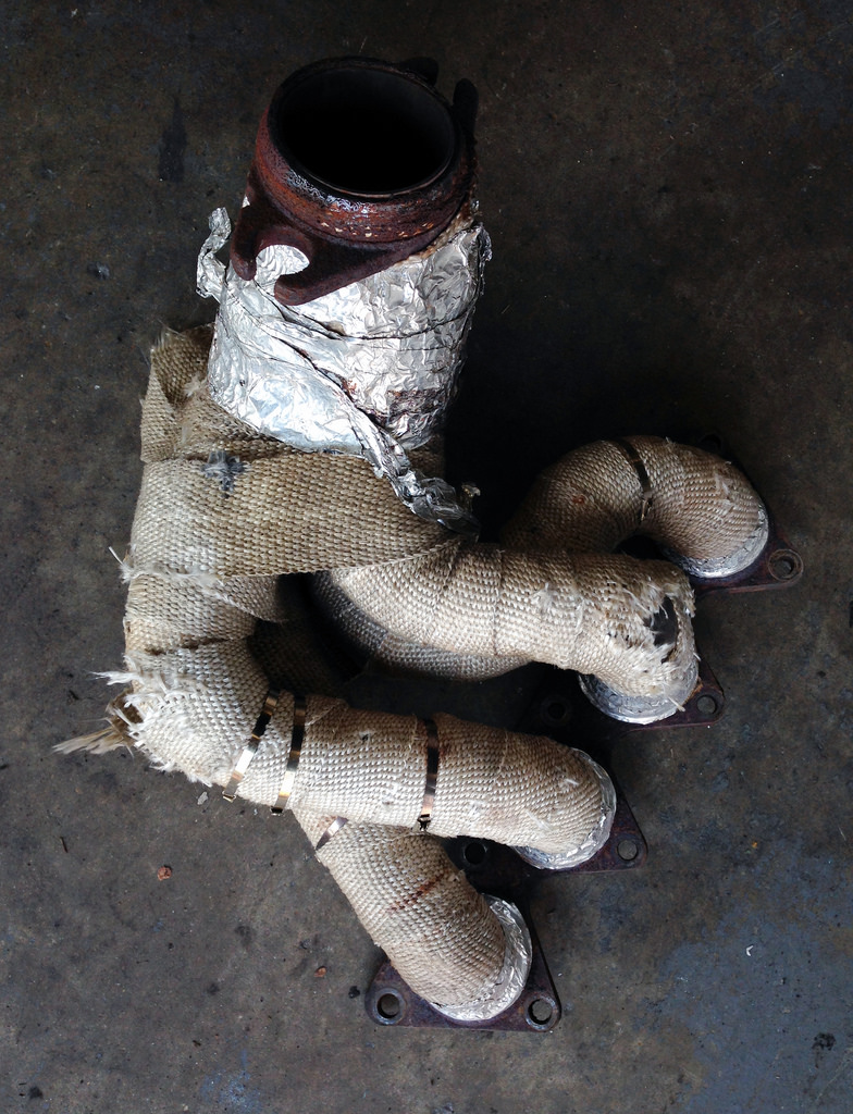

Beautiful wrapping and tinfoil on the manifold we removed, one of the reasons it was coming off and because Alex had a 182 manifold

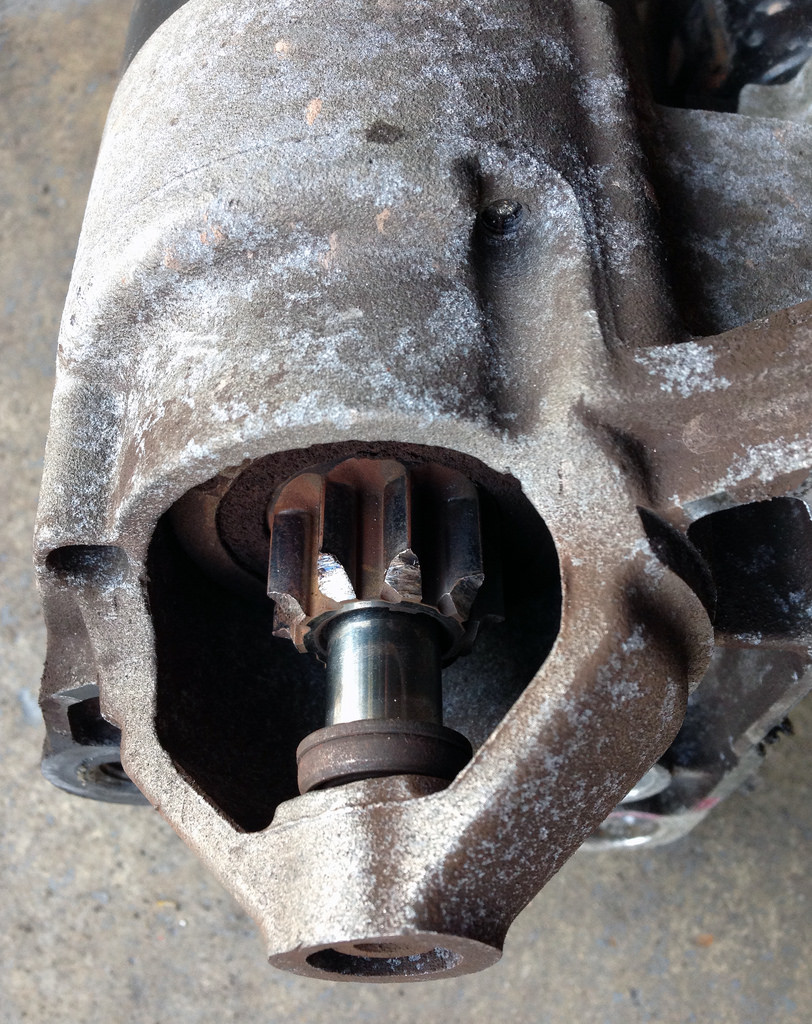

Starter motor chewed up, this got added to the list and replaced, the cause was because it was only held on with 2 bolts and had been mashing itself up

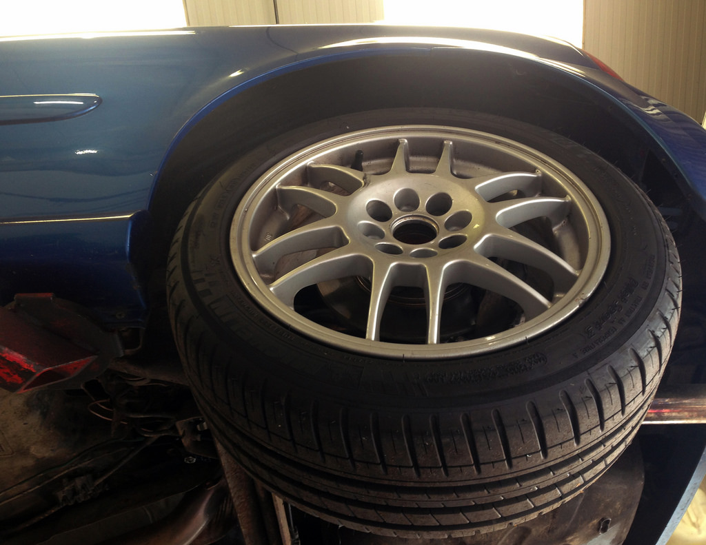

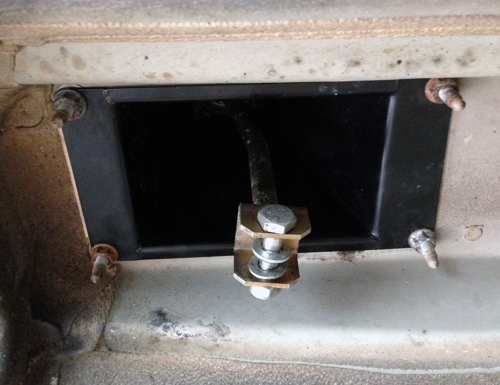

We also weren't planning on adding the spacers but after all the other work was completed and an enthusiastic test drive from Alex, we had some rubbing on the rear so we added the 3mm spacers as a temporary measure, will order some hub spacers this week all being well to replace just have to decide what size. Alex also had the 16mm front spacers with extended bolts so threw them on as well while we were there.

Loving the PMS gear shifter, slight rattle at 3-4k in 2nd & 3rd but nothing I can't live with and not bad at all, have heard some horror stories and was worried but didn't have any need to. It's so worth it for the positive change in shift. Slight issue getting in reverse, you have to be forceful :smile: all the other 5 gears great so will adjust and see what we can do. Gearbox feels great which was again a worry as you just never know when buying a 2nd hand gearbox so all being well will stay that way.

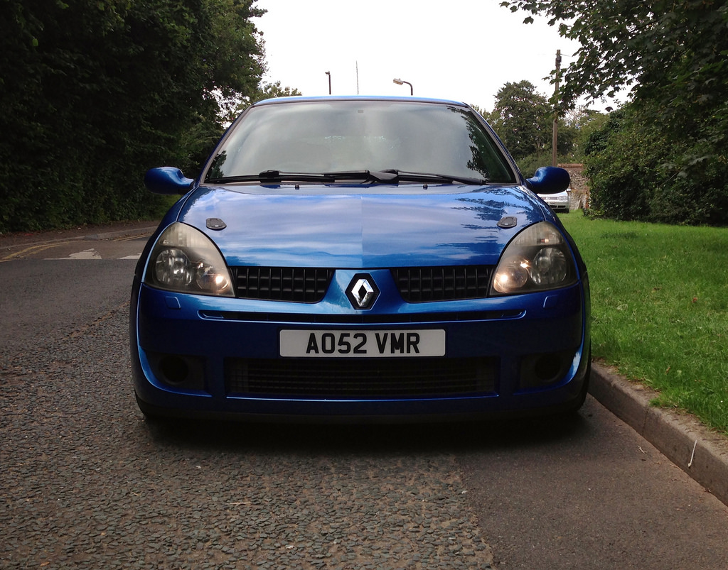

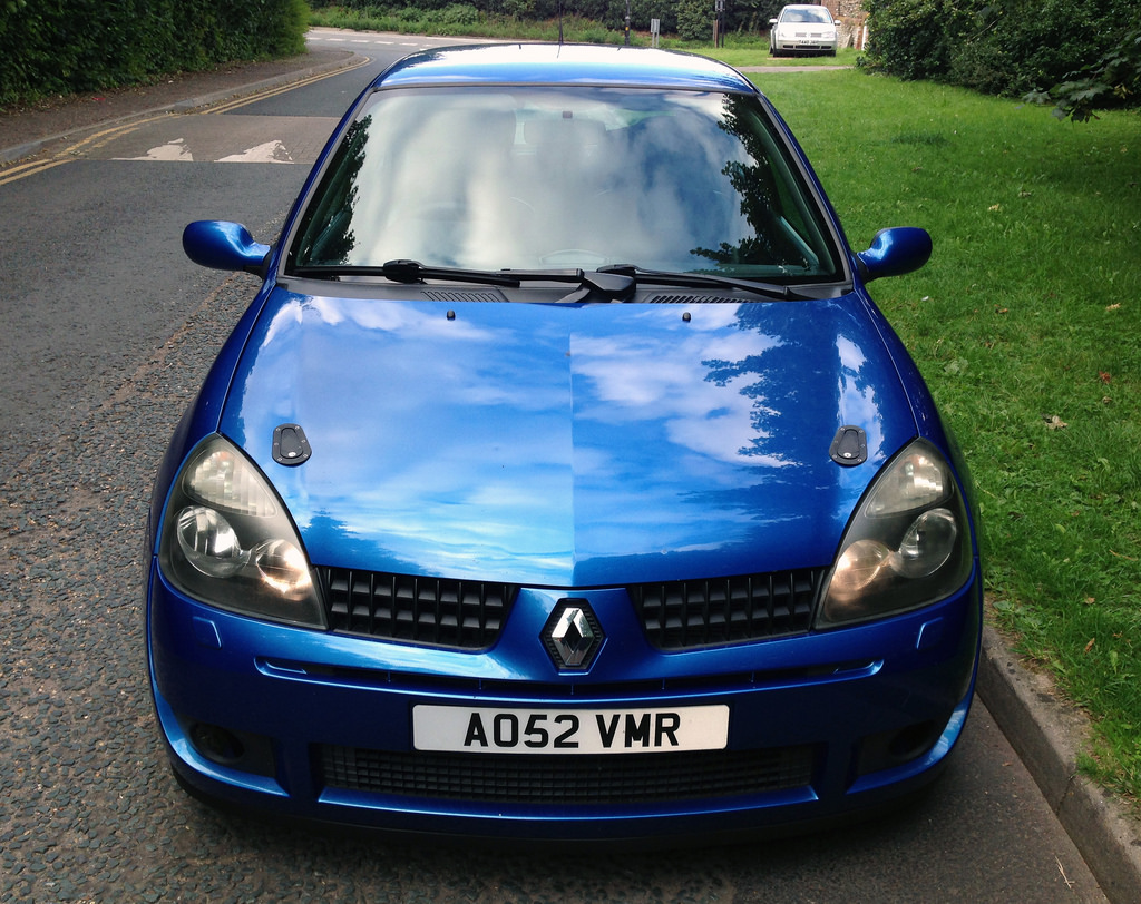

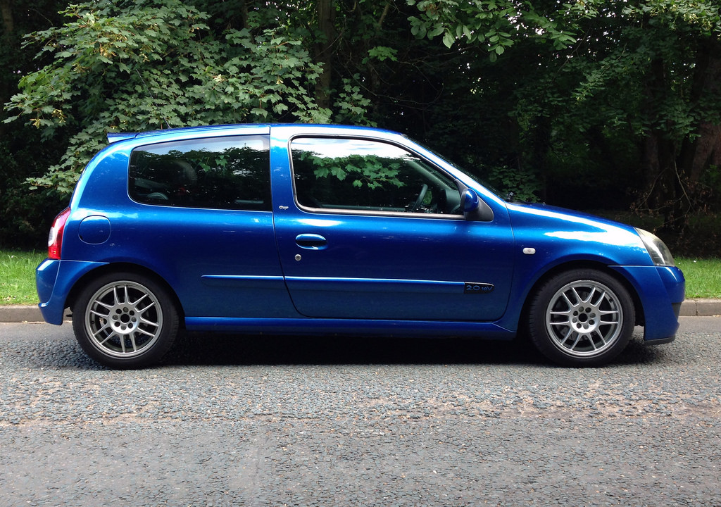

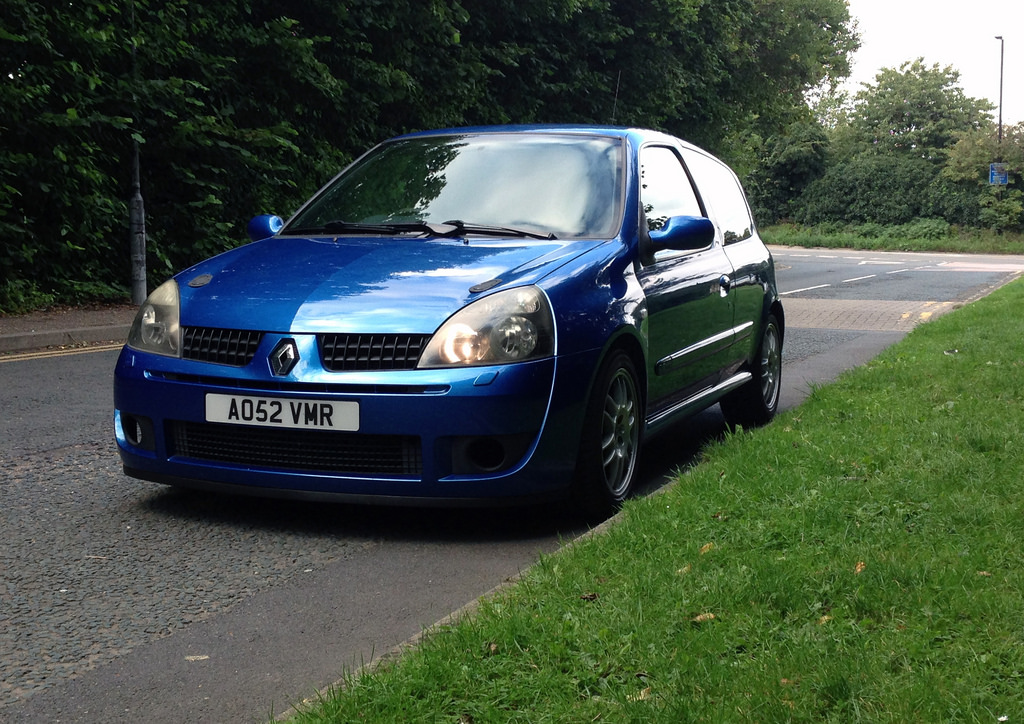

Grabbed some pics earlier, this is how she looks at the minute

It makes a massive difference to the shift, a lot more direct and accurate, you can feel the shift a lot more a lot less vague. I was tempted by the BMS but a few people said go the whole hog and get the PMS so I did, also helped that one got offered to me and I got to test drive in a Ph1 first. My wife got in the car and said that looks ridiculous 😂 but it just feels in a great location, surprising how making it higher makes such a difference, would recommend it, if I ever meet you in real life you can give it a go :smile:
Haha cheers mate, would be interested to try one one day, I too have looked at the BMS but this looks like the real deal if that makes sense

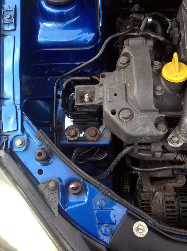

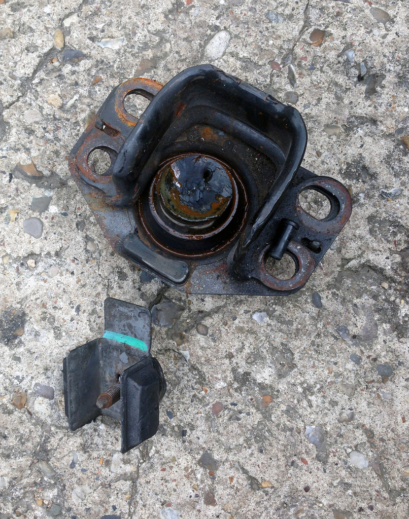

Only a small update when we did all the work a few weeks ago noticed that that both the engine and gearbox mount were done for so swapped the engine one today for a brand new one and just need to organise the gearbox mount now. Did 100 miles today and all good :smile:
Goosed engine mount
Brand new replacement, need to do something with the bolts but will sort them out at a later date :up:
