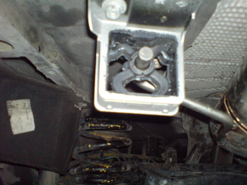

1. it is low in the left side, the guy who fitted it was fiddling for a while and it sat straight when it left the place but on the drive home has become low on one side. i take it this is the mount? will i just need the left one or shall i replace both? is it a job i can do on my own?

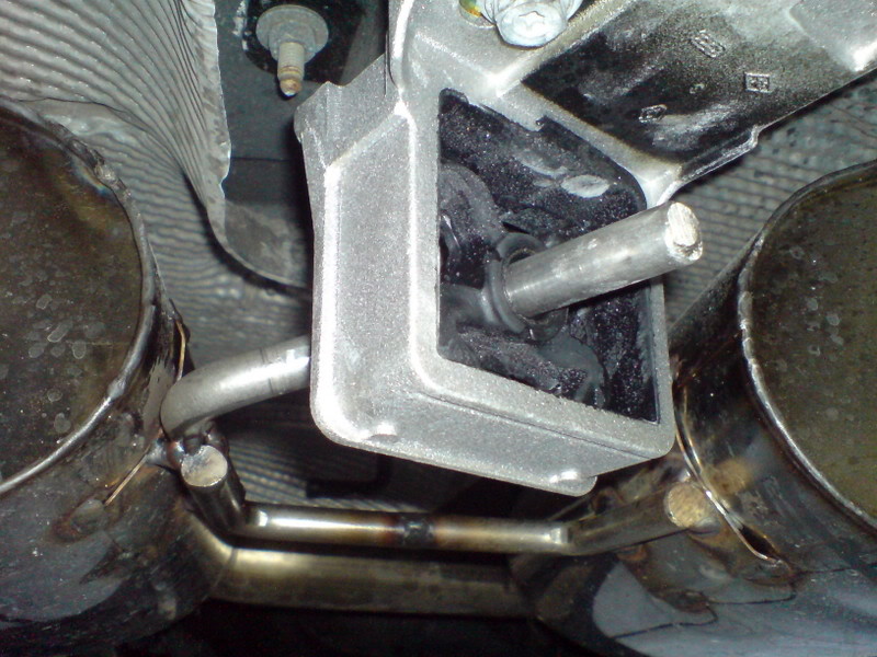

2. I have taken a picture of one mount that isnt used by the system its behind the right backbox (as you look at the car) and i am told by the guy that it will fail its MOT on this? if this is the case then where do i stand with regards to Milltek/Ktec fixing it? i didnt pay the best part of £400 for it to fail an MOT!

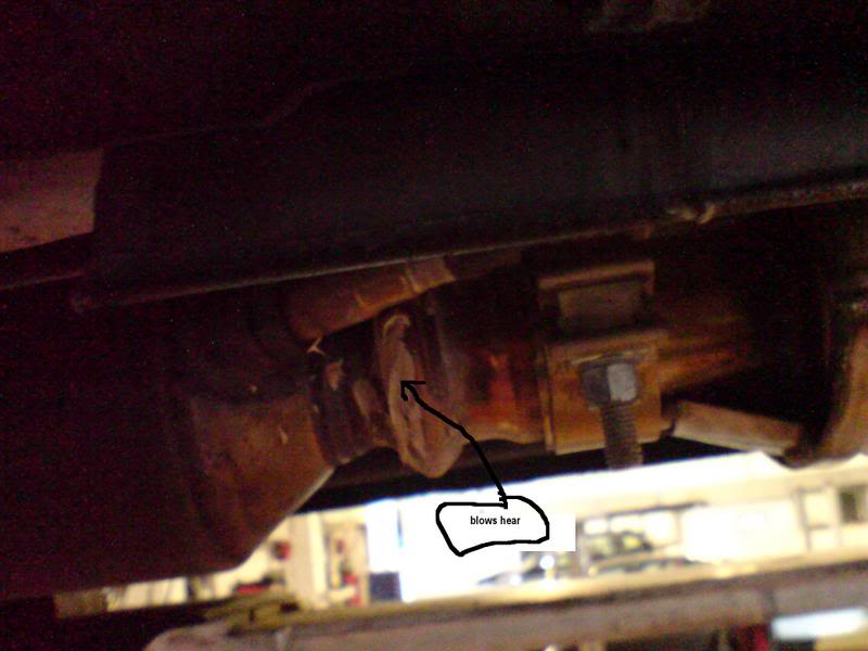

3. Its blowing at the cat joint, its pretty bad and is annoying. how do i fix it? and again can i do it myself?

hi mate get your self a new clamp from renault and don't bend it apart
you can just pull it apart a bit and it will go on , with the bolt out ,inside the clamp put some firegum or thin exhaust paste in + a bit inthe pipe from the mill to the cat

Right the mount you are looking at should be used as i spoken with milltek when mine was being fitted and they made an adjusment on all the systems before sending any out so that this mount is in use which it does hold the whole system alot more stable.

you ask for the clamp behind the cat to the mid part of the exhaust , you can try and refit it but most fitters just pull it apart and bend it out of line it if you get a new clamp only get a one pice clamp from renault , some are two pice thay are crap . i love my janspeed no blows looks cool fitted spot on first time i might add, i think it sounds cool aswell .

Well i definitely have not got that mount either, I compared the milltek and the standard and you can see the extra mount on the standard exhaust. All it is, is a metal bar welded to the back box which should slot into the mount in the pic above. Seems Milltek have slipped up there, they can come round to my house to weld the missing bit on, lol, because I am not sending the exhaust back now.....

take a look at old post janspeed a look under you can just see the bar on the right as you look from behind .

it as two bars at the back goning into the stock rubbers mount and one bar infront on the right side of the others bars going through to rubbers
so there are three mounts at the rear in all .

the noise is like a whistle/hiss, i know its the cat as so many of them do it! just dont really know how to fix it. only notice it if i give it medium/alot of throttle (due to the higher pressure i assume), if i reversed quick then i suppose yea it would do it. does it from about 2000rmp upwards if that helps ya

yea yours doesnt seem to have the mount on it either, unless there's a separate bit you havent photo'd like a clamp-mount if you get that. maybe phone Milltek, and say RS will weld one on for you if they pick up the bill.... and if that works tell me because mine will be next lol

What exactly is missing ? Which of the photos is it easiest for you to describe where/what is missing ?

the circle things are the renault mounts on your car. and the red pole is what you are missing. sorry its a bit crap! lol

No probs mate. Yea John has it, Milltek had to add it to his...they had left it off and said they would alter all the other systems. I think its a bracket they put on so maybe than can send one out to all the people that dont have one?!? the group buy list should all be asked....
mine also hasnt got this seperate bracket.
i started with the same problems as you mate last saturday when i fitted it. i had the replace the 2 framed mounts as they were causing the exhaust to point to the right like yours
Replacing these mounts have resolved the issue for me. the mounts are £17 each.
I would also like to know if these systems should have this other mount included as it may be necessary in the long run.
The problem with it blowing by the cat is that the adapter that came with the Milltek has been put to far onto the main shaft as the cat connection has a lip joint so when the car is running/revved high this will move and if the gap is to wide then it will blow, i had to adjust mine slightly and also got a new clamp from renault at the same time

this where the bugger blows and yes it's likea whistle/hiss noise
  Tesla MP3 2021
^ yes that is the bugger there lol.
if the connector peice is pushed tight enough to the cat and sealed and clamped then it will blow.

yea it is they added it when john182rs went to get his done he says on the Milltek GB page...i thought it was a bracket but turns out its welded on so i dont really know what happens from here...?! what did you do to the adaptor bit to make it a better fit? file it off or something? i might give it a go sunday. oh and can i buy exhaust paste from halfords?!

the adaptor slides into the the exhaust shaft, more than likely it has been pushed in to far so it will need to be brought back abit and re-clapmed.
yes you can get the stuff from halfords, make sure you get the exhaust joint sealent stuff and not the repair gum

oh and thanks for the mount pics ad. did you take one off at a time and re-fit the new ones?
yeah i did mate, peice of piss about 30mins.
i also placed some wood between the bumper and the tailpipes and then tightend up both mounts - worked a treat :)

thanks for the advice mate. i'l slide the adaptor back a bit. i think he's pushed it in too far because he mentioned that the other joint (middle sect to backboxes) was at the very edge. i'l get inderneath sunday and have a go. good idea with the wood. i bought mine from k-tec but as part of the group buy? dont know quite who i go to!!

no worries mate,yeah it will be because its been pushed in to far, could be hard to get it loose tho mate it may take a little wiggling ;)
