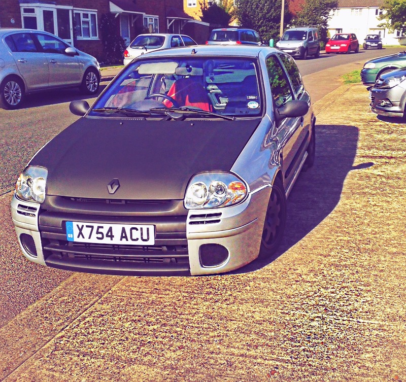

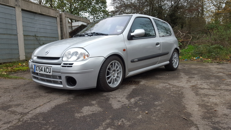

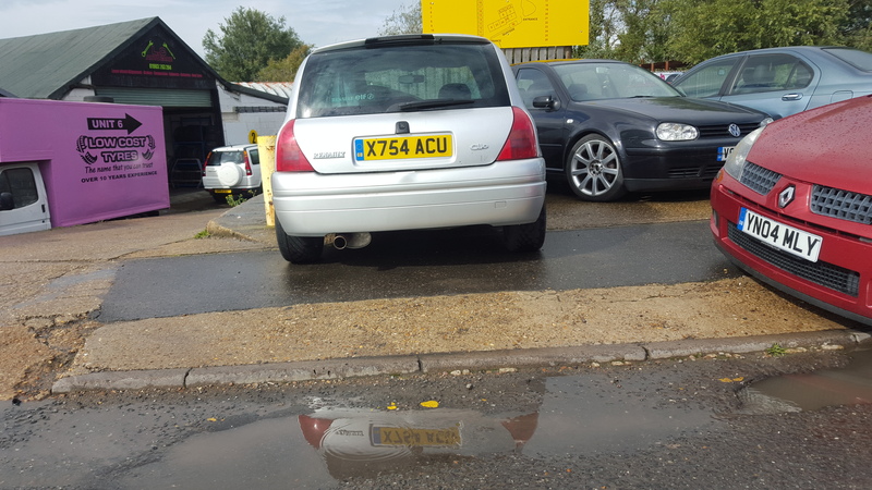

Sellers picture plus some of my own -

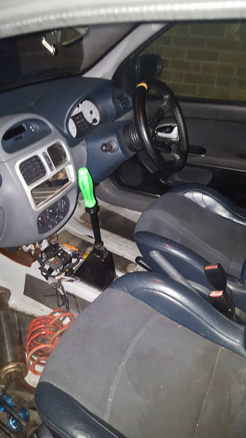

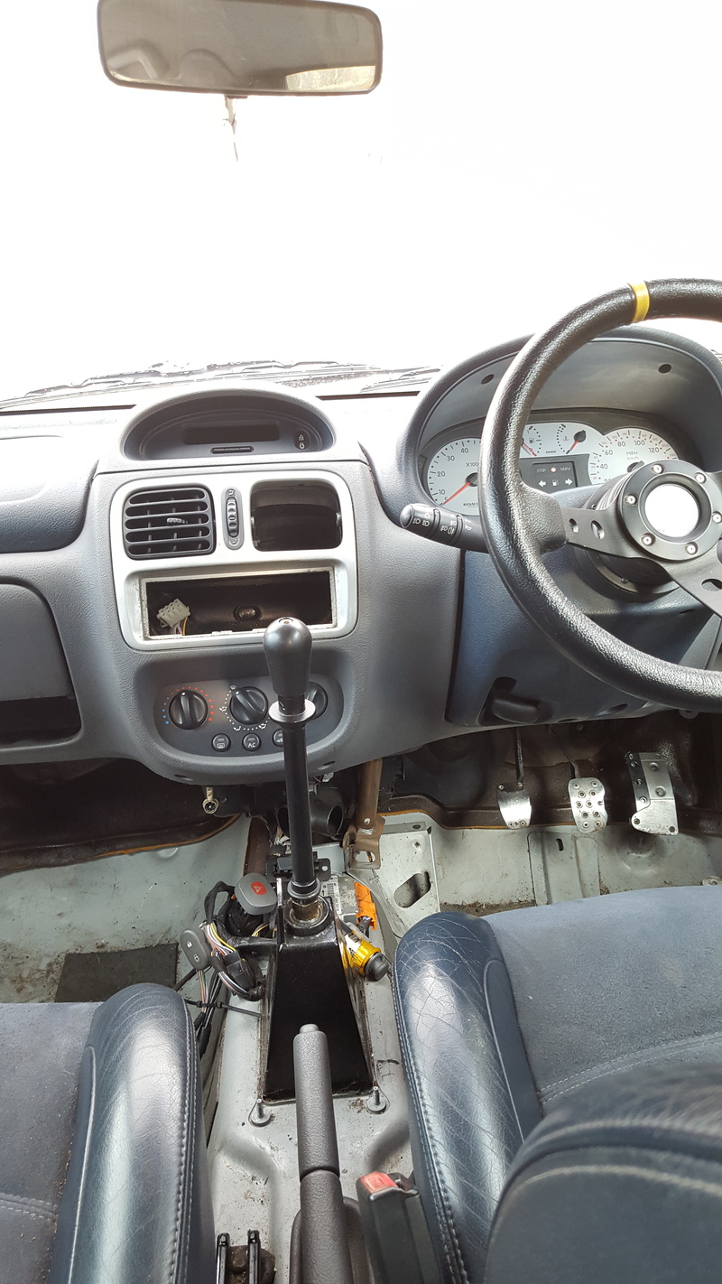

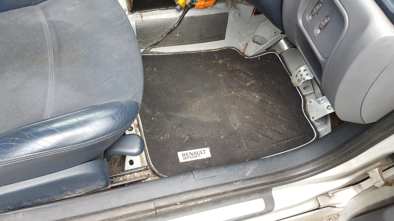

First thing i done was to remove the snap on handle from the gear stick and install the PMS gear knob

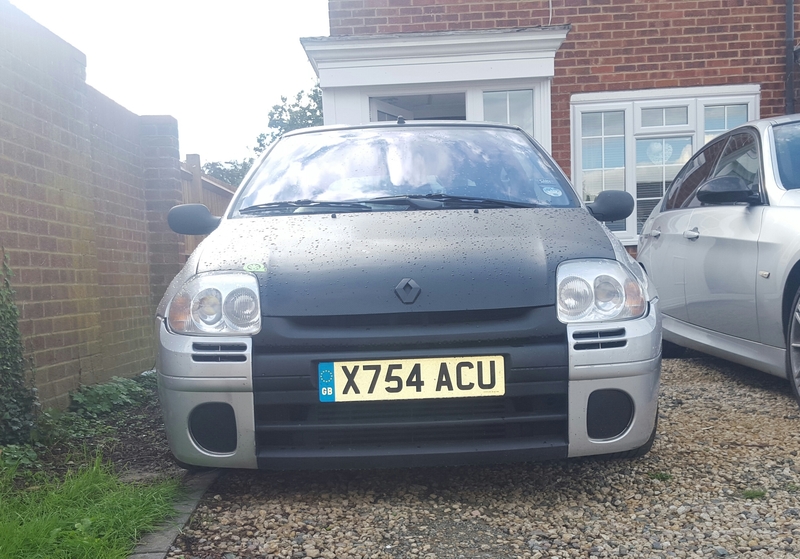

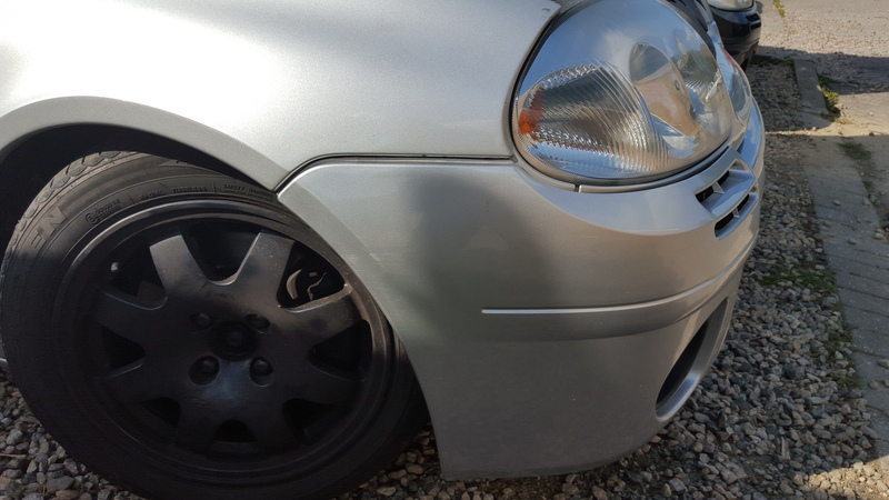

Today i bought a phase 1 that was local to me so i could swap over the panels that have been painted black (bonnet/bumper/grill) i was happy to find it had an aluminum bonnet! i swapped it over and put some silver wing mirror covers on that i had and it looks better already, ill do the other bits at the weekend
That's subjective, i think i got it for a very good price (i wont disclose though!) Hoping to have it all tidied up this weekend, i want to do the williams wheels silver but then im also thinking about putting some F1's back on it (i have 2 sets, well 10 wheels actaully!) going to put a carpet back in it and the plastics around the gear stick to make it more civilized!

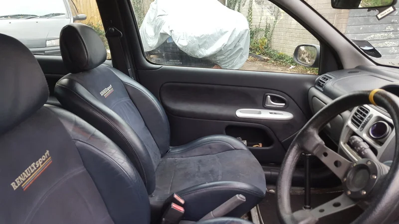

Picked up this exclusive to take some interior pieces from and possibly the exhaust, i will be selling the other silver one once ive swapped over the bumpers!

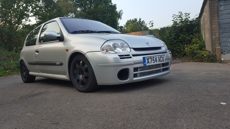

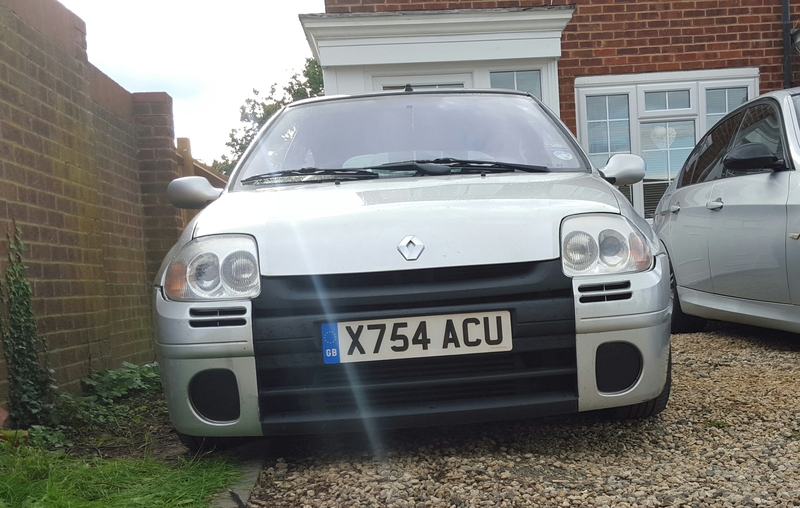

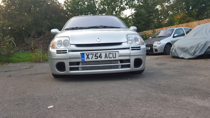

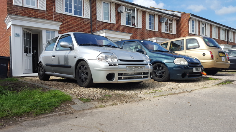

First i finished the front end swap
Form this
To this (i cleaned the intercooler to)

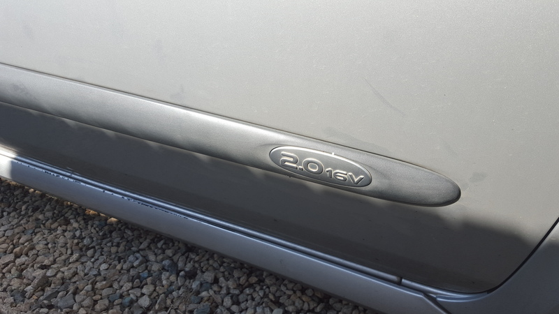

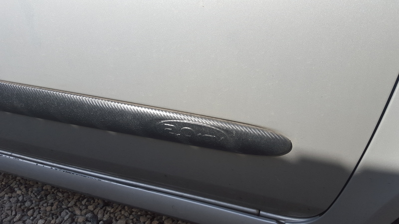

Got rid of these wrapped side strips for the ones of the exclusive which also gave me the rare metal badges

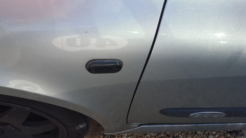

And changed these

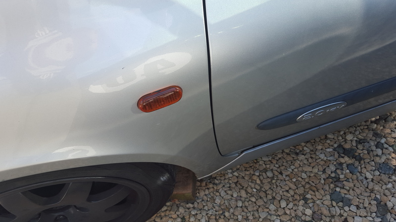

Orange side repeaters ftw! Car looks better. Really like ph1's on willy wheels. I actually thought the snap-on pry bar handles was very individual and different in a cool way.

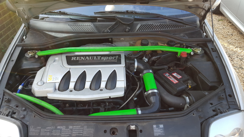

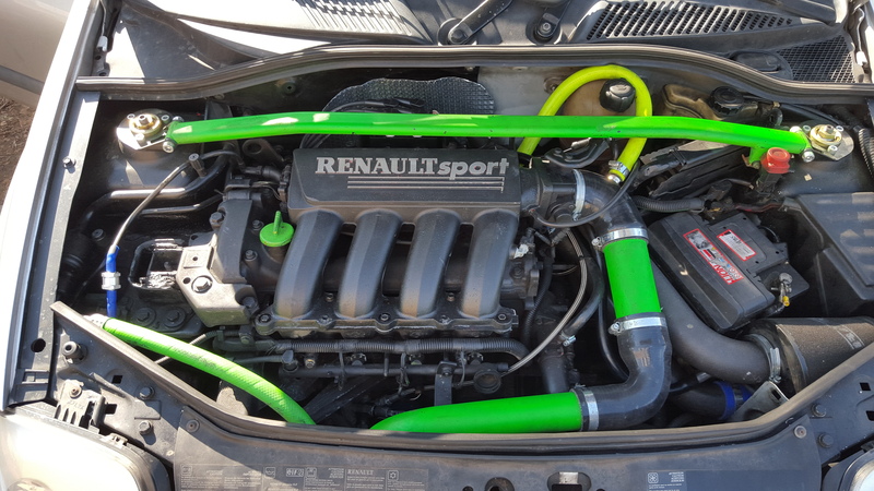

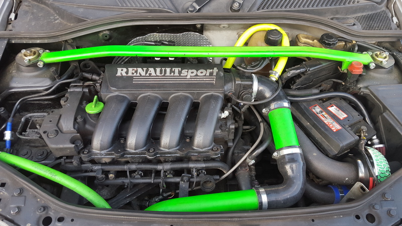

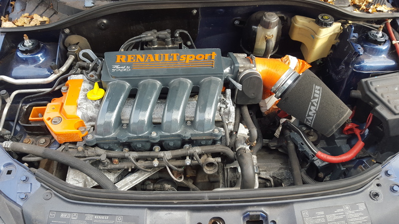

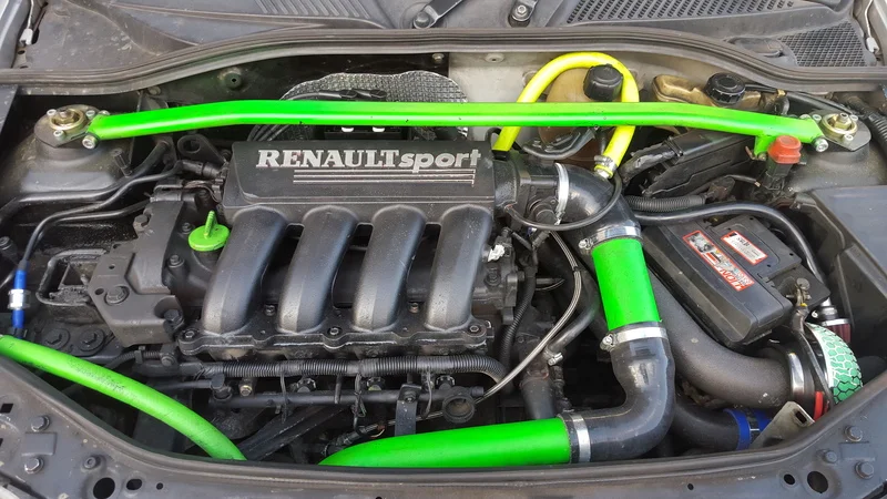

Had a bit of time yesterday so done a couple of little bits, took off the green icv hose and repalced it with an origanal black one that fits properly, also fitted an engine cover, and an origanal yellow oil cap, engine bay is never going to be concours but looks better! unsure what to do about the green parts tbh.

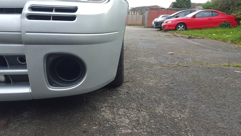

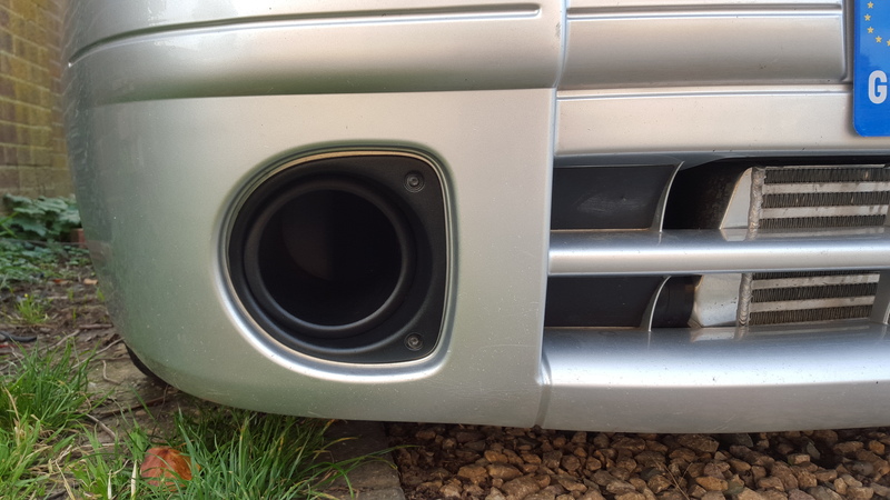

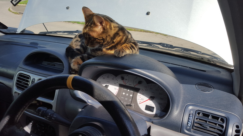

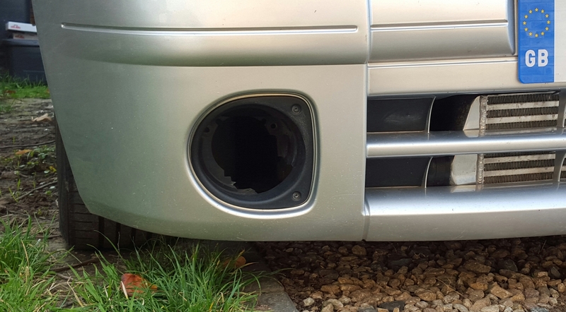

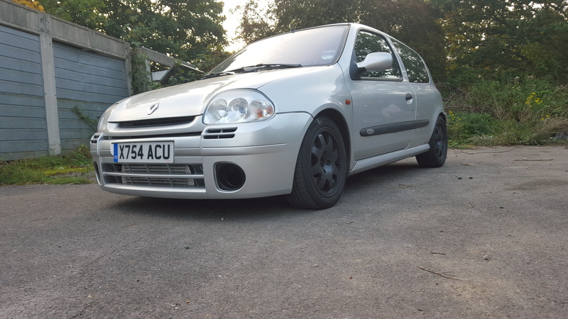

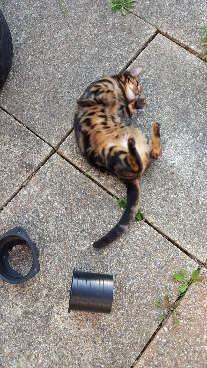

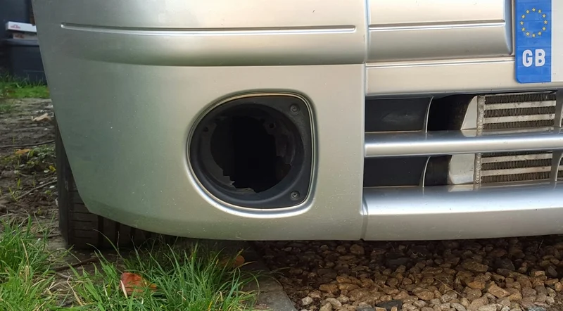

Installed these air ducts with 'help' from the cat, i'd actually prefer the fog lights but i cant fit the nearside one because of the intercooler pipe work but this is a good compromise!
And just a couple of generals

  Whichever has fuel
I have some fog lights if you want some? They're not mint but they work.

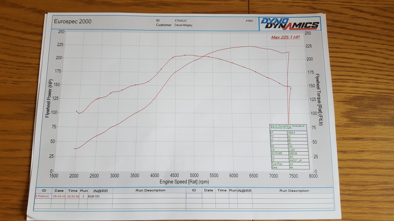

Looks a lot better now! Do you know how long it's had the conversion? Seems very road/engine friendly figures, bet it goes very well?!
I forgot i have also used the Exclusive exhaust and fitted the de-cat back on, will get a couple of pics later, conversion is around 8 months on there, goes well enough, its just what the 172's need tbh! ill throw a link up later for the ducts £3.50 iirc, need to trim back to the lip on the fog surrounds and then they fit in quite tight, i added some duct tape on the rear jsut to be sure they dont fall out but i dont think they would anyway!

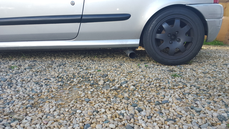

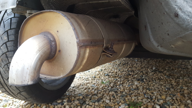

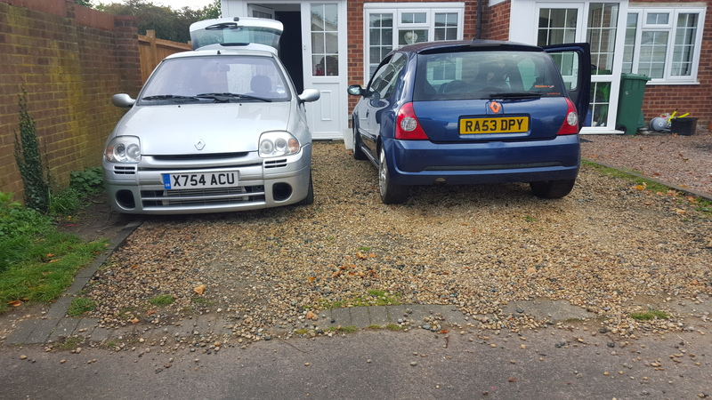

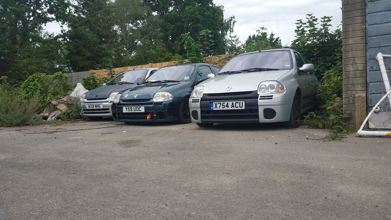

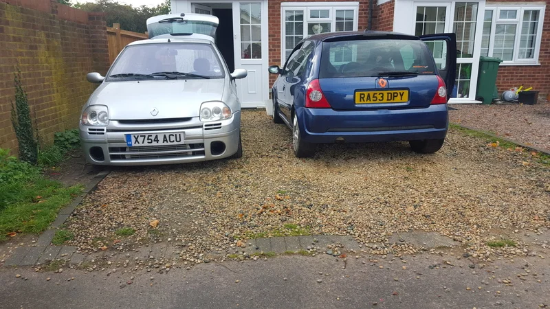

Ive had the second silver phase 1 172 for almost 2 months now, it was boguht purely to swap over the front end, i then bought the exclusive to nick some of the interior from it and the exhaust (the side exit on the turbo was to loud for me) the idea was to use the exhaust temporarily until i found a k-tec stealth as i had informed the 2.5 inch is perfect for my set up and i dont want to be hacking up my bumper.

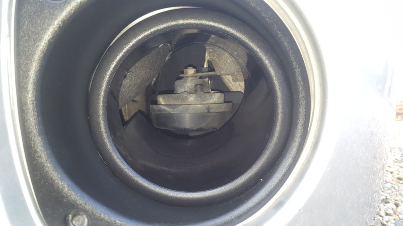

The turbo with the Exclusive's exhaust on it (powerflow, non silenced center, quite a nice system! 2.25")
There was a stealth that went on ebay for around £120 but had had the middle silencer cut out and looked like 2.25" section welded in - not ideal there is one for buy it now at £250 but i didnt want to pay that so just decided to wait until something came up.

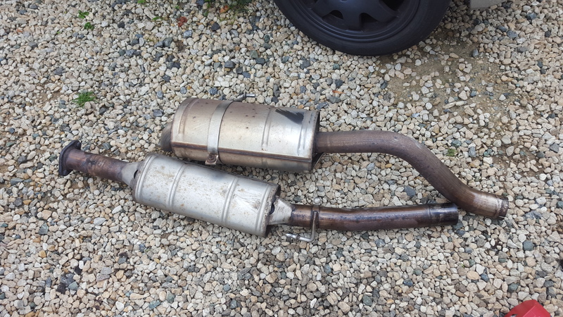

On tuesday i was swapping over the rear bumpers on the turbo and the other p1 as the one on that was better and i see this -
Yes, the silver phase 1 ive had outside my house for the last 6 weeks has the Exact exhaust on it i 'need' its got a silenced center to which is nice! (i didnt realise it had an aftermarket exhaust on it)
So pulled that off and swapped it with another system i have, and now the stealth ready to go on when i find time

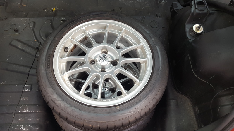

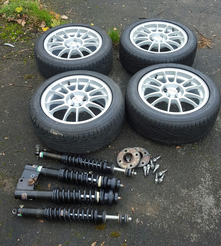

Yesterday i bought this Monaco 172, it was local, i bought because it came with some nice wheels and some brand new Gaz coilovers
im going to swap the coilovers over as mine has k-tec on the front, ill also take the dash and door cards from it and keep the wheels
oz superleggera's my favorate wheel tbh!

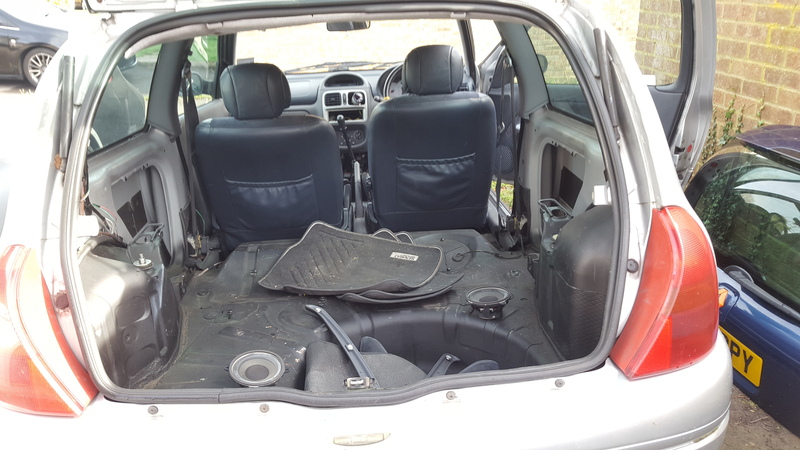

Apart from some rear seats and possibly some proper track tyres, i have everything i want to finish the car off how i want it!

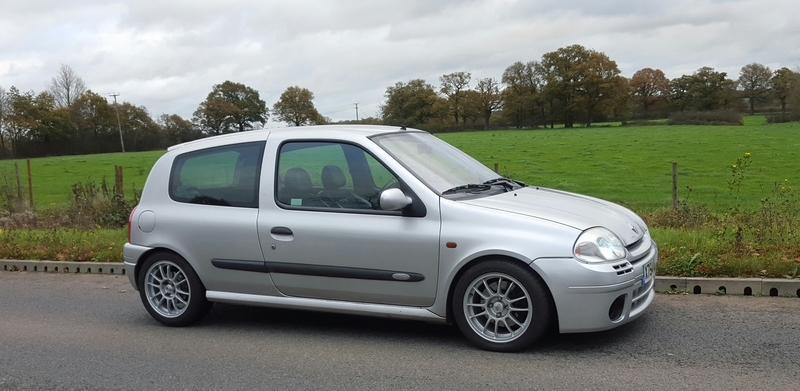

Got a lot of stuff done yesterday

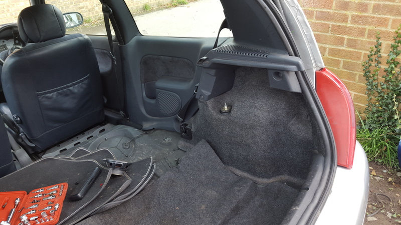

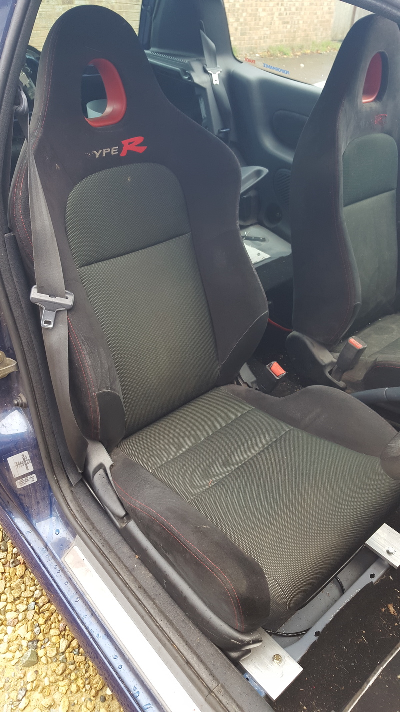

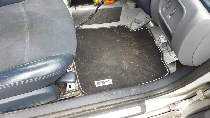

Full phase 2 plastics and belts fitte including original phase 2 172 mats (need to source a carpet as the phase 2 carpet i have has been hacked up, also need the rear seats, possibly full phase 2 seats if i can get some at a reasonable price or a whole car to get them from!)
and heres the stuff ive been waiting for a while to fit and one of the main reasons i bought the monaco 172

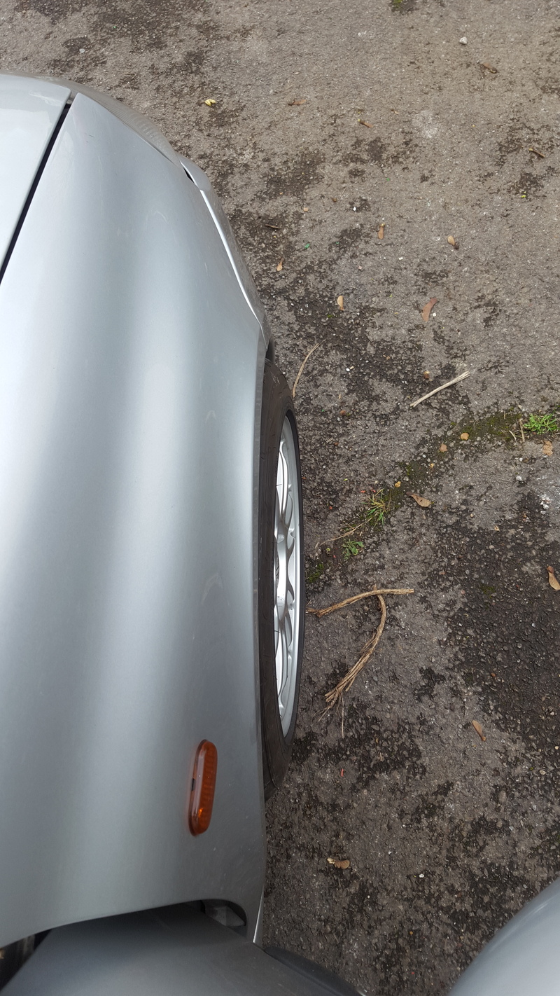

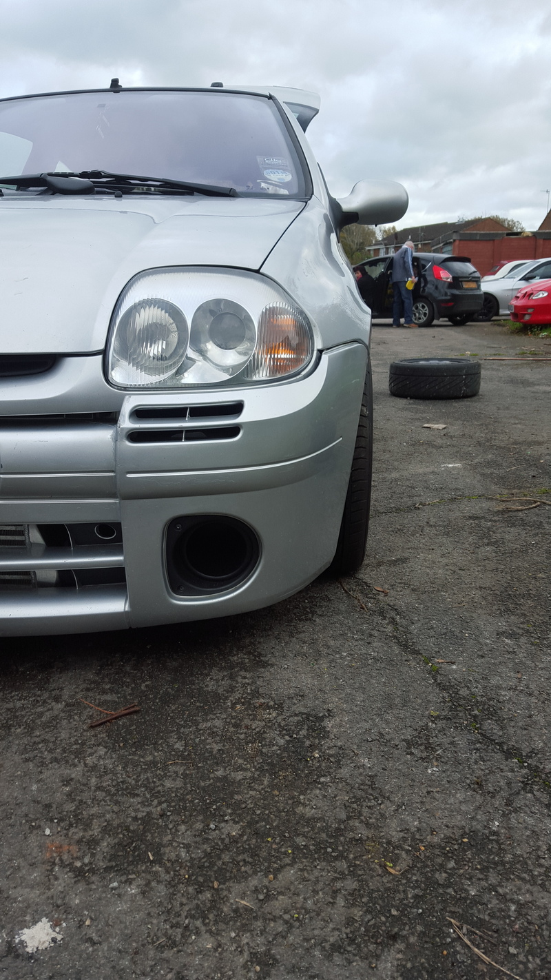

Before spacers
After -
Set the heights up as i wanted and happy with how it looks and rides, just need to get the camber setup up properly
