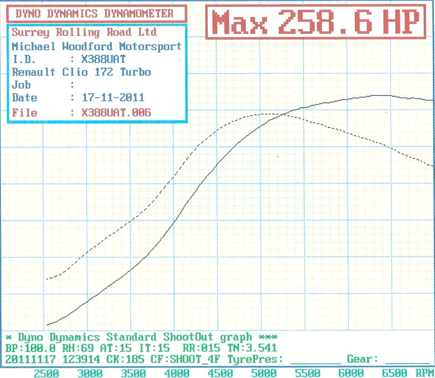

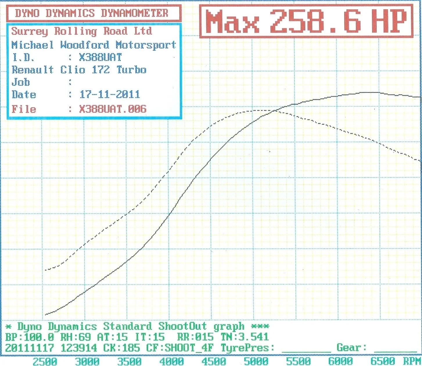

Here is the graph from mine when me and Mike first Mapped it:
When he built Jacks car (now mine) in the first place as a demonstrator Mike deliberately stuck with a really tired old bottom end that he had when he did the conversion as he wanted to be able to proove that the standard internals were good for it. One of the bores actually has a fairly significant visible score down it, but Mikes logic was that if it prooved reliable on a bad example of a bottom end like mine, it would be a good test for a less tired one like most people have.
Had done over 100K when the conversion was done, has done another 9K or so since now, including use on track, rings are really starting to be past their best now as its breathing quite heavy, but its still going strong and in fact Im running more boost now than I was when I did the initial mapping from that graph.
Bear in mind though that the standard pistons are quite poor production standards, so you might get unlucky and have one with an imperfection in the wrong place, its a little bit of a lottery with these engines as mentioned in the thread already, but if you keep the compression quite low like mine the peak cylinder pressures arent actually any higher than on the standard engine I would wager despite the higher power output so I dont think the pistons are as likely to fail on a turbo conversion like mine as they are on an ITB conversion IF (and its a big IF!) its mapped appropriately, as the turbo means you dont have to push the boundaries on the map looking for every last BHP like you tend to be doing on an ITB car.
