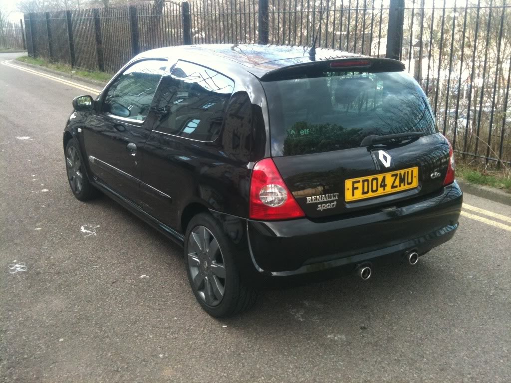

This is the story so far when i came back i was still using it for 2 months untill i bought a 306 dturbo as a work horse so the project began from a standard 182.
here is the car when i had it

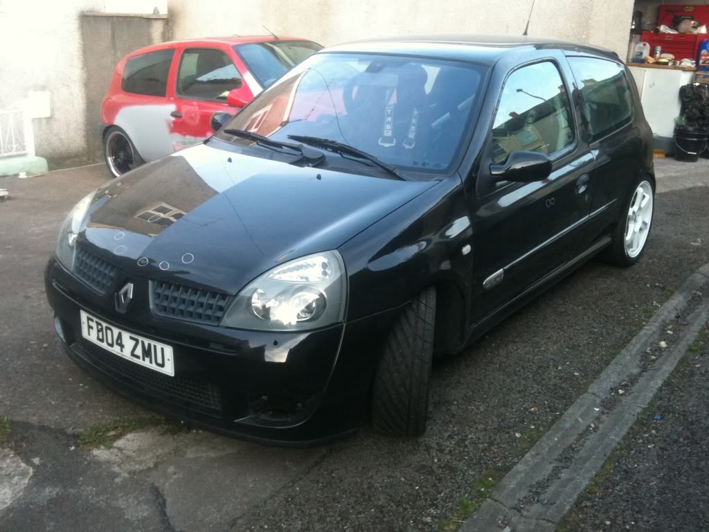

After stripping the complete interior bar dash and selling it along with the wheels i then began searching for bits. In the process off getting the bits i prepped the interior ready so hammerite'd the front foot wells welded motorsport harness brakets and seat runners then sprayed the interior black

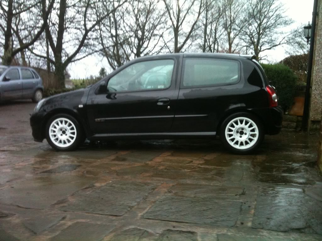

1) Inovit wheels 17" fitted them with yokohama prada spec2

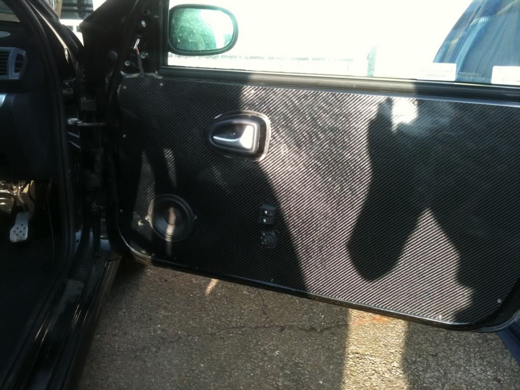

10) Carbon fibre door cards front and rear

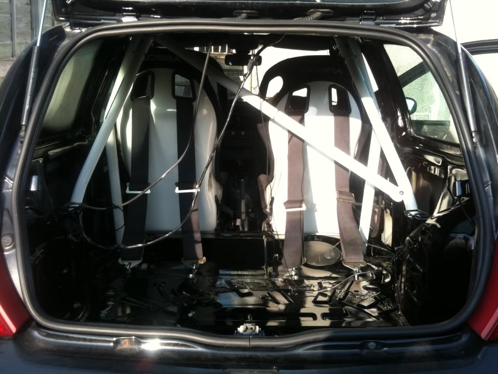

11) Ktr Bolt in roll cage stripped and painted white

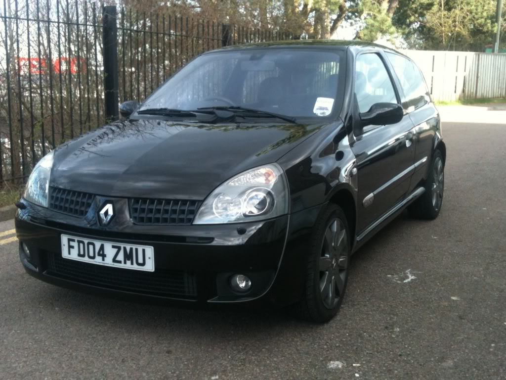

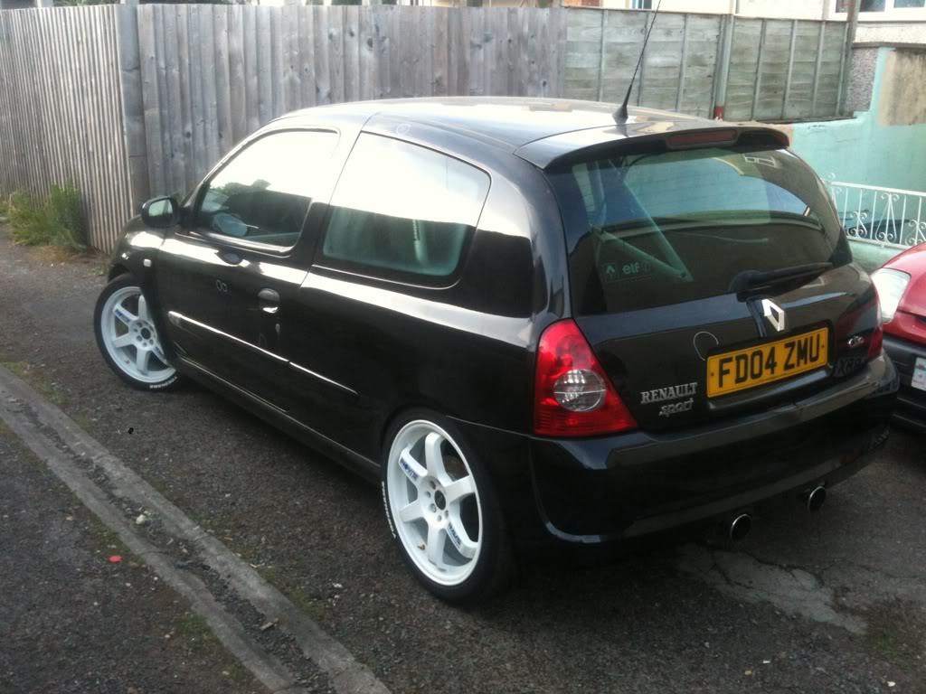

Here is some pics its not finished yet but almost there
Im waiting for the car to be fully resprayed in black then ill be doing this along with other stickers
If i forgot to mention things ill add and keep you updated
any comments or feedback welcome

Overall I definently like where you are going with it. The only thing I can't get on with is the size of the wheels for a track car, but as you have previously stated its due to the brakes

Unless you have 400bhp, you wont need the brakes anyway lol. Just bosh some normal Wilwood/Hi-Specs on there (although you dont really need them either), & fit 15's.
The handling will be considerably worse on the 17's.

Looks sweet! Love the door cards but hate all the stickers!

Those wheels are awesome just too big :(
Set of lightweight 15/16 ti keep the unsprung weight as low as possible!

I know I was going to cause a big debate on the brakes and wheel size I've gone for,
The brakes only cost me £500 second hand with new disks so couldn't turn them down. As for the wheel size there lightweight wheels anyway inovit st-vi weighing only 9.1kg each ok there 17" but does anybody know what size they was using on cup racer cars?.
The car originally had 16" running 50 profile tyres so effectively in me reducing the profile to 40's will allow me to go up in size but still having the overall diameter off 16" with the tyres.

put some 15" wheels on there, 17" look silly on a clio and will make the handling worse!

17" ain't as bad as you all think, If they are that bad why do they use them on the cup racers now infact why do any race cars use 17" and not go the smallest size they can.

clio cup racers are a bigger car now, bigger footprint, maybe thats why they do? old clio cups ran 15s. car looks good though i wouldnt go down the sticker route

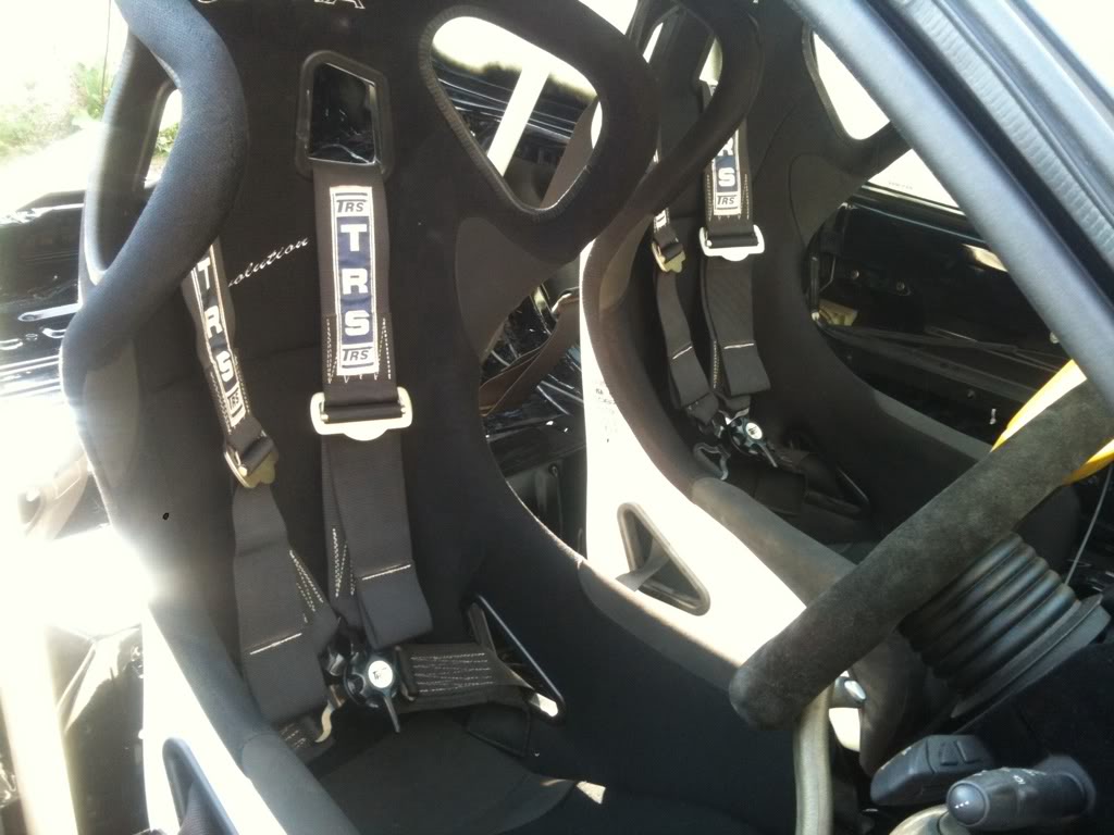

Same seats as I've got. How do you find them around the hip area? Maybe its just my fat ar*e! lol
Also, see the debate about where to mount your rear straps on my project thread. Accoring to the info from Tony, where you have yours just now is a big no no in the event of a crash!

Cheers mate the sears are very comfy which surprised me would defo recommend them to any1 :)

The seats are awesome im 34 waist but I like tightish fitting seats anyway so I've got the normal and passenger has the Gt.
I was going to use the standard rear mount point area but drill another next to it but after removing the fuel tank I noticed it was in a strethening bar :(, Why is it a big no no where I have mine now then I've padded the top off the tank so it can't rub and I've also checked the clearance and it's all fine.

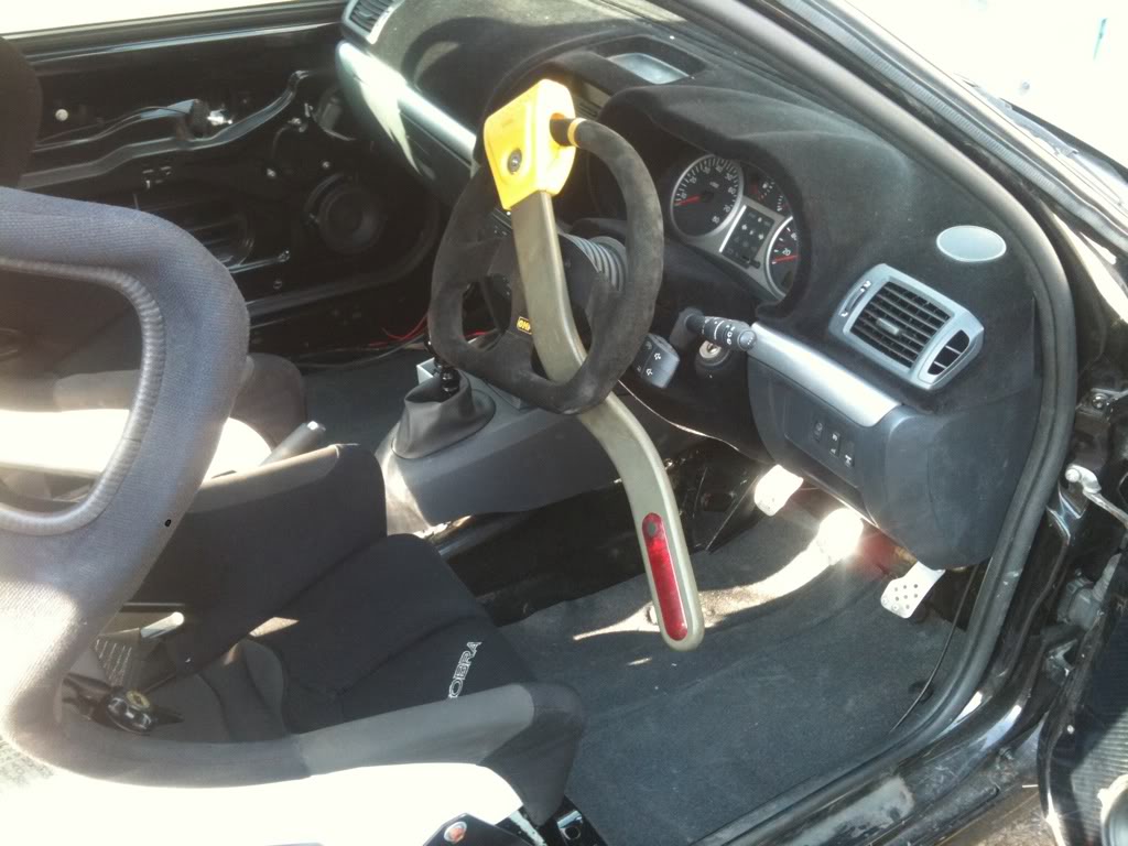

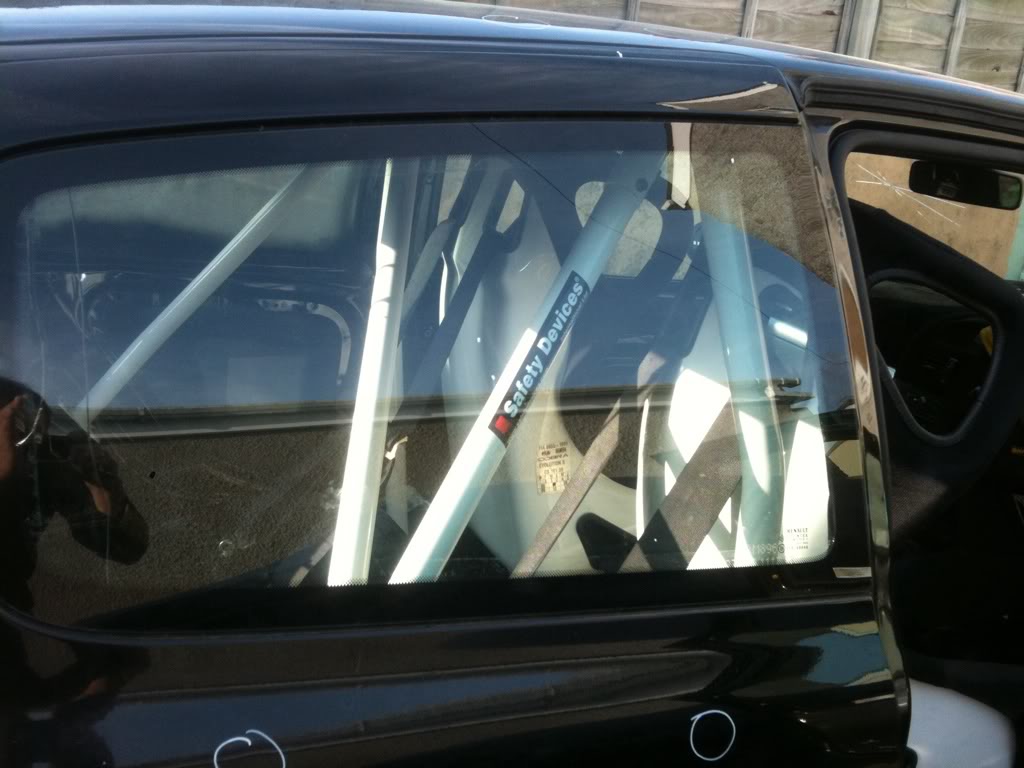

looking good mate, might want to think about welding a harness bar to the cage though??!!
understand why youve gone for big wheels to fit the big discs but the standard 280mm are more than big enough with 4 pot calipers.
15" wheels are tryes are a much cheaper as well as better ;-)
I was going to look into welding extra bars on even getting a front half made up but at the mo I wanna get it road legal and sort out the teething problems first.
the angle of the rear strap has to be a maximum of 20 degrees from from horizontal down the way.

poor choice of steering wheel/stickers/17s :(
the steering wheel isnt that bad , it used to be mine , maybe a bit to small for the hands as there wasnt enough grip for me , but everyone to there own it all depends what someone else prefers ,
