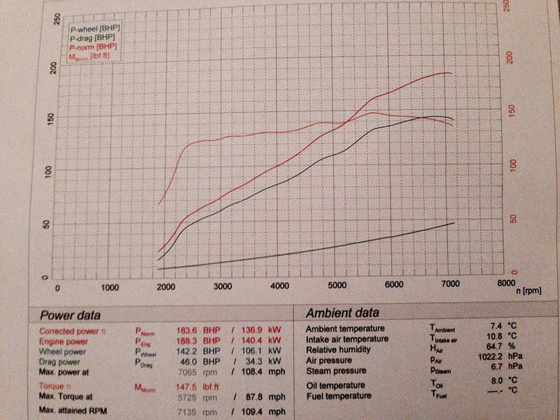

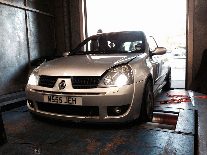

On Saturday afternoon I went along to the rolling road meet at Tipton Garage in Exeter with the SouthWest CS guys.
I haven't done too much performance wise so far other than a full Scorpion RS192 exhaust with Decat, Matched Inlets and a ITG panel filter but I thought, what the hell, I would like to know that the car is nice and healthy so went along!
I'm glad I did, it was a great day out and I met a few new faces which is always nice.
I was hoping for anything over 170bhp and thankfully I wasn't disappointed!
Snap on the rollers:
Rolling Road - Tipton by Lawro1988, on Flickr
Rolling Road Print-out:
RR Print Out by Lawro1988, on Flickr
Pretty healthy result at 183.6BHP corrected and 147.5lb.ft so all is well!

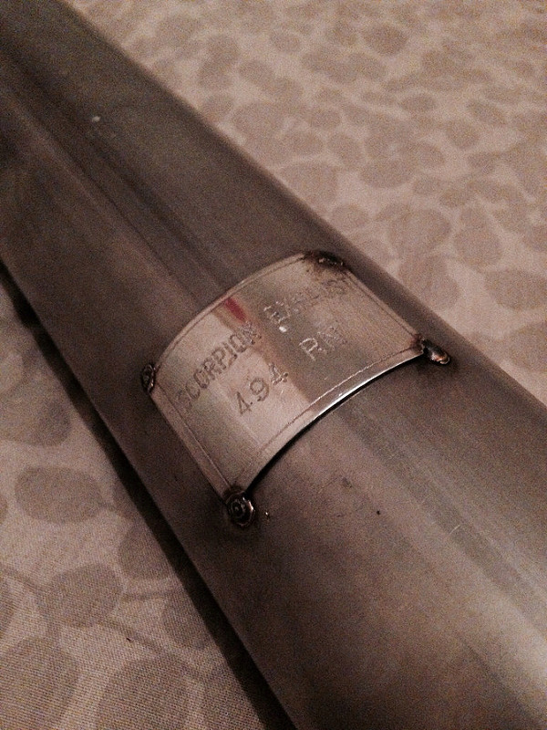

On the way home, I popped in to see my good friend Leighton who noticed my exhaust was blowing upon arrival.
Got the car up on the ramp and it became evident that my centre section had cracked at the weld around the join on the box. Unfortunately, no photos of this but he welded it up as a temporary measure.
On Monday I called Scorpion to discuss the issue with them. They advised that the exhaust is protected by a lifetime warranty and they would send me a new centre section straight away.
Sure enough, the next day it turned up and they have sent me the brand new revised section which features a new much narrower silencer. Hoping this should stop the original issues they seem to suffer with as the centre box seems to hang pretty low down and is easy to catch on speed bumps etc.
Scorpion Centre Section by Lawro1988, on Flickr
I also bought a new cat fitting kit from Adam at Wolverhampton Renault as good measure.
Fantastic service from Scorpion, I was extremely impressed with how swift they were and no squabbling at all! The new section

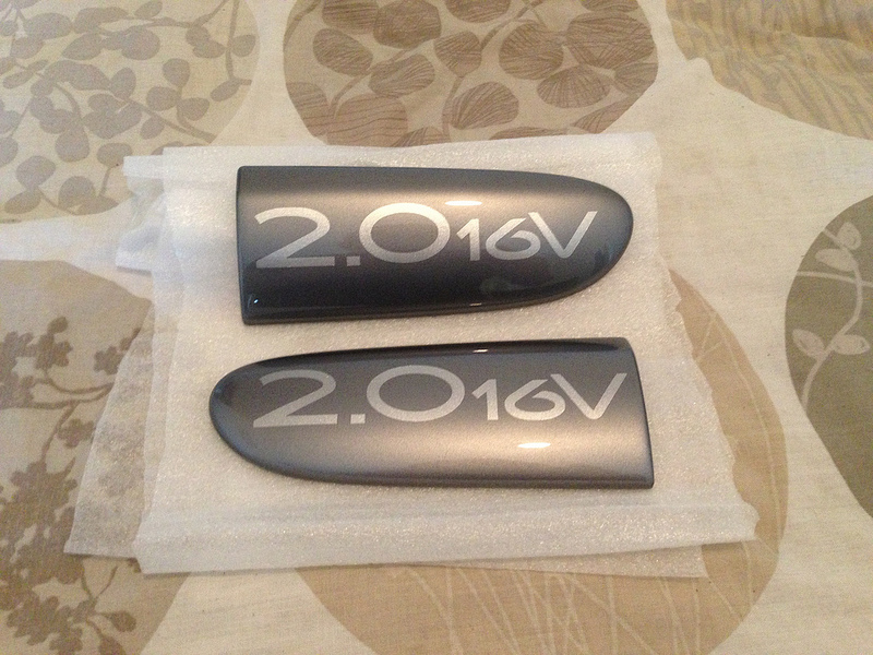

The car was fitted with some anthracite coloured bullets which were looking very tired and weren’t the best colour match so I purchased some of Sprayshack’s smoothed bullets in cup ‘205-110’ anthracite with Titanium Silver lettering.

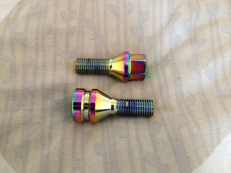

TPI Polarised Bolts by Lawro1988, on Flickr
Sorry im being lazy.. But where did you purcahse both of these items from? Do you have a link or anything?
Any help would be appricated!

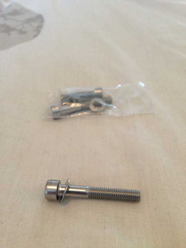

I get at least a PM a week asking about bolts etc so I might as well add it to the thread lol!
Bolts are TPI Polarised, the size you need are 12x1.5 with a 28mm Length. I purchased mine from Demon Tweeks over the phone when I bought a few other bits but you can get them from various sites online for around £70.
The bullets are from SprayShack, however he has stopped trading at the moment so I am unsure if you will be able to purchase them any longer.
Hope that helps.
Hope that helps.

Oh I like the look of that revised center silencer, mine slightly split at the weld but I siliconed it.
Being smaller I'm wondering if the new silencer will sound slightly raspier? If you know how much it cost even though they replaced FOC could you PM me?

It sounds a lot better, it's slightly louder and much raspier, especially at lower revs. I also noticed it seems to run a lot better on cold start than it did beforehand.
Its £150 delivered for the centre section, that's what it states on my invoice anyway. If yours split I would call them mate, I am confident they will help you out. Their Customer service is the best I have ever encountered.
Thanks :) I've sent them an email being honest that I bought the exhaust second hand so understand about the warranty but asking if they can help me in any way, £150 was sort of what I was expecting so if they cant I still may take the plunge.

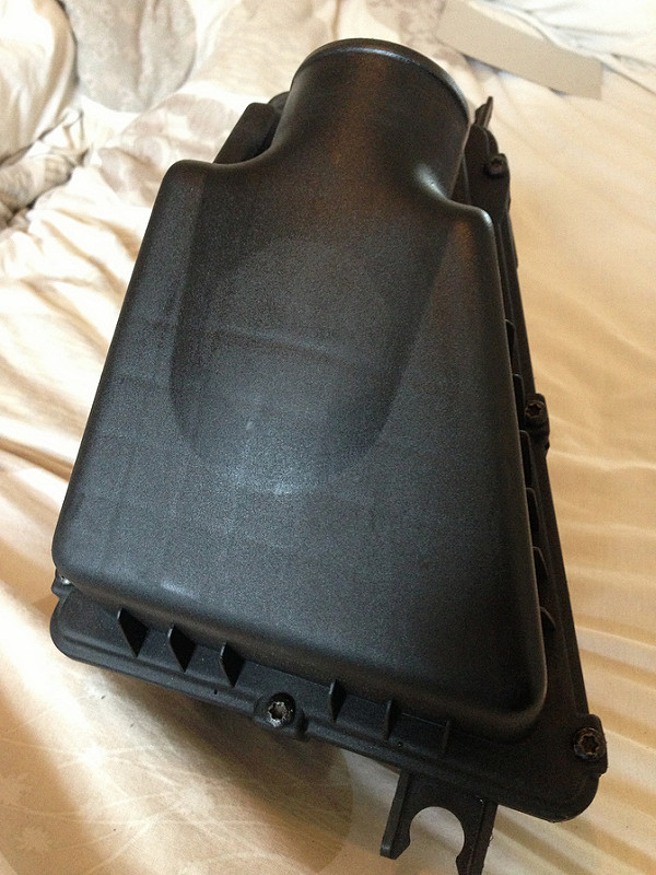

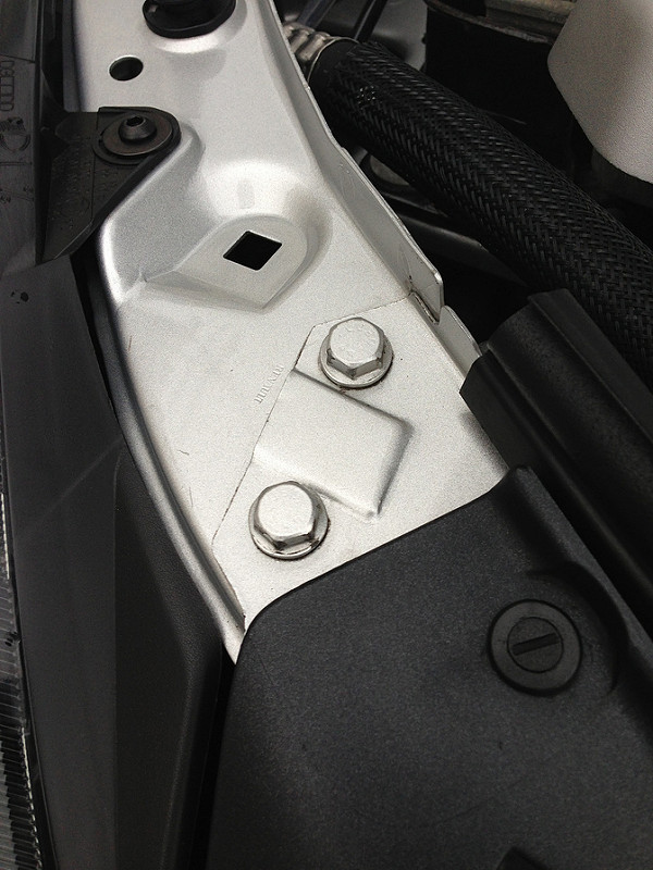

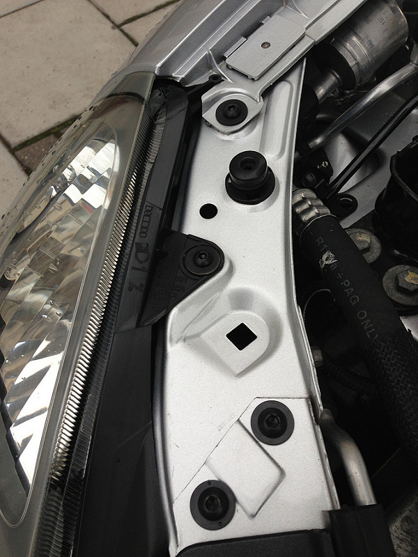

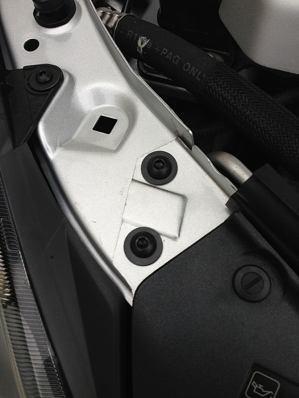

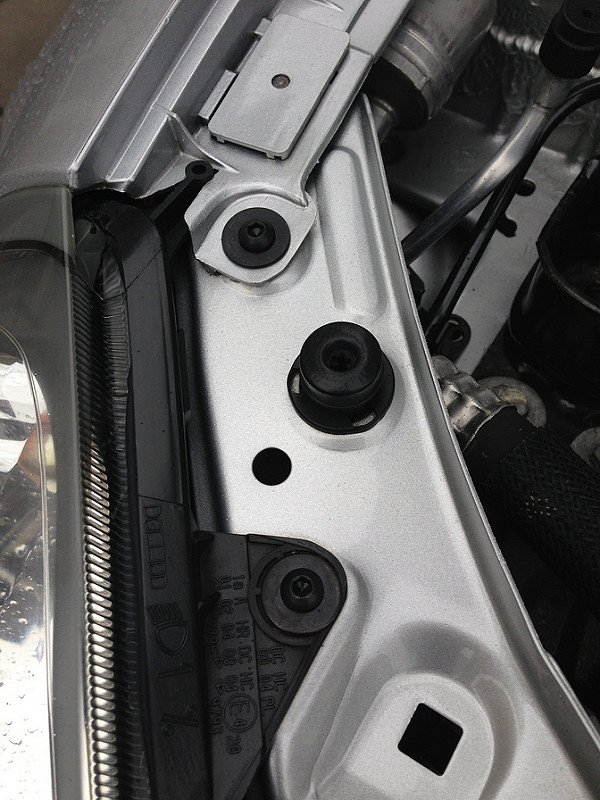

I then decided to replace all the bolts with stainless items. I replaced the slam panel, headlight and wing bolts with stainless black items and the airbox, fuel rail and engine cover with stainless steel bolts.
Stainless Airbox bolts by Lawro1988, on Flickr
Stainless Engine bolts by Lawro1988, on Flickr
Headlight/Slampanel bolts by Lawro1988, on Flickr
Before:
Before by Lawro1988, on Flickr
After:
After by Lawro1988, on Flickr
Before:
After:
Complete:
Complete by Lawro1988, on Flickr
Before:
After:
