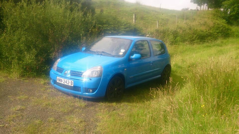

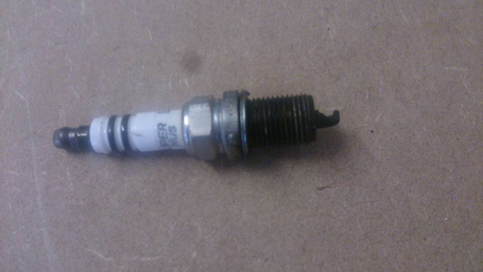

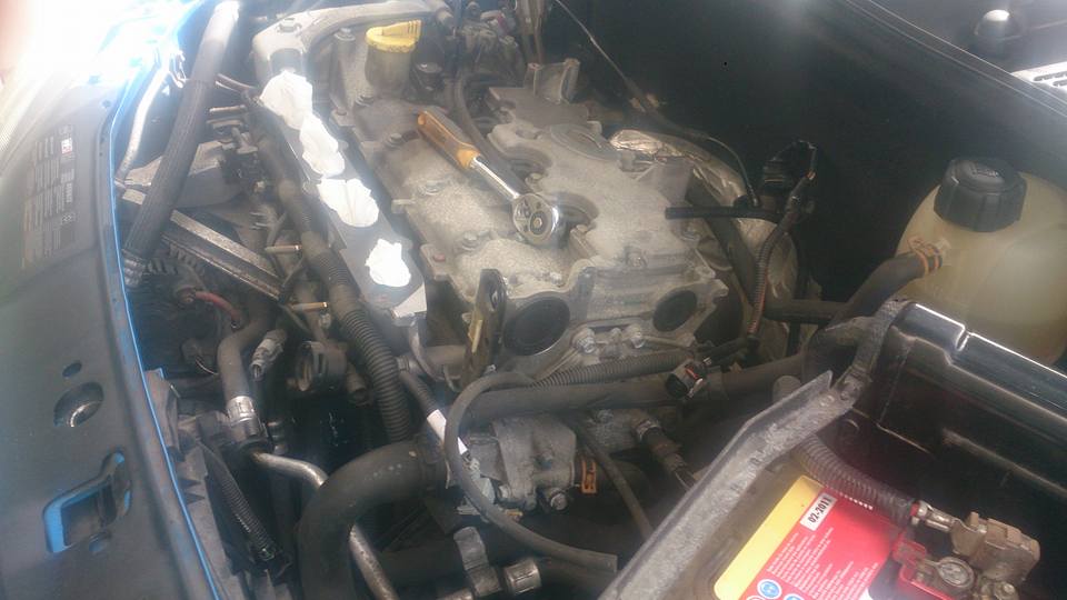

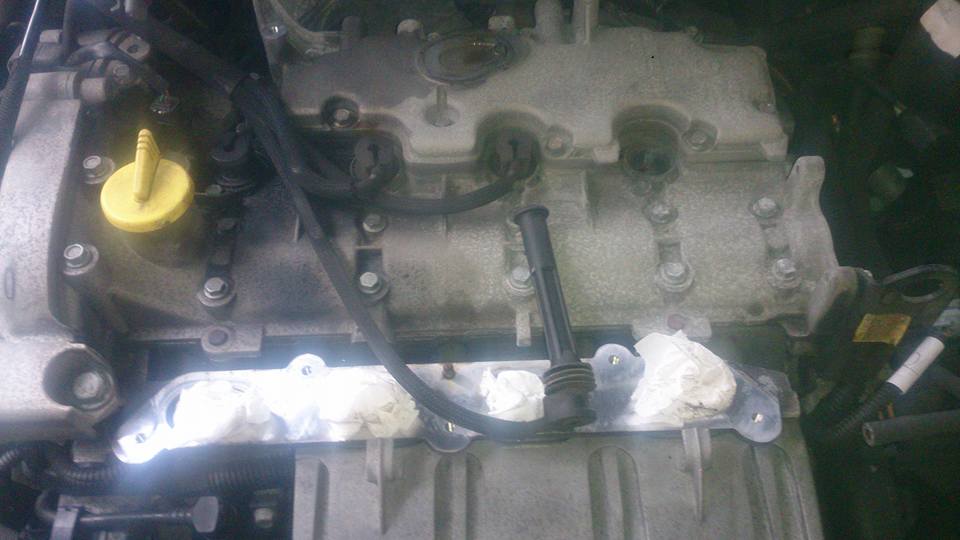

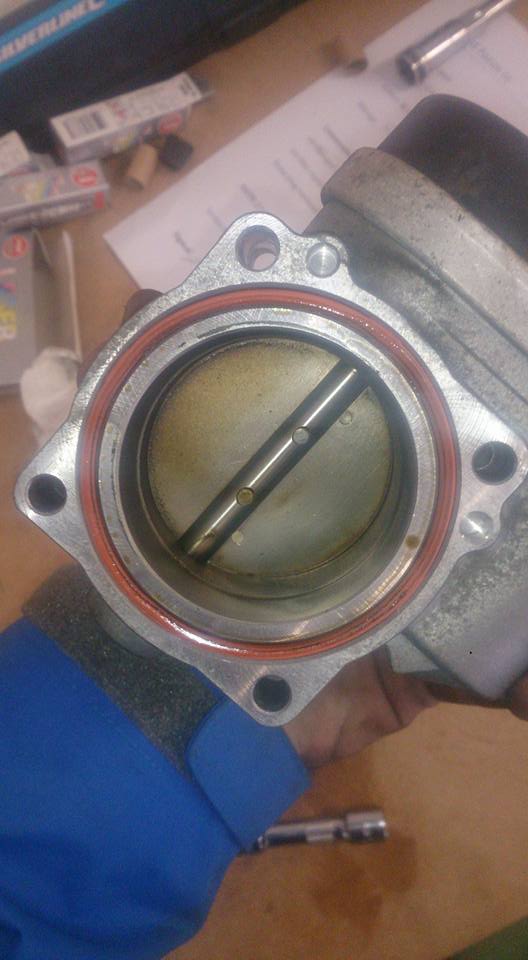

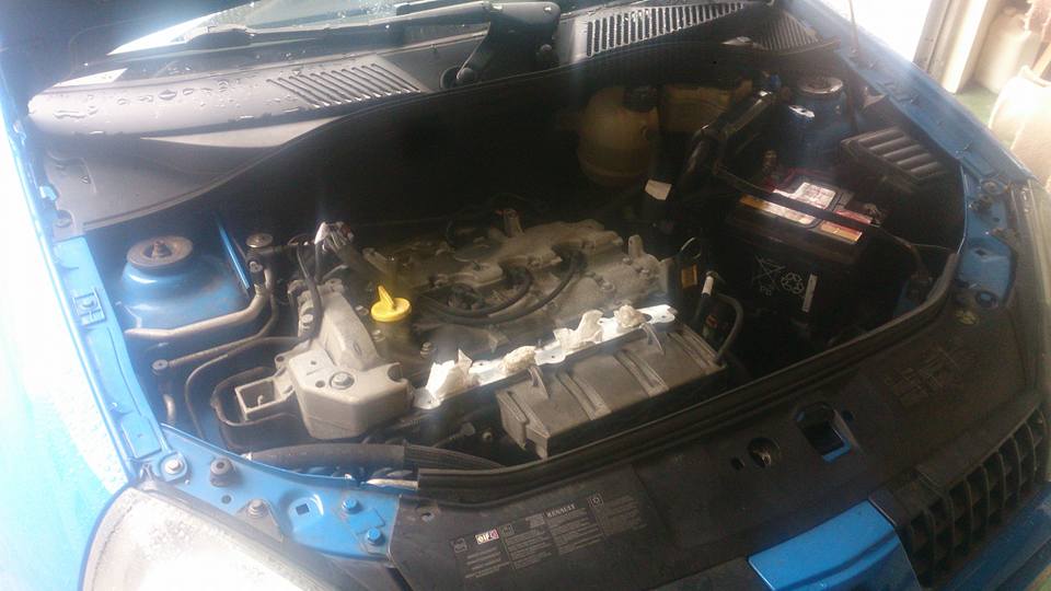

First of its a racing blue 182, on the Isle of Man with 96,000 miles on the clock. I changed the spark plugs today and cleaned throttle body so i will include the pictures of that into this post.
Please comment with your thoughts and ideas, would be greatly appreciated. :)

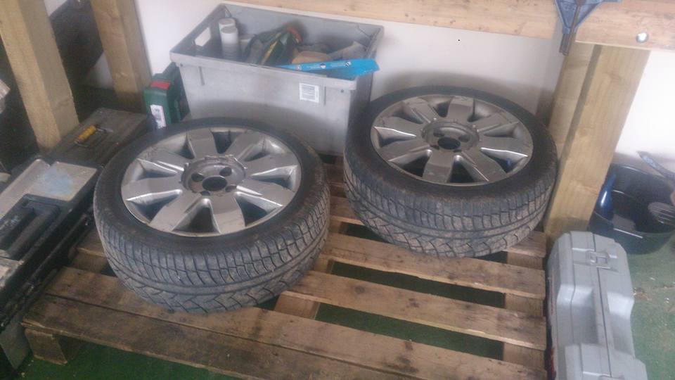

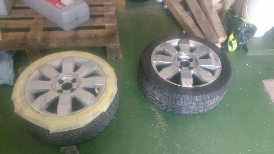

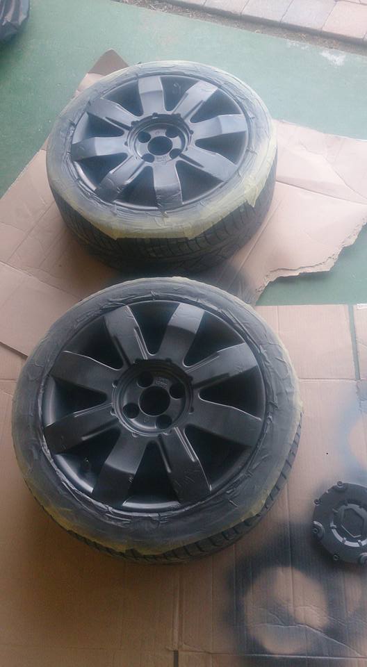

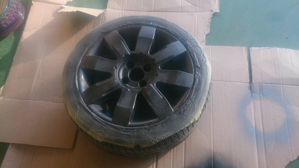

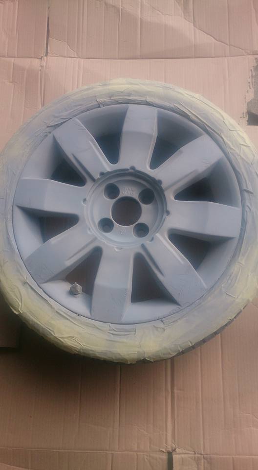

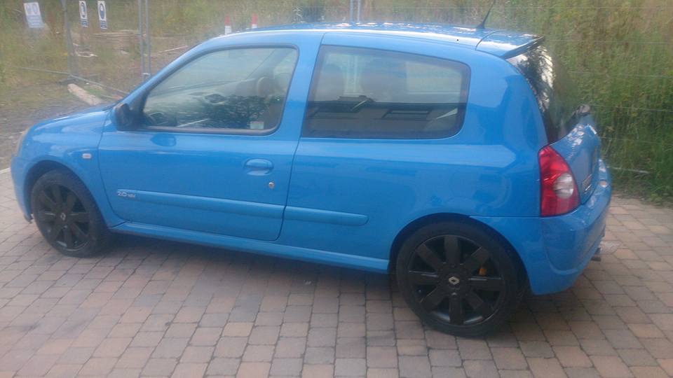

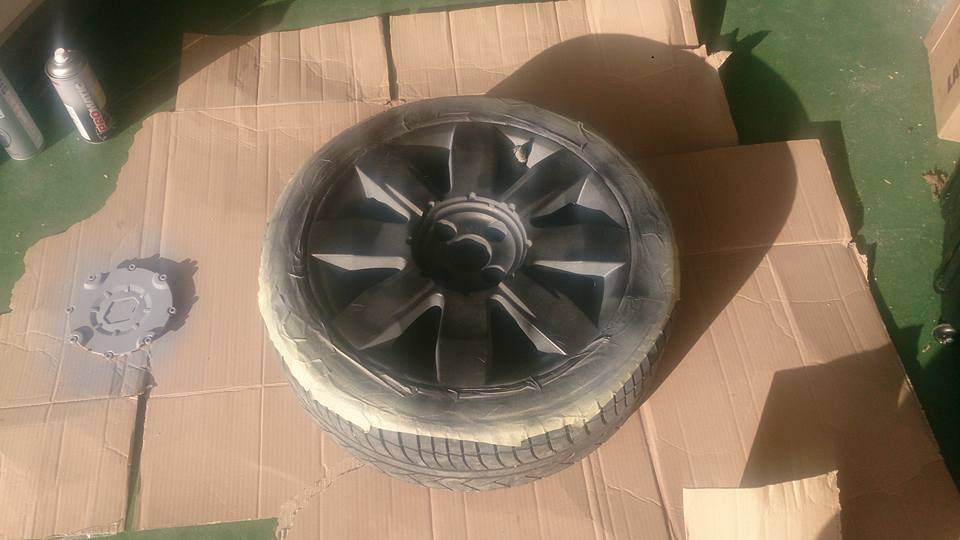

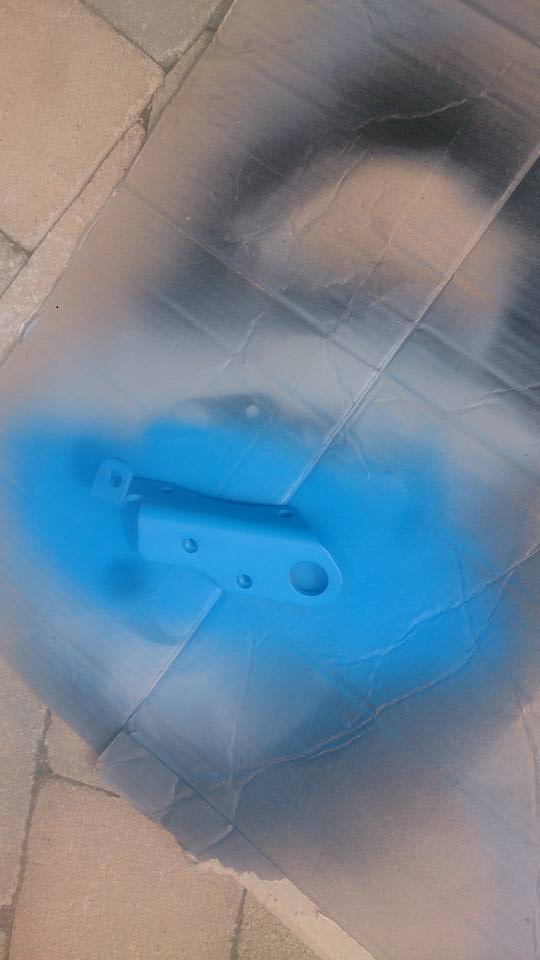

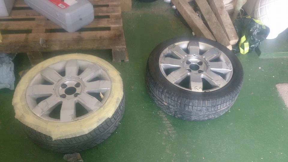

Ive started to refurbish my alloys, im going for a Ford graphite grey. Never done this before so it's all guess work with prep etc. My alloys have some very nasty marks on them that would be near impossible to get out with sandpaper, i have done my best, with the primer on now they have improved an awful lot.
i'm not looking for flawless results but im looking for the best possible finish that i can do as a DIY project. Pictures below.
primer on, marks still visible a bit but far better than before!
  vectra+clio172 cup
didn't take you long to decide to do them fella!
Fair play, looking good, when I did mine I remember when you do the black paint to redo every 15-20 minutes when it's still tacky-ish. Good luck, I'll have to see the finished product in the flesh.

Had to do them, from seeing yours yesterday, i knew it was the colour i wanted... few more pics of progress below :smile:

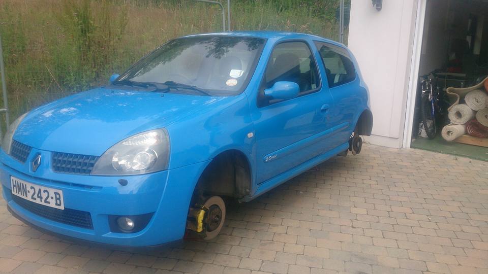

I'd reccomend some new springs mate, Eibach Sportlines or Cooksports. Your running an enormous arch gap at the front. Non cup pack suspension by the looks of it buddy.
would love to mate but with money being the problem its going to have to wait. I plan on lowering it, not such by how much yet. I plan on giving it a full detail valet at some point with a new cat back scorpion exhaust.

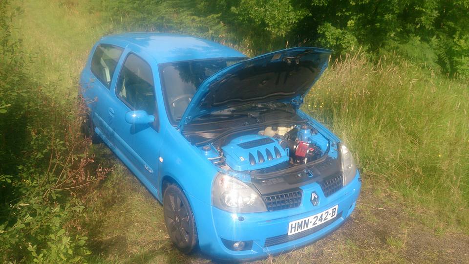

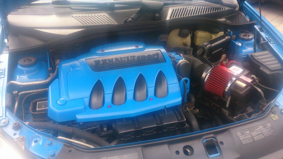

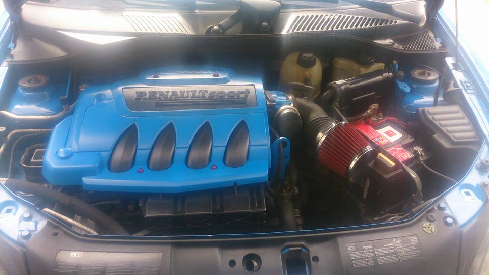

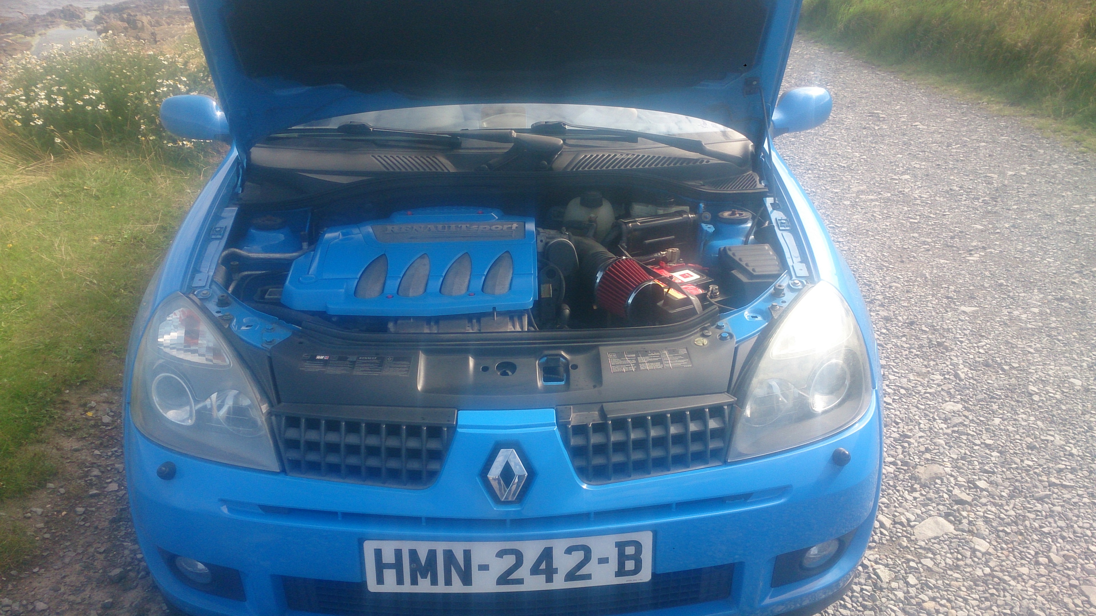

I have sprayed my engine cover the same blue as the car, next job is perhaps a black finish on the intake and Rail guard?
Ive touched up a chip on the front bumper, im hoping it will blend in with a polish once paint has cured.
Pic of Engine Cover.

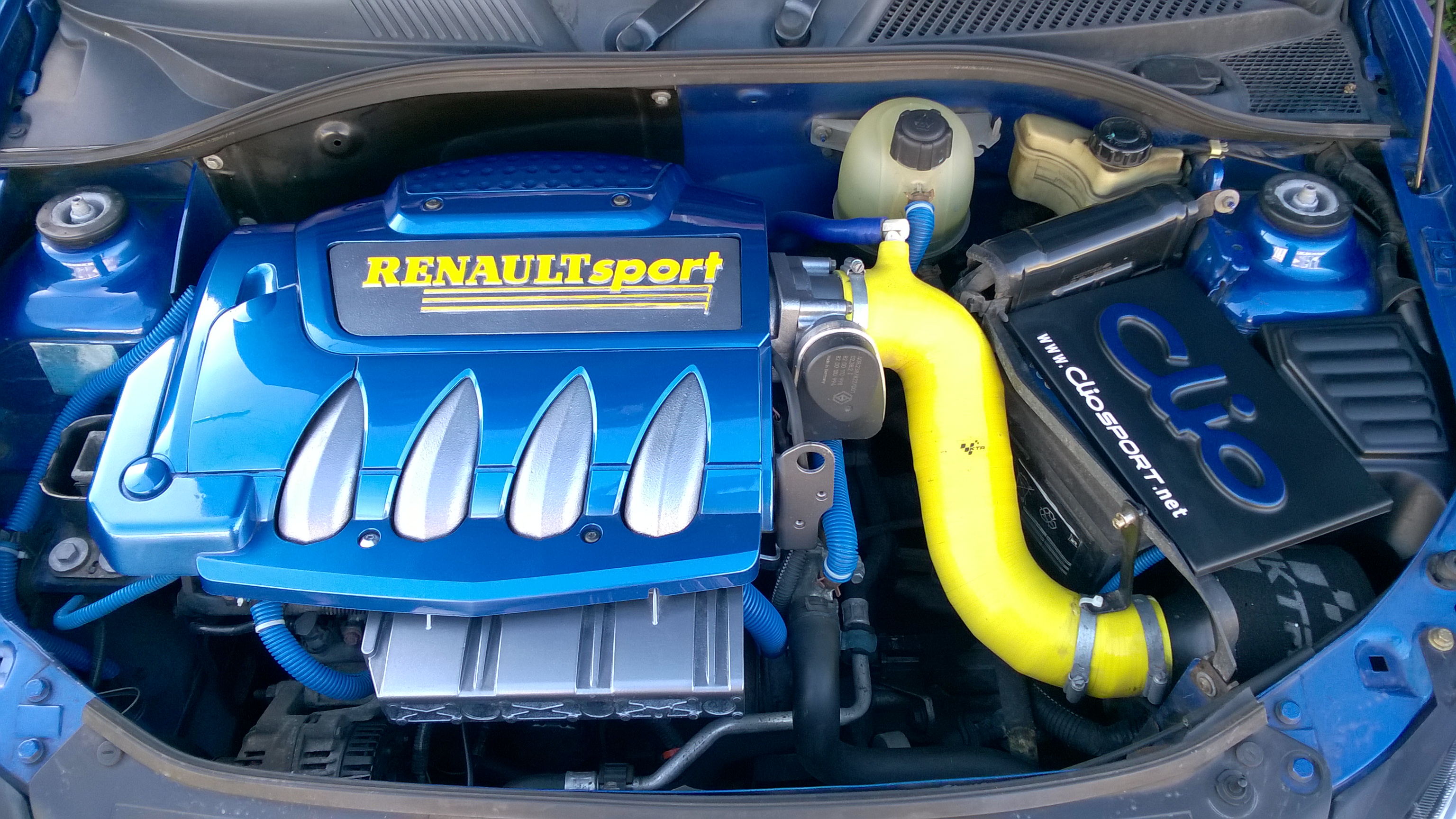

That looks ace, how did you paint the lettering yellow? I think Black would look good on mine with the lettering yellow?
  Clio 2.0 182

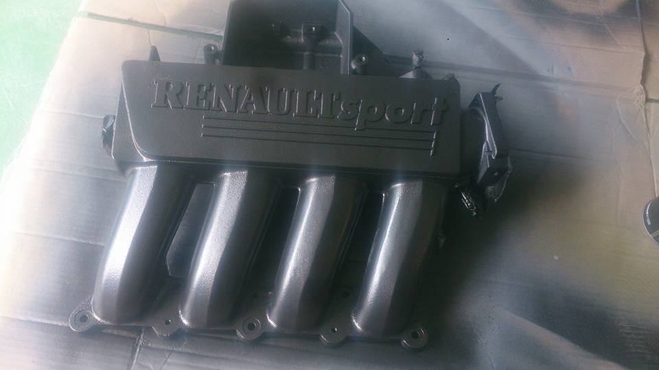

I'm thinking of spraying my inlet manifold in the ford Graphite grey my alloys are in. I still have a full can of this paint and primer left over. Could i use this on the manifold and fuel rail guard or will i need high temp stuff?
sorry for the slow reply. I just painted by hand using some humbrol enamal paint I had left from my Tamiya kit making days. Its camel yellow if your old enough to remember Nigel mansells Williams fw14b f1 car circa 1992. I had a huge model I made years ago. It did need 6 coats though!!
should be ok. My inlet is just halfrauds silver for some rover. Just picked a colour I liked. Yellow on black would look awesome.
  vectra+clio172 cup
Agreed that engine bay looks tidy and the yellow paint looks great. I even remember the mansell colours you're talking about!
Found it on here. It was a naff carbon effect so just painted it mondial blue, then masked the lettering before satin blacking it with a rattle can. Had a spare Cliosport decal to finish it off.

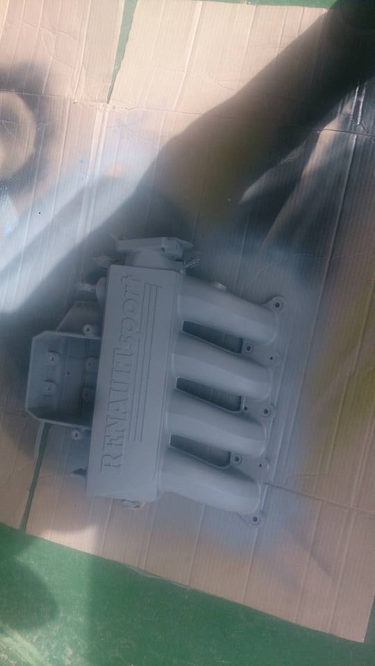

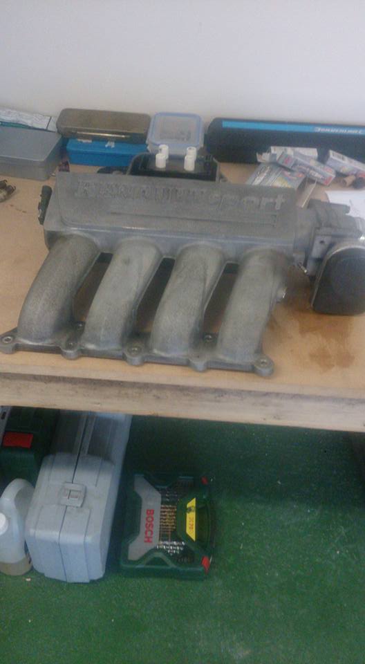

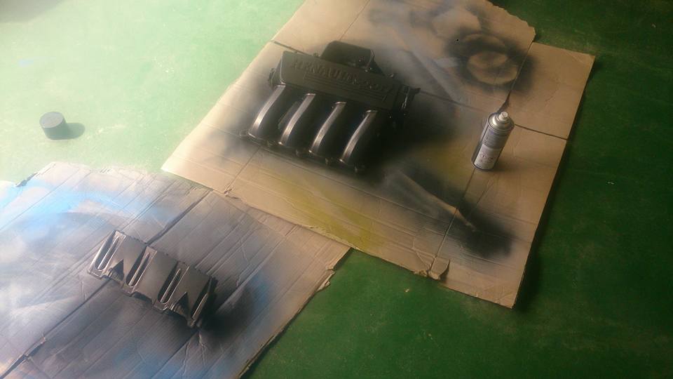

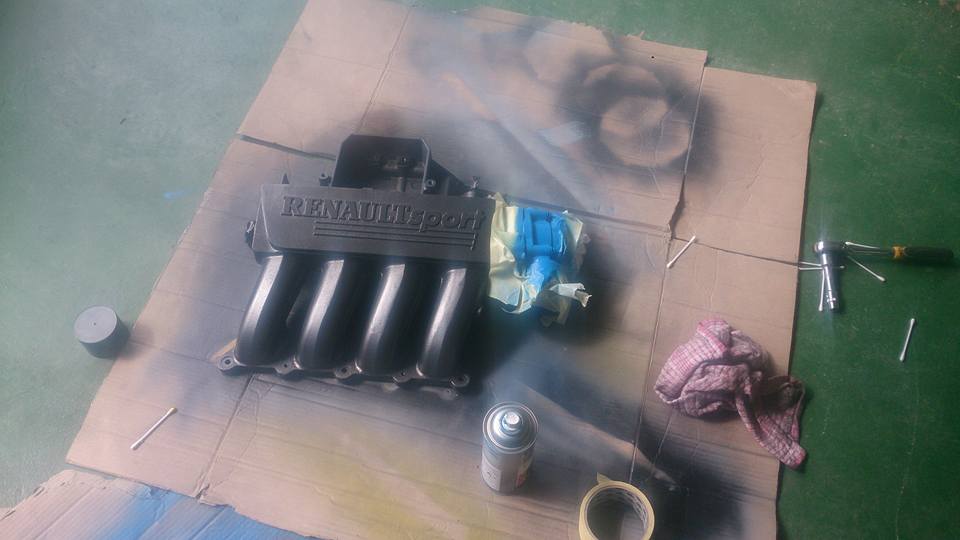

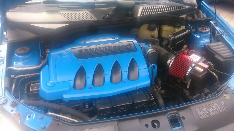

Been busy with an afternoon off, i thought i would crack on with the inlet manifold spraying. Here is some photos i took along the way.
What you think? Its far from a professional finish but i think it looks tonnes better than it did before!

Advikaz
I like the manifold.
Not sure on the cover. And I've never been a fan of induction kits tbh.
But if you like it.
I used a fine modelling brush. Took my time. 6 light coats to build it up. Light heat gun between coats to speed up the drying time. If I over painted I just wiped it off straight away. When it was fully dried I just sprayed some of the manifold colour in a small pot for any touch ups around the lettering. I did do it in the kitchen though as I found it easier than bending over the bay.

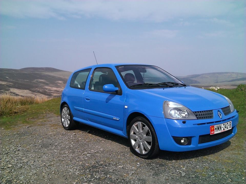

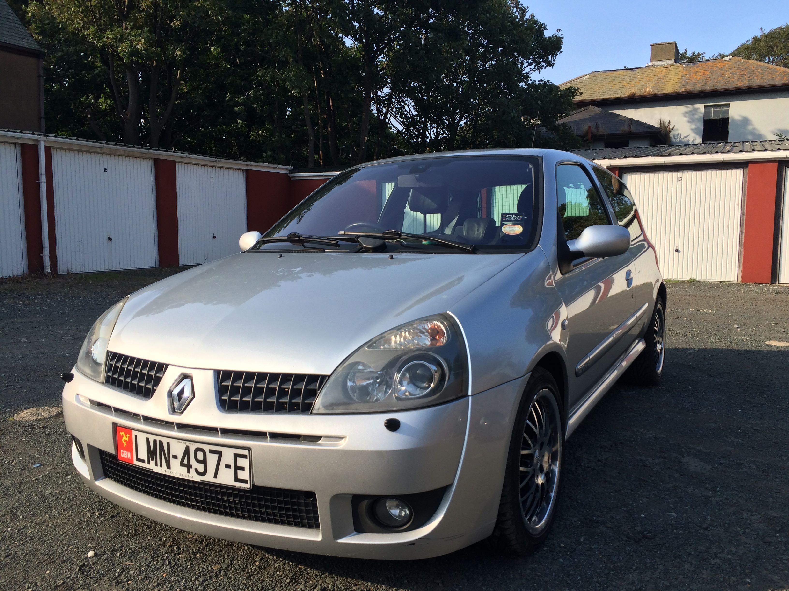

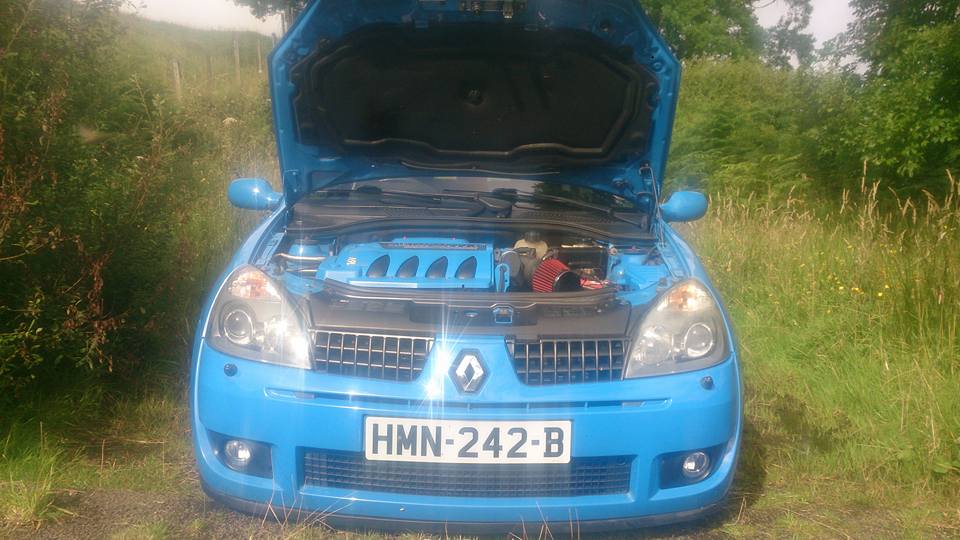

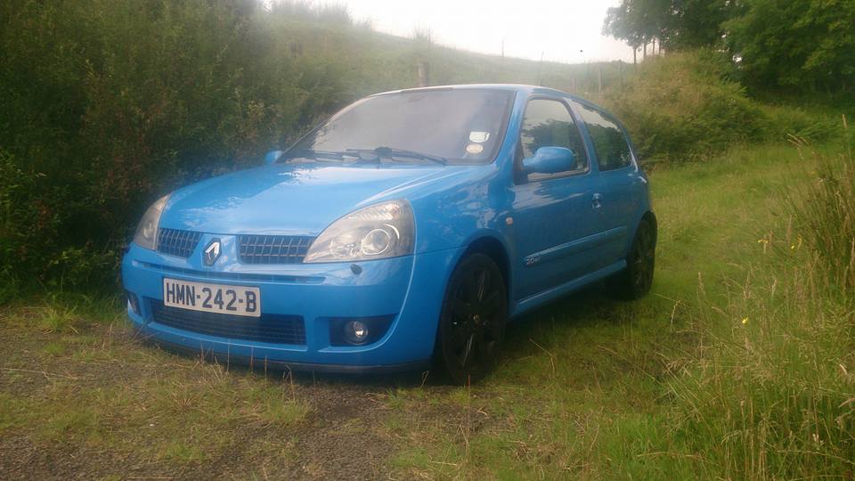

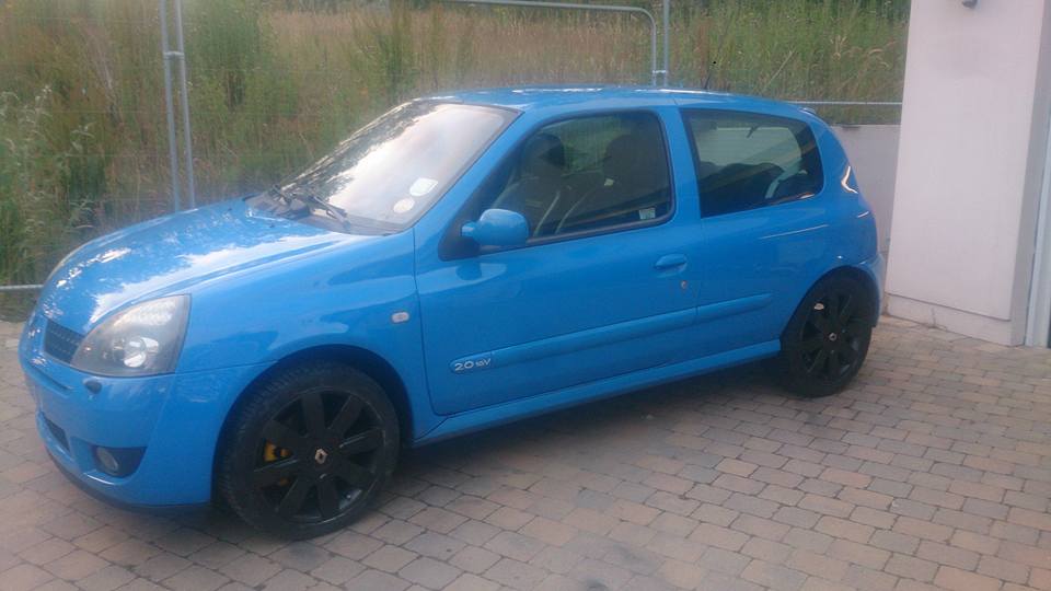

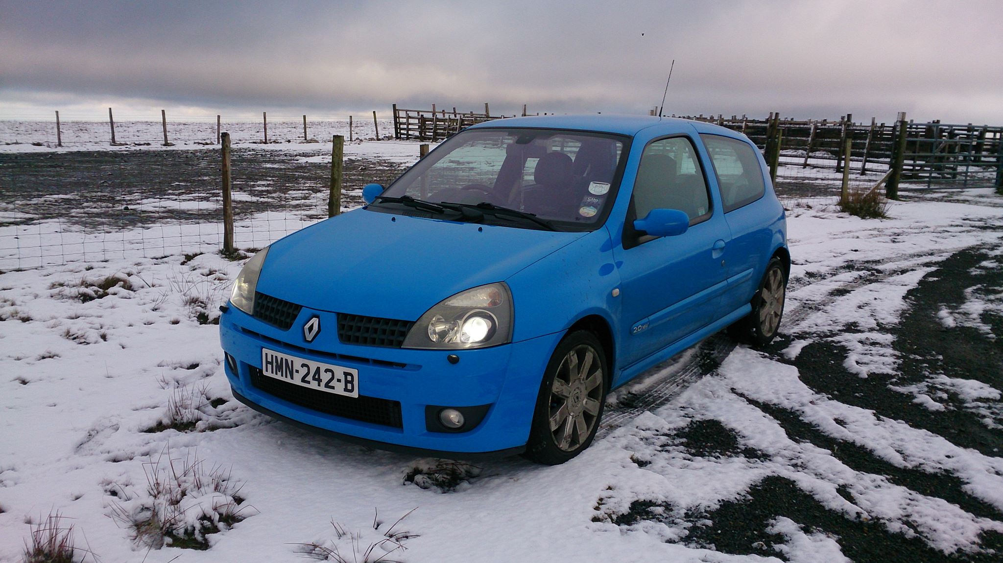

Had a house viewing this morning, so i took the time to go and take some pictures of car whilst sun shining. Pictures below. What we reckon?
Gus
  182Turbo,DCi90
Looks in amazing condition, you would never know the mileage was around a hundred k. Really like the manifold and engine cover. Great job on those.
I would get hold of a 90' elbow for the airfilter and locate it behind the passenger headlight - look at the fatty kit thread. Also a new coolant bottle for £15 and a battery cover from MAD on ebay would finish the engine bay off nicely.

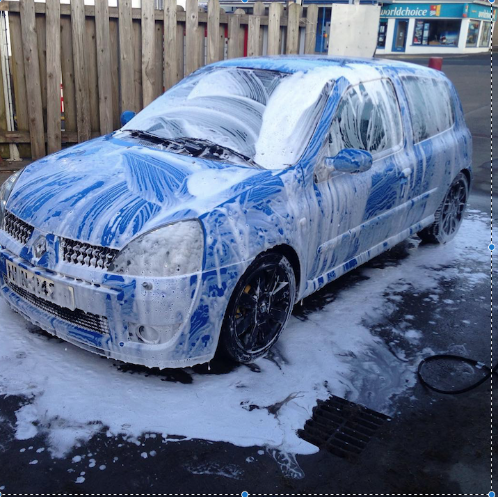

  Clio 2.0 182

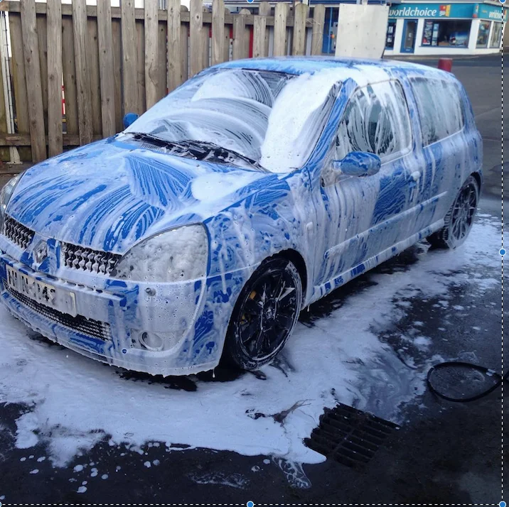

My car being washed this Morning, with its new springs and Scorpion Cat back exhaust :smile:
