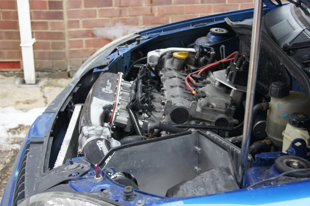

Yeah I had 50mm Jenvey ITB extensions fitted to mine, they may need tapering to your inlet currently depending on what design your RS2 is.
You'll have to remove the aircon, slam panel with an aerocatched bonnet, cup rad with a slimline rad fitted to it to get the extra 50mm extensions connected to the RS2.
Mine gained 4bhp and 8lb/ft of torque without any additional mapping, the torque being the most noticeable for sure! Getting someone to play with the timing on STANDARD CAMS is the way to go imo, the 197 cams lose you a lot of torque for a couple of horsepower which isn't a benefit. GroupN timing's on these would be the way to go, the rumours of a guy in France with a standard length RS2 with said timing making 200+bhp and great torque figures seems to more true than not. If I had one I'd be taking the time to prove that this method works or if not finding good results for them, as people seem to not want to bother.

Yeah that was the early one, however I had a revised set also which I should still have pictures for I believe?
@bozothenutter -
The torque stays similar to standard length if a tad more up to 3.5k, then it makes the more torque I was saying about from then on and holds it reasonably well to the limiter. Graphs should be in project thread as said, they'll be back to back due to comparing.

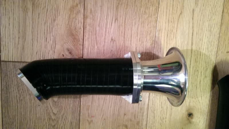

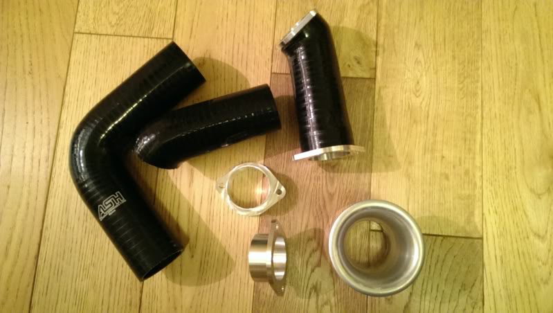

The runner extensions are the standard jenvey SF type extensions, you can get straight and curved ones.
I have an alternative method of doing it which would gain you more than 50mm.
I also have some plates so you can keep the grill in place but remove the slam panel and bonnet catch.
Adey.
@Adeyspec
the set i have coming from James Stone should be here tuesday, but would be good to see your alternative? slam panel out and aero catches already fitted for extra space in anticipation of the longer inlet
Ph1 Tom

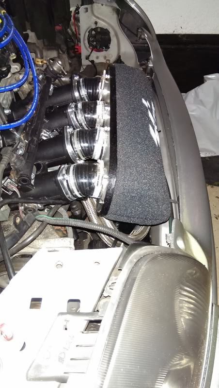

It gives you a lot more length than straight extensions because the angle (see Nick's engine bay) pushes the inlet into the bonnet. Changing the angle and moving it towards the front of the car gives you much more space. For example my total inlet tract length is 380mm whereas the maximum with straight adapters is 330mm, and mine is a ph1, if it was a ph2 there's scope for another 10mm so 390mm vs 330mm. The next step for me is to come up with some kind of intake/airbox and do away with the sausage filter, then I could break 400mm I reckon.
The plates I have are so you can keep the top of the grill. Its a shame I had to loose mine but I had no choice as I have ITBs and it would affect air flow. Imo it looks s**t without and keeping the top of the grill keeps the car looking tidy. These are the plates the allow that.
