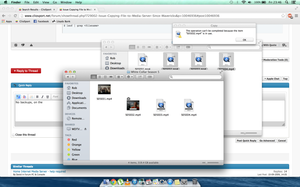

Since upgrading to Mavericks (and then getting a new machine with it pre-installed) I have an issue with drag and dropping my files wirelessly to my external HDD (that's on the network).
Basically the sequence is:
Download a 100% legal torrent ;)
Close utorrent down
Copy file to exhdd
Gets right to the end and comes up "copy could not be completed because file is in use" or something to that effect.
I seem to be able to fix the issue but not 100% of the time which is driving me mental. A series of resarts etc does often cure it, but as said, I don't know for certain what actually fixes the issue. It's got to be the new software as prior to this I've been using the method for 3 years with no issues.

I'm not a spaz dude :rasp:, I'm properly quitting it.
I thought I'd found the issue, I thought it was because I hadn't deleted the .torrent file yet and it was accessing it or similar, but that's not the case, I'm also stopping the torrent before closing utorrent down.
I have just this second had another thought, could it be the icon based preview that there now is? Because it loads one frame of video? I've just disabled that and am testing. Problem is with it being a random issue, I'll not know if that's solved it for at least a week.

Having you got any backup schedules set?
In fact when the issue occurs again, run this in terminal to see what program has a lock on the file.
Code:
$ lsof | grep <filename>

Preview removal didn't fix it.. (I only removed previews on the source file)
Code:
lsof '/Users/rob/path/to/file.mp4'
That will work better, I forgot to remove the grep bit!
Lsof is case sensitive btw :)
Or you can try this, grep just searches instead of having to specify the whole path!
Code:
lsof | grep -i 'S05E02.mp4'

100% can't get that to work for some reason.
'lsof' all lower case?
I keep getting no such file or directory.
Or when doing the search one, it loads something in the background, but does nothing.
Yeah it's lowercase, the command is working fine it just can't find the file. Can you copy and paste the code you are using when it comes up no such file or directory?
Second one may take a bit of time to locate the file!
This program does the same thing as lsof, but with a gui interface, but the last version was for 10.6 so I can't see it working http://www.hamsoftengineering.com/products/wkm/wkm.html

Okay mate, one last thing if terminal is opening in your directory "Users\rob" -rob$ or however it comes up, then you don't need to include that bit of the path in the command :)
  172 Cup & K20 Ph1
See example below for syntax, simple bit of code that holds a filesystem lock on a particular file and I'm checking which binary currently has that lock...
vader:~ rdo$ ./a.out & lsof | grep file.txt
[1] 49784
a.out 49784 rdo 3u REG 1,4 0 12181804 /Users/rdo/file.txt
However, this doesn't answer why @Rob Cannot finish the copying of a file. A UNIX platform should have no problem copying a currently open-file...
vader:~ rdo$ echo "hello from file.txt" > file.txt
[1] 49792
a.out 49792 rdo 3u REG 1,4 0 12181804 /Users/rdo/file.txt
vader:~ rdo$ cp file.txt file2.txt
vader:~ rdo$ cat file2.txt
hello from file.txt
vader:~ rdo$
So I suspect that there's some other problem here!
