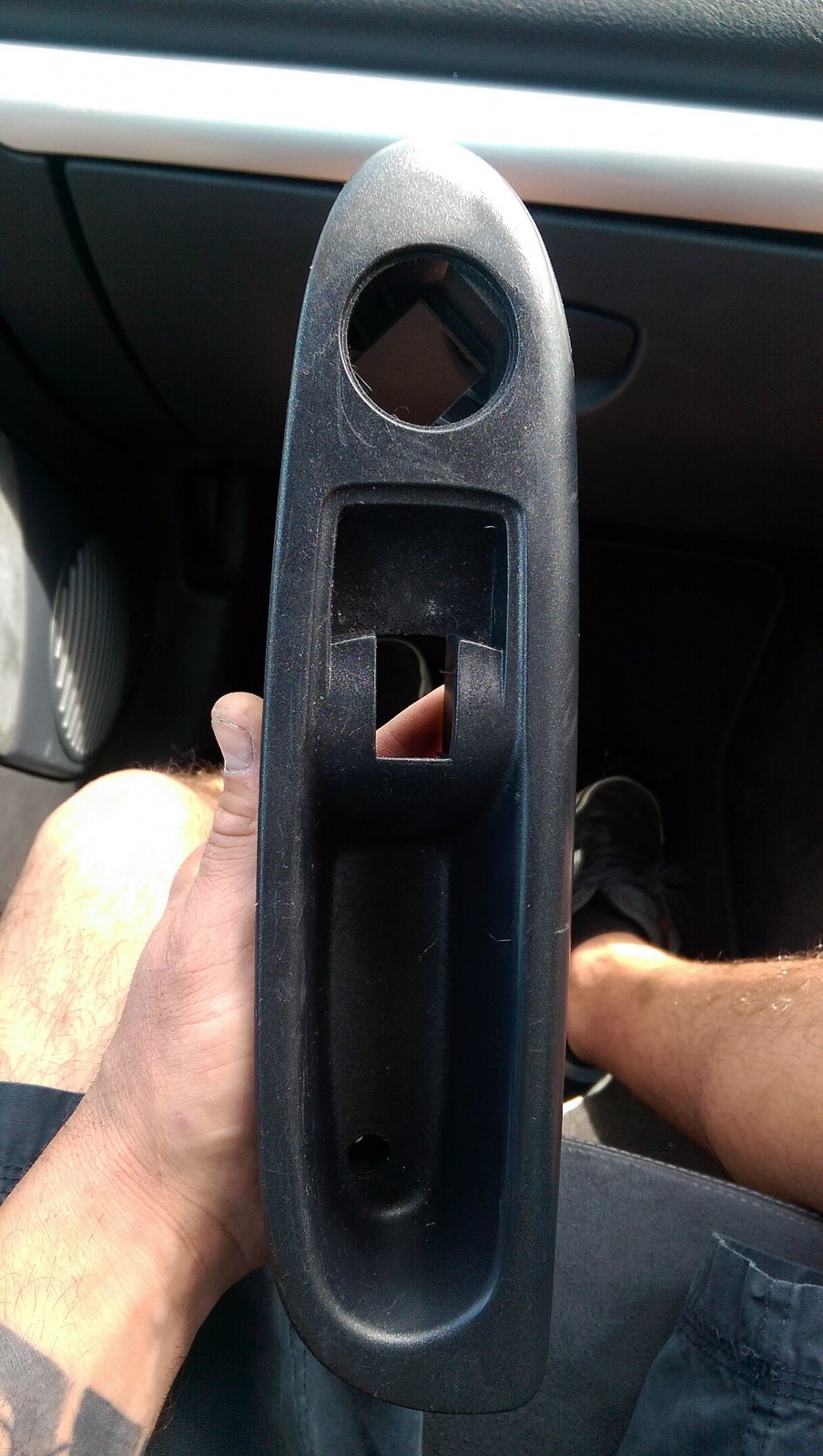

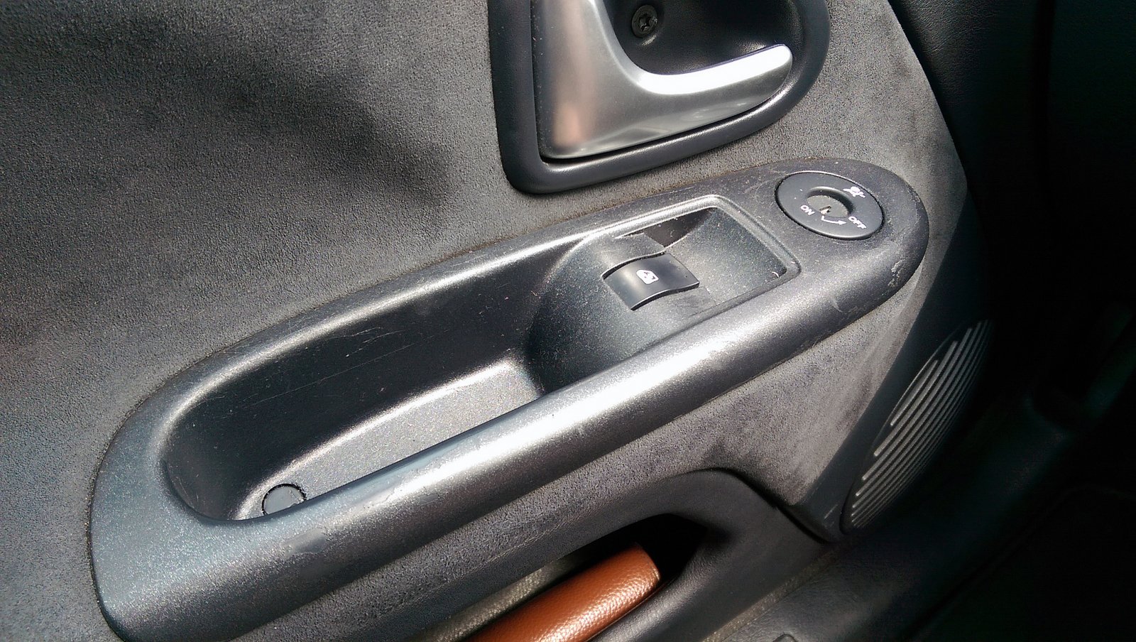

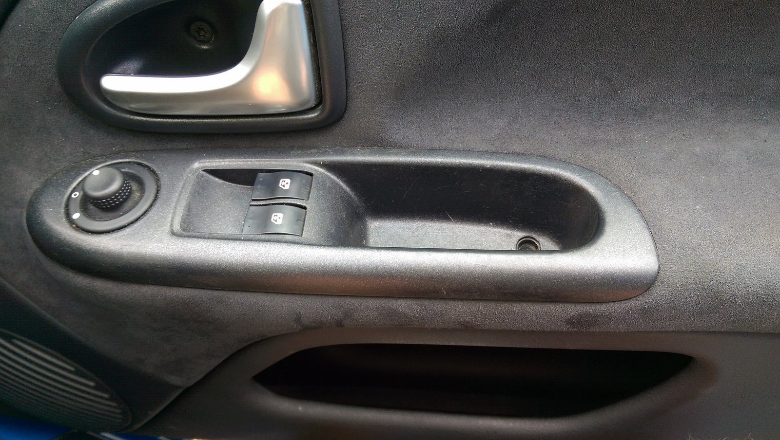

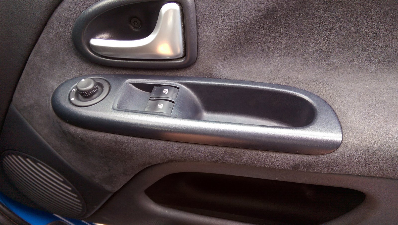

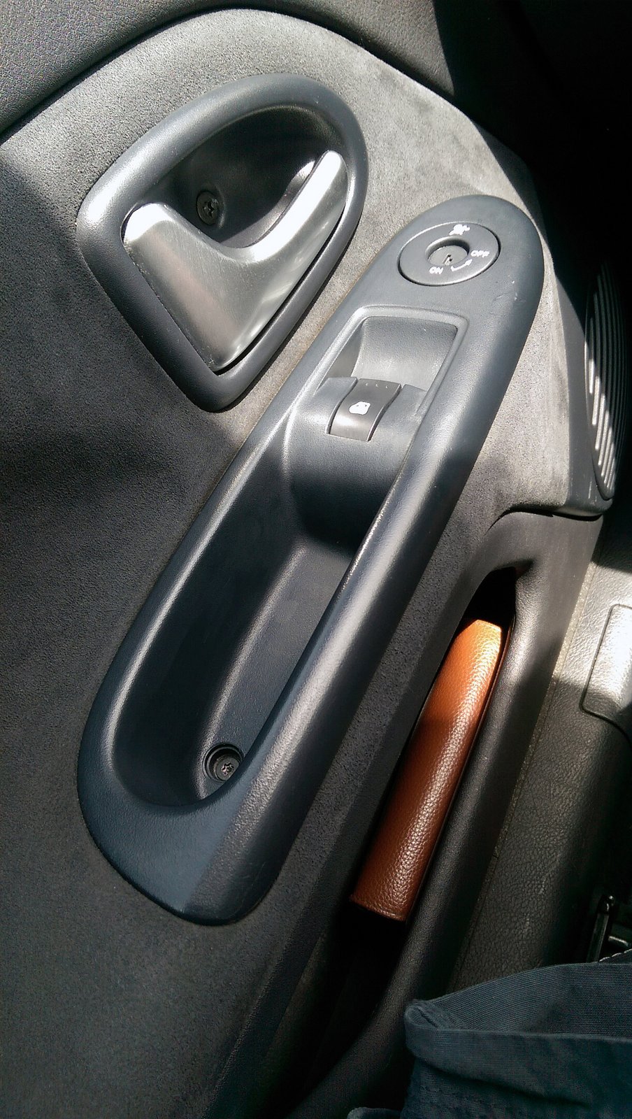

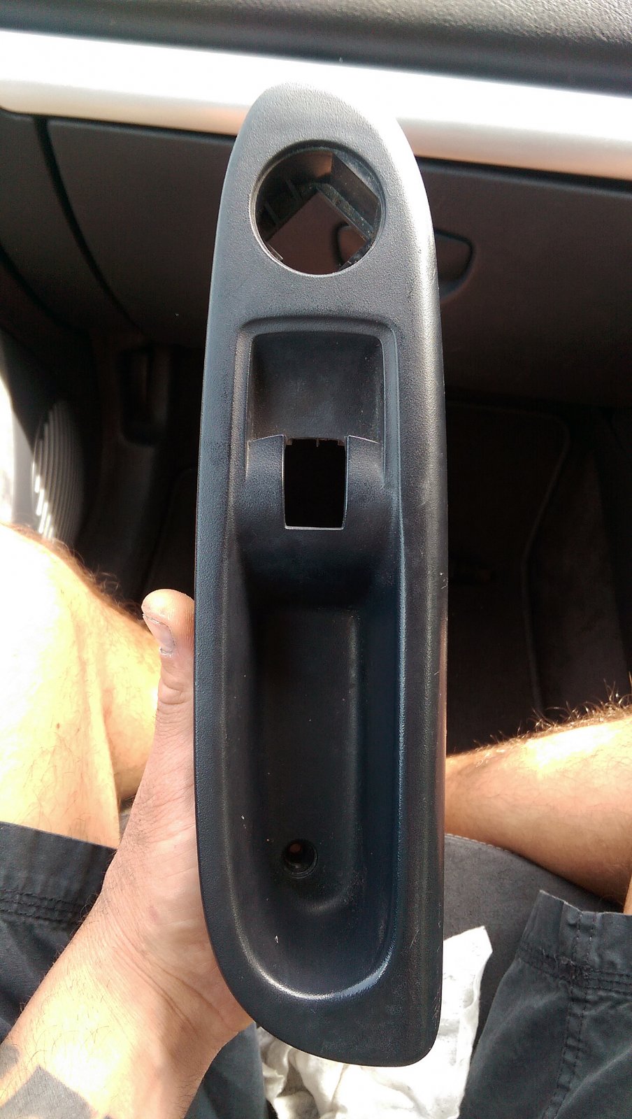

I chose to have non sports ones too as I couldn't stand the stickiness. A few pics of comparison.
Sticky sport ones.
And the non sport, non sticky ones.
