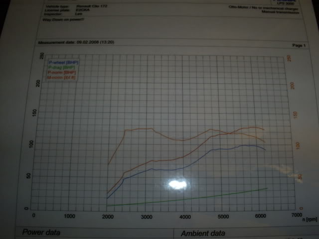

Missing the point mate. Title would be more accurate if it was "I seem to have a Clio that makes 10bhp less than the dozen other 172s that ran on the same day so it doesnt matter if the rollers were accurate or not" however its a bit long winded ;)

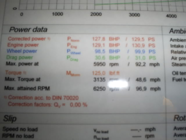

I remain unconvinced! Btw it was 123.8bhp at the wheels, how does that compare?
123.8 bhp at the wheels does NOT correspond to 162 bhp at the flywheel.
That's way to high an amount of power (23.6%) to be lost in the drivetrain in a transverse front wheel drive car. The right number is about 15%, or even lower. What that says is that there's serious questions about that dyno and/or its operator. You can't rely on the numbers he's giving you.
However that doesn't answer the question of why your car produced less power than other cars tested on the day that it shouldn't have produced less power than. People can suggest possible reasons, but without evidence of which of the great many of them it could be, you and we have no idea. All they suggest is what it might be worth you investigating first.

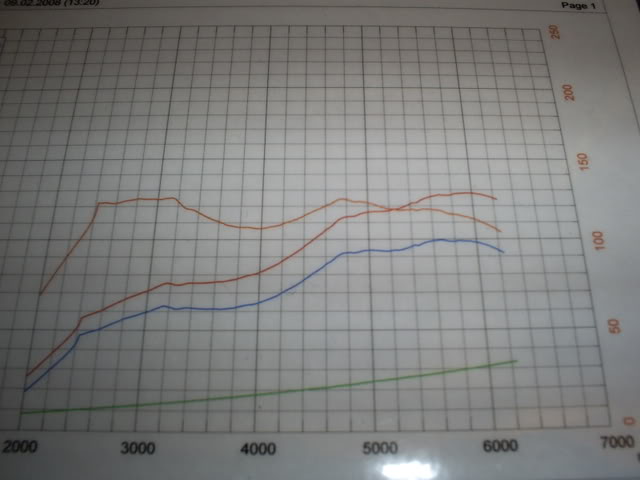

Looking at the dyno chart you posted your car looks like it would feel strong in normal road driving. It has a lot of torque at low revs. Rather than your car having a fault that's subtracting power, it looks more like its tuned for torque rather than power. That points the finger at something like cam timing. Was the cam belt put on one tooth out, or somehow incorrectly? Is the VVT fully advancing?

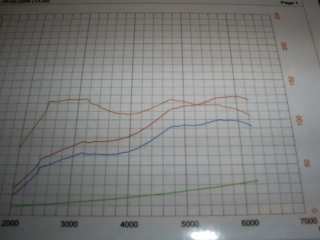

Well here is my print out of the day
What do you guys think about the dips etc
Any advice welcome

The fact that it didnt hit 7k, by a fair margin, the strange sound it was making and the similar power its producing to Mikes old car all point to 1 dodgy valve imo. Id place a fiver on it!
Yeah didnt here it hit the limiter iirc, think it should rev to 6.9k or something like that, but as the graph says it only hit 6.2k not good:dapprove:

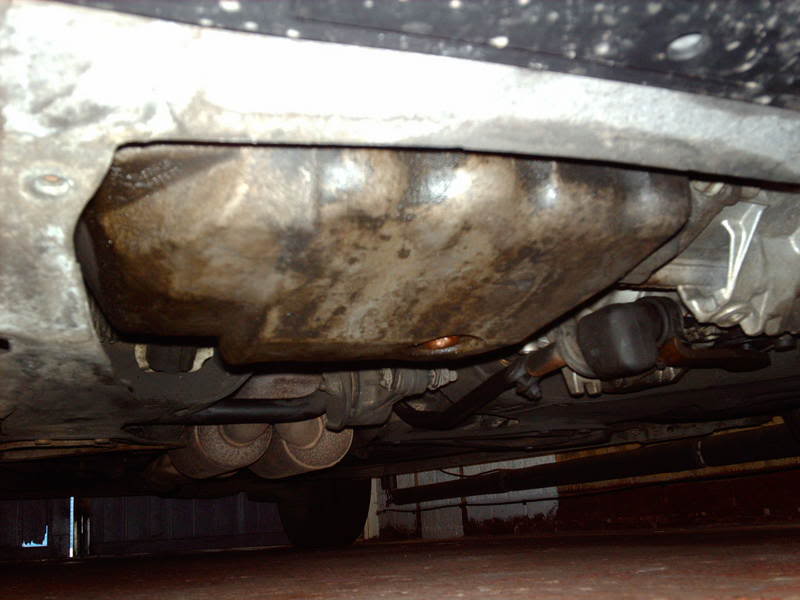

tbh I think you you maybe right about the valve. Heres what the standard one looked like:
  Golf R
Any easy way to check the cat?
i'm sure the cat was done with the exhaust fella - have you looked on the exhaust receipt for what they did?
